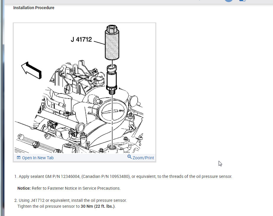

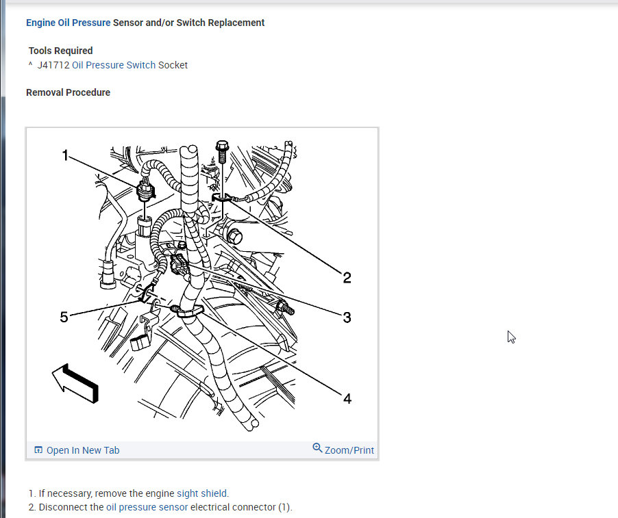

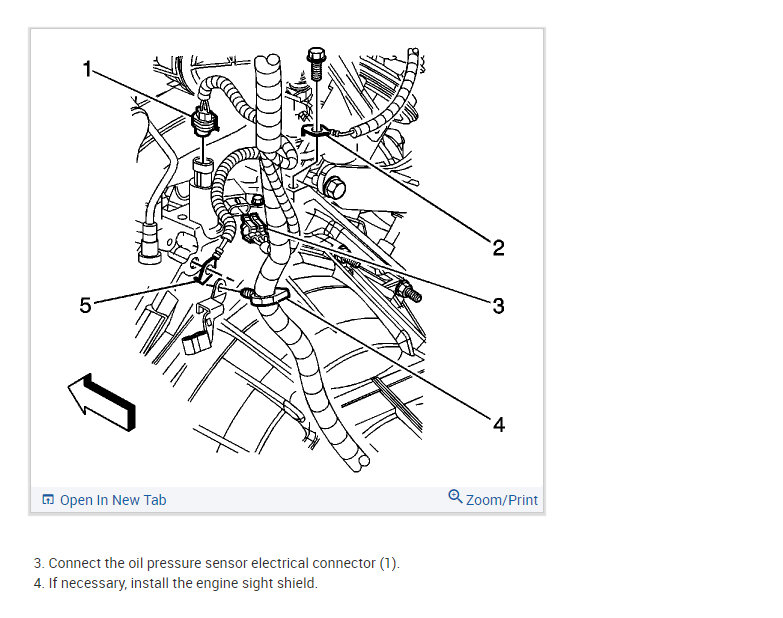

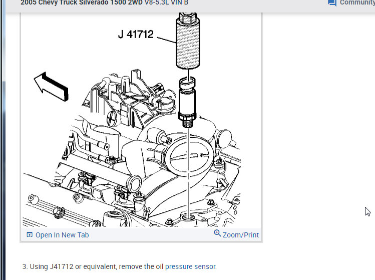

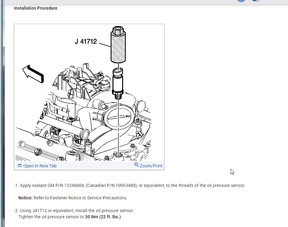

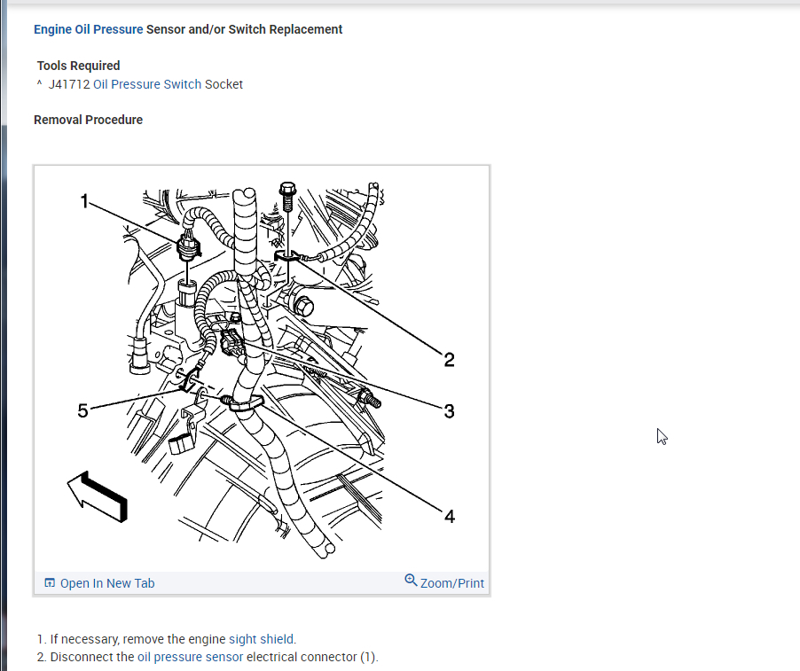

where is the oil sending unit located?

I am attaching the replacement info for the sensor. Let us know if you need more info and we can provide it. Check out the diagrams (below). Please let us know what you find. Thanks
