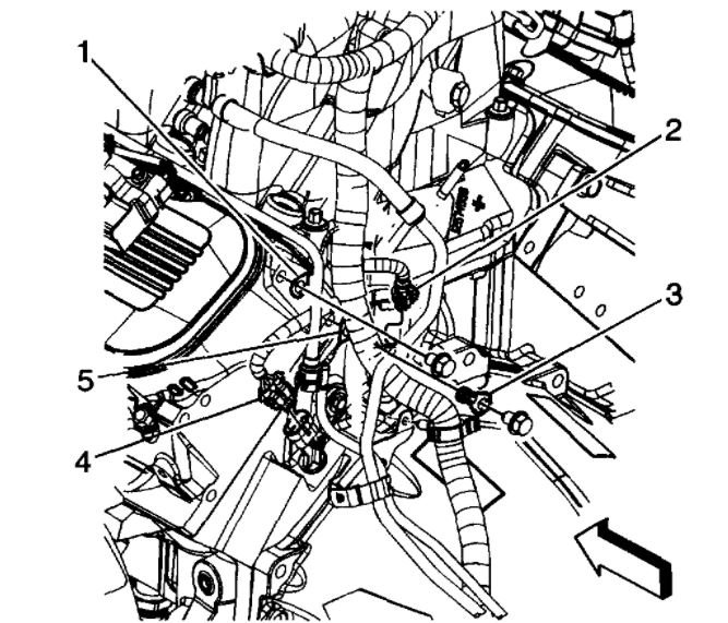

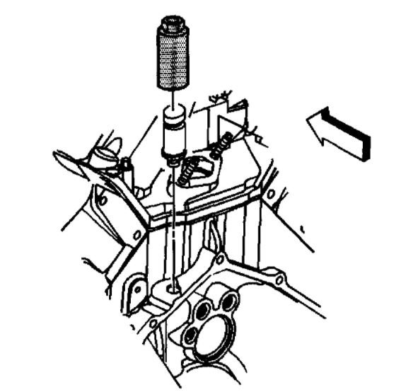

My oil gauge was fine 40 PSI when first started it in the morning. I stopped at my local corner store. My SUV was idling. When I returned it was at zero. No check engine nothing! No clunking noise from engine, until I got off from work. After work as started it I heard clunking. Not that bad but some.
So my questions are:
1. Where is the oil pressure sensor on my vehicle listed above 2500?
2. Can someone send pictures or diagrams?
3. Also does it require a filter screen in the oil sensor hole?

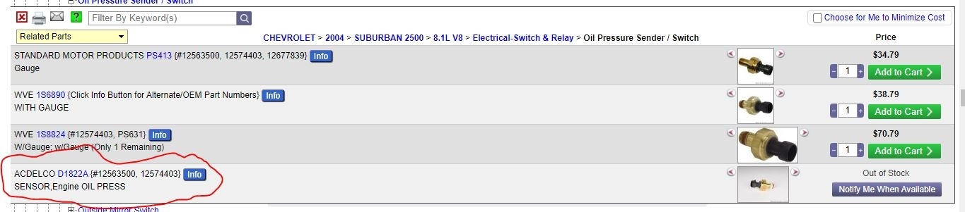

4. What part number would it be in AC Delco or equivalent?
Thank you

I attached the part below as well.
Engine Oil Pressure Sensor and/or Switch Replacement
Tools Required
- J41712 Oil Pressure Sensor Socket
Removal Procedure
1. Remove the engine sight shield.
2. Disconnect the oil pressure sensor electrical connector (2).
3. Using J41712 or equivalent, remove the oil pressure sensor.
Installation Procedure
1. Apply sealant GM P/N 12346004 (Canadian P/N 10953480), or equivalent, to the threads of the oil pressure sensor.
Notice: Refer to Fastener Notice in Service Precautions.
2. Using J41712 or equivalent, install the oil pressure sensor.
Tighten the sensor to 30 Nm (22 ft. lbs.).
3. Connect the oil pressure sensor electrical connector (2).
4. Install the engine sight shield.
