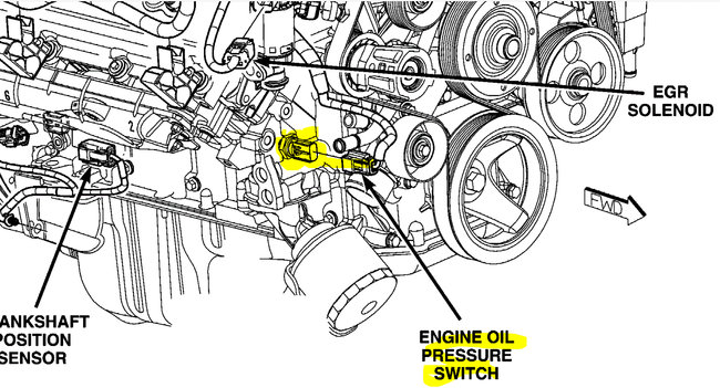

So once my truck has warmed up and is at an idle the oil pressure drops low to the point of not registering. But whenever I take back off driving again it regulates back normal. Does this mean my oil pressure switch needs changing?

If the pressure drops to nothing, you normally will hear a ticking or knocking from the engine. If that isn't the case, it sounds like the oil pressure sensor is bad.
Oftentimes, they leak into the connector plug. This allows the pressure to appear low.
If you wanted, you could confirm oil pressure using a mechanical gauge. Basically, you remove the electric sensor and screw in an adapter that goes to a mechanical gauge. Start the engine and see if the pressure is truly low. However, if you don't want to try that, check the sensor for leaks. Also, disconnect the connector and inspect it as well for oil
I attached a picture below showing the sensor location. It is up and to the right of the oil filter. Simply disconnect the connector and using a deep well socket (some require a special oil switch socket) unscrew it from the engine and replace it.
See pic below.
