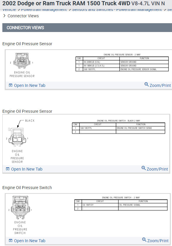

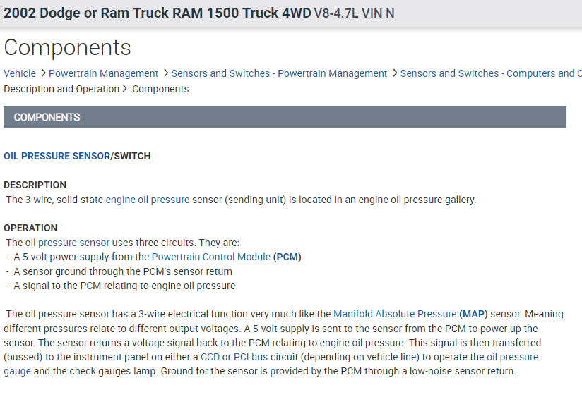

When stopping my oil presure guage comes on indicating that the oil pressure is low. During normal driving all is well. Will I need to replace the oil pump or is some other reason for this?
Friday, January 2nd, 2009 AT 10:57 AM
SQM
  • 6,383 POSTS
First of all please make sure your oil level is correct.

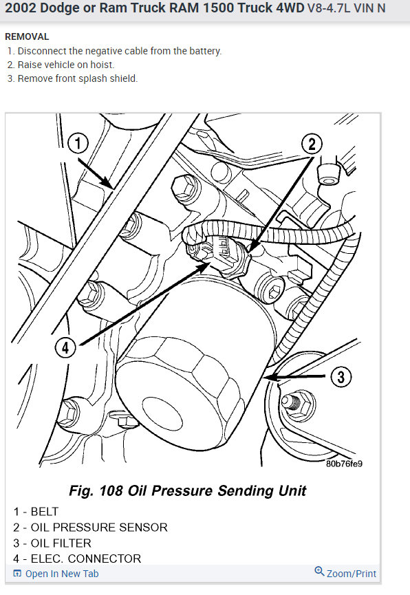

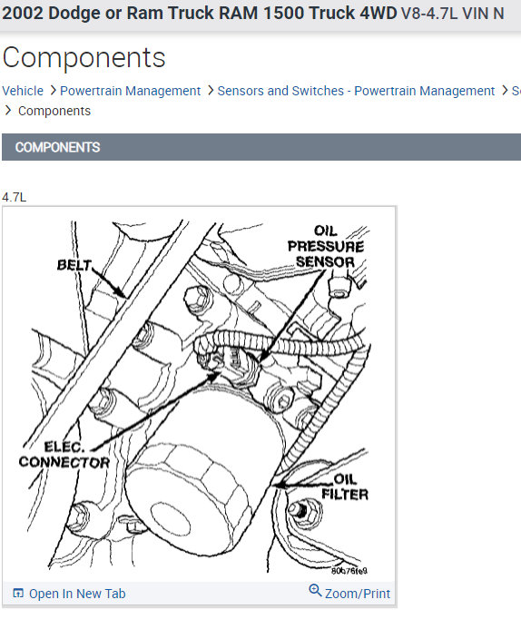

Second thing is that you could have a faulty pressure sensor, which giving incorrect data.
Does the engine run any different than usual? Any strange noise?
Here is a helpful article on oil pressure:
https://www.2carpros.com/articles/high-or-low-engine-oil-pressure

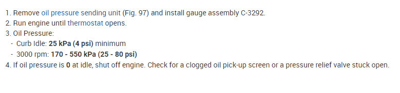

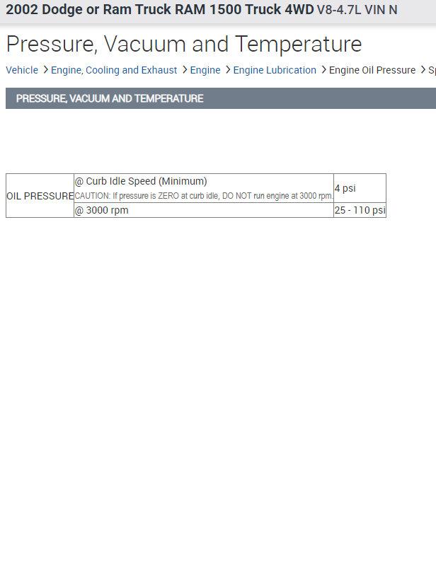

I would also recommend checking the oil pressure to make sure it is a faulty sensor and not a pump.
At idle the engine should be at 4 PSI of pressure.

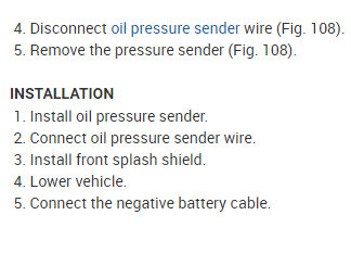

I have attached the pressure sensor location and replacement as well as pressure testing procedure for your vehicle.
