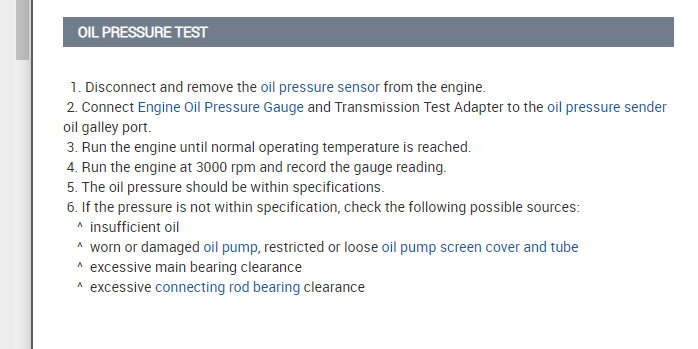

Was driving yesterday noticed oil light came on and pressure dropped. Checked oil and its fine. Making no noises

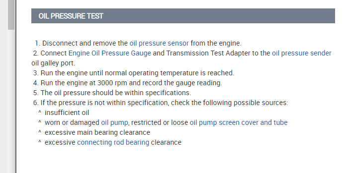

We need to also hook a gauge to this engine and see if the actual oil pressure is low.
If it is low then we don't want to drive this vehicle until we fix this. However, if the gauge shows good pressure then we have a sensor or wiring issue.
Take a look at the attached below for the detail on how to run this test.
