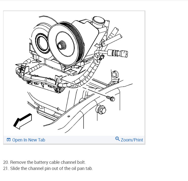

I have about 20 PSI while driving but drops down to about 2 when idle. I replaced the oil pressure sensor and still does the same thing. Oil is up to level, no knocking of the motor. Everything seems fine except for the pressure reading.
Jun 3, 2023 at 1:44 AM
  • 55,399 POSTS

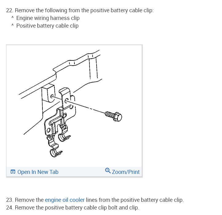

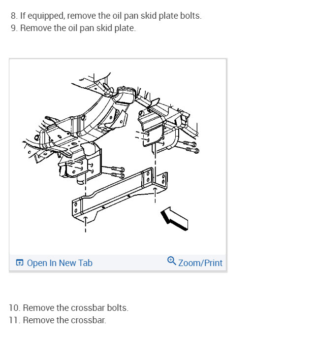

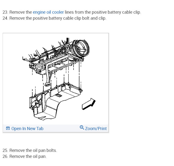

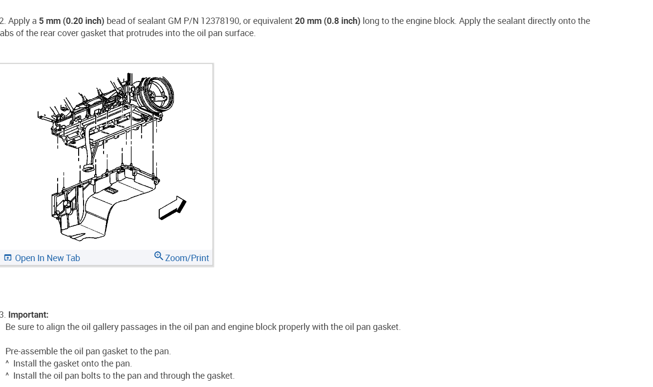

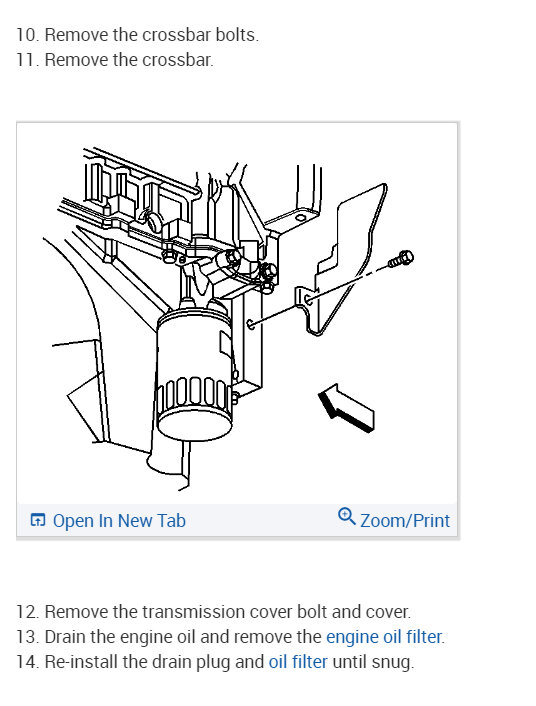

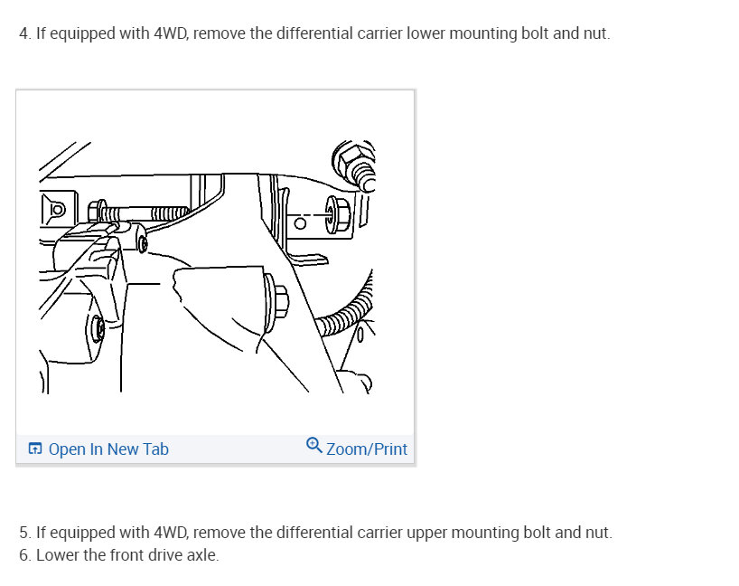

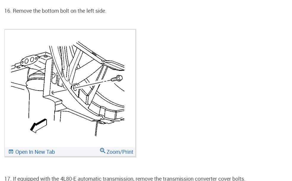

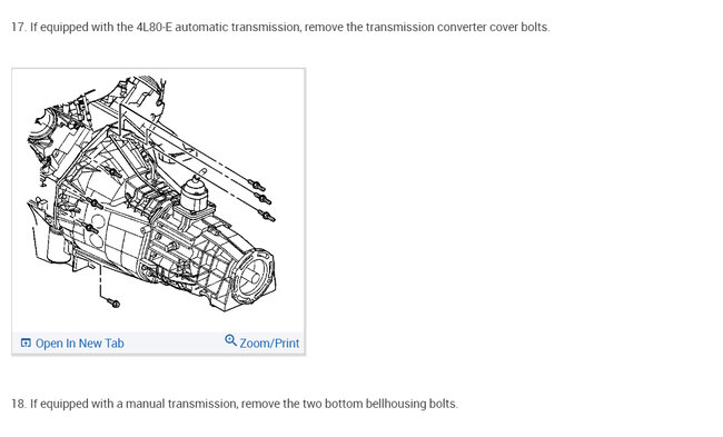

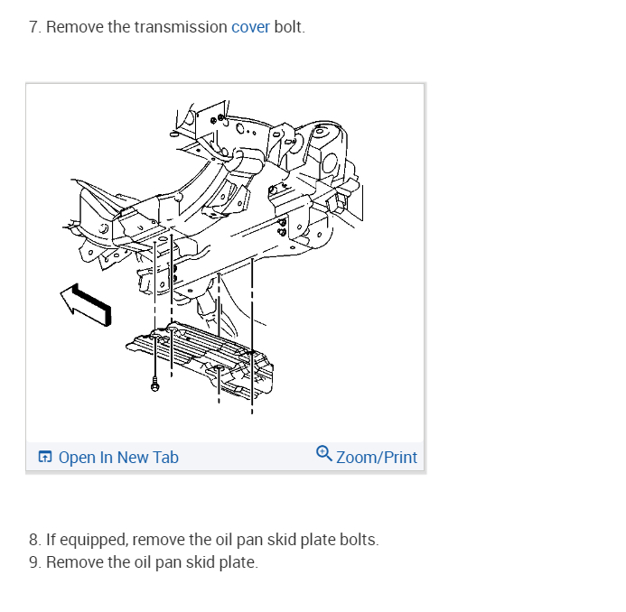

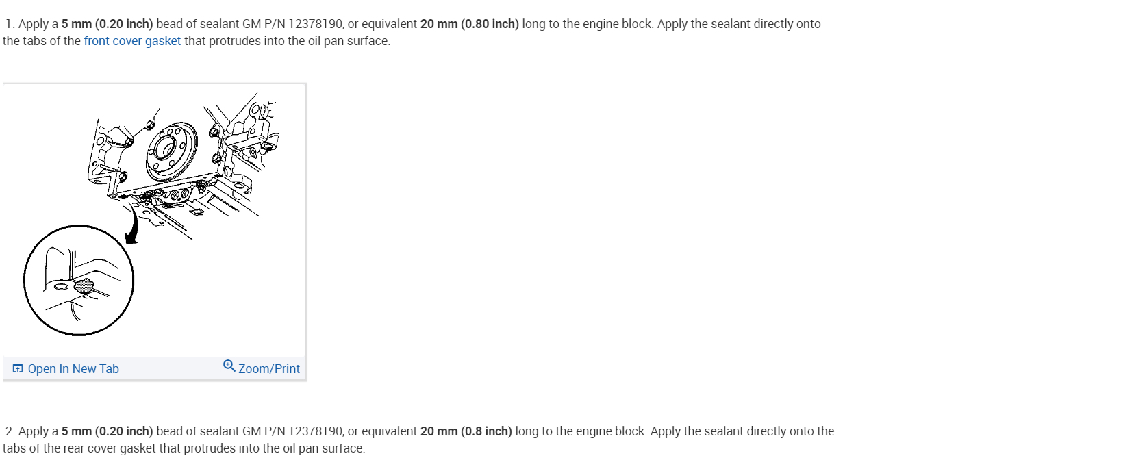

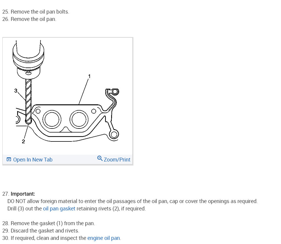

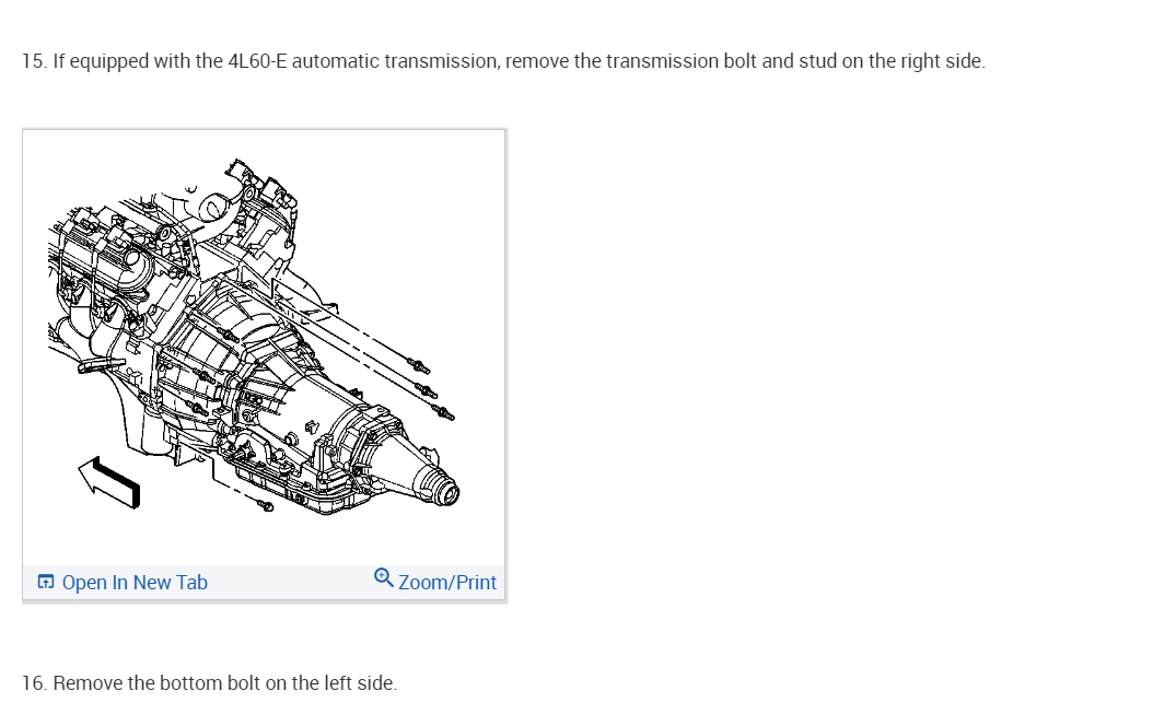

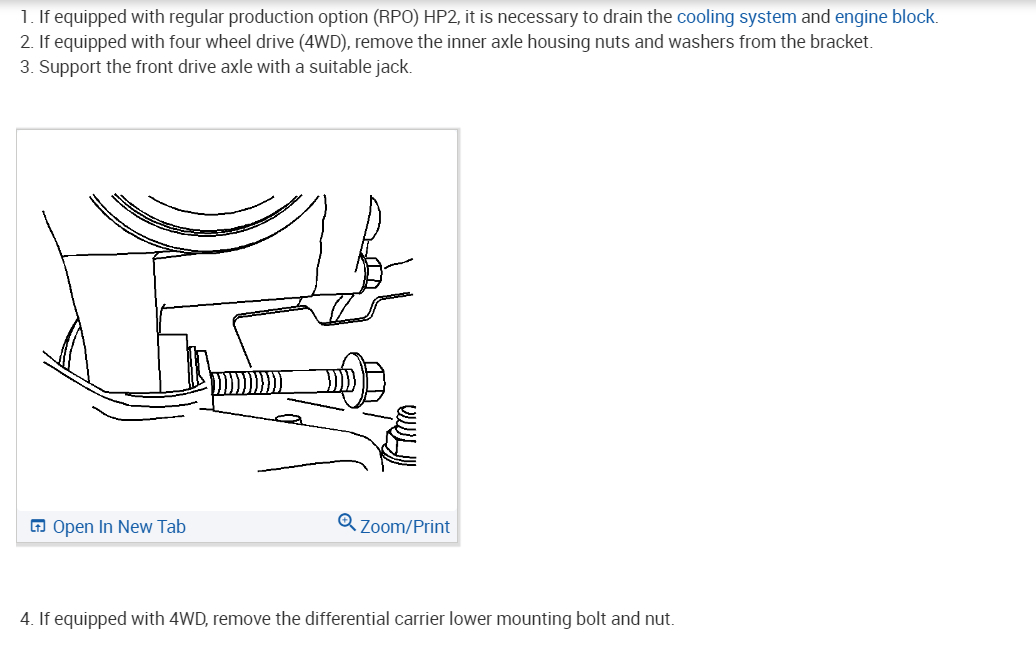

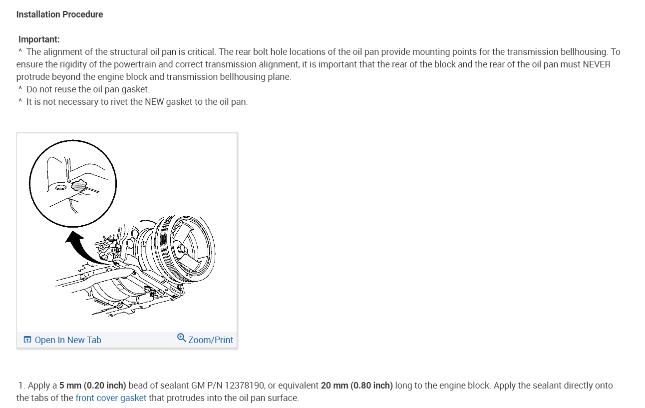

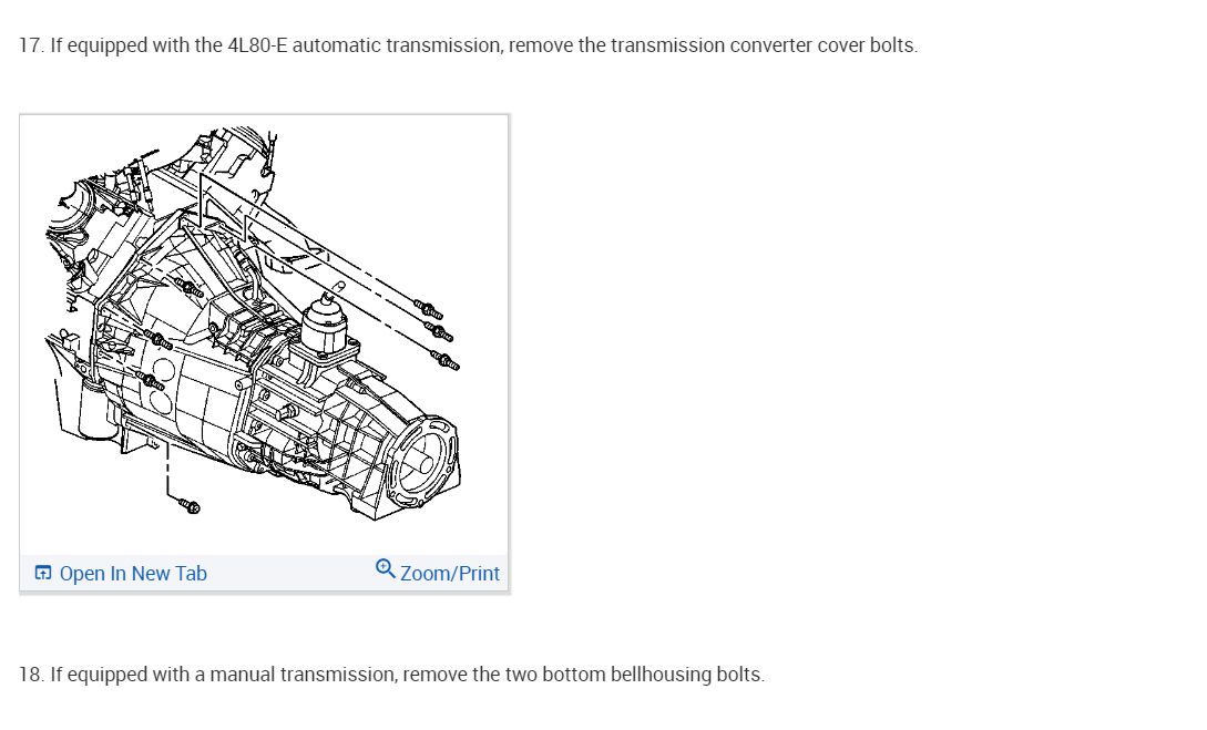

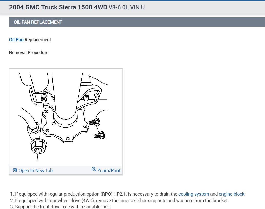

Yep, this happens when the oil pump pickup gets clogged due to sludge or the oil pump pressure relief springs breaks. How does the inside of the engine look is it sludged up? If so, I would start by removing her oil pan to clean the oil pump pickup which is most common.
This guide can help as well:
https://www.2carpros.com/articles/high-or-low-engine-oil-pressure

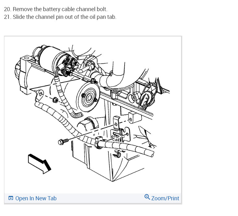

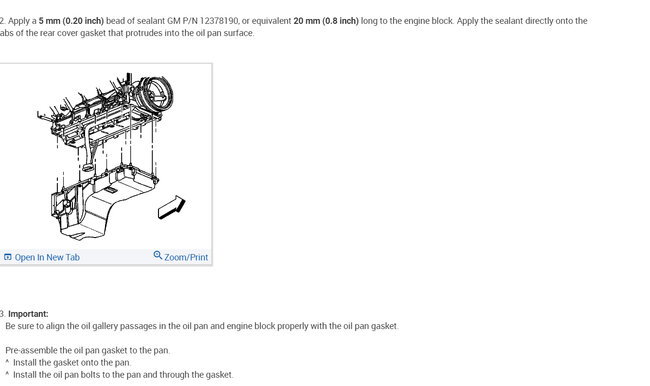

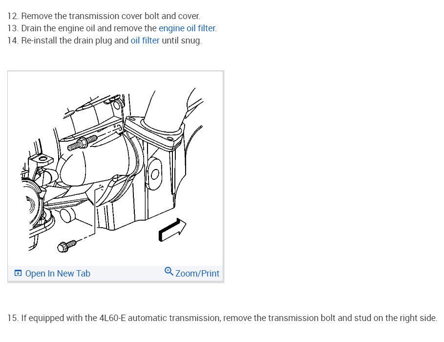

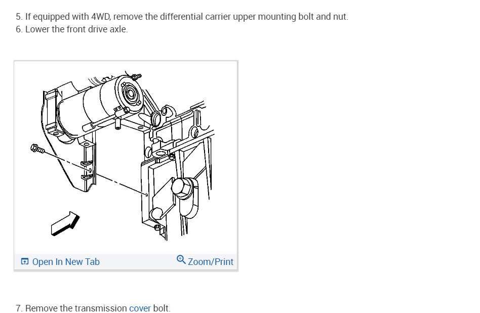

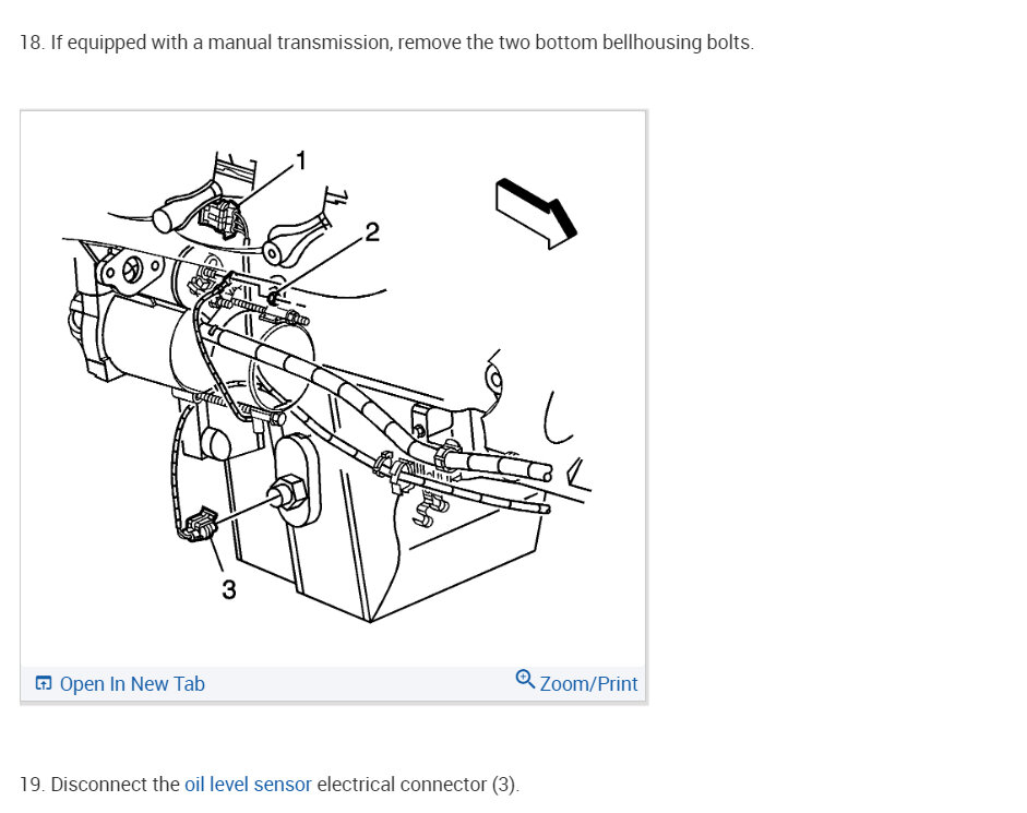

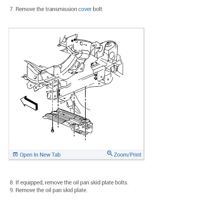

Here is how to remove the oil pan in the images below. Check out the images (below). Let us know what happens and please upload pictures or videos of the problem so we can see what's going on.
