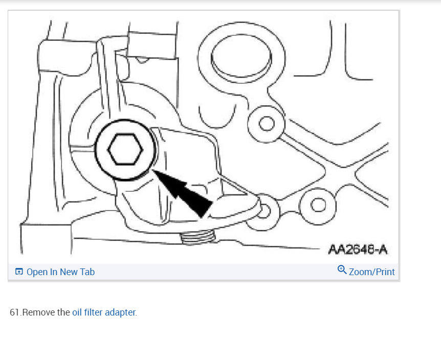

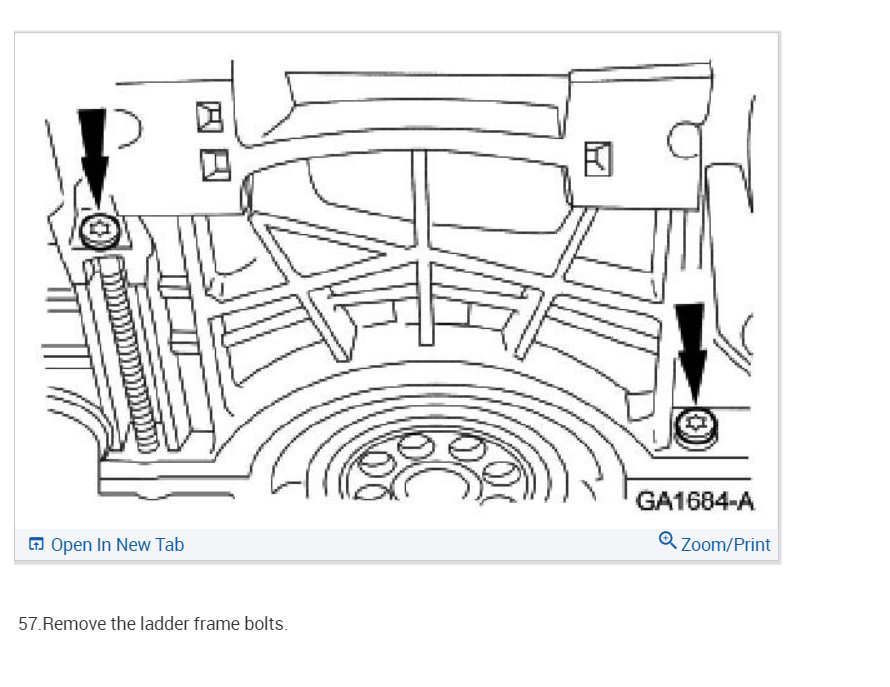

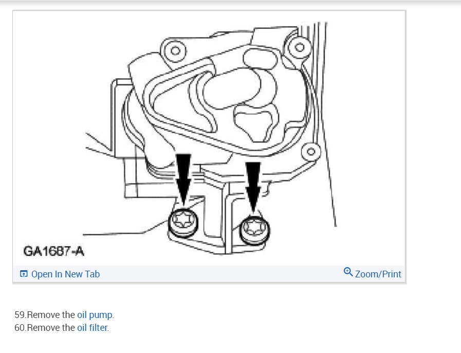

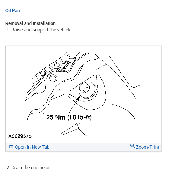

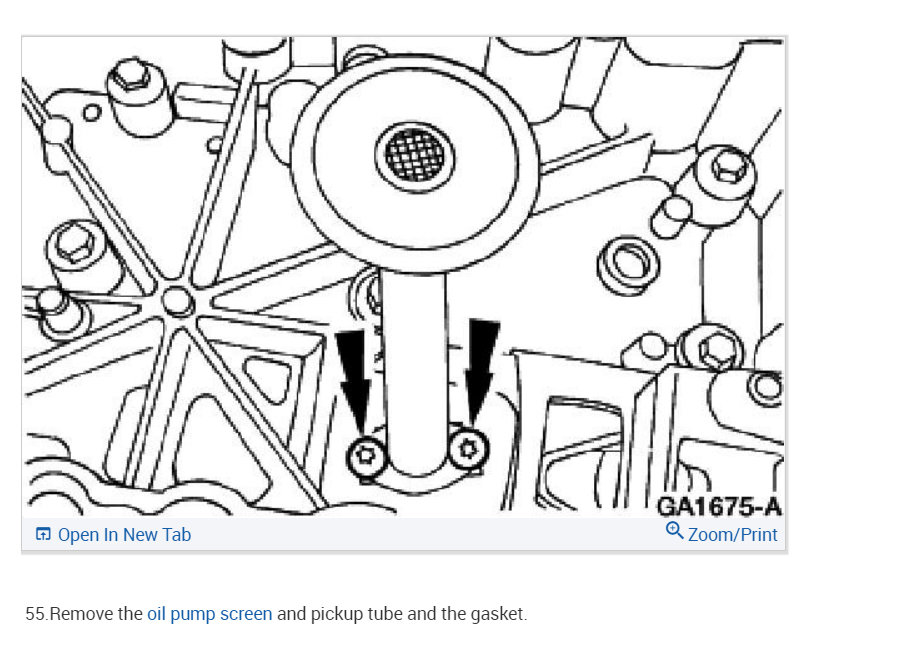

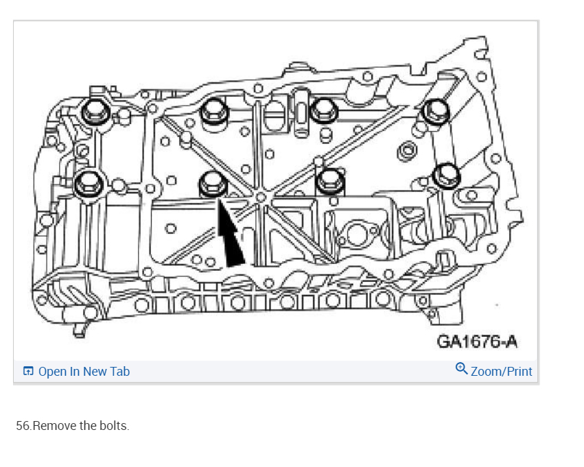

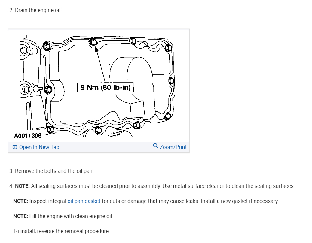

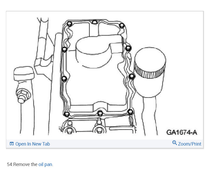

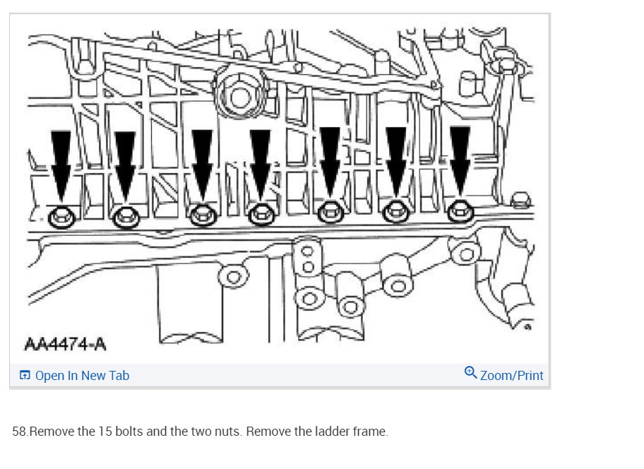

Does the engine have to be lifted out to change the upper oil pan gasket?
2,640,000 MILES • 0.6L • V8 • 4WD • AUTOMATIC
DEBBIELEE196128
Oil pan gasket replacement.
Aug 25, 2022 at 1:59 AM
  • 55,746 POSTS
Yes, it does, here are the instructions on how to change the upper oil pan gasket in the images below.
For Upper Oil Pan/Ladder Frame Service and Repair information please refer to Engine, Cooling and Exhaust/Engine/Service and Repair/Procedures/ See: Engine > Procedures > Disassembly
