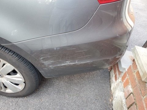

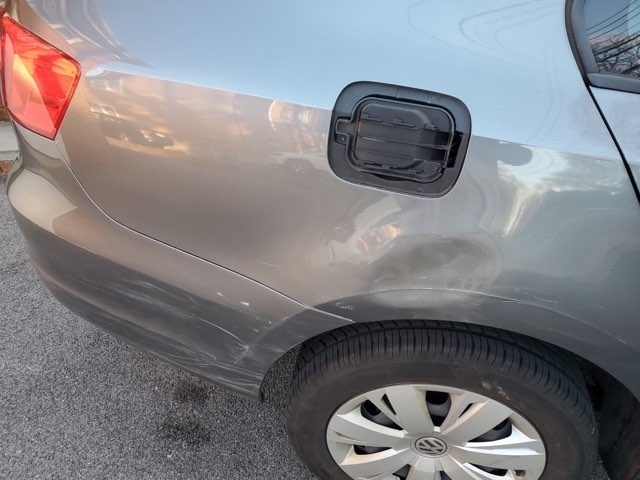

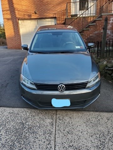

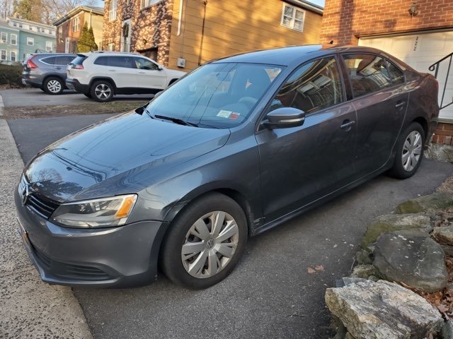

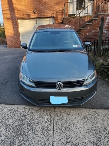

ADA512
Danny,
See attached pics.
Jul 8, 2020 at 7:20 PM
So to Danny's point, if this is the only thing wrong with the car and $2,400.00 will get it back on the road and you like the car then it is worth repairing.
However, if it has been giving you issues with one repair after another and you don't want to keep it then I normally sell it as is and not put the money into. Clearly you will not get as much for it but sometimes it is worth not dealing with the head aches of repair after repair.
The vehicle looks clean so if you like it and doesn't have any other major mechanical issues, then I would fix it.
Jul 9, 2020 at 7:04 PM
