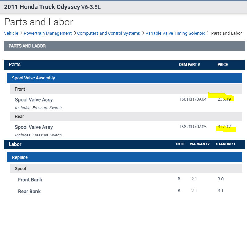

The solenoid is relatively easy to replace as you have already seen how it is done.
One thing to remember, on leaks of this nature you cannot really use a stop leak. Personally, I have not seen one that actually work, especially on newer vehicles.

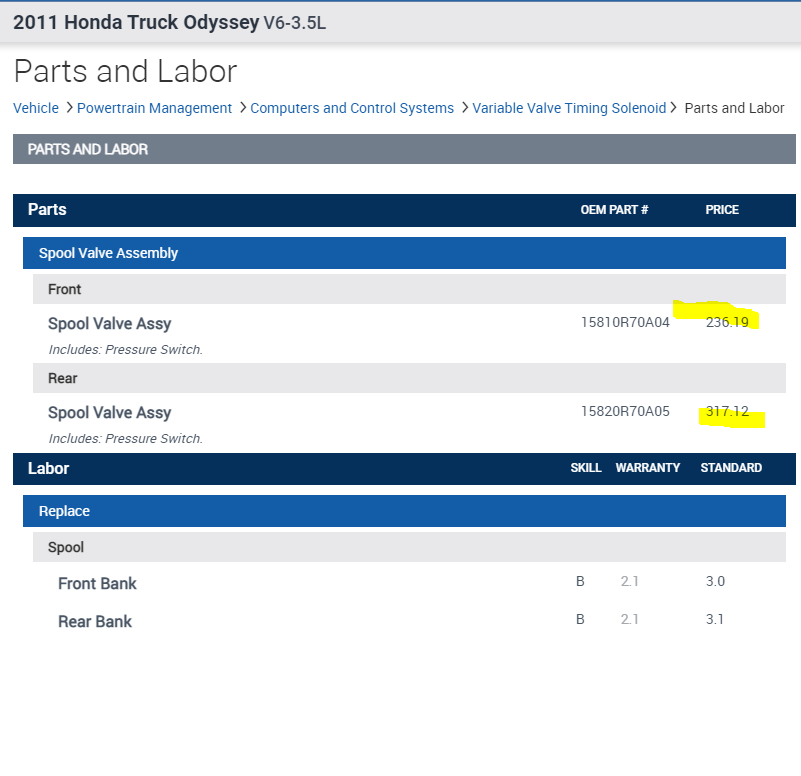

The reason why the dealer might have quoted you that price could be that the OEM replacement solenoid price is around $250.00 plus whatever labor they will charge you. The book does call for 3 hours. But as you might suspect it should not take that long with the right tools.
I have attached the OEM solenoid part number below.

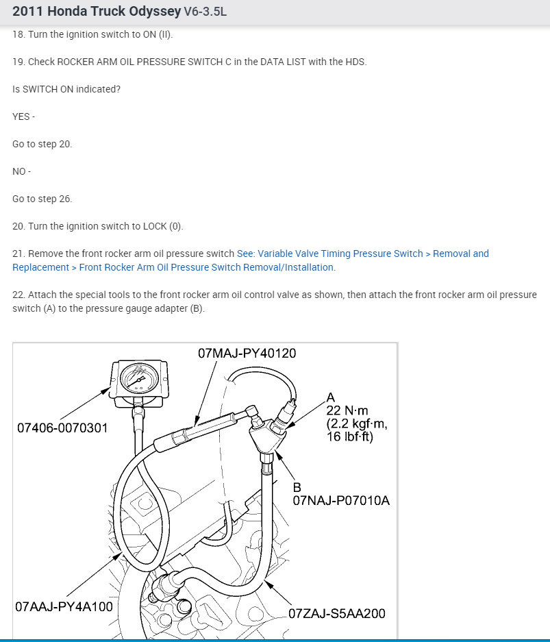

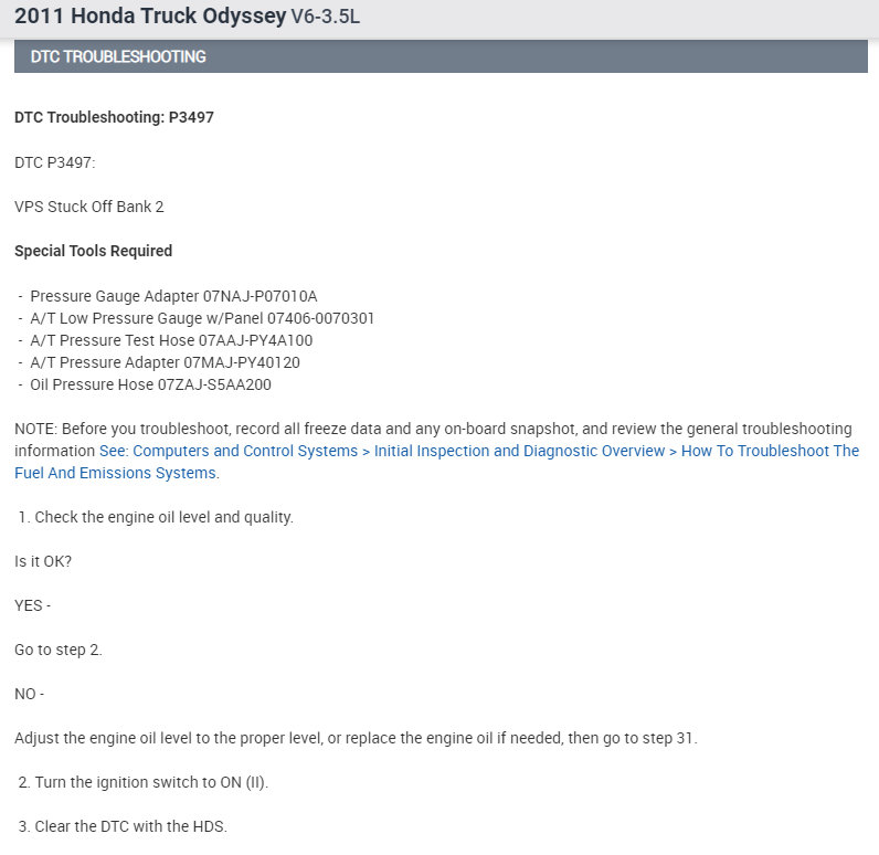

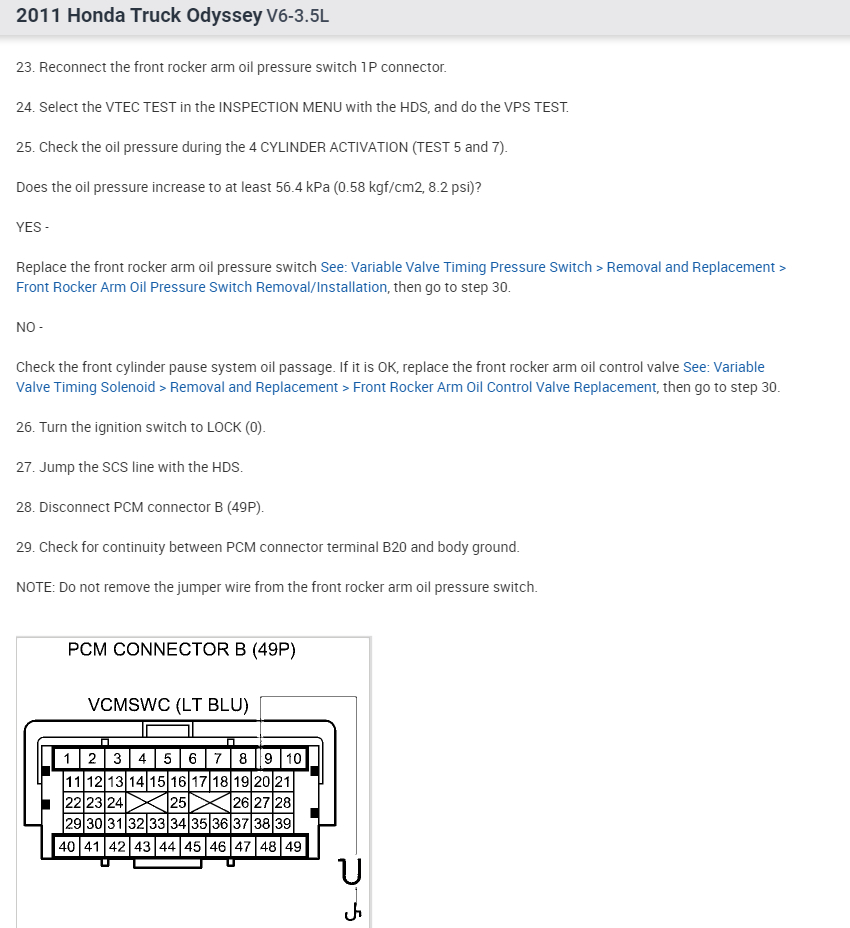

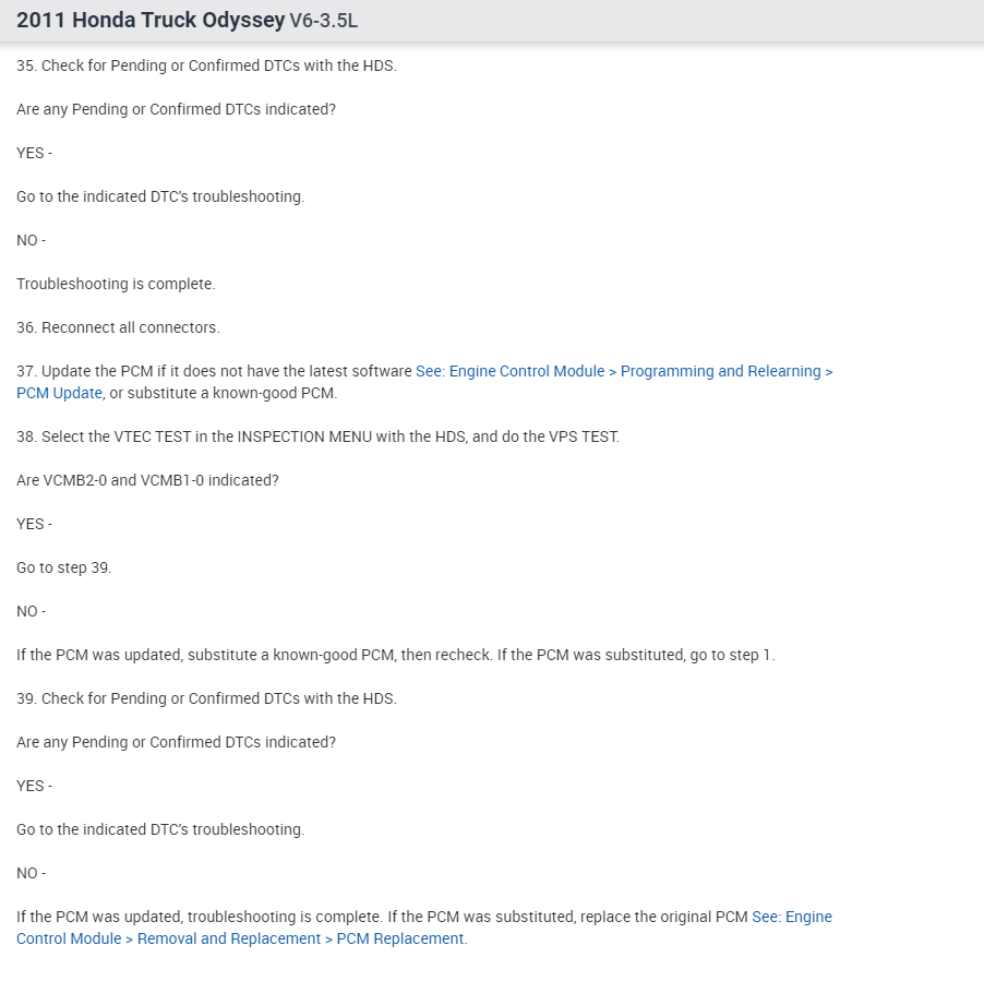

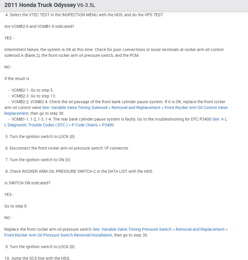

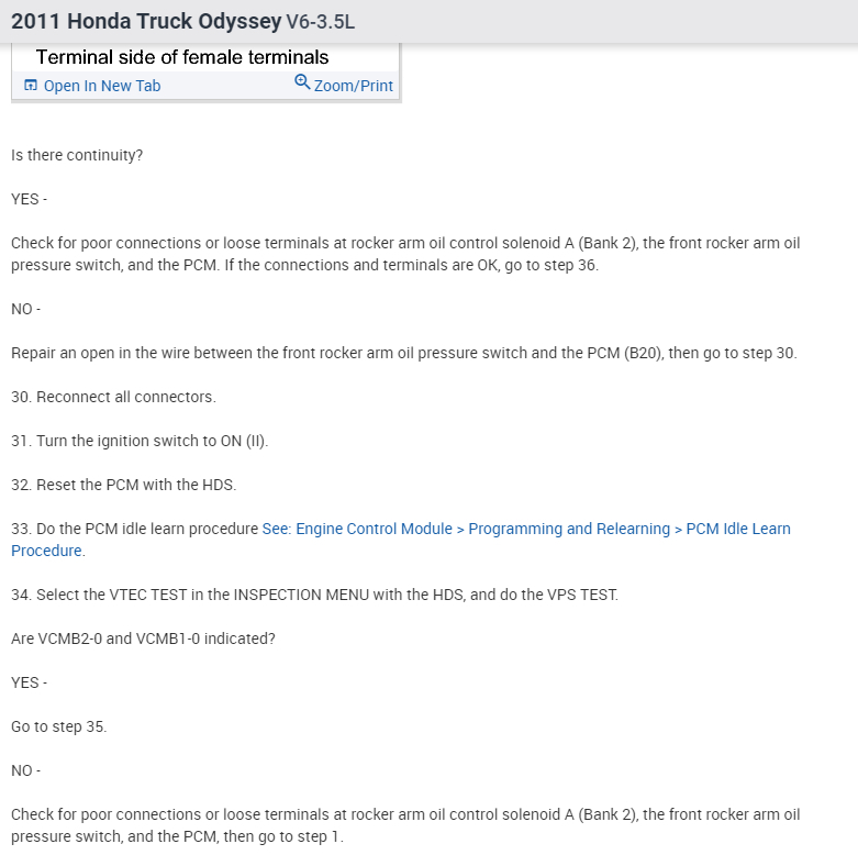

Well, everything has been going swell until today when my check engine light came on and I noticed it never went into ECO mode, even on the highway. Code scanner says it's P3497 cylinder deactivation system bank 2. I don't see any oil leak around the VTEC solenoid anymore, could it be the solenoid itself failing?
May 23, 2022 at 11:59 PM
SQM
  • 6,383 POSTS

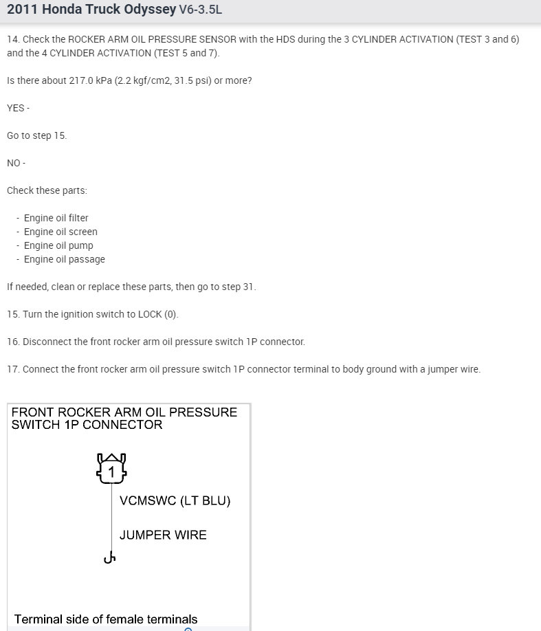

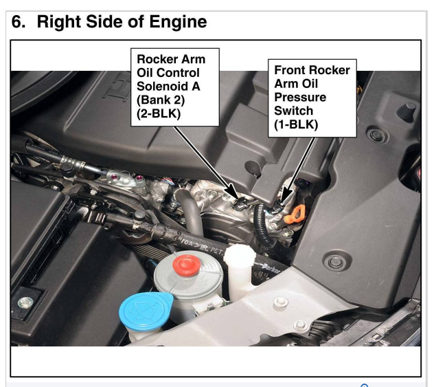

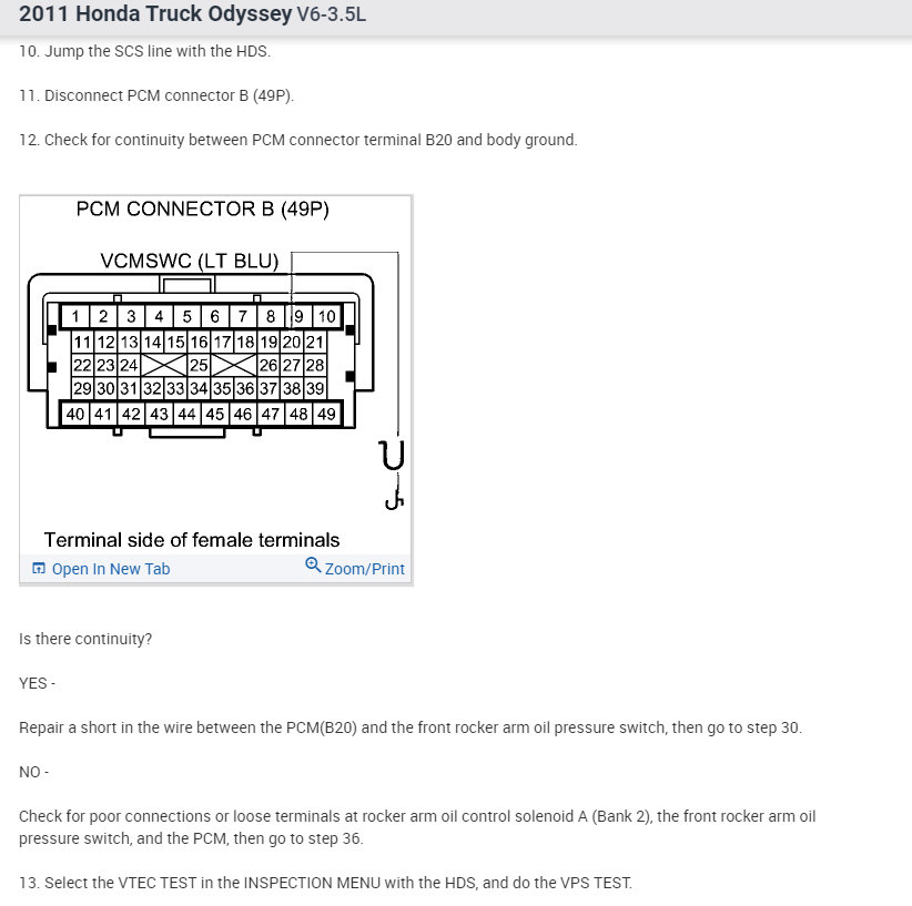

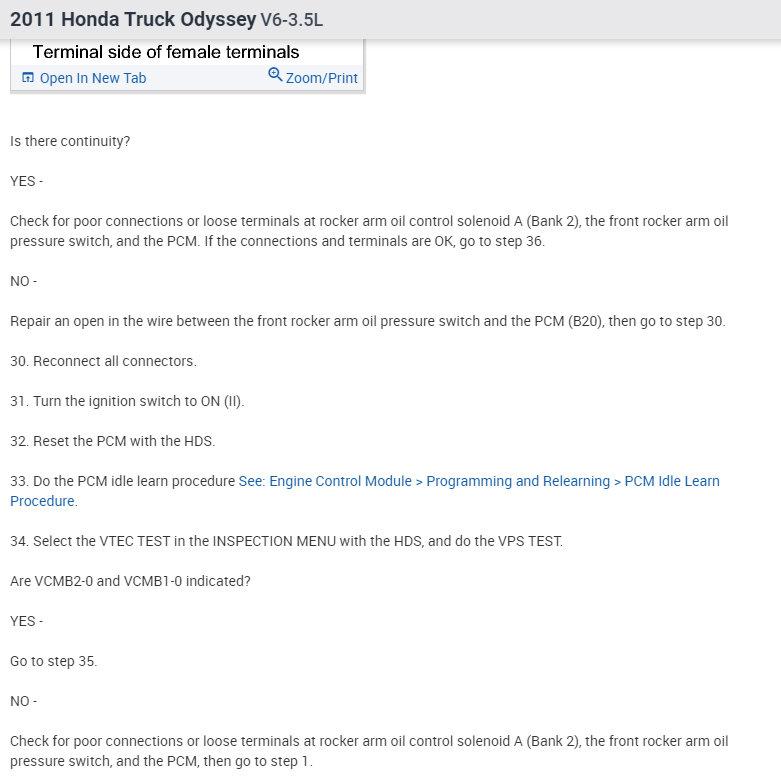

It is possible that the issue is to do with the solenoid. However, it could be a number of other factors.
I have attached the troubleshooting guide for the code P3497 below. Follow those steps as it can help you determine the issue.
Let me know what you find or if you have any questions.
May 24, 2022 at 3:56 PM
ETERNALARIANNE
  • 240 POSTS
Unfortunately, I do not have any of the tools listed there, only a basic code scanner. Is there another method I could use to test this? I cleared the code and cranked the engine and the CEL did not come back. If it helps, I was on the highway speed up to 65MPH when the light came on...
