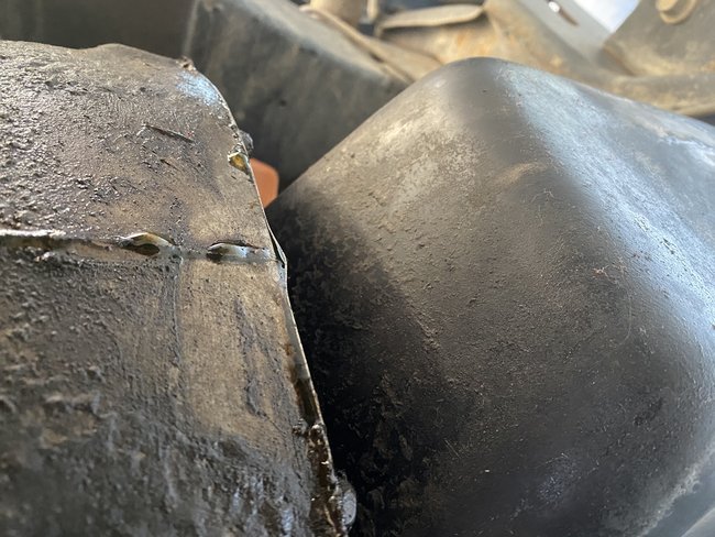

I have an oil leak come from the area in the picture. not sure what it is called or what I need to go about fixing it. we appreciate any help. thanks

Sorry here’s the photo:
Mar 15, 2021 at 8:13 PM
Okay, this could be from either the back of the intake manifold or the rear main oil seal.
Get a good look at the back of the intake to see if it is leaking down the back.

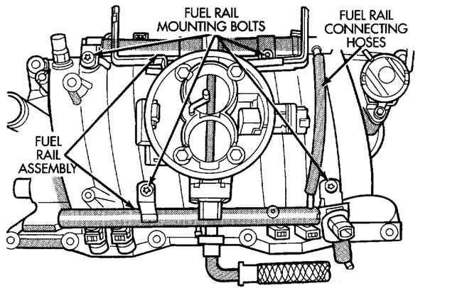

Throttle Body Assembly
16. Remove the throttle body bolts and lift the throttle body off the intake manifold. Discard the gasket.

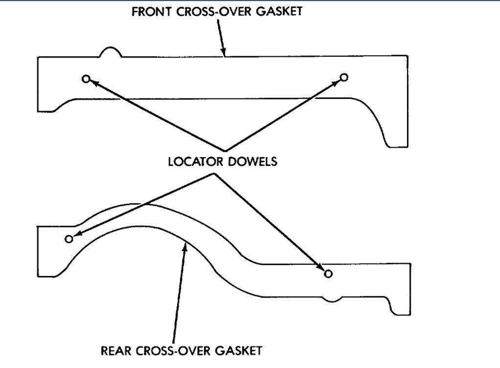

Cross-Over Gaskets And Locator Dowels
3. Place the 4 plastic locator dowels into the holes in the block.
4. Apply Mopers Silicone Rubber Adhesive Sealant, or equivalent, to the four corner joints. An excessive amount of sealant is not required to ensure a leak proof seal. However, an excessive amount of sealant may reduce the effectiveness of the flange gasket. The sealant should be slightly higher than the cross-over gaskets, approximately 5 mm (0.2 inch).
5. Install the front and rear cross-over gaskets onto the dowels.

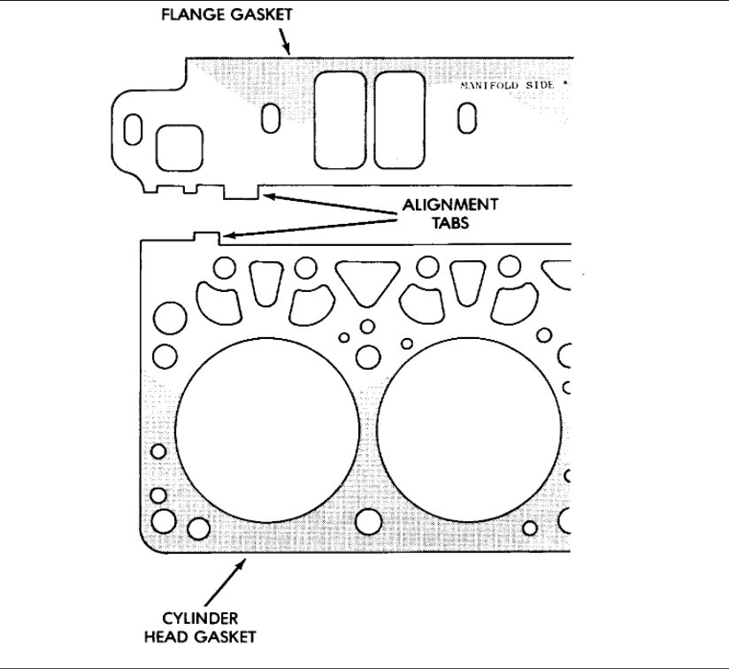

Intake Manifold Flange Gasket Alignment
6. Install the flange gaskets. Ensure that the vertical port alignment tab is resting on the deck face of the block. Also the horizontal alignment tabs must be in position with the mating cylinder head gasket tabs. The words MANIFOLD SIDE should be visible on the center of each flange gasket.
7. Carefully lower intake manifold into position on the cylinder block and cylinder heads. Use the alignment dowels in the cross-over gaskets to position the intake manifold. After intake manifold is in place, inspect to make sure seals are in place.

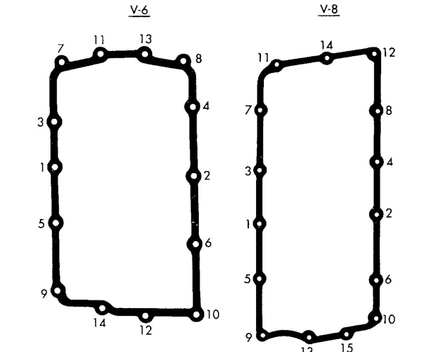

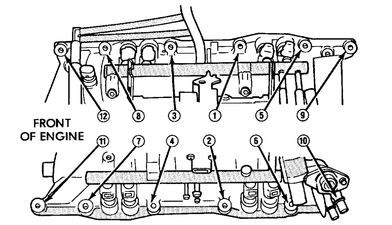

Intake Manifold Bolt Tightening Sequence-V-8
8. Install the intake manifold bolts and tighten as follows:
- Step 1-Tighten bolts 1 through 4, in sequence, to 8 Nm (72 inch lbs.) torque. Tighten. in alternating steps 1.4 Nm (12 inch lbs.) torque at a time.
- Step 2-Tighten bolts 5 through 12, in sequence, to 8 Nm (72 inch lbs.) torque.
- Step 3-Check that all bolts are tighten to 8 Nm (72 inch lbs.) torque.
- Step 4-Tighten all bolts, in sequence, to 16 Nm (12 ft. lbs.) torque.
- Step 5-Check that all bolts art tighten to 16 Nm (12 ft. lbs.) torque.
