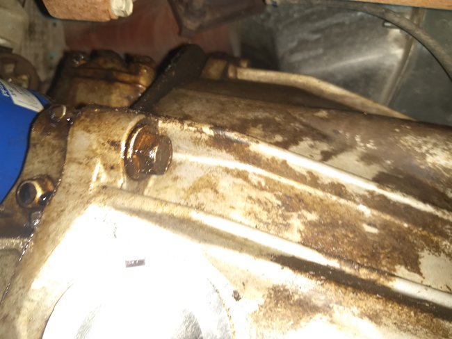

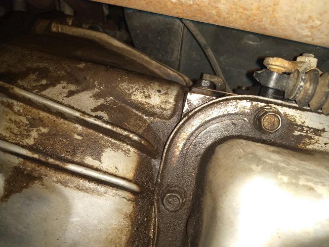

I just bought this vehicle from a Chevrolet dealer and drove it about two weeks and it said low oil when I was pulling a s10 Chevrolet truck about ten miles. So I added oil drove for about another week or so and said low oil again. So I parked it in the garage and noticed oil spots on the ground. What could cause this and what would it cost to fix? Also, I had a friend tell me he saw blue smoke when I started it up. I have not had a chance to see the blue smoke.

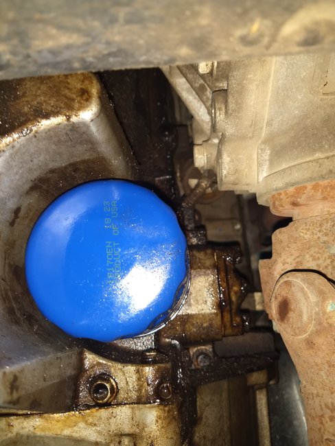

I looked under the truck is seems to be coming somewhere around the oil filter.
Dec 1, 2018 at 10:41 AM

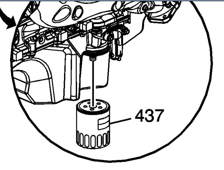

Check the oil filter and see if it is tight and that it does not have a double gasket. Common issue.

I also do not see it actually leaking just oily around the housing unit.

When they change the oil there are times the old gasket from the oil filter sticks to the housing and when the new one is installed, it doubles and leaks.
The oil pan is around there as well.

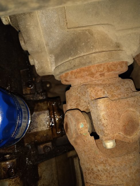

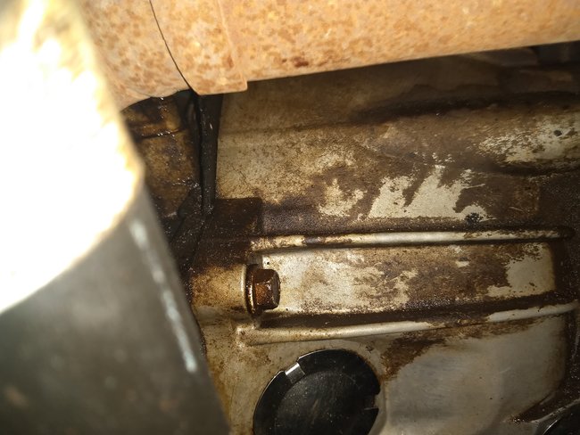

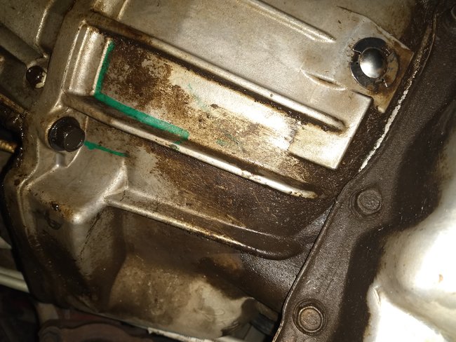

This is all after I gave it a little wipe down.
Dec 1, 2018 at 11:05 AM
That is your leak at the oil filter.
Spray that down with a can of brake kleen. Then run the engine and watch for the leak so you can pin point it.
