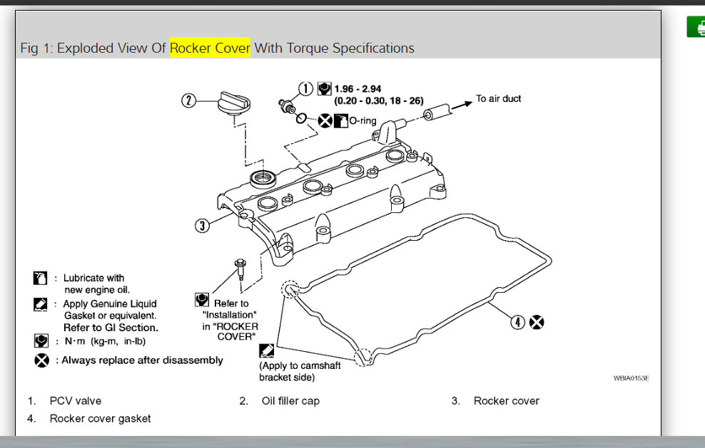

I've changed the spark plugs the valve cover and valve cover gasket and oil is still getting in my spark plug wells only when i make a complete stop that it hesitates no engine light. i am lost don't know what it could be.

I would double check the valve cover gasket. It almost certainly has to be coming from there. The only other thing it could be is a cracked cylinder head in the well itself, and I would find that extremely unlikely. Please let us know what you are able to find out.

When i ask the mechanic if he could put permatex on the gasket he said it didn't need it. i think that is what the problem is because the valve cover comes with seals for the spark plug wells.

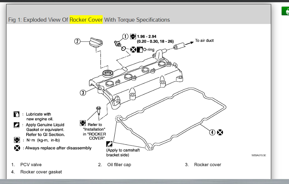

Sorry I didn't get this the first time, but Im glad that you asked that question because in the Nissan Factory Rocker Cover Gasket Exploded Diagram that I have sent you in the diagrams down below it says that RTV is to be used when installing the gasket. Please keep us informed on how things are progressing.
