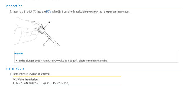

Just a heads up, the mileage of my car is in Km. This car burns through oil like it has stock in Castor Oil or something. The dealership said the engine would have to be taken completely apart to find out what's wrong. At that time, it was going through about 3/4 of a liter of oil every two weeks and I was putting on a lot more mileage. The burning has gotten worse, to the tune of about 3/4 liter every 400-500 KM. My question is - is it worth it with this many Km to spend $1000's of dollars rebuilding/replacing the engine? It is now clogging up by catalytic converter.

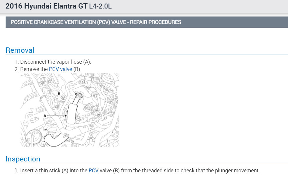

Also, it could be the PCV valve needs to be replaced, here is the location and how to replace it in the images below. Check out the images (below). Please let us know what happens.
