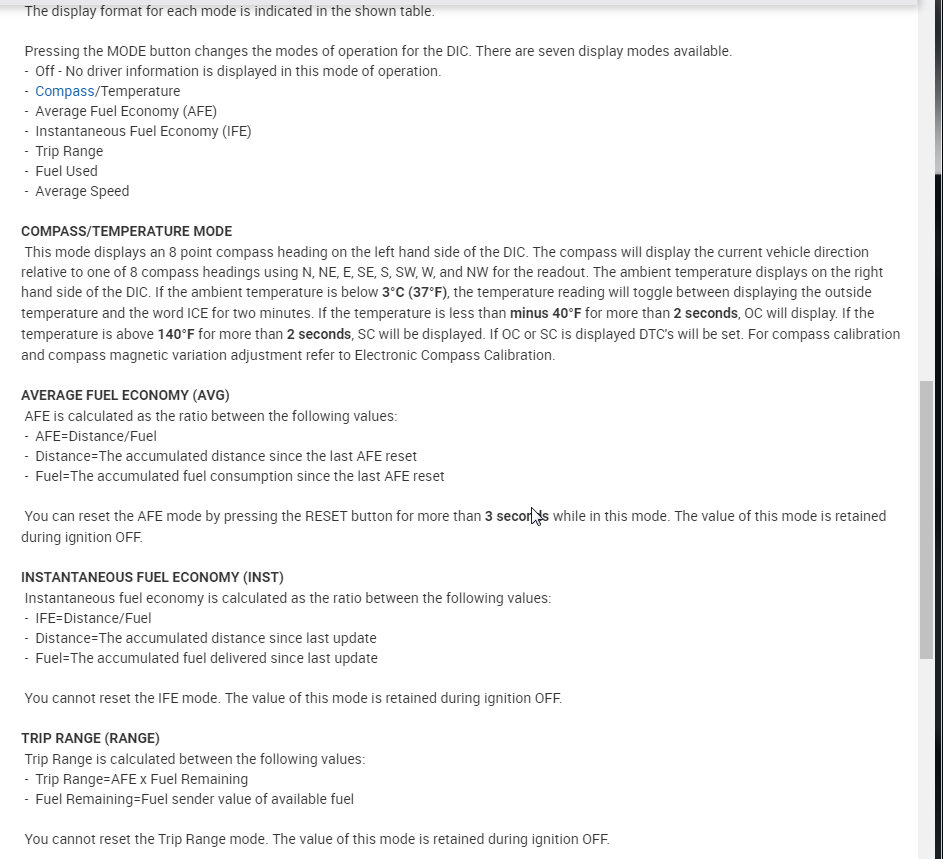

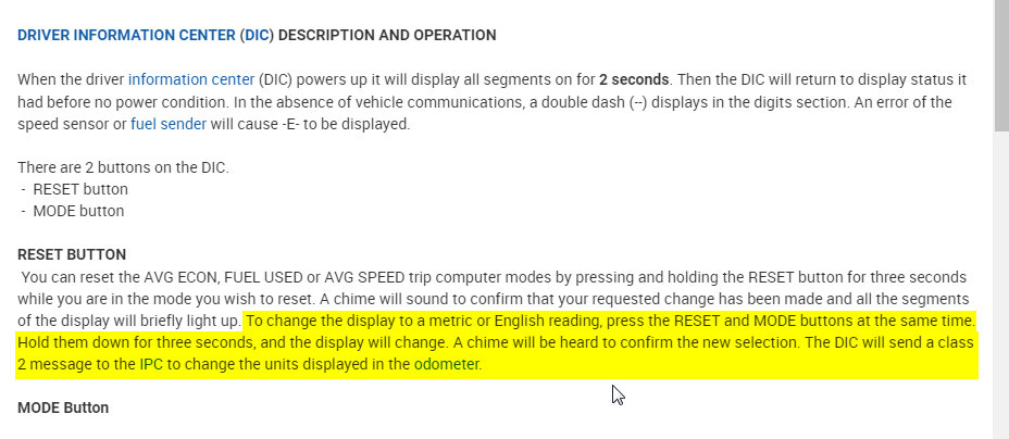

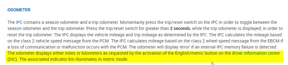

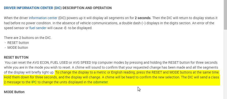

How do you change the odometer from reading kilometers to reading miles?
Nov 27, 2019 at 6:42 PM

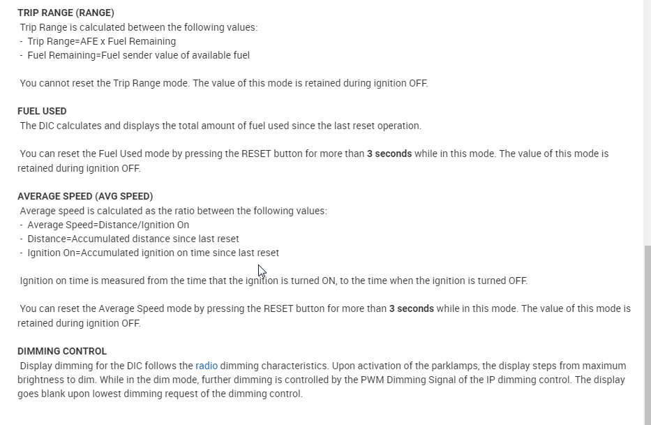

I attached the procedure on how to switch between metric and English. This will change the odometer display as well. Let me know if you have questions. Check out the diagrams (Below). Please let us know if you need anything else to get the problem fixed.
Nov 27, 2019 at 10:34 PM

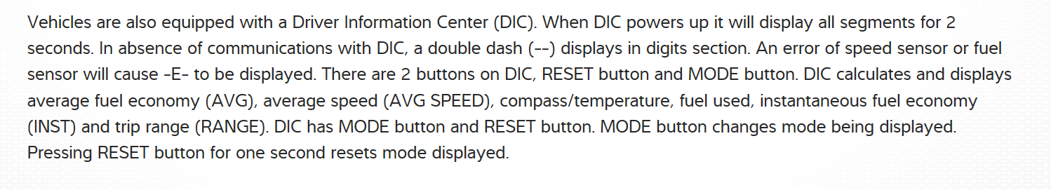

WILLIEAB
My 1996 Chevrolet Impala was put in the shop for brake repair while I was working overseas. When I returned home and drove the car, the odometer is reading in kilometers. How do I reset the odometer to read mph?
Jan 18, 2021 at 2:24 AM (Merged)
  • 110,248 POSTS
These are all different, so hang in there with me. If you press the trip odometer button, does it give you options or things to select from? Is there an information center in your vehicle?
WILLIEAB
My instrument cluster does not have a trip odometer button. The cluster has a solid face. What are you referring to as a information center?
  • 110,248 POSTS
On some of these vehicles, they have an info center. It details mileage, trip, and just about anything you can think of. That is where some are reset.
