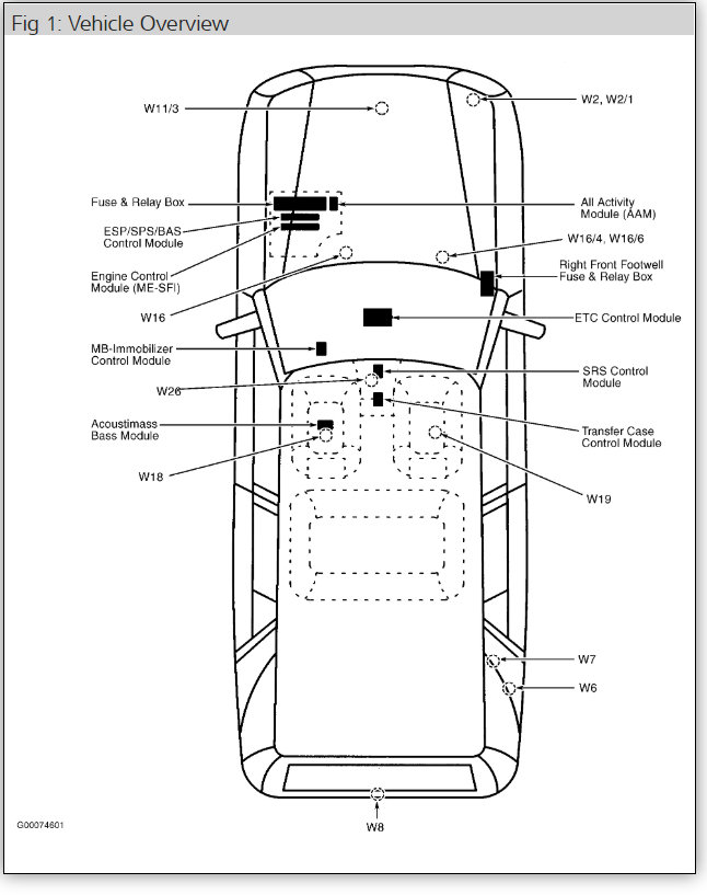

The fuse box is attached to the AAM module, the AAM module is responsible for communication, most likely there might be water or corrosion in the AA. Take it apart and check for water and or corrosion, if none found you will need to check continuity from the OBD port to the AAM and then possible replace the AAM.

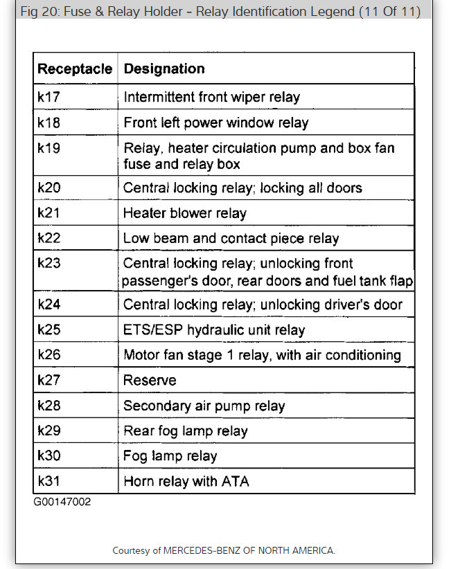

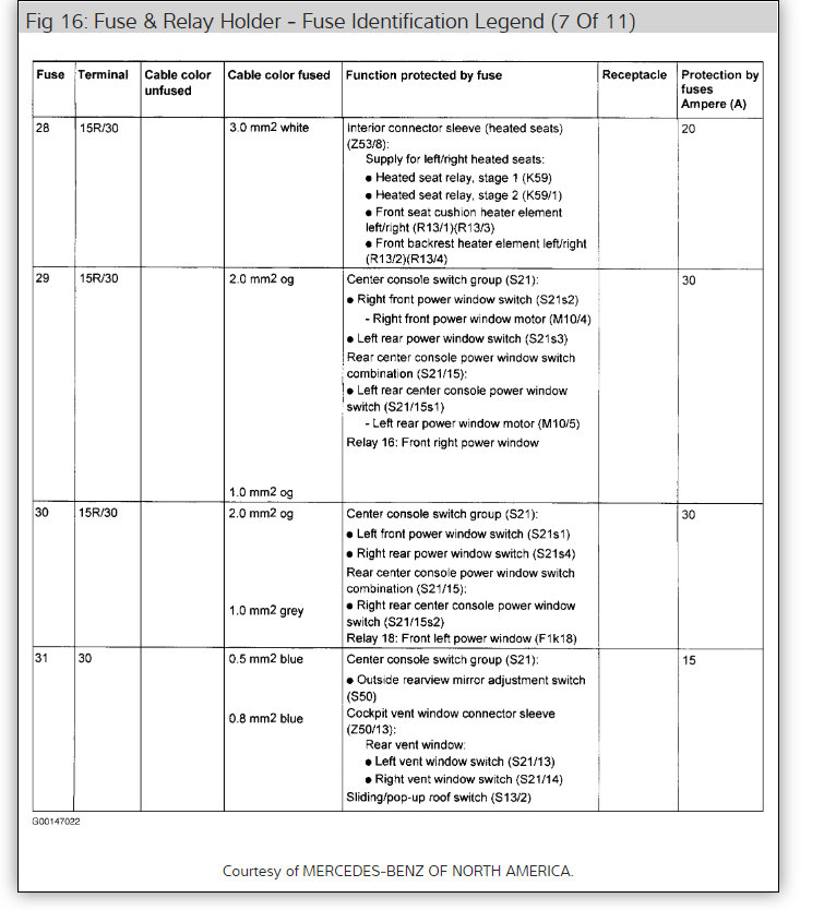

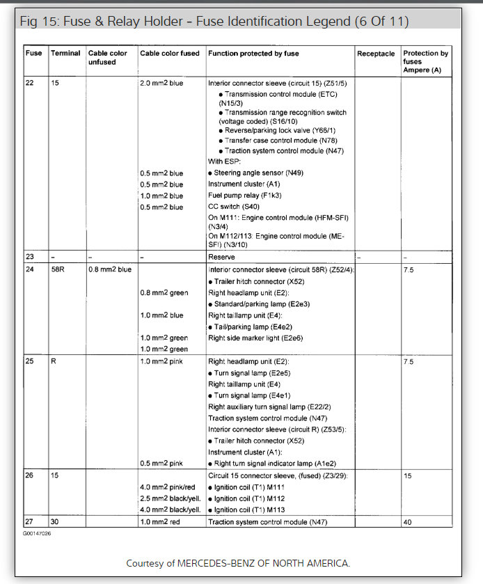

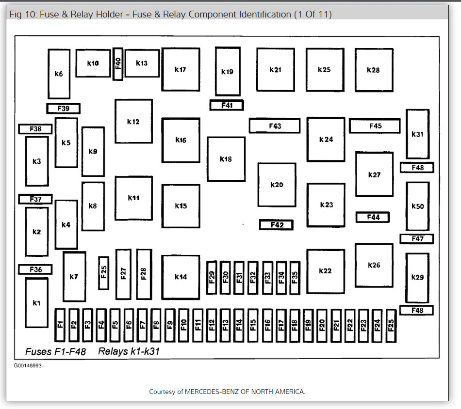

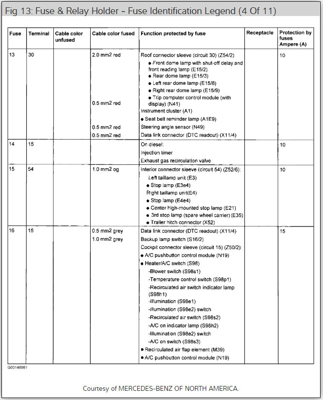

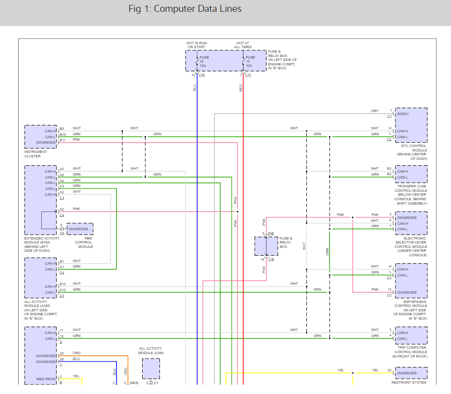

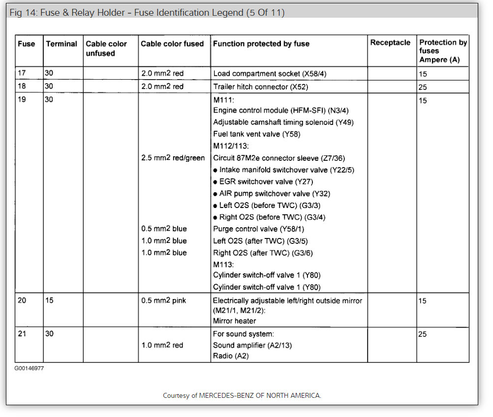

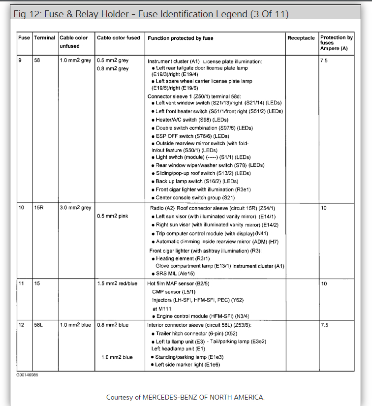

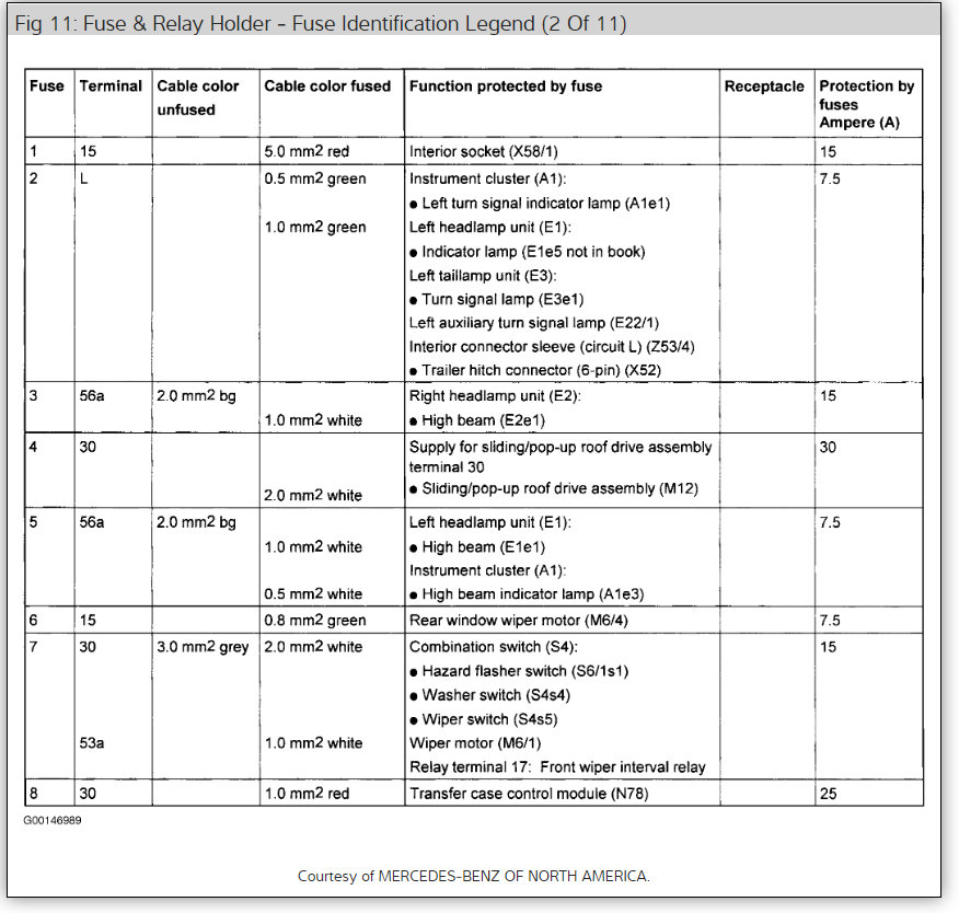

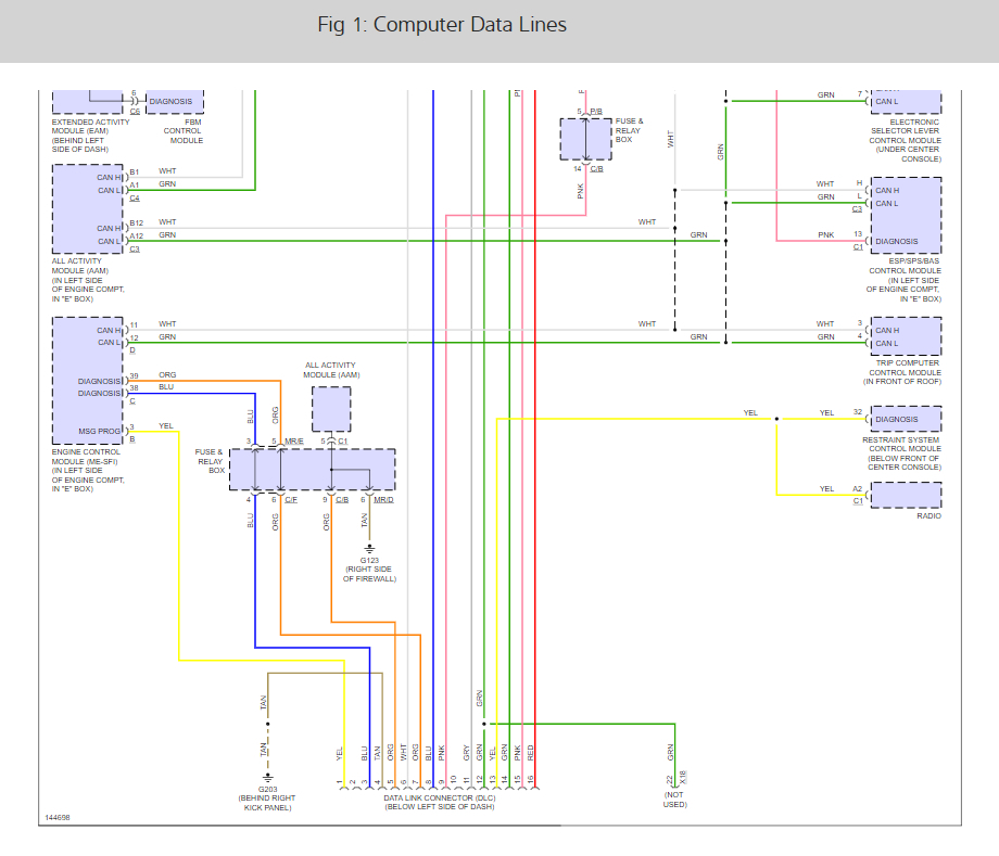

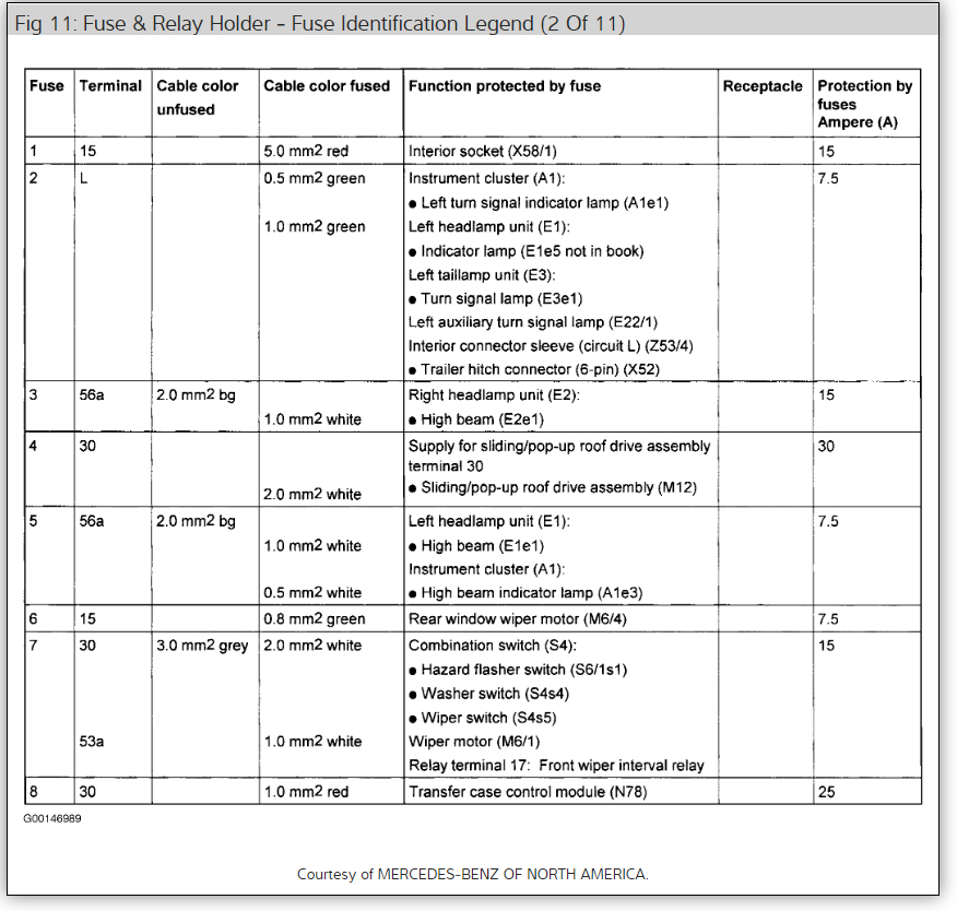

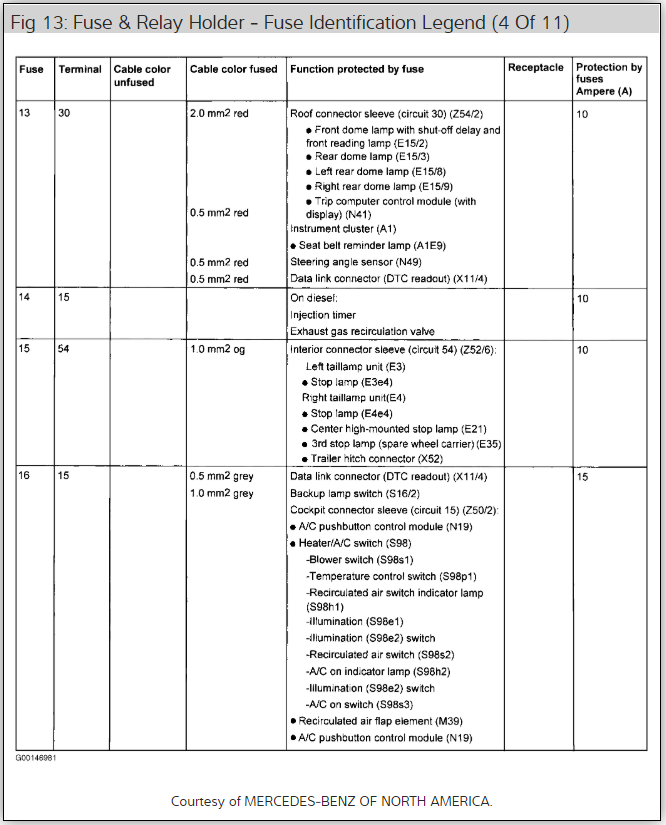

Can we check for power at fuse # 22 and #13. Here is guide to help you and the ALDL connector wiring diagrams so you can see how the system works:
Check out the diagrams (below). Please let us know what you find.
Dec 4, 2018 at 12:19 PM
PETER HOU
  • 10 POSTS
Ken,
Thank you,

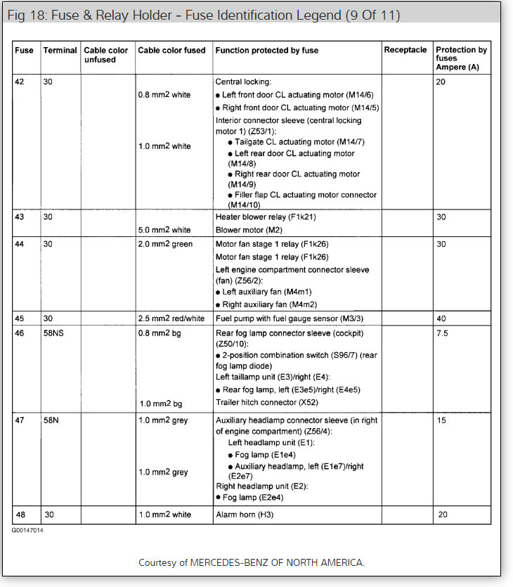

I rechecked all of fuse with key in 2, did as your link, all fuse are good, only F47 there is no power.
I am going to check headlamp housing, if the fog sockets have bad connection.
Anything else I should check over?
Peter
Dec 5, 2018 at 10:49 PM
  • 54,840 POSTS

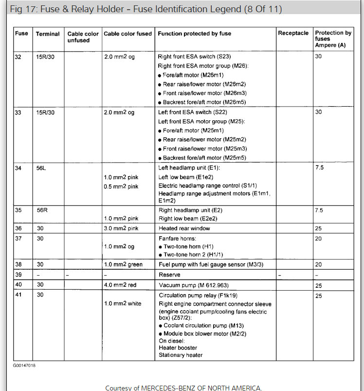

Did you test #47 with the lights on? Has nothing to do with the non communication. What about fuses # 22 and #13?
Dec 6, 2018 at 9:39 AM

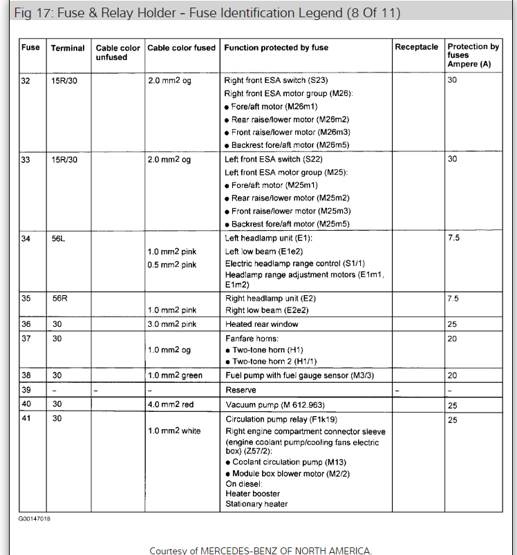

PETER HOU
  • 10 POSTS
Hi, Ken,
All fuses are good, voltmeter made beep sounds at both ends of each fuse, including 22 and 13, except #47 (front fog lamp). I turned the switch rod to the fog position no lights on, I believe it should be yellow lights. So, I think maybe there is a bad connection? What do you think?
Dec 6, 2018 at 12:12 PM
  • 54,840 POSTS

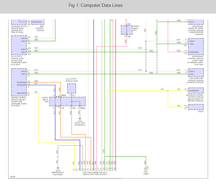

Yes, it does sounds like a bad connection to the ALDL connector. Here is a guide to help you run some test use the wiring diagrams above:
Dec 7, 2018 at 9:00 AM

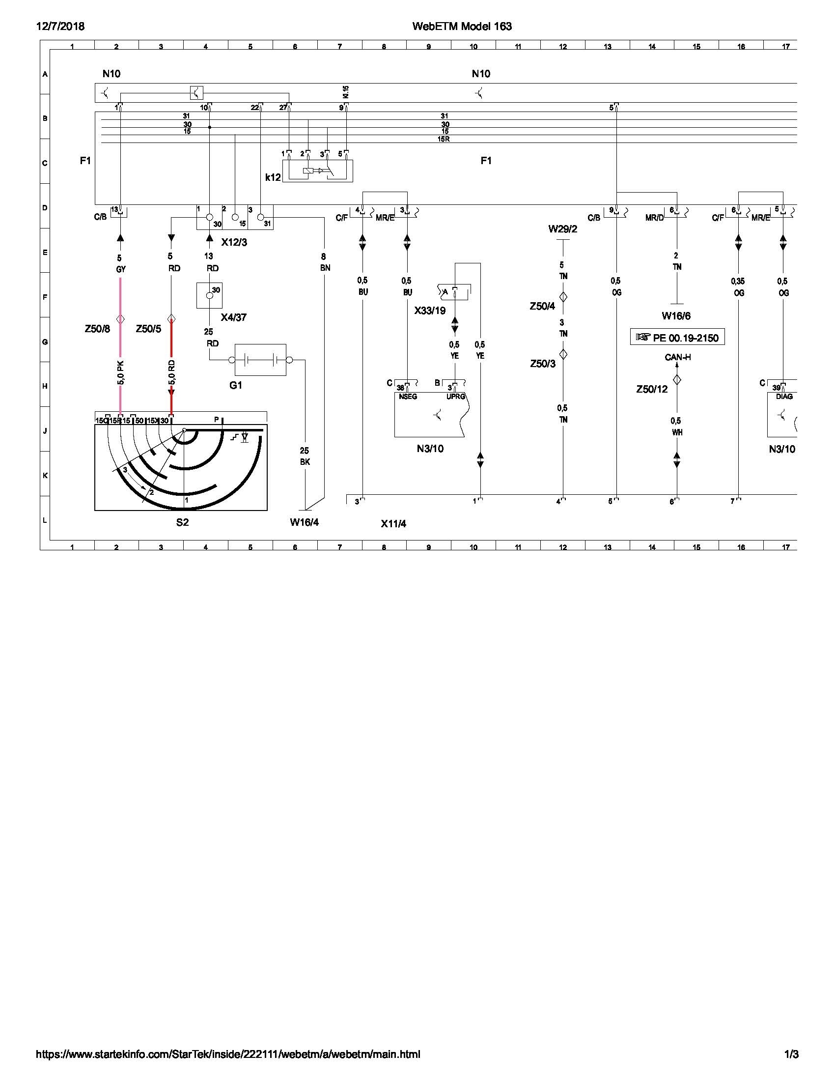

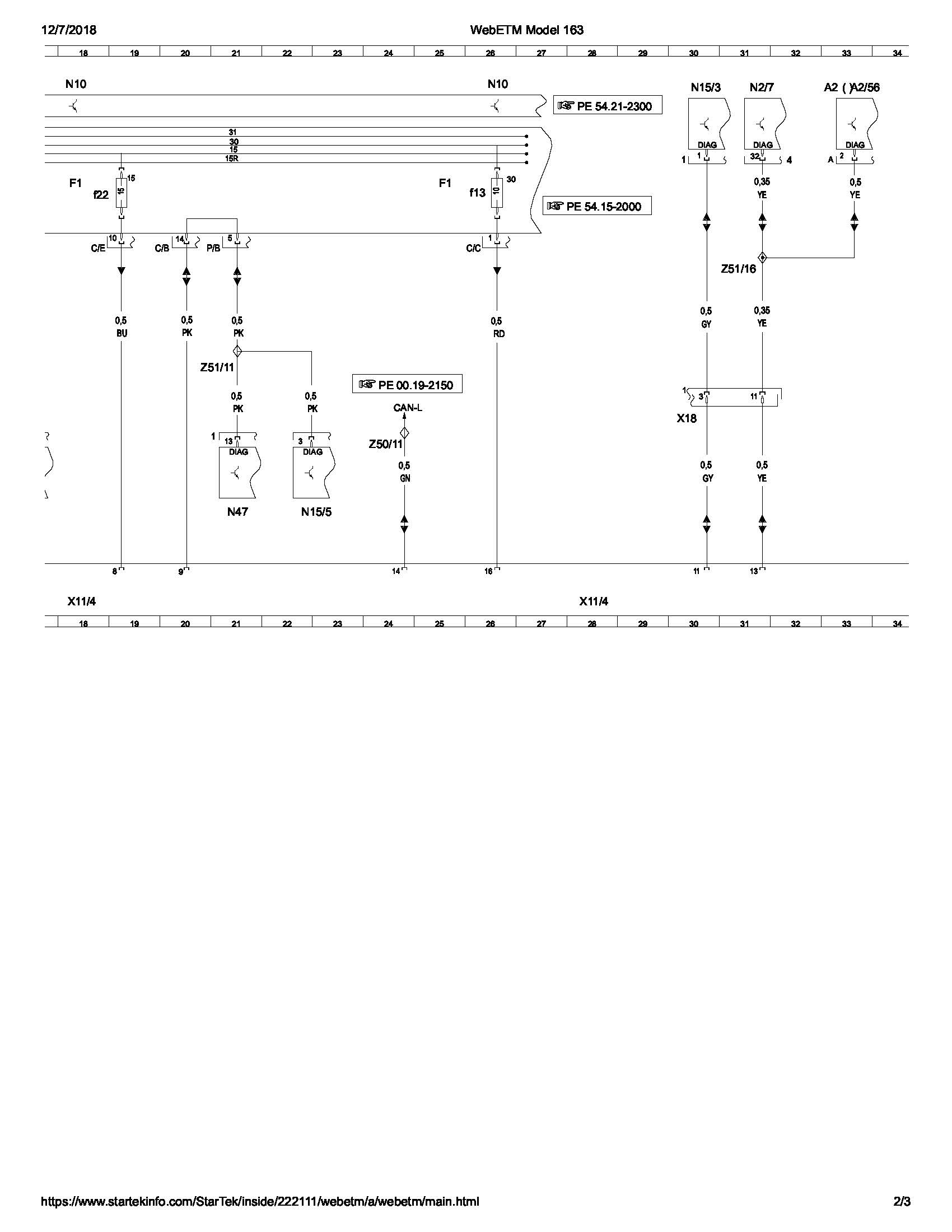

LOU P
  • 118 POSTS
Peter, what kind of scan tool are you using?
On our OBD port the AAM handles most of the communication but if you are using a generic scan tool you are only accessing the engine module and the engine module can be the issue.
You need a Mercedes capable scan tool such as the icarsoft or startool found at www.mbstartool.com
or a high end Snap on or Matco.
With Mercedes there is no such easy task as no communication.
Having power at the OBD port is just a fraction of the things that need to be present.

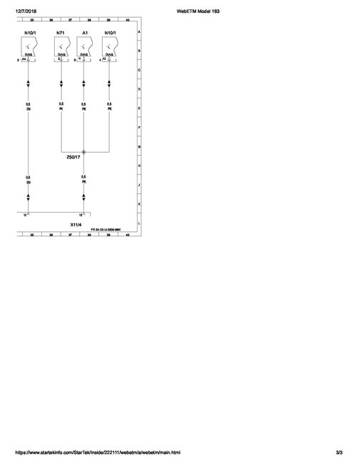

The wiring diagrams for the ML also changed every year so I would need the build date to get you the correct diagram for the car.
Also the diagrams are not easy to read if you are not familiar with them.
Here attached is the one for the 2000 built between 11/99 and 9/00.
Hope this helps.
It might be best to take this in, based on your replies you are shooting in the dark with your testing and it might be best. It can save you time and money having someone with Mercedes knowledge assist with this.
Lou

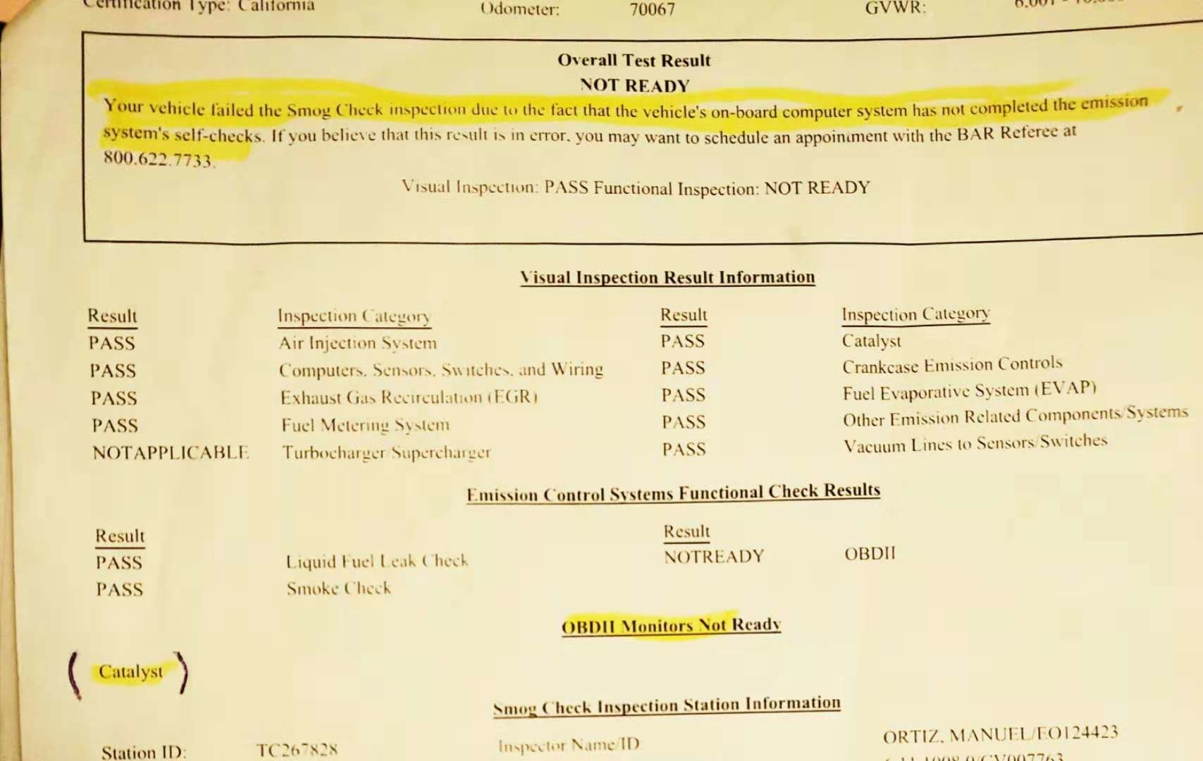

PETER HOU
  • 10 POSTS
I should first post the smoke check report. So, can know what I am talk about and what should I do about it. See the picture.
Dec 7, 2018 at 10:16 PM
  • 54,840 POSTS
It looks like the monitors are not ready, so is this the problem? Have you had the codes cleared? Does a scanner read the computer?
Here is a guide:
Let us know, Ken
Dec 8, 2018 at 10:18 AM

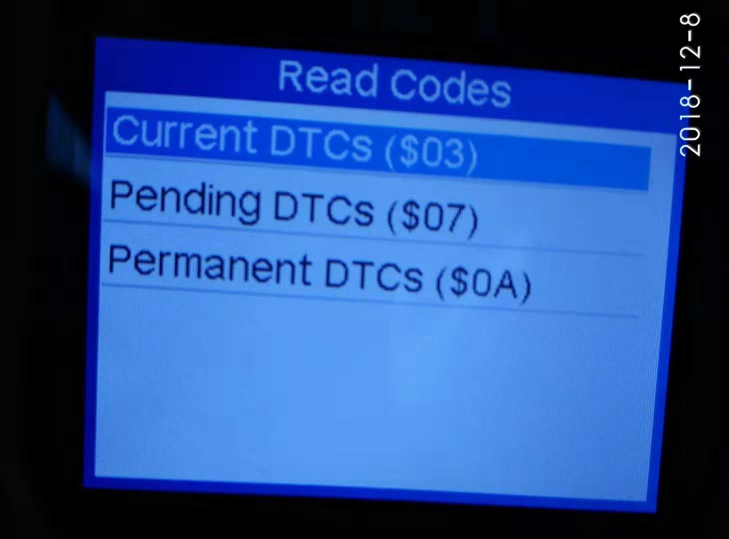

PETER HOU
  • 10 POSTS
Hi, Ken,

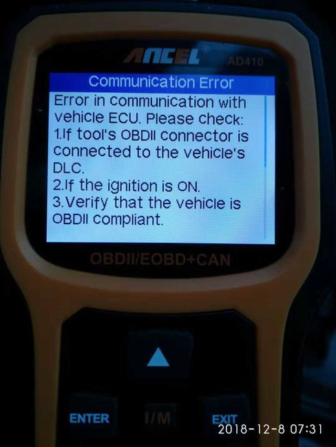

OBD II can be powered on.
Check engine light can be on with all other lights when key in position 2.
There no codes showed. (Visual Inspection PASS ?)
"There no communication to ECU ",
(see picture from OBD II Ancel AD410, as well as from O'Reilly Auto Parts's OBD II Botch.)

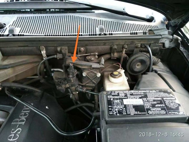

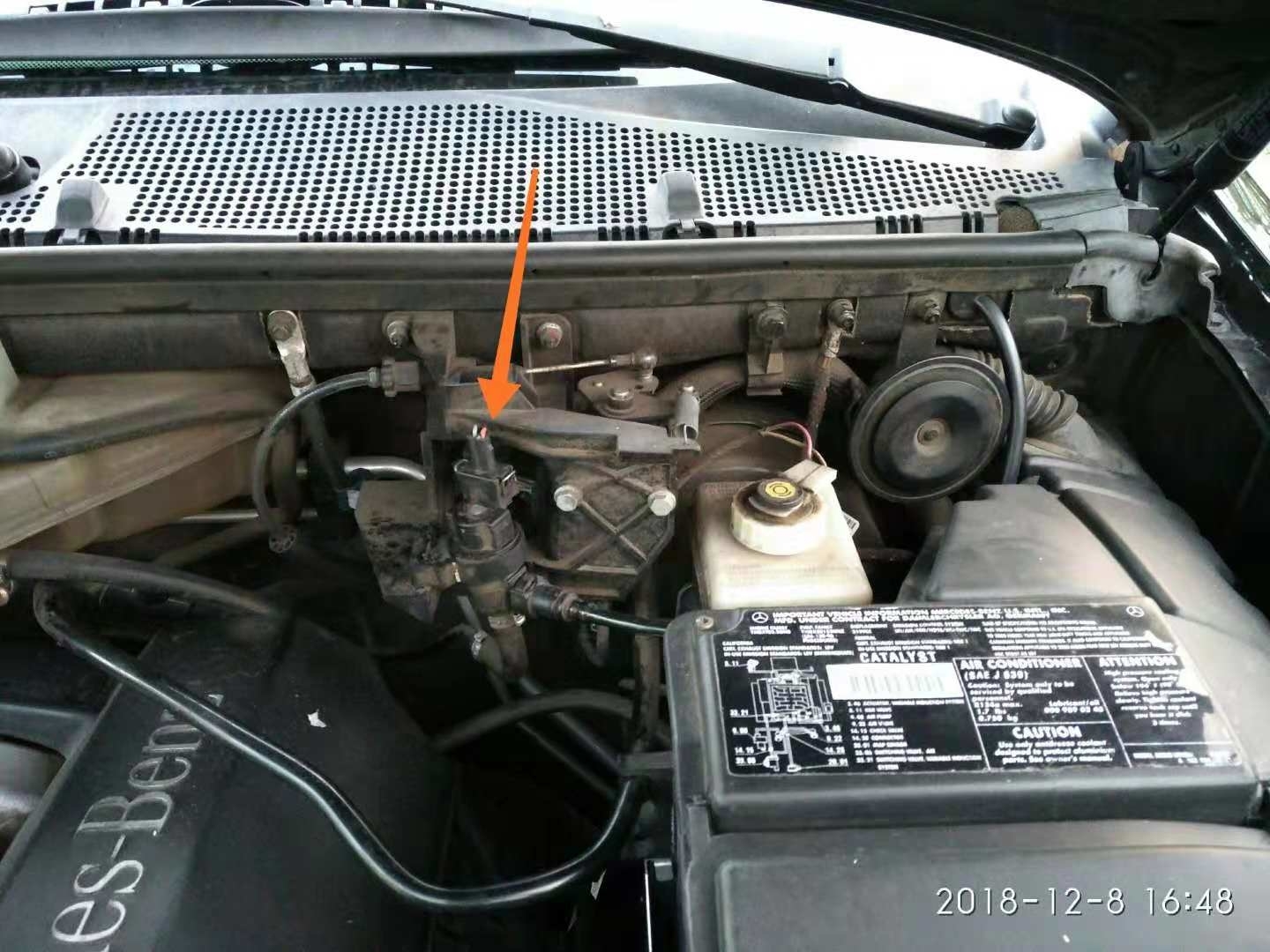

PETER HOU
  • 10 POSTS
Hi, All,
Is the communication successful? I did not see my OBD II show the lines before.
If it is, that means I fond it !
The wire is bad.

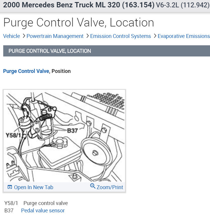

What is the part's name?
See two pictures,
Thanks all.
Dec 8, 2018 at 9:10 PM
  • 54,840 POSTS
That looks like an EVAP system control solenoid. Remove the unit it should have a part number on it. Nice work fixing the communication problem.

PETER HOU
  • 10 POSTS
I want to confirm it if it is the problem, let O'Reilly Auto Parts store to OBD II scan again, unfortunately was showed communication fail.
And I checked it at home with key in position 2,
OBD II show the DTC again :
Review DTC >
Pending DTC's ($07) >
P0443 EVAP System Purge Control Valve A Circuit
Hi, Ken,
Should I replace the EVAP Purge Solenoid Control Valve ?
Dec 10, 2018 at 12:11 PM
  • 54,840 POSTS
Yes I would replace the purge solenoid and then clear the codes. Here is the location below.
Dec 11, 2018 at 11:29 AM
