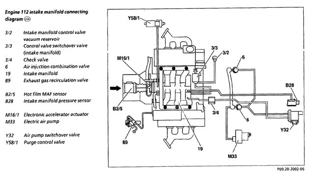

The fan belt broke on my 2000 ML320. After replceing it I found a small "L" shaped vacuum hose (about 1/4") but can't find where it goes. The check engine light came on about 50 miles after replacing the belt. Is there a vacuum hose diagram or can you tell me where to look or where it might belong?
Jun 22, 2009 at 8:31 AM
  • 54,849 POSTS

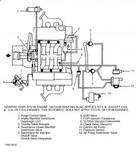

I found this engine vacuum diagrams for you.
https://images.2carpros.com/forum/automotive_pictures/261618_Graphic_48.jpg
Here is a larger version (below) Please let us know if you need anything else to get the problem fixed.
