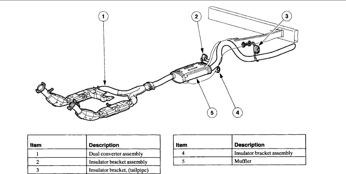

Hi, how many hangers do I have for my exhaust?
Monday, November 4th, 2019 AT 1:17 AM
MECHANIC
52,797 POSTS
3. I attached a picture.

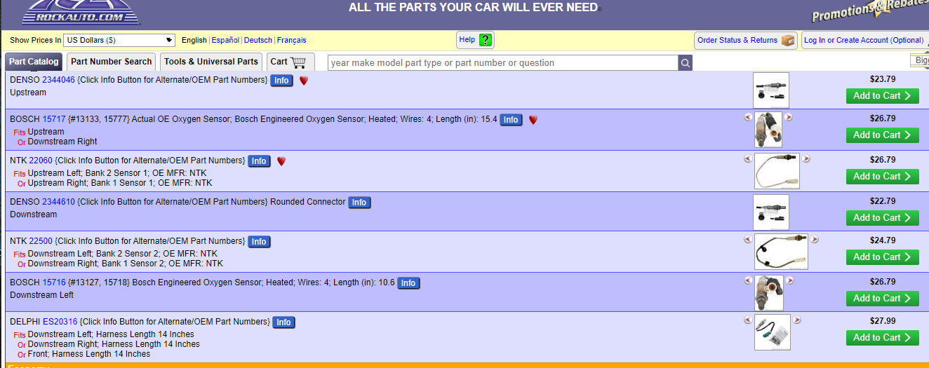

Yes, can you tell me which 02 sensors go where OEM? I have a blue, white green and purple one. Please let me know.
SPONSORED LINKS
Sunday, November 17th, 2019 AT 2:24 PM
CHRIS KINARD
MEMBER
83 POSTS
The people at these auto stores are newbies. So I rather get a professionals answer.
Sunday, November 17th, 2019 AT 2:26 PM
MECHANIC
52,797 POSTS
Okay, I attached rock auto site. It has the location of the sensor and the numbers for you.
Image (Click to make bigger)
Sunday, November 17th, 2019 AT 2:34 PM
CHRIS KINARD
MEMBER
83 POSTS
Heck ya! Thank you a lot.
