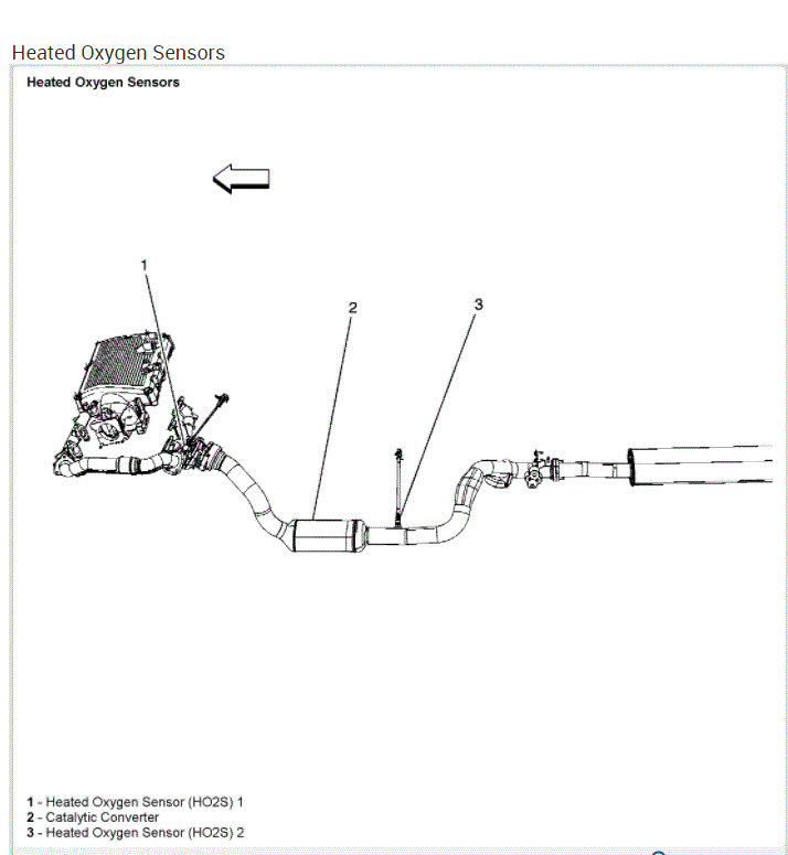

where are the O2 sensors located?
Oct 11, 2020 at 10:59 AM
  • 110,244 POSTS
I attached a pic below. See if it helps and let me know if you have questions.
This guide can help you step by step to change out the sensors:
https://www.2carpros.com/articles/how-to-replace-an-oxygen-sensor
Oct 11, 2020 at 11:28 AM
GONZALO AGUDELO
Thanks very helpful Question did I need to change both?
Oct 14, 2020 at 7:50 AM
  • 110,244 POSTS
First, you are very welcome. As far as replacement, the diagnostic trouble code that was retrieved should indicate which one is the issue. By any chance, do you remember what the code was that was found? In most cases, both do not need replaced at the same time.
