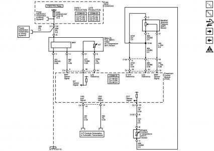

2005 Buick Terraza IAT SENSOR PLUG
2005 BUICK TERRAZA
65,000 MILES • 6 CYL • 2WD • AUTOMATIC
TOMB
I NEED TO KNOW WHICH WIRES GO TH THE IAT SENSOR IN THE AIR INTAKE
Dec 14, 2007 at 6:29 PM
DENNYP
  • 1,824 POSTS
Tan/Black wire goes to terminal D on the IAT connector, and to connector C3 terminal26 on the PCM. Tan wire goes to terminal E on the IAT connector, and to connector C3 terminal 50 on the PCM.
