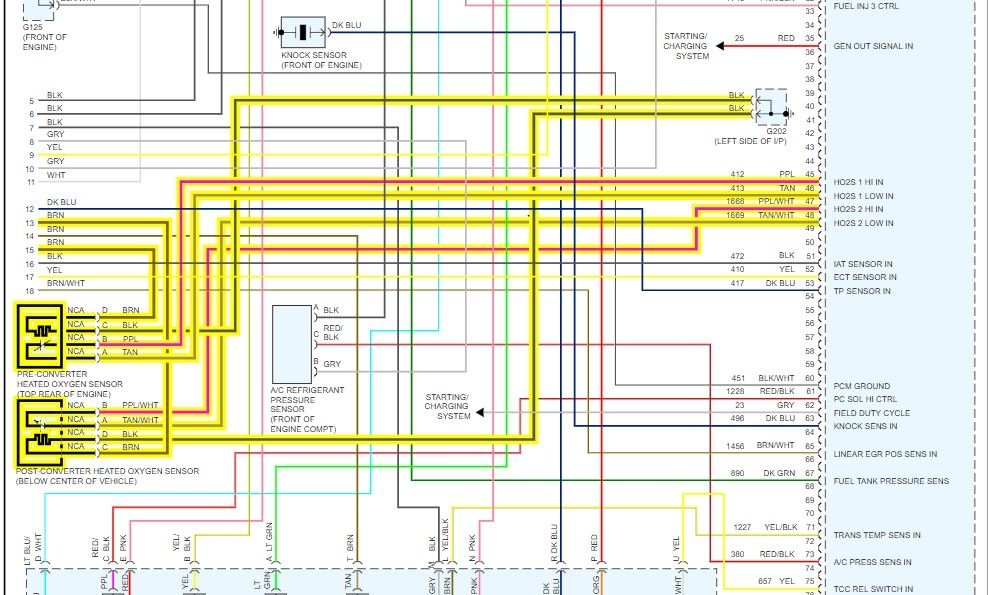

Trying to find the sensor inside the exhaust manifold/crossover specific to the Sfi 3100 V6 and also the wiring to the sensors.
Saturday, May 8th, 2021 AT 1:23 PM (Merged)
  • 52,797 POSTS

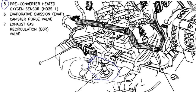

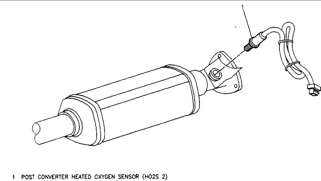

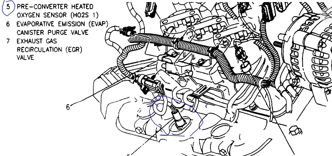

Good afternoon,
I attached pictures of the location for the upstream and downstream O2 sensors.
https://www.2carpros.com/articles/how-an-oxygen-sensor-works
What is the issue?
https://www.2carpros.com/articles/how-to-test-an-oxygen-sensor-02-sensor

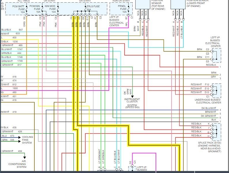

I attached the wiring for the O2 sensors. The brown wire is battery voltage for the heaters on each one.

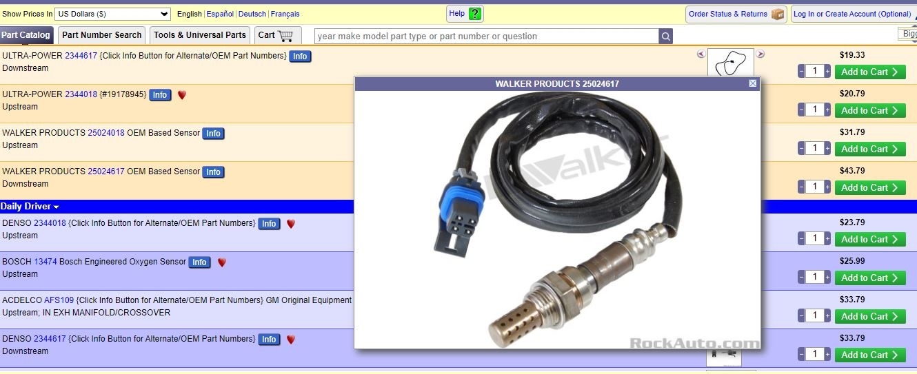

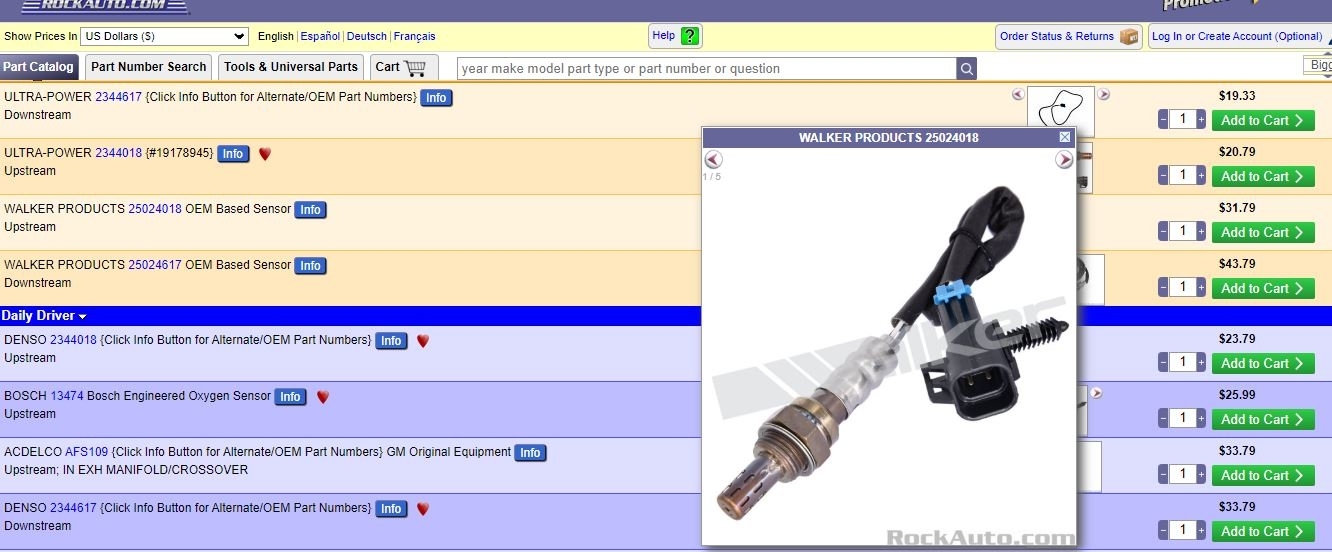

Okay, because I was at AutoZone and they have 3 different kind of sensor for my vehicle and I feel I might have got the wrong one. I can send images of these 3.
  • 52,797 POSTS
Please send me the images.
  • 52,797 POSTS
I attached the pictures of the correct sensors for your car.
This is from rockauto.

Your vehicle has two 02 sensors. One upstrem and one dowmstream.
The upstream 02 sensor is mounted in the exhaust system before the catalytic converter. The downstream is mounted in the exhaust after the catalytic converter.

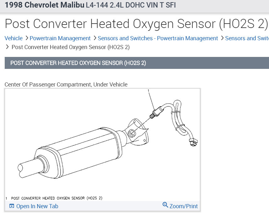

On a 1998 Malibu 2.4L 4cyl, to which sensor does a P0141 OBD code refer? If it's not the one after the catalytic converter, where is it located?
Tuesday, June 8th, 2021 AT 10:40 AM (Merged)
  • 75,992 POSTS
This means the sensor behind the catalytic converter as bad here is a guide to help you do the job and the location below for your car.
https://www.2carpros.com/articles/how-to-replace-an-oxygen-sensor
