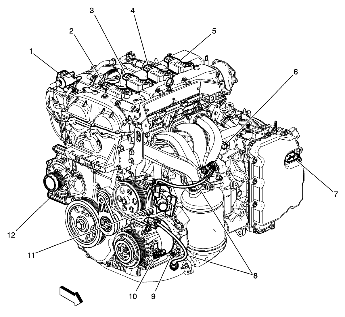

Where is the o2 sensor bank 1 located on my car?
Nov 17, 2016 at 8:09 AM
JIS001
  • 3,412 POSTS
On the exhaust manifold. See picture below. The one in the exhaust manifold will be bank 1 sensor 1, behind the catalytic converter is bank 1 sensor 2 on the image. Here is a guide to help you change the sensor out step by step with diagrams below to show you on your car

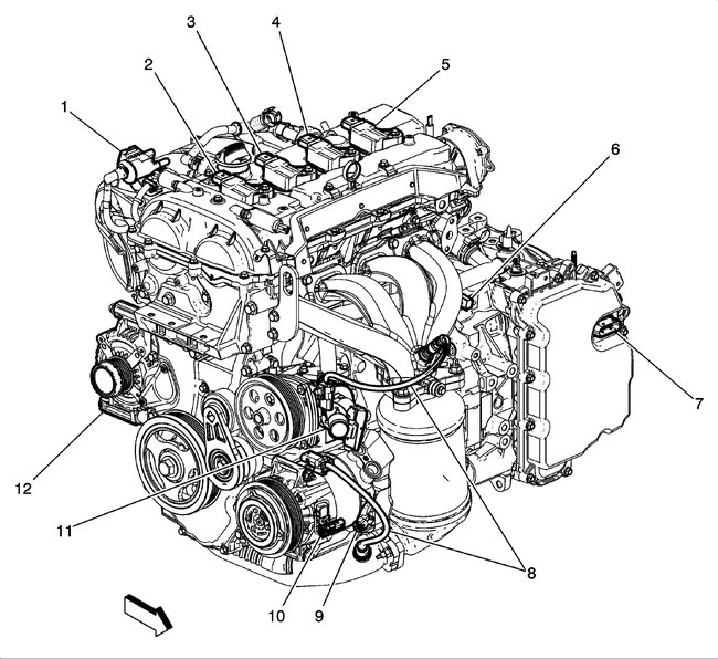

MAW0118
need to know how many O2 sensors are in the car listed above and where bank 1 sensor 2 is located exactly? I'm being told there are three, one 1 before and after the catalytic converter and also one inside the catalytic converter.
May 8, 2021 at 6:21 AM (Merged)
  • 110,244 POSTS
Welcome to 2CarPros.

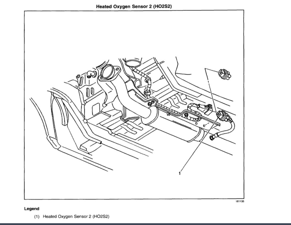

Banks 1 and 2 refer to either a V6 or V8 engine. You have an inline 4 cylinder. There are two sensors. As far as the sensors, one is mounted after the catalytic converter and one is mounted on the exhaust manifold.
There isn't one in the catalytic converter.

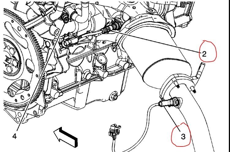

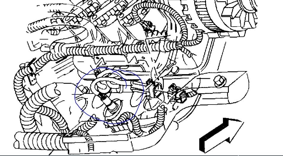

I attached a picture. Numbers 2 and 3 show the locations of the sensors. Number 2 is the heated O2 sensor which is referred to as number 1 and number 3 in the pic is the heated o2 sensor after the converter. I also attached a second picture and highlighted where the sensor is before the converter. Note that it is at the end of the exhaust manifold right where it would enter the converter.

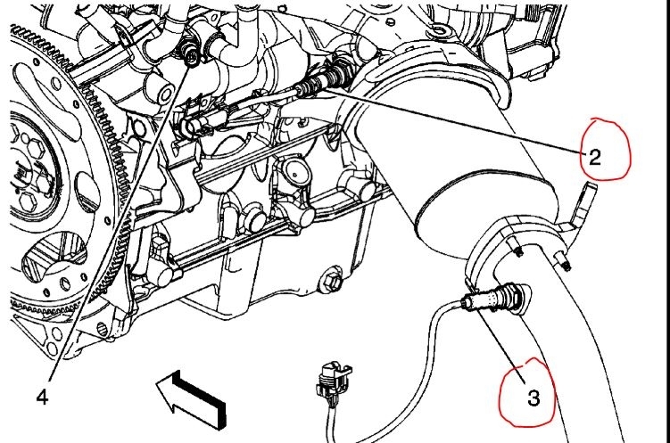

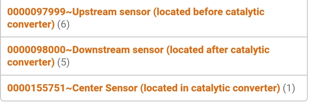

Thank you very much I believe I understand but to be clear sensor 2 is after the catalytic converter and I have looked down behind the engine (above the spark plugs) and seen an O2 hanging out.. now am I correct by saying that's before catalytic converter and I have to go right under that box "catalytic converter" and there should be another O2 hanging out?
also the reason I said there where three O2 sensors is I went to AutoZone and priced the sensors and they came up with three different sensors (upstream, center stream, and down stream) so I was very concerned.

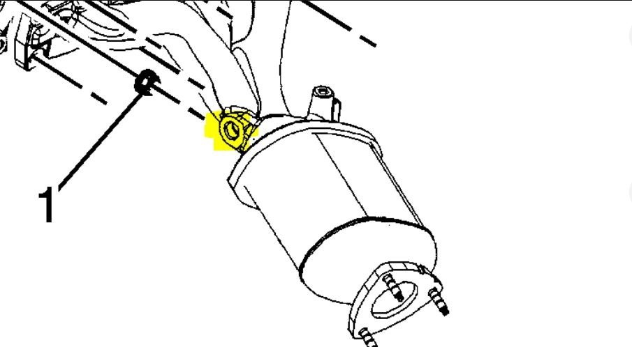

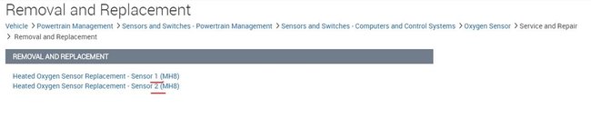

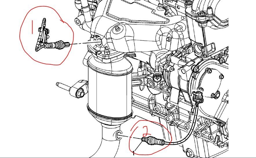

  • 110,244 POSTS
Welcome back:
There shouldn't be one above the spark plugs. Can you take a picture of what you are seeing and upload it for me?

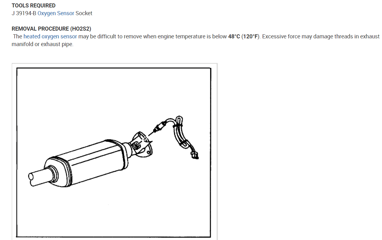

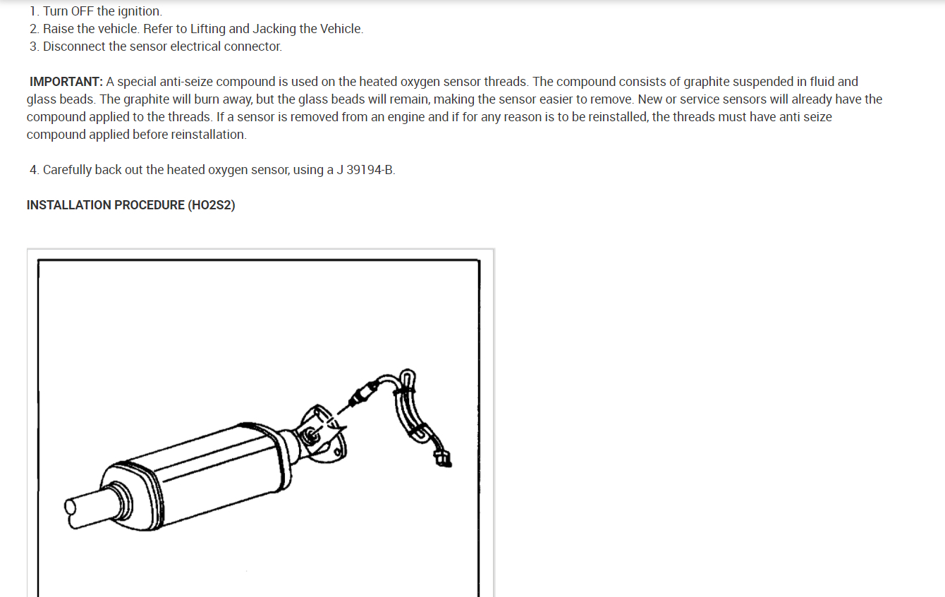

The one after the catalytic converter is actually in the intermediate pipe. If you look that the converter, you will see where it flanges and bolts to the intermediate pipe. At the beginning of the intermediate.
In the first picture above, sensor 1 is shows or identified with a number 2. The one after the converter is sensor 2.

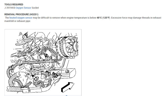

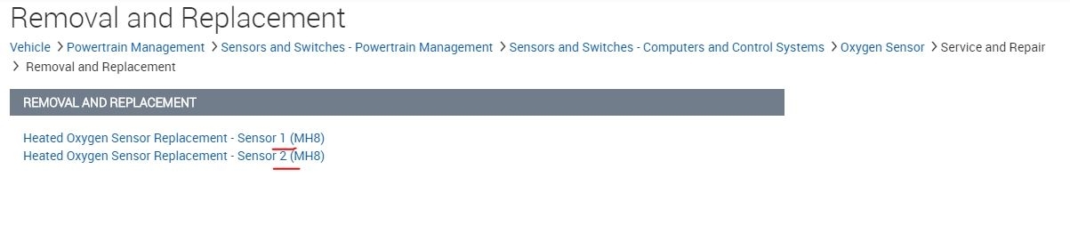

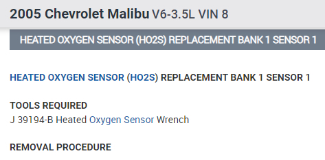

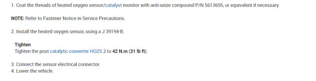

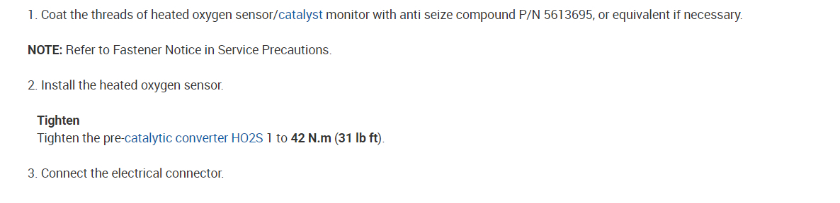

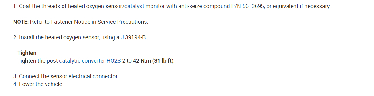

I attached two pics. In the first one, I circled the two sensors and identified which is sensor 1 and which is 2. In the second pic, I copied and pasted from the removal and replacement page. You will see that it only indicates two.
I have to be honest, I have seen sensors in the converter, but not this vehicle. However, as soon as I say it, I'll be wrong. LOL If I am, the manual is wrong, too. LOL

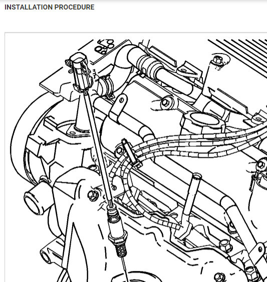

SWITCH68
I need to change the bank 1 sensor 1 oxygen sensor can you help me? Please help Thank you
May 8, 2021 at 6:22 AM (Merged)
DANNY L
  • 5,648 POSTS
Hello, I'm Danny.

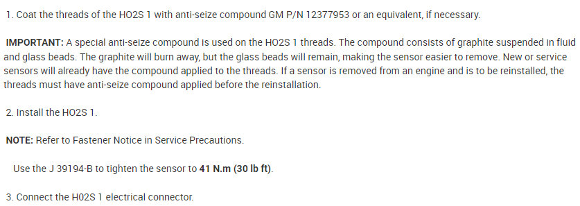

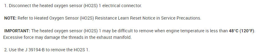

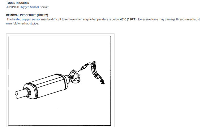

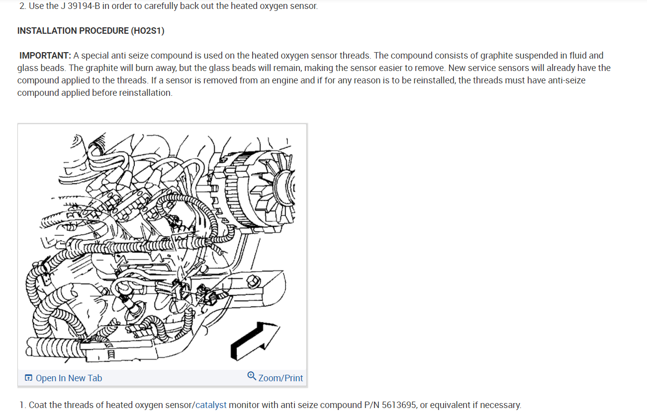

Here is the information you requested. This is a tutorial for you to view showing oxygen sensor replacement:
https://www.2carpros.com/articles/how-to-replace-an-oxygen-sensor
I've attached picture steps below showing oxygen sensor replacement and location for your car. Hope this helps and thanks for using 2CarPros.

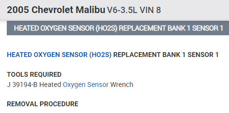

Good morning,
I attached a picture of the location of the sensor for and a direct link with the part required from advanced auto.
It is at the back by the firewall in the exhaust manifold. It is a very tight fit.
I would also ask for the socket for removing it as well when you go for the part.

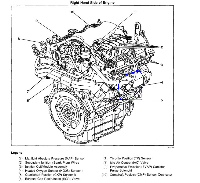

JUNIIR PALACIO PEREZ
  • 9 POSTS

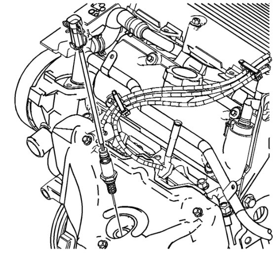

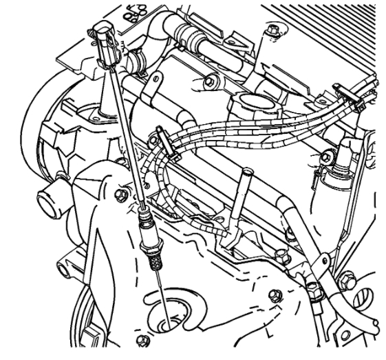

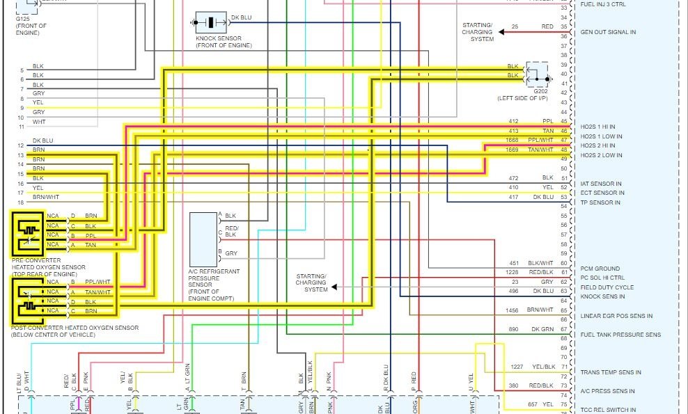

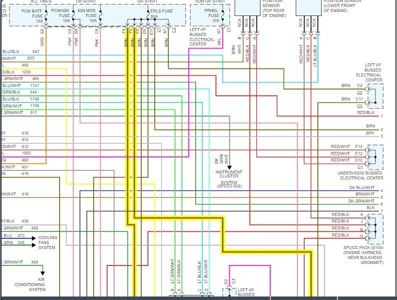

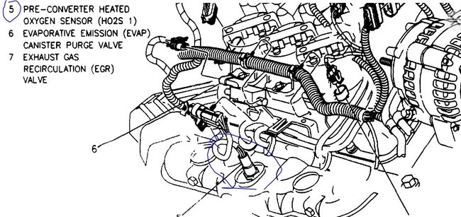

Trying to find the sensor inside the exhaust manifold/crossover specific to the Sfi 3100 V6 and also the wiring to the sensors.
May 8, 2021 at 6:23 AM (Merged)
Good afternoon,
I attached pictures of the location for the upstream and downstream O2 sensors.
https://www.2carpros.com/articles/how-an-oxygen-sensor-works
What is the issue?
https://www.2carpros.com/articles/how-to-test-an-oxygen-sensor-02-sensor
I attached the wiring for the O2 sensors. The brown wire is battery voltage for the heaters on each one.

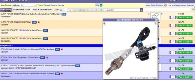

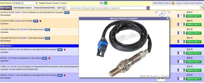

  • 9 POSTS

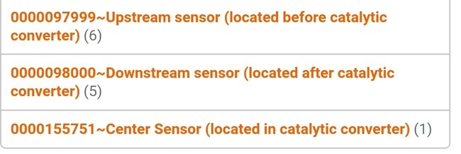

Okay, because I was at AutoZone and they have 3 different kind of sensor for my vehicle and i feel i might have got the wrong one. I can send images of these 3.
Please send me the images.
I attached the pictures of the correct sensors for your car.
This is from rockauto.

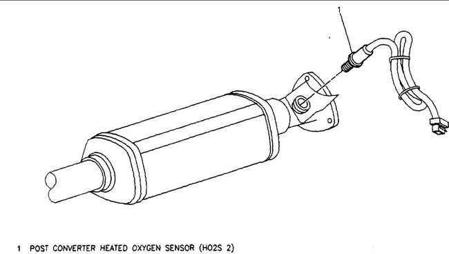

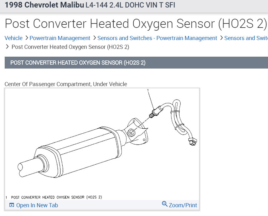

On a 1998 Malibu 2.4L 4cyl., to which sensor does a P0141 OBD code refer ? If it's not the one after the catalytic converter, where is it located ?
Jun 8, 2021 at 3:40 AM (Merged)
  • 75,992 POSTS
This means the sensor behind the catalytic converter as bad here is a guide to help you do the job and the location below for your car.
