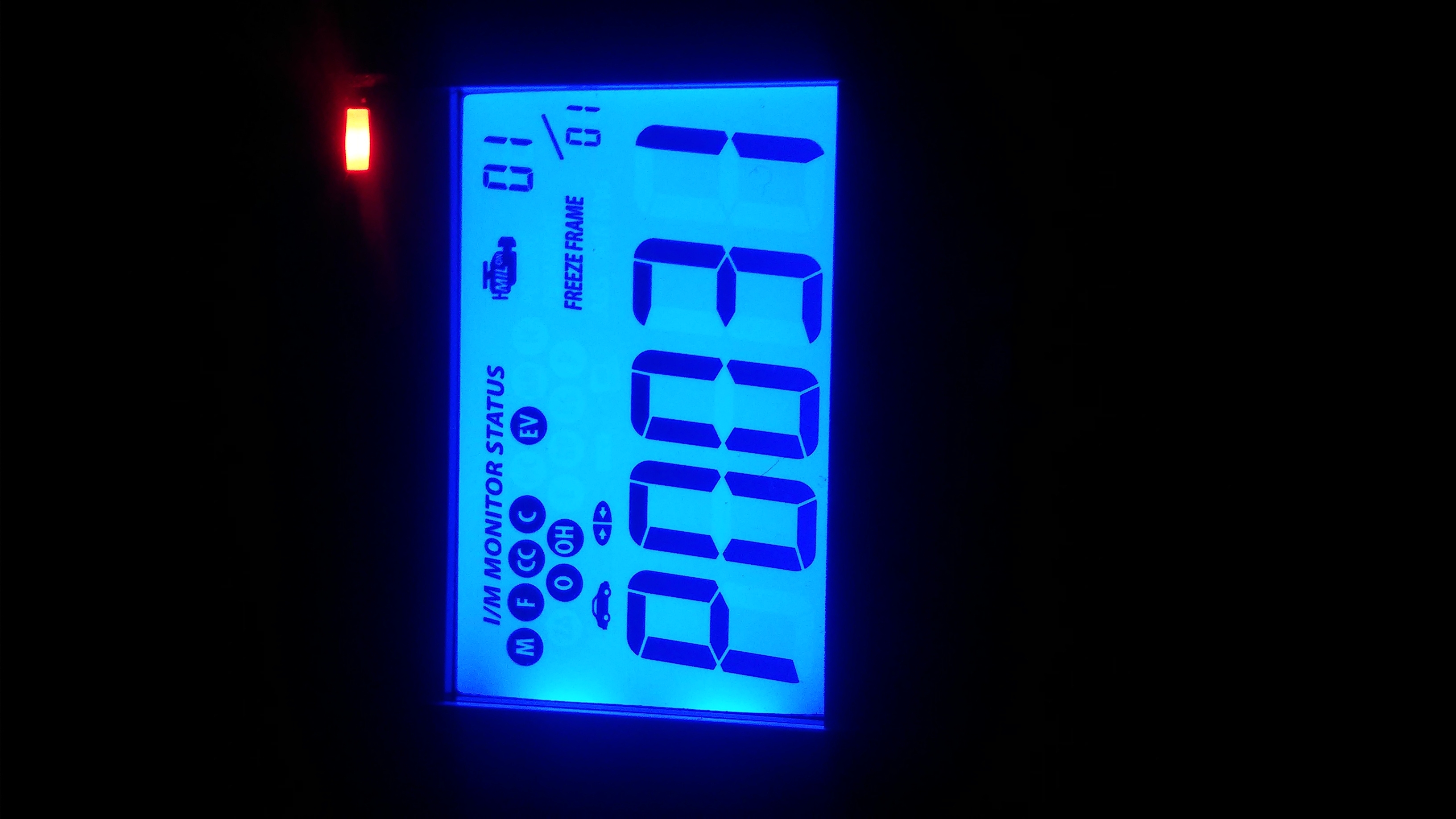

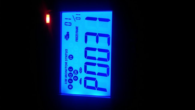

Getting this code in my pickup. I need help determining which sensor it is and if I can change it easily myself or if I need to take it to a mechanic. My pickup is an SR5 V6 3.

P0031 - Heater control circuit low (bank 1 sensor 1). Easy item to test, unplug the sensor connector for the upstream O2 on the drivers side. Look at the connector and you will see two wires that are the same color and two that are different. The two same color wires are the heater circuit. Those carry twelve volts to the O2 sensor to make it heat up and respond faster. Use an ohm meter to check for continuity between those wires. Also use a test light to see if the twelve volt feed is there as well.
