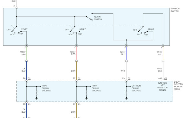

When you open the door there is no chime, when you turn the key the only thing that comes on is the check engine light. You can hear a click on the top of the motor, like a pump priming. I changed the ignition, i have had trouble with it before. But that didn't fix it. BCM? Also, i had my windshield replaced and it leaks pretty bad, would that help fail the BCM? The truck was running and driving, shut it down to change transmission lines. And the truck sat for 6 months with the windshield leaking. I tried to shop vac it out and put a dehumidifier in my truck. No codes from obd2.
I have also taken out the bcm and inspected it, clean and nothing looked burnt or discolored. Hooked up the battery and tried the key and just the check engine light nothing else. No turn or start. Disconnected the wiring harness right below the bcm, (i think it runs to the back of the truck running along the running panel), and when I tried the key again there was no check engine light or anything else?

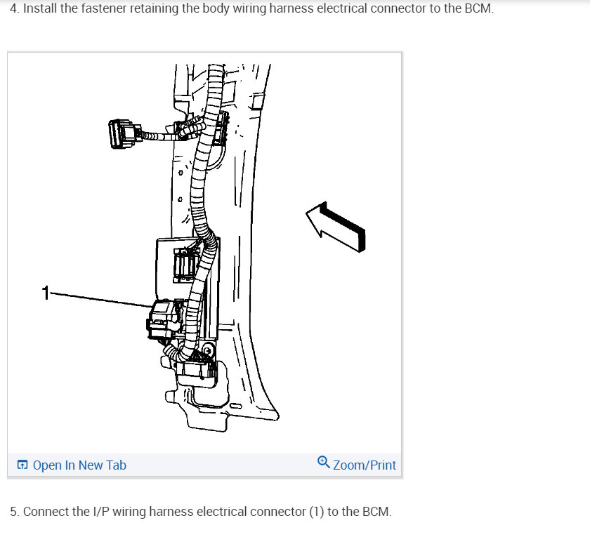

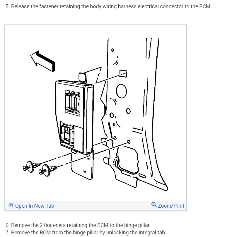

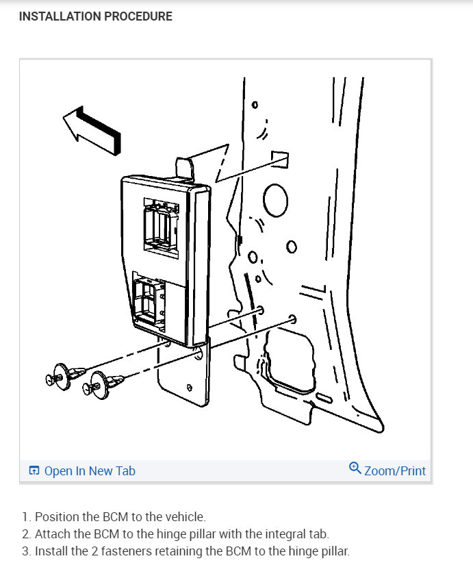

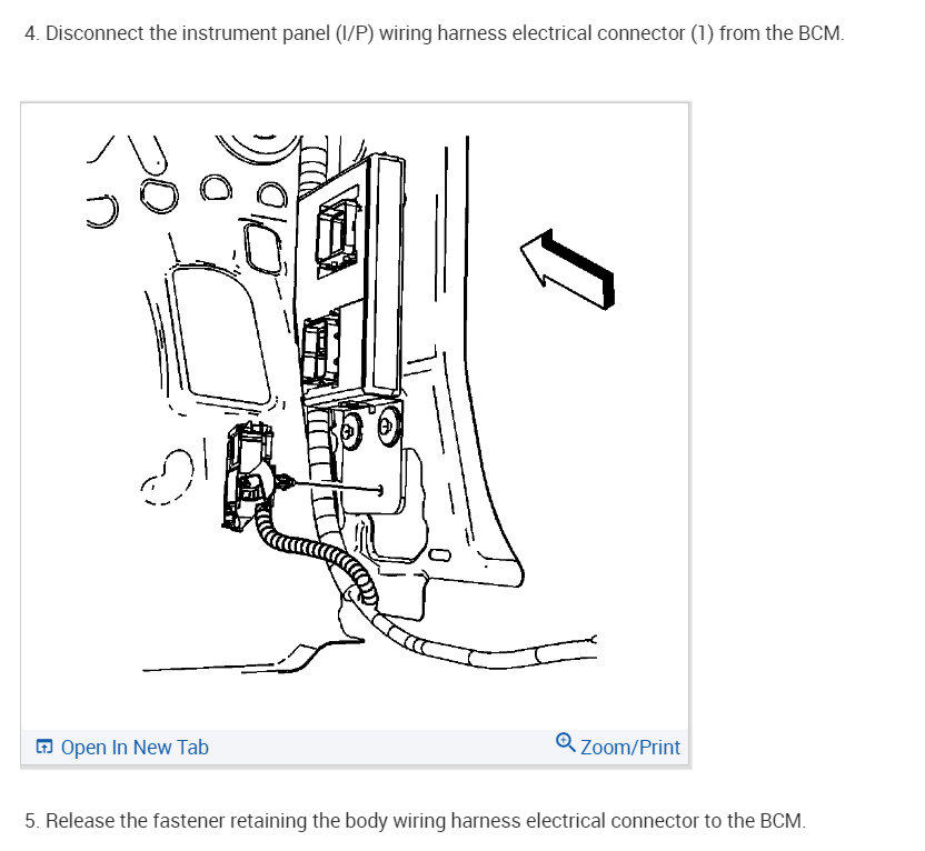

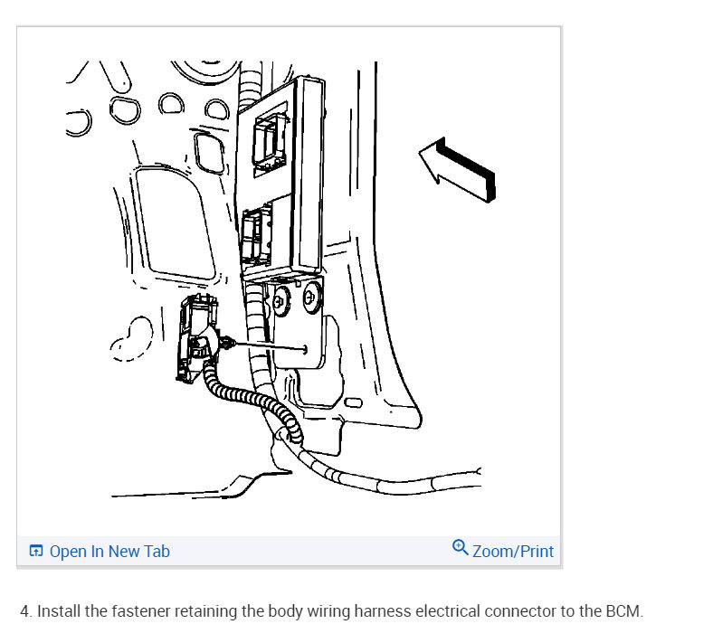

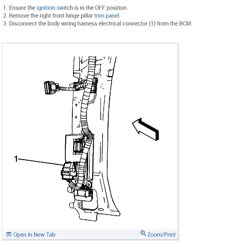

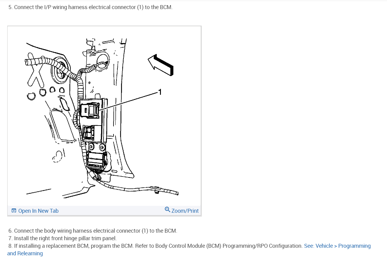

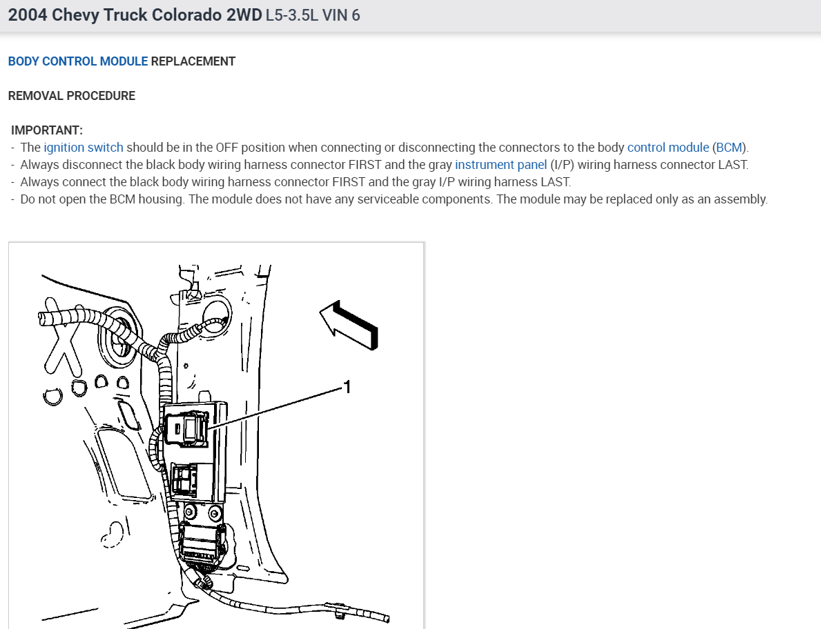

Here is how to change the BCM out, you can get a preprogrammed unit by searching Google or Ebay. You might want to try to dry out the electrical connectors as well.

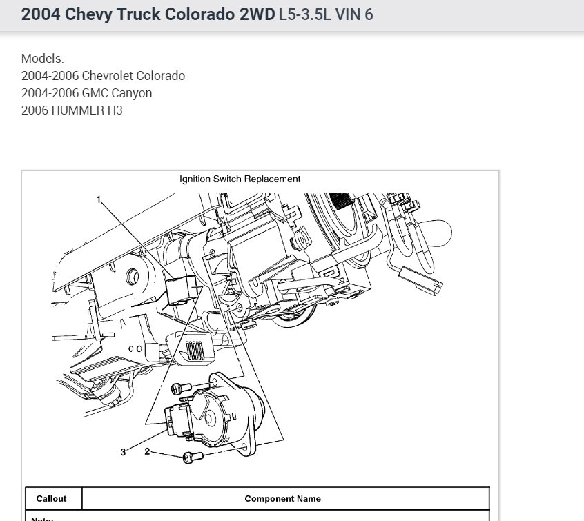

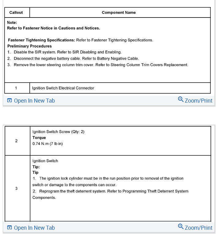

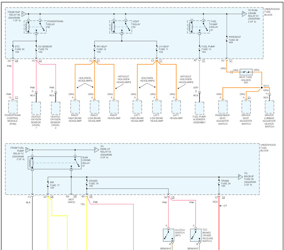

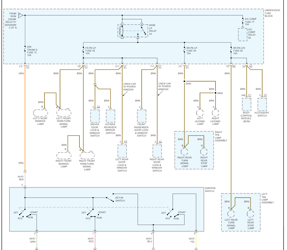

Okay, did you check the main power fuses? And if they are okay, it could be the ignition switch. Let's use this guide to help test for power input and output when the key is on.
See if you have power to the orange wire, and then turn the switch on and test the outputs. Check out the images (below). Please let us know how it goes.
Aug 7, 2023 at 2:37 AM

I know there is power at the white with blackline wire. I will check all of them and let you know. So test with key to on, correct??
Aug 7, 2023 at 3:34 AM
04COLORADOZ714X4
  • 26 POSTS
There is power to all except blue and yellow.

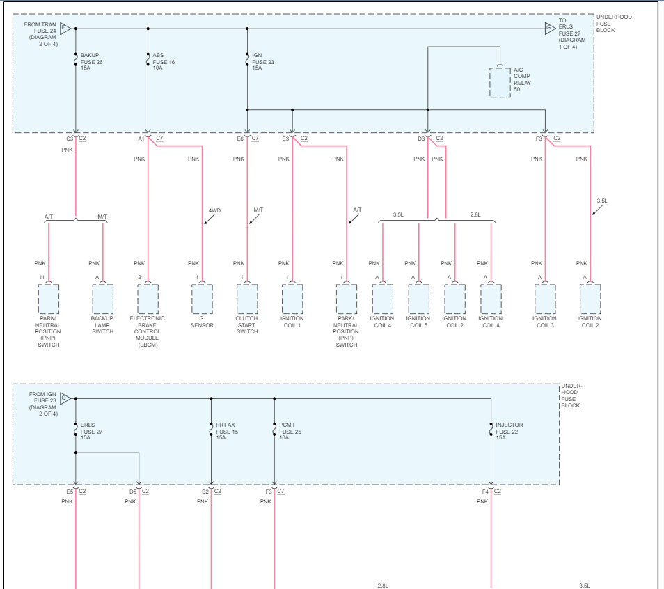

I have checked all the fuses and none were bad. Have power on both sides of mega fuse.

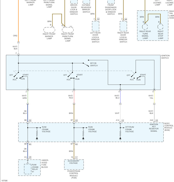

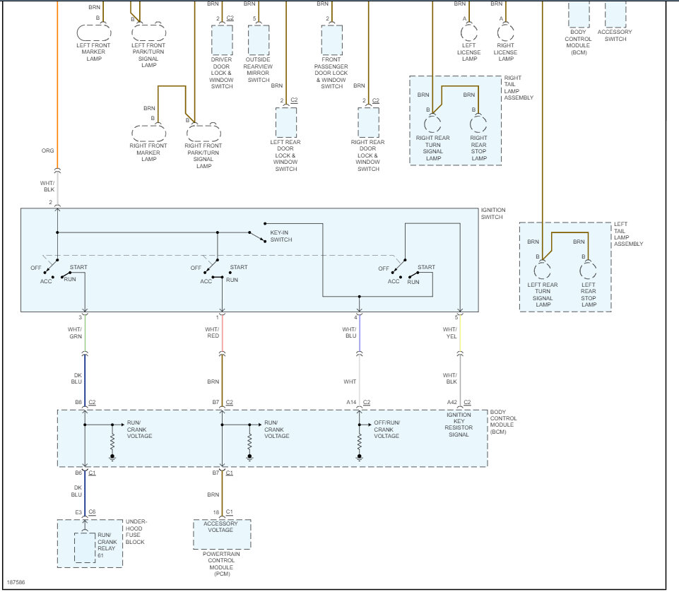

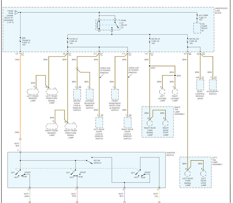

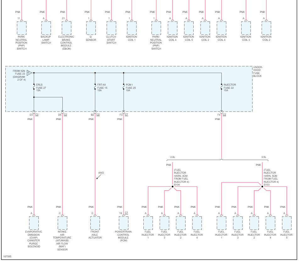

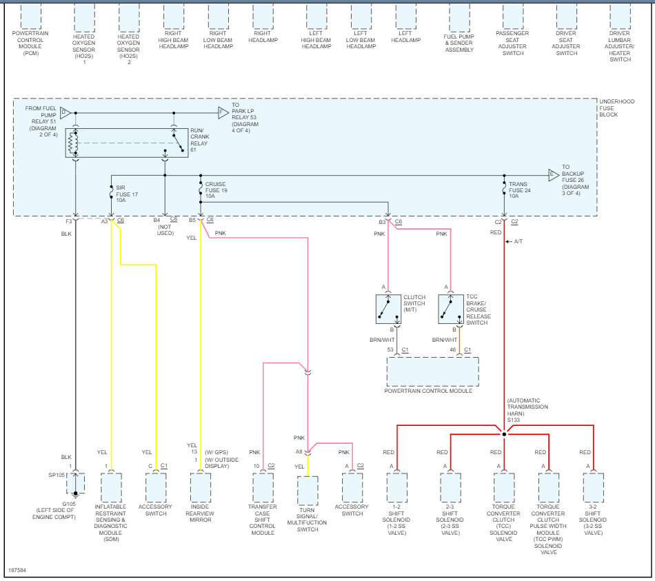

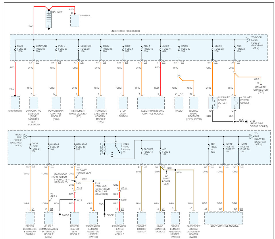

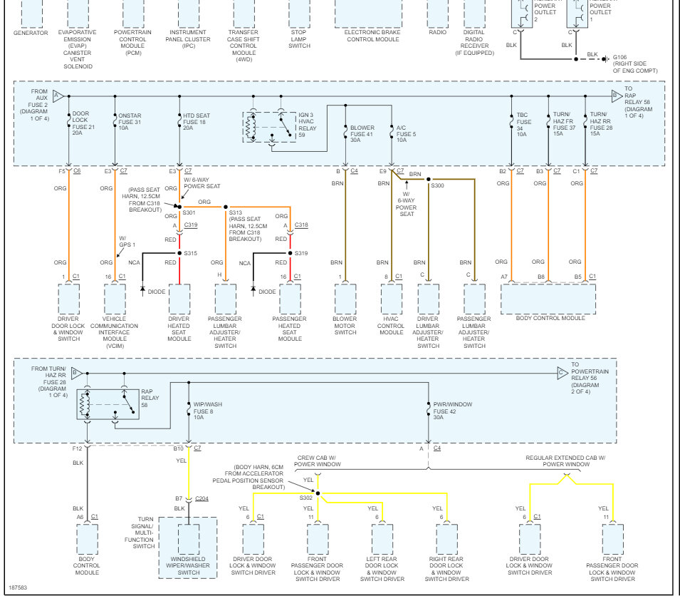

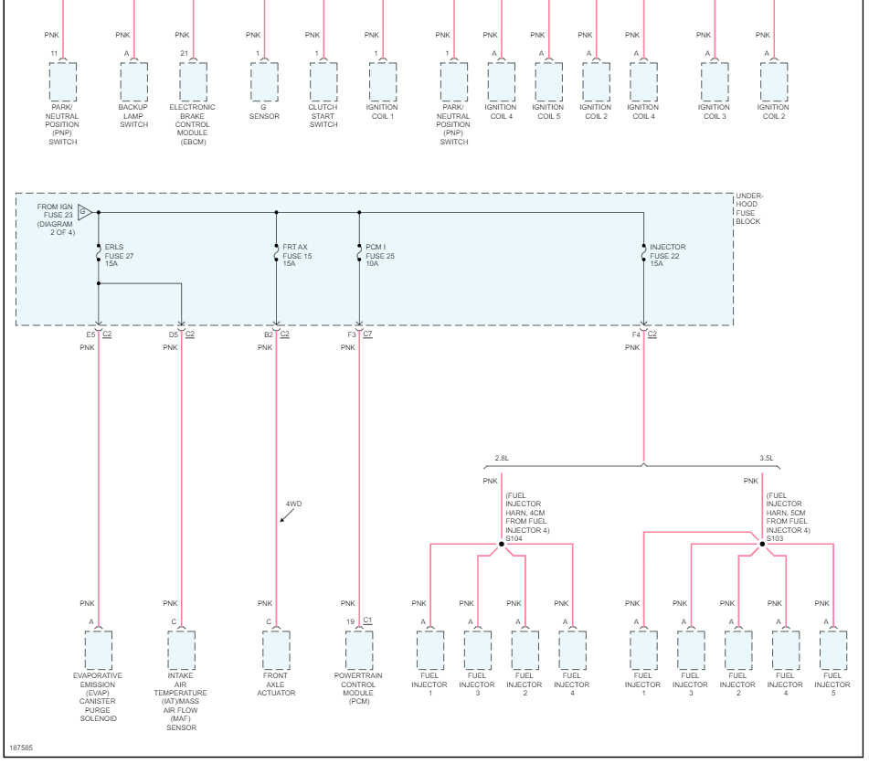

No that should not matter, do you have power at the orange / blk/white wire going into the ignition switch? here are the entire wiring diagrams so you can see where the main power comes from, I think this is your issue. Please make sure the battery is in good shape. There are several main fuses you need to test. Check out the images (below). Please let us know how it goes.

One the driver side of the ignition is a black cap with the plug. The white wire with black line has power.
Aug 10, 2023 at 7:42 AM
  • 55,456 POSTS
Okay, with the key on the remainder of the wires should have power can you please test them? Check out the images (below). Please let us know what you find.
Aug 11, 2023 at 3:10 AM
04COLORADOZ714X4
  • 26 POSTS
No power at white and blue and white and yellow.
Aug 11, 2023 at 6:36 AM
  • 55,456 POSTS
It looks like you have found the problem, here is how to change the switch out. Check out the images (below). Please let us know if you need anything else to get the problem fixed.
Aug 12, 2023 at 2:05 AM

There is power on the blue wire to the BCM, but i do not know how to test if it is coming out, does the white/yellow wire from the ignition receive 5 volts from the BCM to then activate the white/blue to the run/crank??or does 5 volts. come from the ignition to the BCM? So stressed out.
Aug 13, 2023 at 8:47 AM
  • 55,456 POSTS
Sorry about that, yes it can be stressful. You will need to send the BCM for testing for it is difficult to test on your own. Did you test through the ignition switch? They are 12 volts only. Please let us know what happens.
Aug 14, 2023 at 5:21 AM
04COLORADOZ714X4
  • 26 POSTS
There is power to ignition wires wht/blk,wht/red and wht/grn.
There is no power at the ignition wires (wht/blue and wht/yellow) although when testing the white with yellow wire,
i believe that it receives or sends a 5-volt signal to or from the BCM (pass lock) then the white/blue would send 12v to run/crank?
Hence why i think it is the BCM.
Am i wrong?
Aug 14, 2023 at 5:37 AM
  • 55,456 POSTS
Nope, it sounds like the BCM. I would replace it with a rebuilt unit, you can get a preprogrammed unit by searching Google or Ebay.
Aug 15, 2023 at 1:32 AM
04COLORADOZ714X4
  • 26 POSTS
I got a new BCM, door chimes started working as soon as the battery was connected.
