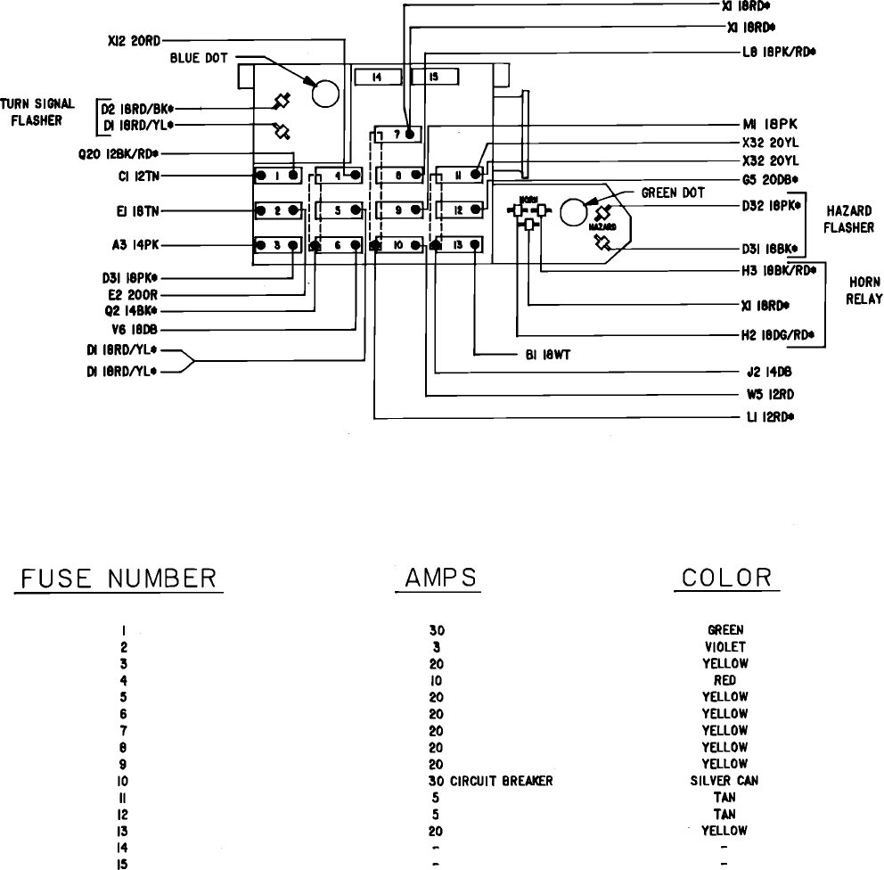

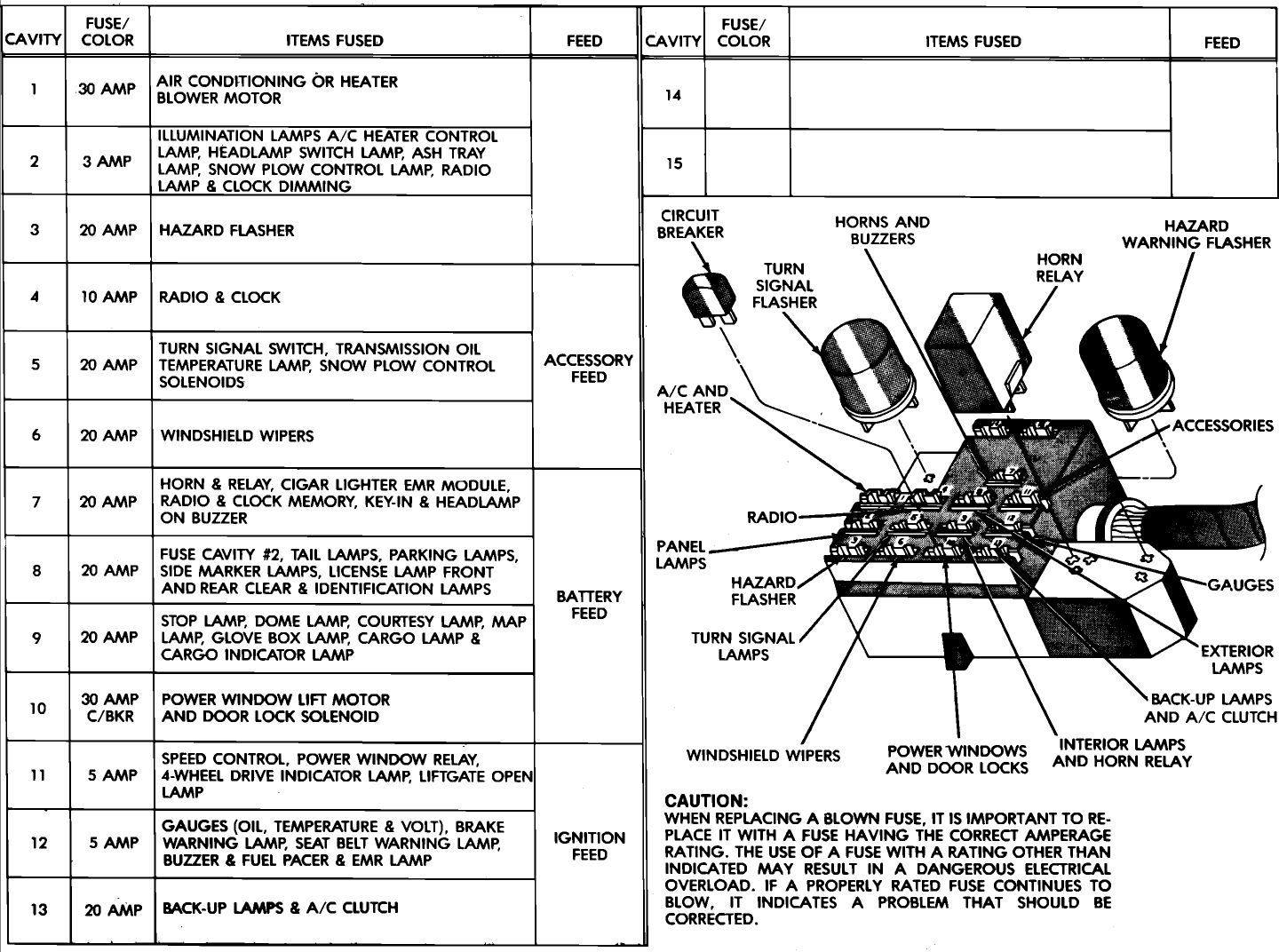

Ok, have tried all that and still no luck. One thing I keep noticing is if I am driving when it happens, the radio will go off to. But the headlights stay on. Crank the key and it starts back up and radio comes back on.

That still sounds electrical. Possibly a bad ignition switch harness or switch itself.
The radio, wipers and turn signal switch are all fed from the same buss in the box, they are fed from the ignition switch. If the switch was failing it could "repair itself" when you turned it off and back on.
