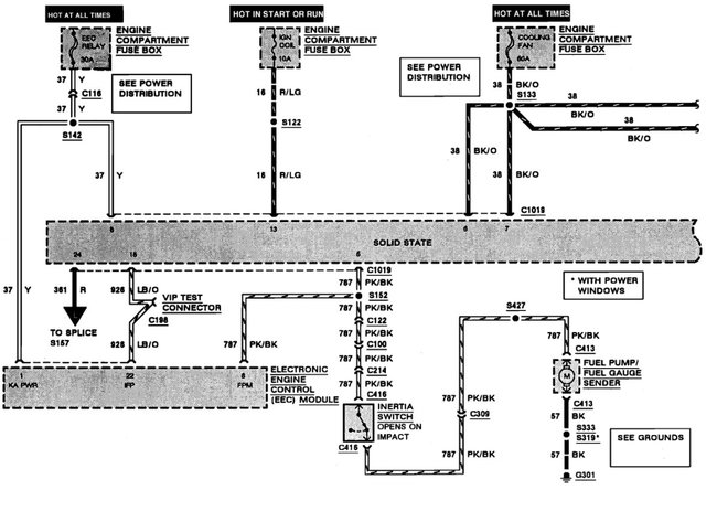

Recently car shut off while driving and has not started since. It made a gasp for air noise three times and would almost shut off. So I replaced the fuel pump and got codes 556 and 557. What should I do before replacing the CCRM since that is where the fuel relay is?

I would make sure the fuel pump operation is the problem. Use a test light and see if the fuel pump is getting power.
Here is a guide that should help you and a wiring diagram (below)
Here are some more guide that will help.
Please run some tests and get back to us so we can continue helping you.
