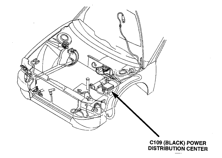

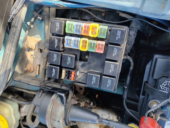

I changed the head cover gasket, and it started running rough like I had a miss, and I had just changed the plugs to do thought it was my plug gaps so pulled plugs and checked my gaps and put them back in. Then it wouldn't start. I changed the purge valve cannister and the coil solenoid. Still not starting...what am I missing. It ran fine except for a small miss in it until I checked my plug gaps then no start. Did I damage the plug wires?
Dec 24, 2022 at 10:32 AM
  • 110,244 POSTS

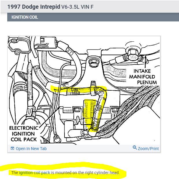

If this happened after removing the spark plugs, I'm questioning if there is a wiring problem to the coils or we have a failed fuse.

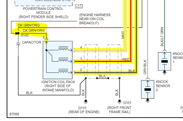

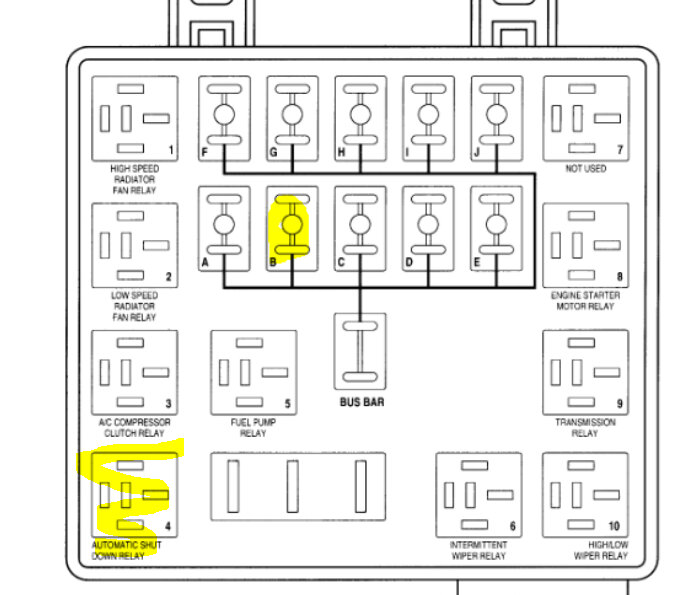

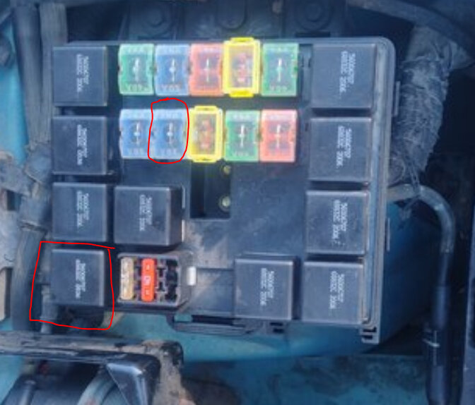

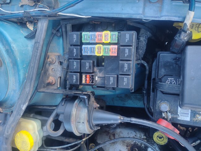

Do me a favor. At the coils, you will see a dark green wire with an orange tracer. With the key in the on position, check that wire for power. (See pic 1 below)
If there is no power, check fuse B in the power distribution box under the hood. In addition to checking the fuse, confirm there is power to and from it.
Power from Fuse B travels through the ASD relay and then to coils.
Let me know what you find, and Merry Christmas

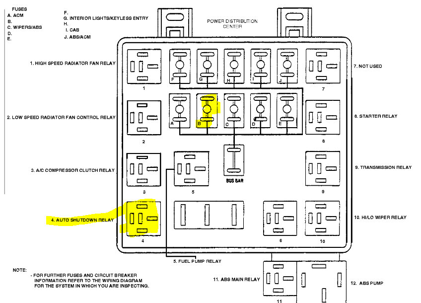

As far as the fuse and relay, see pics 1 - 3.
As far as the wire, that is at the coil connector. See pic 4. In the wiring harness to the coil will be a dark green wire with an orange tracer. With the key on, confirm there is power to it.
Dec 27, 2022 at 10:08 AM

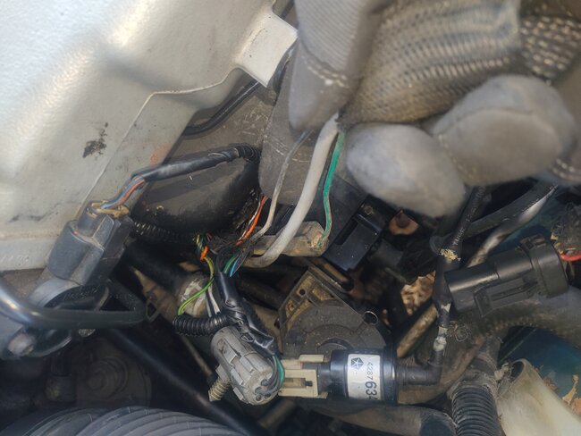

Code reader said emissions purge control valve circuit. I replaced the cannister already. Don't have a test light so couldn't check that wire. I have a analog multimeter but couldn't get any kind of reading off it when trying to test that wire. The fuse is good because when I plugged it back in it made some clicking sound like it engaged the computer. My battery is shit. Have to replace it if I can ever get it to run. So, is it the purge valve wire harness?
Dec 27, 2022 at 4:52 PM
RODNEY JASON WARD
  • 35 POSTS

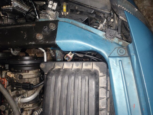

Is this plug go into anything, looks like it comes from the headlight area but I could be wrong or is it what I am missing?
Dec 27, 2022 at 5:22 PM
  • 110,244 POSTS
The connector you found is difficult for me to determine. What color are the wires going to it? I believe one is blue. Also, you certainly can use an analog multimeter. Set it to voltage. The key needs to be in the run position when checking power at the coil. If there is no power, that is the issue.
Let me know. Also, the EVAP code you had wouldn't prevent it from starting. What I need to know is if we lost spark to the plugs. You confirmed fuse B is good, so there should be power present at the coil.

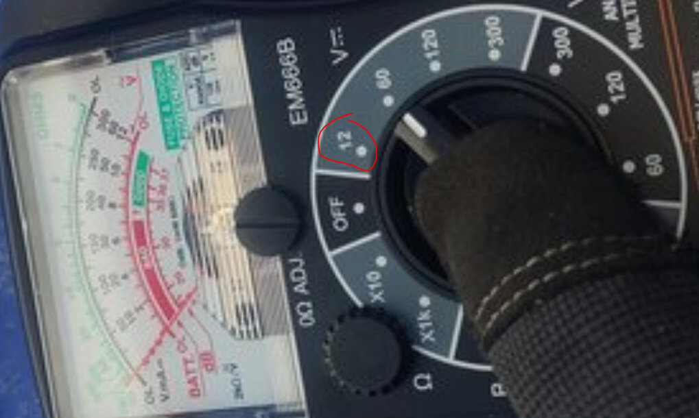

Got no reading from the plug.... I used the meter like you said on the two settings in the pics...nothing.

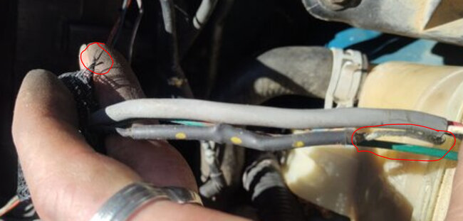

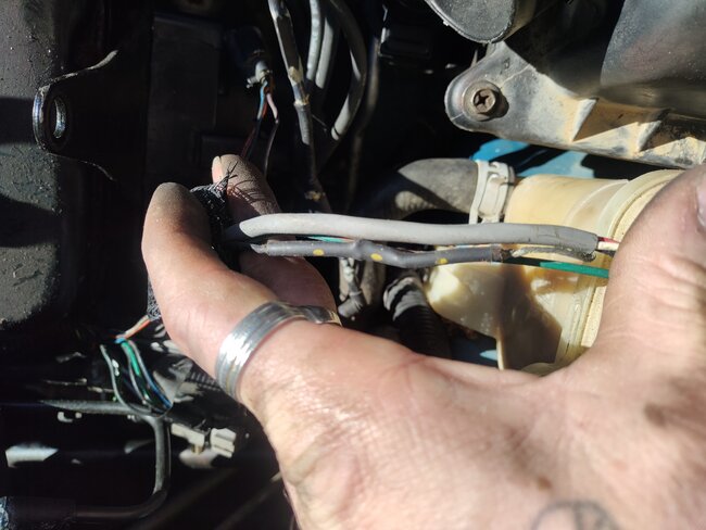

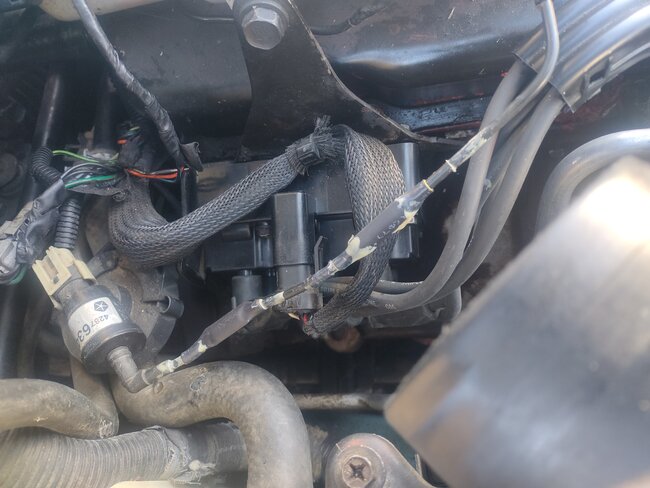

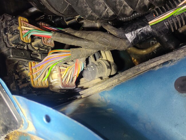

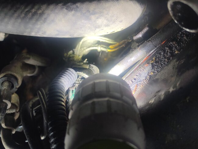

Hey Joe, I have been trying to send you a video on here of what's up on this car, but it won't upload. My name is Rodney if I haven't told you yet. I am sending a pic to see if it's normal wiring or what? That wiring with the yellow dots and the exposed wire is that good, or no?
Dec 30, 2022 at 2:28 AM
  • 110,244 POSTS
Hi Rodney,

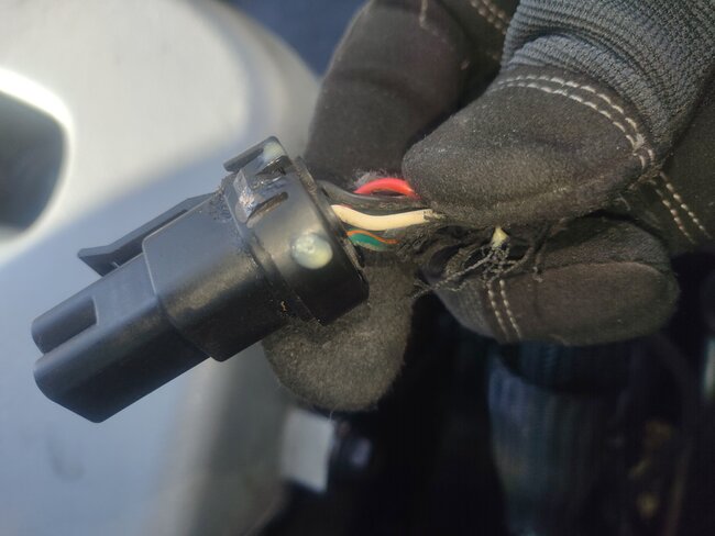

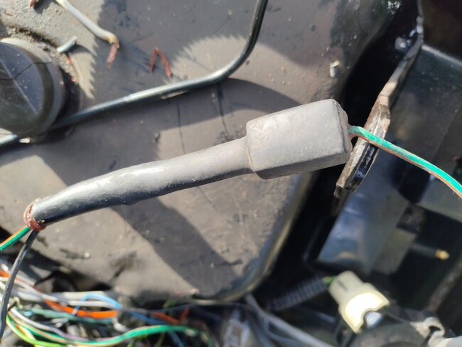

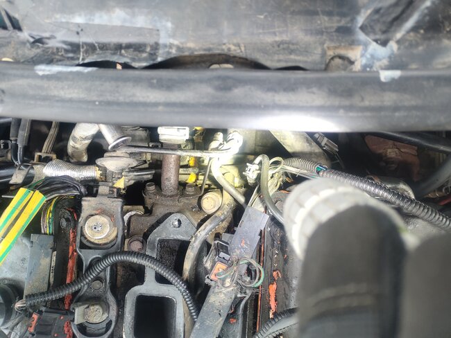

As far as the wiring is concerned, those appear to have been repaired and a product called heat shrink is used to insulate it.

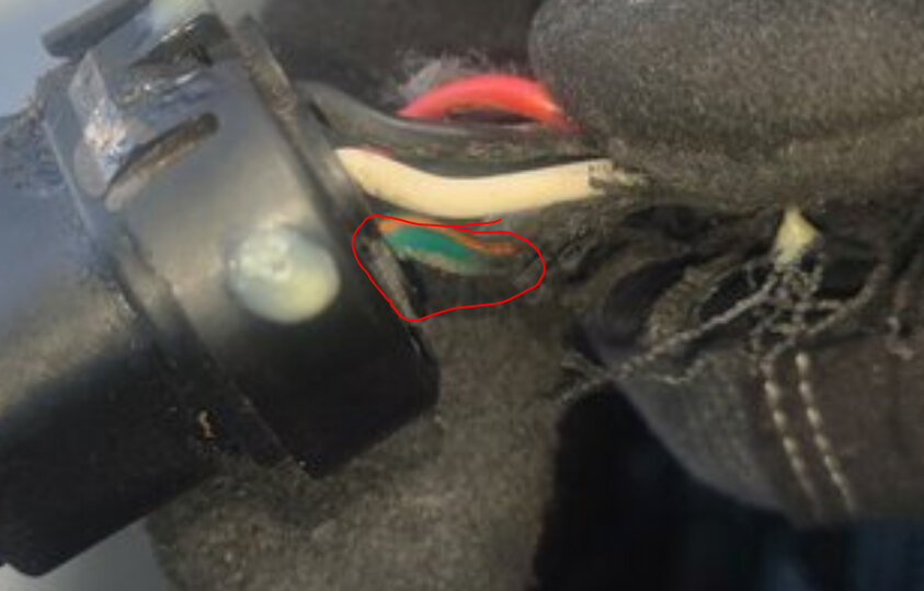

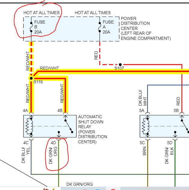

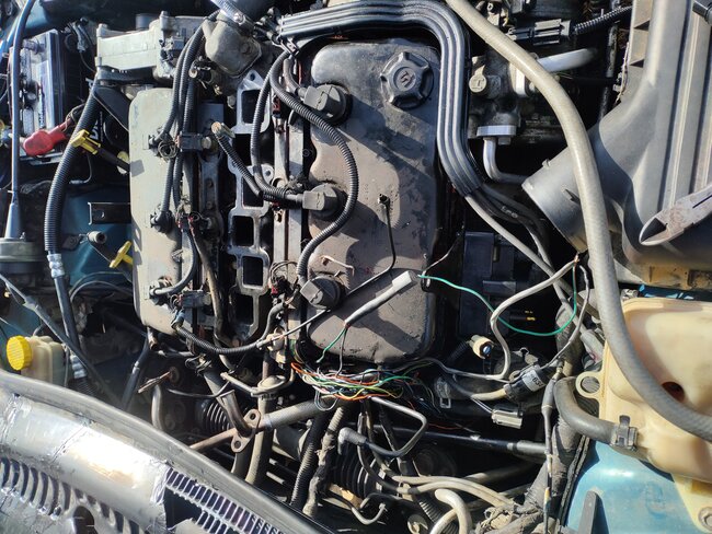

Okay, in the pics below, which I copied from yours, take a look at pic 1. Keep in mind all multimeters are different, but I would think you want that set on 12v. Set it on 12v and simply test the power from the battery to confirm it shows 12v on the multimeter. Try it on the other settings you tried.
If you look at pic two, that should be the wire supplying power. Now I do have a question about the third pic.
I circled two things. On the right side of the pic appears to be the bare/broken wire. Is that correct? Also, I circled what appears to be a connector that is next to your finger. Is that correct?
Also, is the green wire with the yellow tracer connected in either of the wires in pic 3? If it is, we need to open up the heat shrink and see if there is power where the connection was made. We may have a problem at that point if it ultimately reaches the green/yellow wire.
Let me know. Also, if I don't hear from you right away, have a great New Year's Day.

Pic 3 the circled parts, one was just some insulation and the one with the bare wire it folds back into the gray sleeve. So, cut open that yellow dot stuff and check for power somewhere?
Dec 31, 2022 at 2:04 AM

I am curious if the green/yellow has power to the connector and then it is lost due to an open circuit at the connector.

How do you test or check these fuses and relays?
Jan 4, 2023 at 5:03 AM
  • 110,244 POSTS
Here are two links. One explains how to test a fuse and if the fuse is getting power. The second one explains how to test a relay.
Let me know if that helps or if you have questions.
PS: If you don't have a test lamp, you can use the multimeter in its place.
Jan 4, 2023 at 12:00 PM

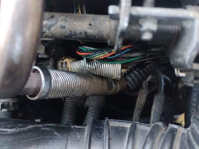

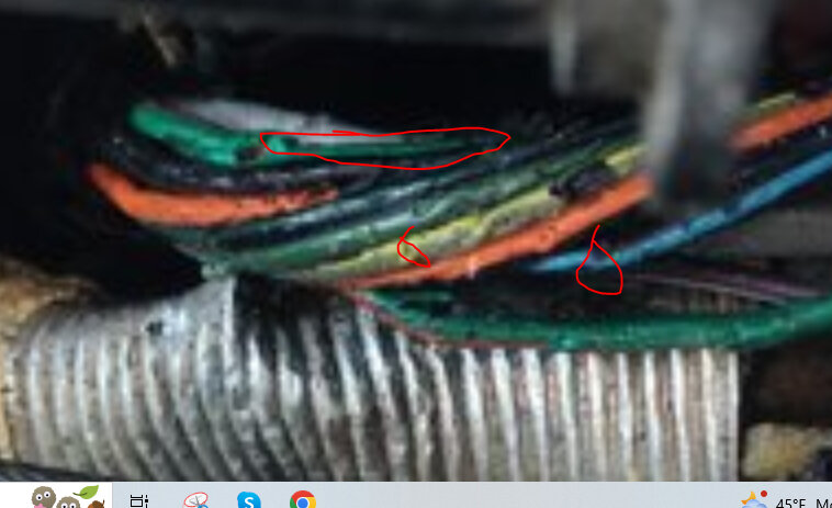

I tested the fuses all good, I tested where the relays plug into, all good, so does that mean I have a break in my wiring some where? I have a very limited budget. How can I find this break because I looked all over the wires that I could see I couldn't find anything but where the wires are all bunched up behind the motor, they are all like stuck together almost like melted together...
Jan 5, 2023 at 6:17 AM
RODNEY JASON WARD
  • 35 POSTS

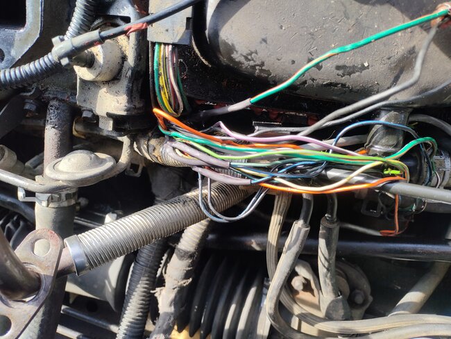

This is what I am talking about. You think the problem is in this mess?
Jan 5, 2023 at 6:20 AM
  • 110,244 POSTS
Rodney, I think you best described it, a mess. Yes, there appear to be several different possible issues there.
I copied your pic. The wire I circled seems to be crushed, the other wires seem to have insulation that is damaged. Also, they are near the exhaust and EGR pipe which will get really hot. Do they seem melted together? The wire I circled, is that the green/orange wire we have been checking?
Jan 5, 2023 at 7:09 AM

That entire group of wires was melted together. Not all the way but the insulation was all stuck together. I got them apart and now fixing any exposed wires or bad kinks. What is the thing in the second pic?
I got the top taken off and going to leave it until I hear back from you. Is there anything I should check?
Jan 6, 2023 at 3:42 AM
  • 110,244 POSTS
That appears to be a splice. If I'm correct, that looks like the dark green/orange, but I can't tell the color of the other wire. Tell me what color it is so I can track it down.
When you repair the wiring, make sure that none of them are broken. They can actually break internally and be hidden by the insulator.

Could this be my issue. The 2nd pic is to show you where it's at in the back of the engine. Wired come of the same group as my fuel injection wires
Jan 11, 2023 at 2:03 AM
  • 110,244 POSTS
I'm not sure what to look for in the pics. If you have come across a dark green wire with an orange tracer, that is the power supply to the injectors along with other things.
