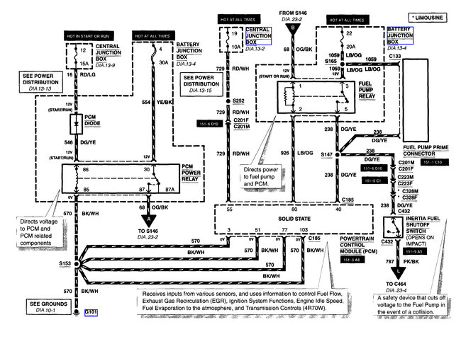

Engine cranks, just does not start. had some coil issues that i worked on last week. it was jumping around forty mph when you tried to gas it. i parked it and now it will not start. seems like it is not getting fuel? so i started small and changed the fuel filter and it was pretty clogged. maybe the fuel pump? or the relay?

Listen if the fuel pump runs (hums) for the first two seconds after you first turn the key to run, before you turn the key to start.
Let me know if you do not hear the fuel pump run.
Nov 4, 2017 at 9:40 AM
PATENTED_REPAIR_PRO
  • 1,853 POSTS
The fuse and relay are both in the battery junction block. Below is that wiring diagram.
If the fuel pump does not run, put your finger tips on that fuel pump relay and feel if it clicks or not when someone else turns the key to run.

Also, that fuel pump relay gets its power on the other side from the PCM power relay. so check those fuses too and if that relay clicks or not. It is in the same wiring diagram and A from the PCM relay goes into B of the fuel pump relay.

Try a new fuel pump relay. Or better yet swap one into that spot from something that is not important, like a horn relay, etc. Did you check that number 22 fuse yet though?
Nov 4, 2017 at 10:13 AM
PATENTED_REPAIR_PRO
  • 1,853 POSTS
If you did check that number 22 fuse and it is okay, make sure the power is reaching the fuel pump relay, so remove the relay and test those spots in the empty fuel pump relay socket. One spot should be hot all the time, that comes from that number 22 fuse. If it is hot, try a swap or new relay.

When using a voltmeter or twelve volt test light you want to use a metal ground for the ground test lead, or if it will reach, back to the negative battery post. then use the positive test lead to test whatever you want to test for power/voltage.

So i was getting like 9.0 DC on the number 22 fuse, and the same thing on the PCM relay. but nothing where the fuel relay was at, with the key turned.
Nov 5, 2017 at 2:10 AM
CHEVY__88
  • 104 POSTS
We rechecked it and there is power going to everything.

Charge the battery overnight at 4 amps or for two hours at 10 amps, then check if the fuel pump runs when you first turn the key to run, for about two seconds. Do not bother cranking the starter over and draining the battery just yet until you are sure the fuel pump is working. Test if the fuel pump is getting twelve volts that first two seconds the key is turned to start or not. If not, replacing the fuel pump probably will do no good at all, cause the new pump will not work either until you find out why the fuel pump relay is not delivering voltage to the fuel pump.

Disconnect the harness back near the fuel pump and jump twelve volts to the pink/light blue wire going to the fuel pump and make sure you also ground the black wire spot and see if the fuel pump runs or not. At least then you will know if it is the fuel pump or not.
