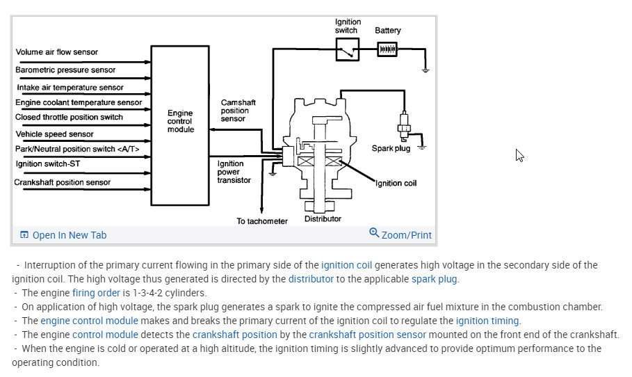

This does not sound like a security system issue because it normally does not disable half the cylinders. It normally cuts fuel and spark and it may not even allow it to crank.
The fact that you have two cylinders, we need to find out how he checked those components. The reason is, if the coil is ok then you should have spark coming out of the distributor. If you don't then I suspect you have an ECM issue because as you will see on the attachment, it makes and breaks the current to create the high voltage spike for the ignition.
I can understand how you are stumped because if all those things check out, it should be working. This means we have to ASSUME something was missed when they were checking these items.
Let me know detail about how he checked them and any measurements he as on coil resistance. Thanks

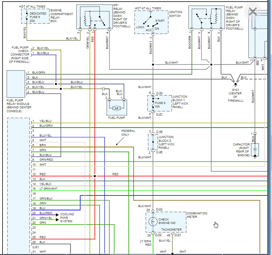

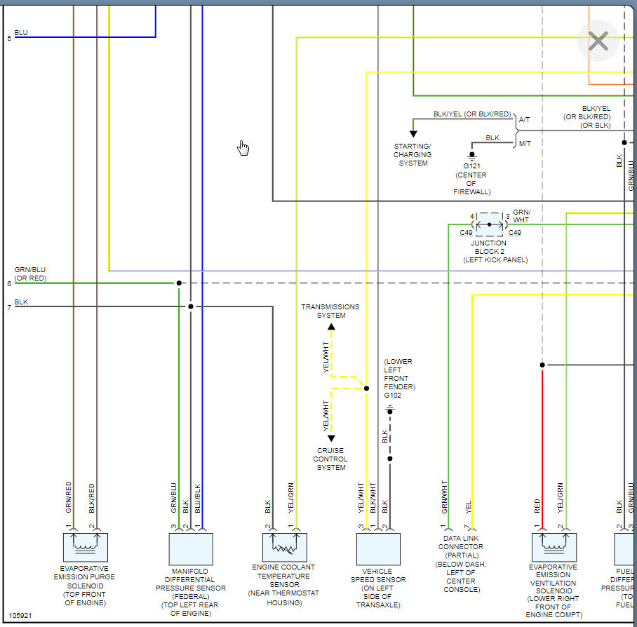

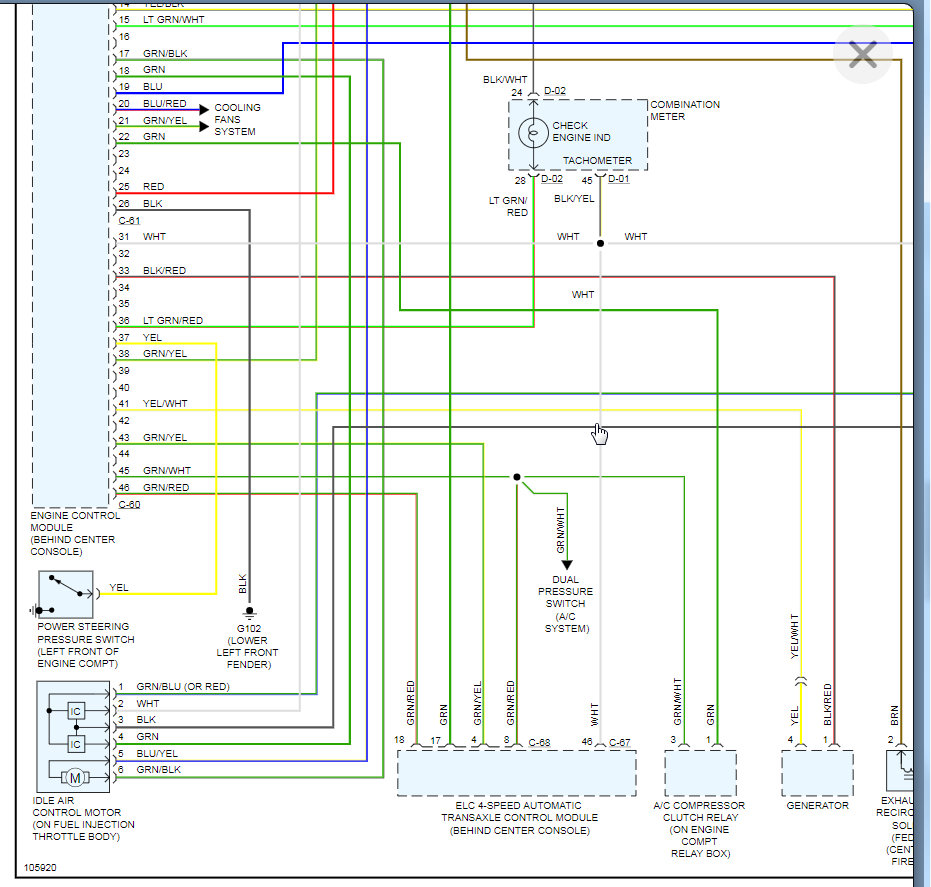

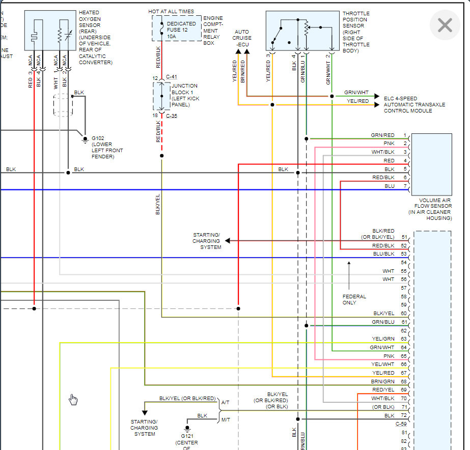

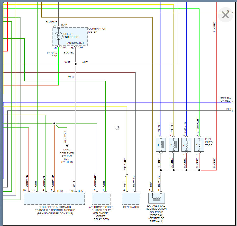

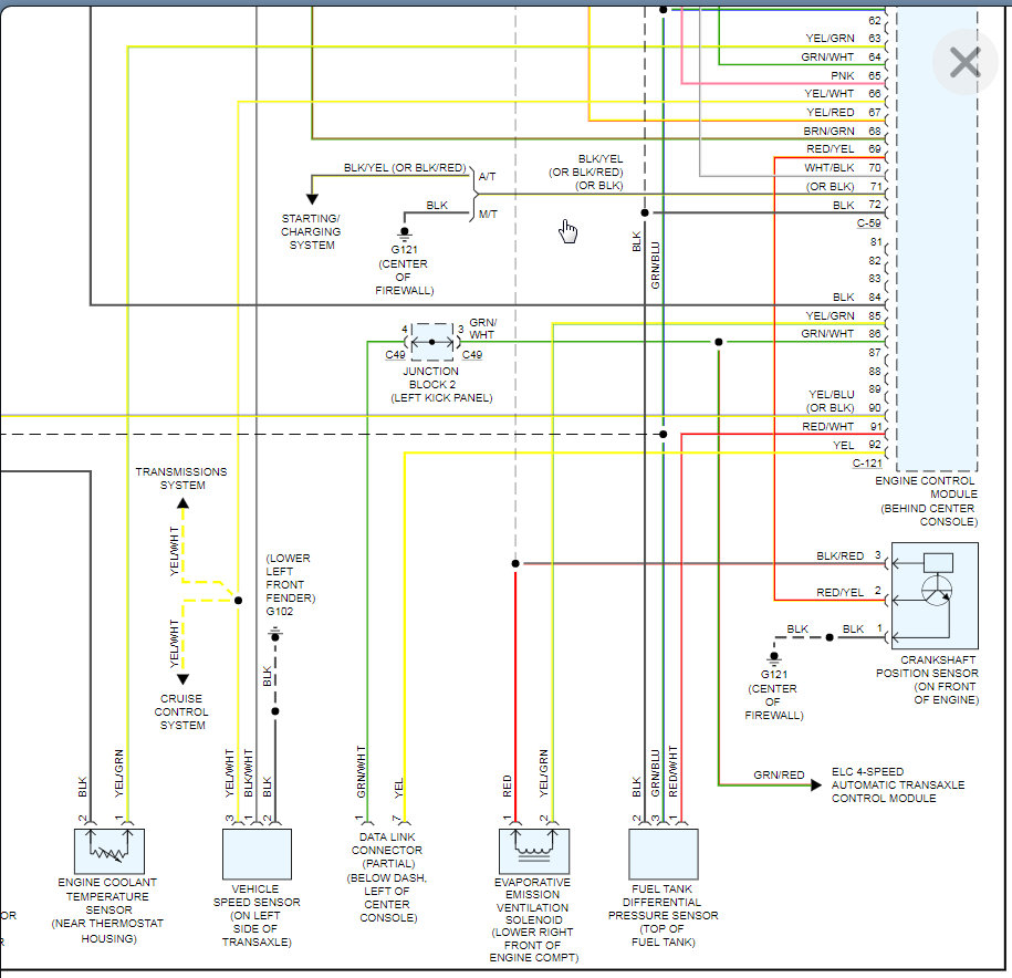

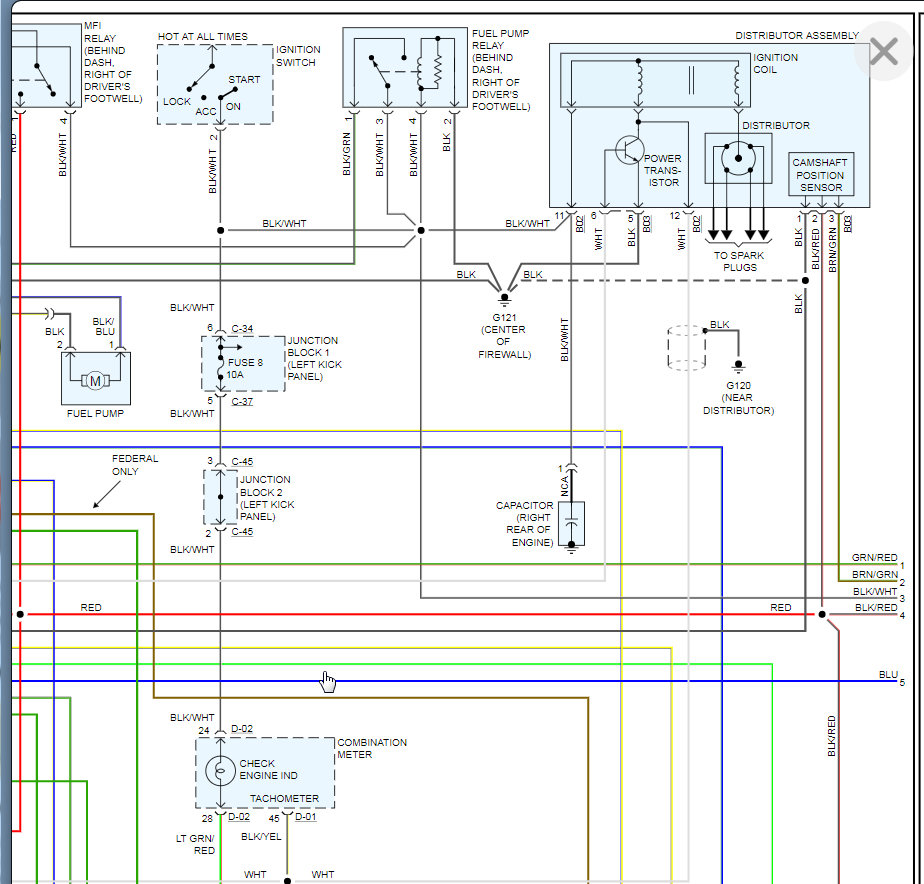

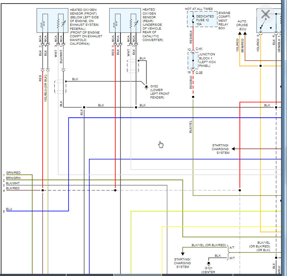

Do you have link that gives a free complete circuit wiring diagram for whole vehicle or the engine circuitry components. In particular the ECU?
Sunday, January 12th, 2020 AT 5:28 PM
We use AllData and Mitchell manuals but you do need to have a subscription. I can send you copies of what you are looking for but we don't have access for the public.
Here is the wiring diagrams for the power-train management. Keep in mind this is for a vehicle in North America so yours may differ slightly but unfortunately it is the best we can offer. These are screen shots of the diagram so they do overlap so we don't cut off a circuit by mistake.
From here, I would suggest purchasing an online subscription which will give you access to what you are looking for.
