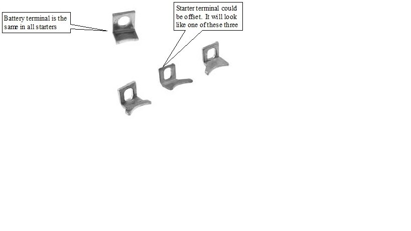

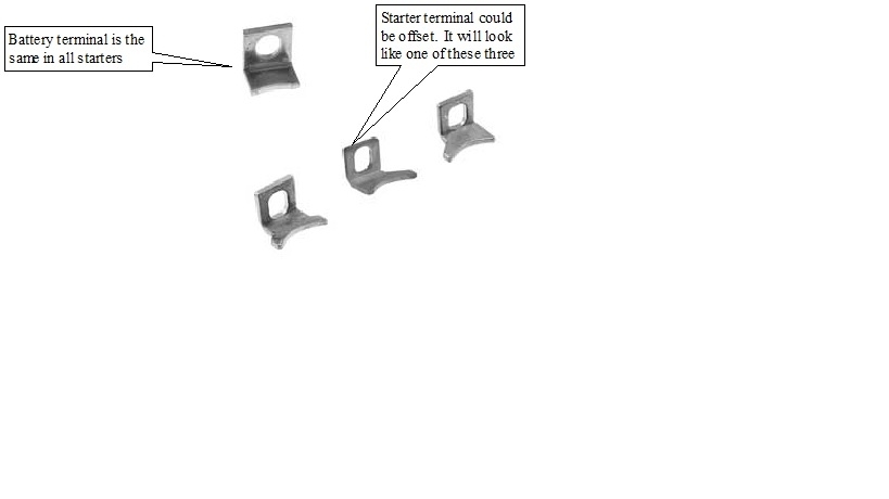

Do you hear a single, rather loud clunk from the starter when you turn the ignition switch to "crank"? Then, if I understand correctly, you release the switch, then turn it to "crank" again, and the starter works properly? If I have that right, this has nothing to do with sensors or the ignition switch. This has been an extremely common problem with Nippendenso starters on Chrysler products and Toyotas. Most people just replace the starter motor, but if you have a local starter / generator rebuilder near you, the repair parts cost less than ten dollars. You may find repair kits at some farm and home stores or hardware stores too.
The repair involves replacing the burned-away contacts inside the starter solenoid. The repair kits come with four of them. You only use the two that match those you remove, as shown below. The contact that's bolted to the battery cable is the same on all starters, all years. For the other three, the only way to know for sure which one you need is to compare the old one. Some repair kits list which contact to use for which year, but you can't rely on that. The starters interchange among all years and engine sizes, so you could have a rebuilt starter on your engine now from a different year.
The repair kits also come with a plunger with its built-in contact. There are three versions of that. The center stem that pushes on the drive gear is 1/8th inch longer in some starters. Here again, you have to compare the old one to get the right new one. There is a third, much longer plunger for Toyota starters, but I've never seen those available as a rebuild kit. You have to get those right from the Toyota dealer's parts department. If you're buying the contacts from a local rebuilder, don't bother with that plunger. I've repaired dozens of these starters, but I've never needed to replace the plunger. That contact doesn't burn away.
Eventually this problem gets worse and worse over time. When this happened to my mother's '95 Grand Caravan, I ignored her complaints for about six months. The last straw was when she lost count after turning the ignition switch over 700 times, with a blister on her thumb, but it did finally start. You can be sure I heard about it that night.

Nope, this is not the brushes. The motor itself is fine. It's the contacts in the solenoid that commonly burn away. The solenoid still engages the drive gear to the ring gear, but then the contacts are supposed to turn current flow on through the motor. It's those contacts that stop the motor from running.
This always starts out as a very intermittent problem. It might act up once a week for a few weeks, then it acts up once every other day for a while. It gets progressively worse and worse over a few months.

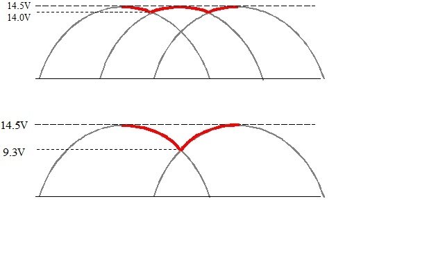

Previously, the discussion revolved around "ripple voltage". My drawing below shows what that looks like. A properly working alternator's output voltage looks like the top waveform. At any time, one of the three phases is developing its voltage, and therefore, current. Three-phase output is very stable and efficient. The red line shows the ripple voltage of 0.5 volts. That's the difference between the low and high points. It's very easy for the battery to smooth that out to roughly 14.3 volts.
In the lower waveform, one phase has been lost due to a failed diode. Here the ripple voltage is 5.2 volts. Remember, most professional testers will just show that as "high", not as an actual measured voltage. The changes in voltage aren't actually what causes problems because the battery is still there to supply some current when the alternator drops out. The problem is the drop in voltage, (pressure), is what causes a drop in current, (flow). When current flows through a wire, it sets up a magnetic field around that wire. Also, when a magnetic field surrounds another wire, it "induces" a voltage in that wire which again, causes current to flow in it. The pulsing current in the first wire creates a pulsing voltage in the second wire, and if that second wire is the signal wire for an engine sensor, it's very easy for a computer to perform the wrong calculations or produce incorrect outputs. One of those unusual reactions could be erratic idle speed.
Another concern has to do with how voltage regulators react to excessive ripple voltage. Some see the 14.5 volts as perfect, and try to maintain that, not realizing when it drops to 9.3 volts, current is also going to drop too low. The battery has to make up the difference as it slowly discharges over days or weeks. This is where the charging voltage appears to be fine, but under the full load output current test, the alternator can't develop more than one third of its rated capacity. You can do that voltage test yourself, but it's why that has to be followed up with the professional tests.
Some voltage regulators respond to the 9.3 volts and try to make the alternator work harder to get it back up to the acceptable range. Remember, an alternator can not develop more current than it is rated for, but it can develop a much higher output voltage. In this case, to get the low points up to at least 13.75 volts, the high points could exceed 18 to 20 volts. The average a voltmeter would show could be a perfect 13.75 to 14.75 volts, but 20 volts is reaching the point where computers can be damaged. The only thing that may prevent damage is the battery is trying to hold system voltage down.
