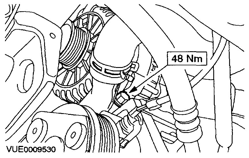

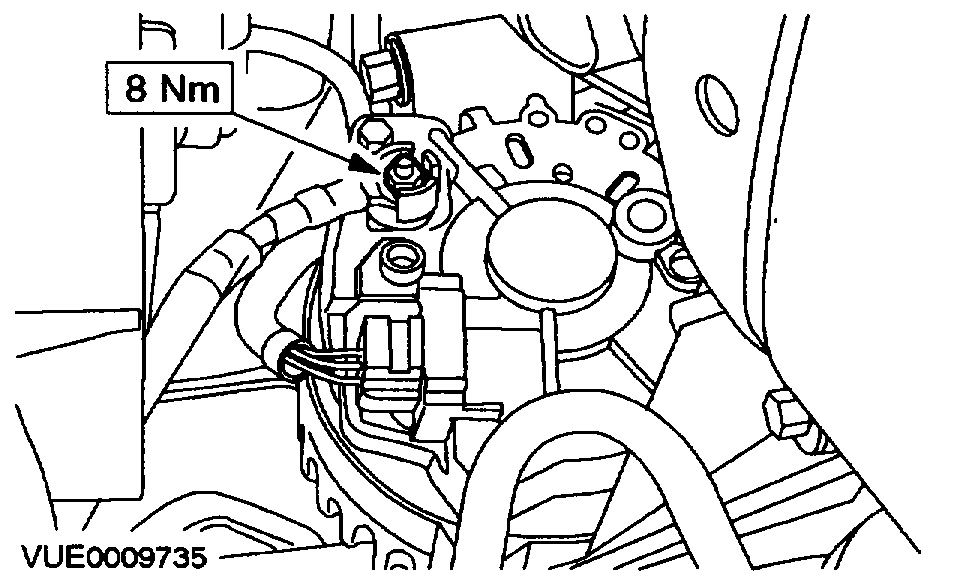

I'm only getting 11.5 volts from the alternator. checked the grounds all good. it's showing a code p1151.
Jun 21, 2019 at 5:45 AM
  • 110,194 POSTS
Welcome to 2CarPros.
You have two unrelated issues. The trouble code indicates an issue with a heated oxygen sensor, and the alternator sounds like it's bad.
Now, what I suggest is to remove the alternator and have it bench tested at a parts store. Most will do it for free. Here is a link that explains how in general to remove and replace an alternator:
https://www.2carpros.com/articles/how-to-replace-an-alternator
Here is a general test you can do at home:
Here are the specific directions for your vehicle. The attached pictures correlate with the directions. Note that the directions are for a 2.0L 4 cylinder. These cars didn't have a V6 in them. If the 2.0L is wrong, let me know.

1. Remove the cooling fan motor and shroud.
2. Remove the accessory drive belt.
pic 1

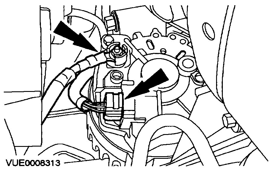

3. Remove the power steering pipe support brackets.
pic 2

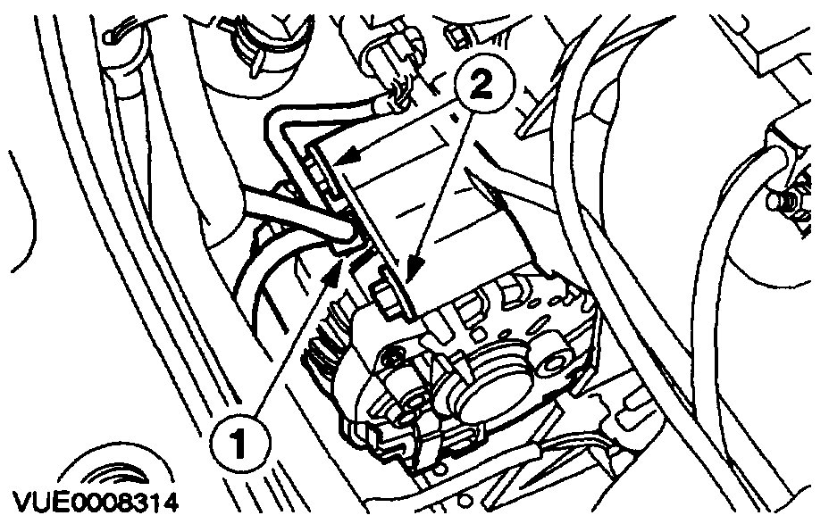

4. Remove the exhaust manifold heatshield.
5. Raise and support the vehicle.
pic 3

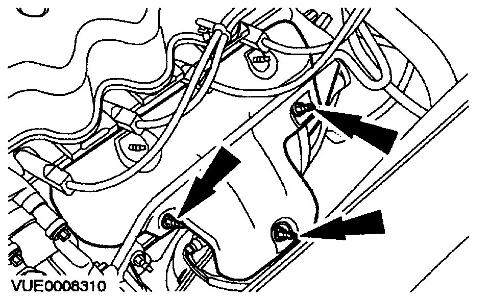

6. Disconnect the generator electrical connectors.
pic 4

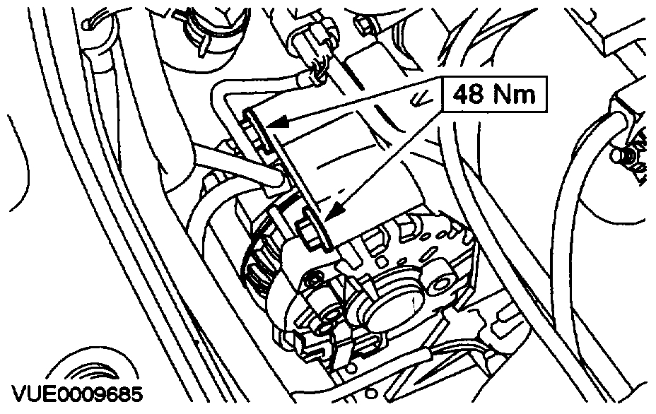

7. Remove the generator lower bolt.
8. Lower the vehicle.
pic 5

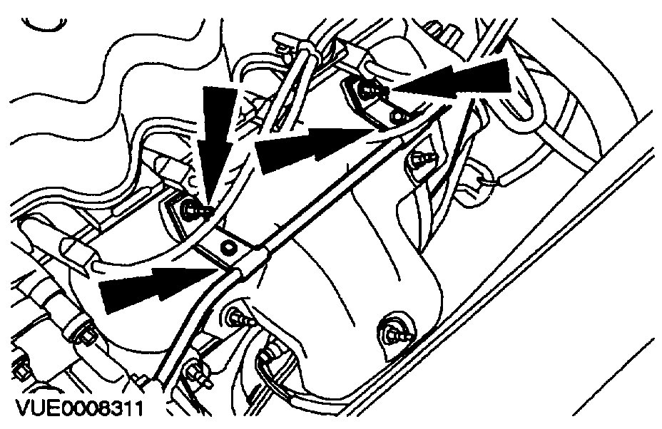

9. Remove the generator.
1 Disconnect the clip.
2 Remove the generator bolts.
INSTALLATION
pic 6
pic 7
pic 8
1. To install, reverse the removal procedure.
__________________________________
What I suggest is if the alternator fails a bench test, replace it, clear the trouble code, and then see if the code for the O2 sensor comes back. It could have to do with low voltage.
