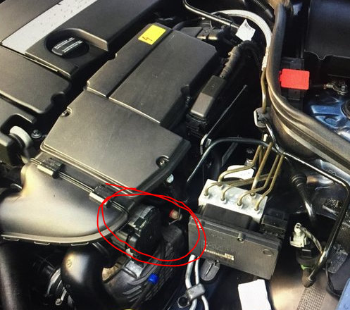

The issue is that I was going by my US spec manual for that C230.
You are not in US correct?
So I will have to assume you have the Euro spec C230, which has different smog/emission related component.
After doing some more checking. I believe this is the secondary air pump for your C230 (picture below).
Can you confirm if that part has a tubing that goes to the intake?
Sunday, August 1st, 2021 AT 5:17 PM
VIVEKHB
  • 89 POSTS

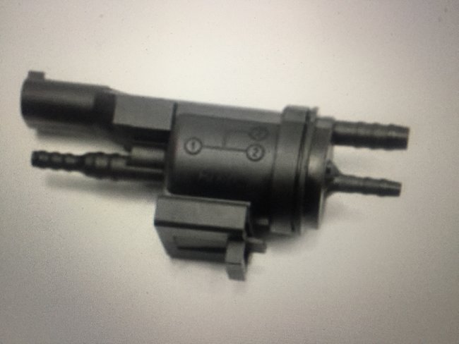

Sir, I am from Montreal, Canada. The part you circled in red is the throttle body.
I recollect very well that the vacuum valve solenoid has three rubber hoses, one attaches to the intake manifold and two attach to the EGR valve, the one that I cleaned yesterday.I have attached the photos below.
Thanks once again.

Hi Joe, I am basically waiting for a reply from your part. I was asked to clean the vacuum valve on the intake side of the manifold, but I don't see any valve. Please direct me, thanks in advance.
Wednesday, August 4th, 2021 AT 1:19 PM
  • 109,885 POSTS
No problem. I read back through the threads and found a picture that you sent us. I copied it and attached it below. That is what you are looking for.

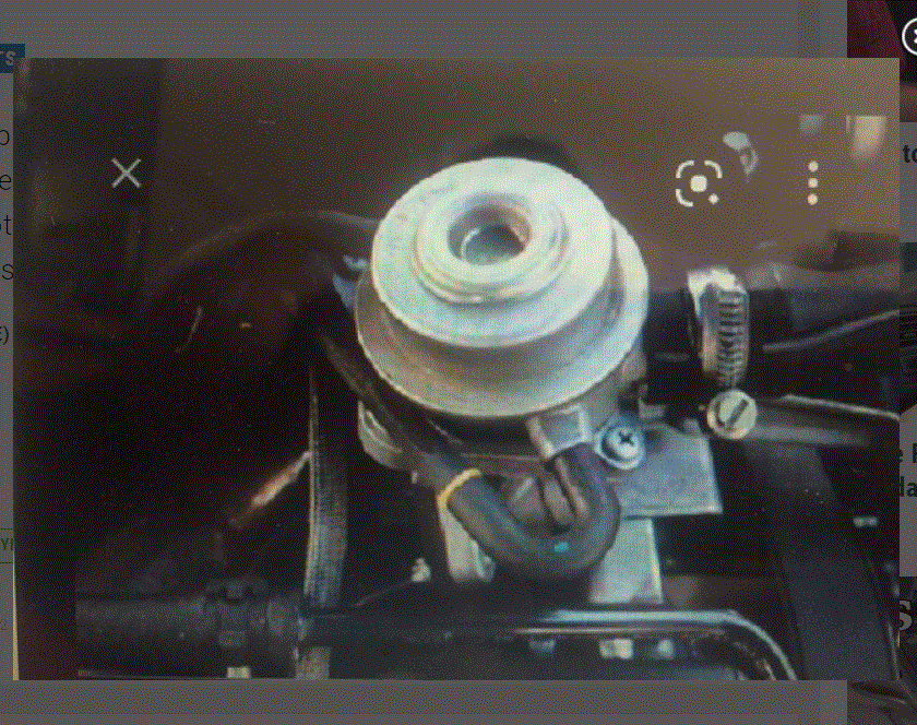

Hi Joe, I have cleaned the EGR valve and the check engine light came back after 20km.I don't see the actuator valve on the intake manifold. Please your direction is highly appreciated.
Thursday, August 5th, 2021 AT 12:51 PM
  • 52,797 POSTS
That valve is a back pressure valve, not an actuator.
The EGR gets carbon up on the shaft and you cannot access it for cleaning. The only way is to replace the valve.
Saturday, August 7th, 2021 AT 5:52 PM
VIVEKHB
  • 89 POSTS
Thank you Roy, I will change the EGR valve and let you know the outcome. Have a blessed Sunday.

Hi Roy, I replaced the EGR valve and after 32 km of driving the check engine light has come back. Please, waiting for your expert opinion.
Vivek
Thursday, August 26th, 2021 AT 5:20 PM
  • 52,797 POSTS
Is the valve being commanded open?
You can heck by accelerating the throttle from under the hood and see if the valve opens and closes.
