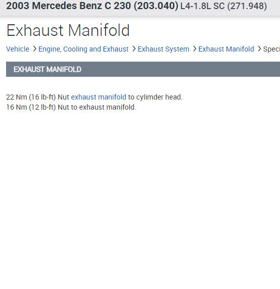

I plan on changing the exhaust manifold gasket.
Your valuable opinion is requested,as I have never changed the gasket.What more have I to remove?

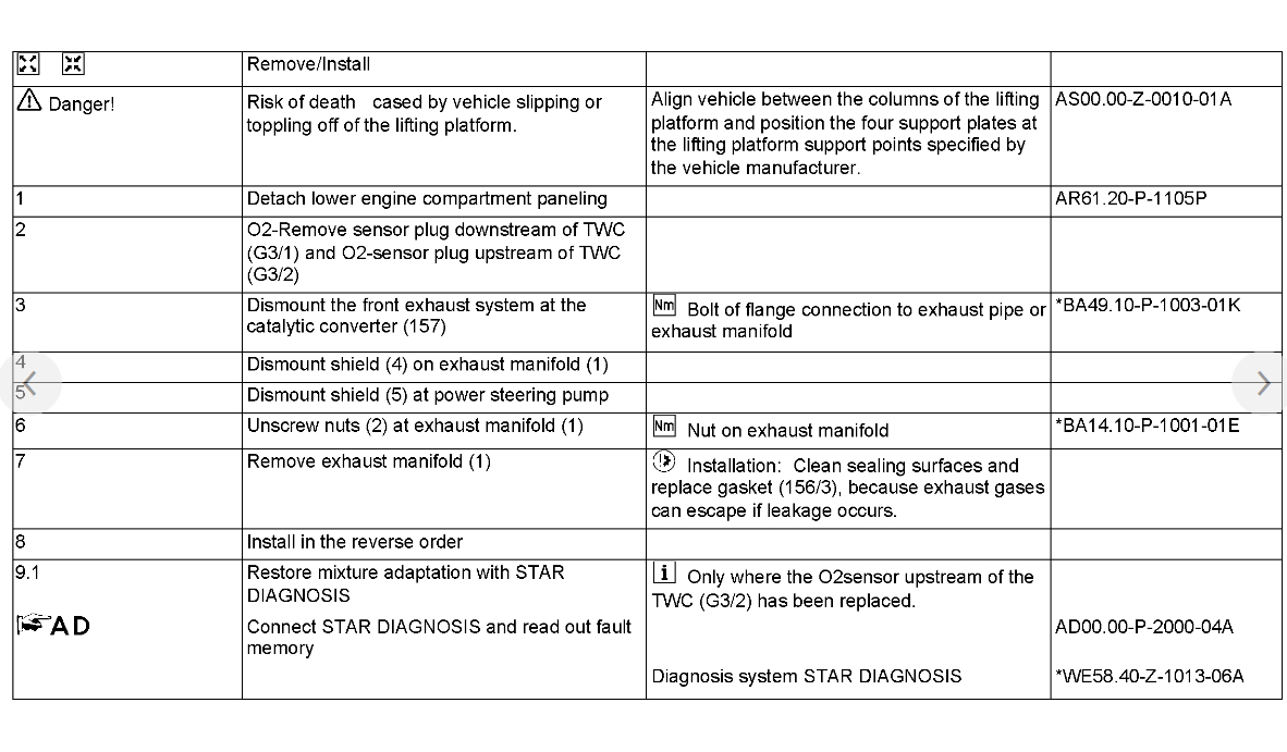

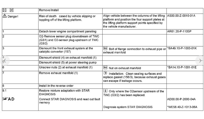

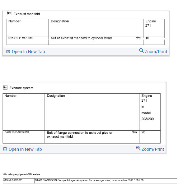

I have attached the exhaust manifold gasket replacement process for your reference.
Please let me know little more info.

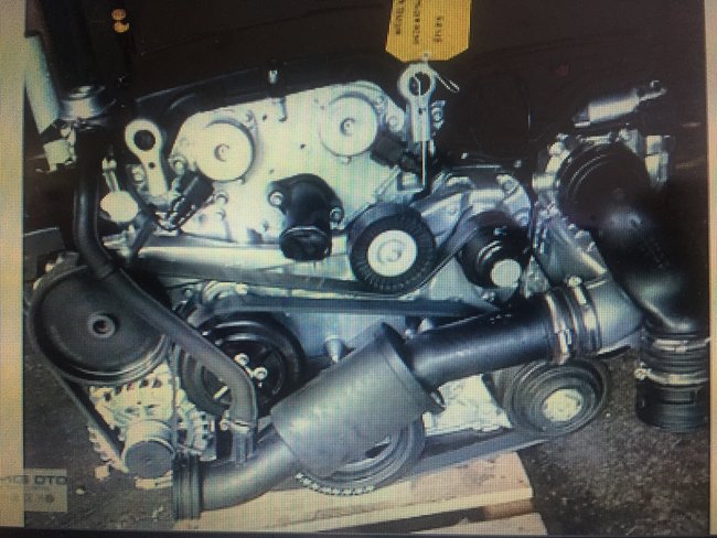

Correct. Because the C230 Kompressor is supercharged there is not another air pump.
There is a line that is diverted from the intake just before the throttle body. (look below)
That goes to a vacuum actuator, which acts as the pump. Which can still get gunky inside and cause the CEL.

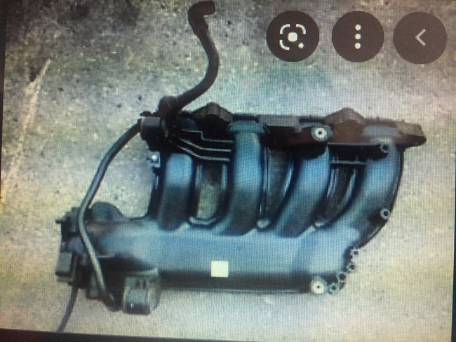

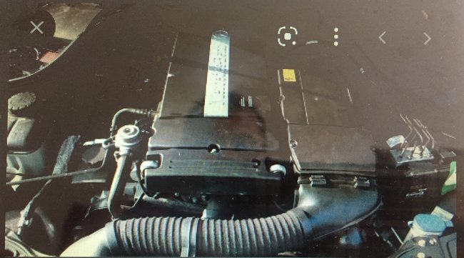

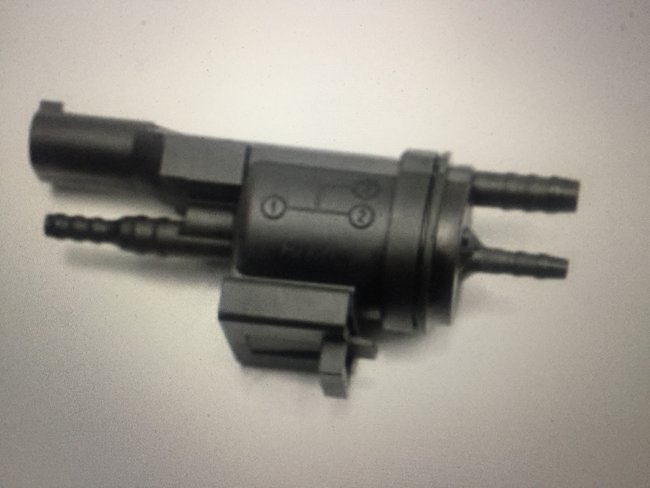

Sir,thanks for the reply .To be honest I don't see the Vacuum actuator. I took some photos that are posted on youtube that pertain to my model.Please direct me on the photos as to which line that gets gunky inside that causes CEL, that I have to disconnect and replace or can be cleaned .Thanks.
Jul 30, 2021 at 7:06 AM
SQM
  • 6,383 POSTS

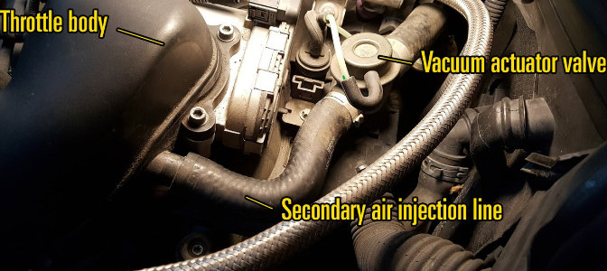

This should be that valve (see below).
It typically gets gunk built-up inside the valve. When you take the hose off, you can usually see the inside. This can be cleaned by parts cleaner, just be careful not to use too much cleaner inside.

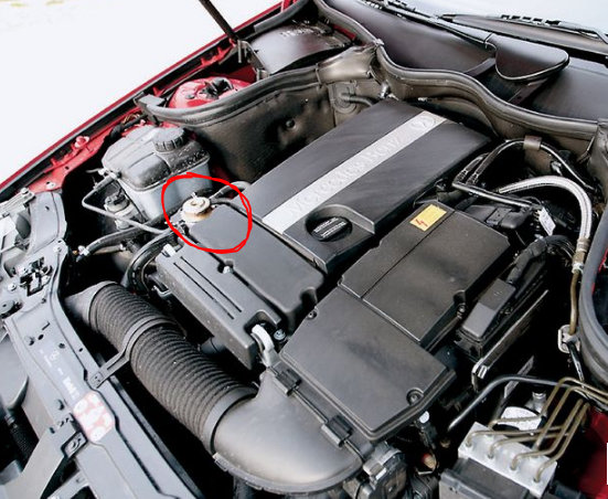

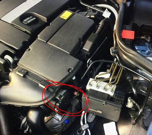

Look at the picture below. Does your engine by looks like this? Circled in red.
Jul 30, 2021 at 12:33 PM
VIVEKHB
  • 93 POSTS
Yes , it does look exactly the same.
Jul 30, 2021 at 12:34 PM
SQM
  • 6,383 POSTS
That should be the valve. Let me know the outcome after you clean it out.

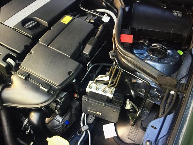

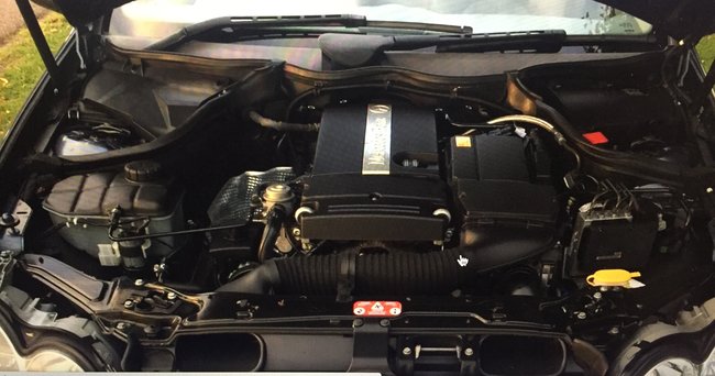

Would it be possible to upload few pictures of the engine area of your car?
Some reason I am getting conflicting information on the 2003 C230.
As that was a refresh year.
Aug 1, 2021 at 7:44 AM
VIVEKHB
  • 93 POSTS
Sir, I got the same code P0410.

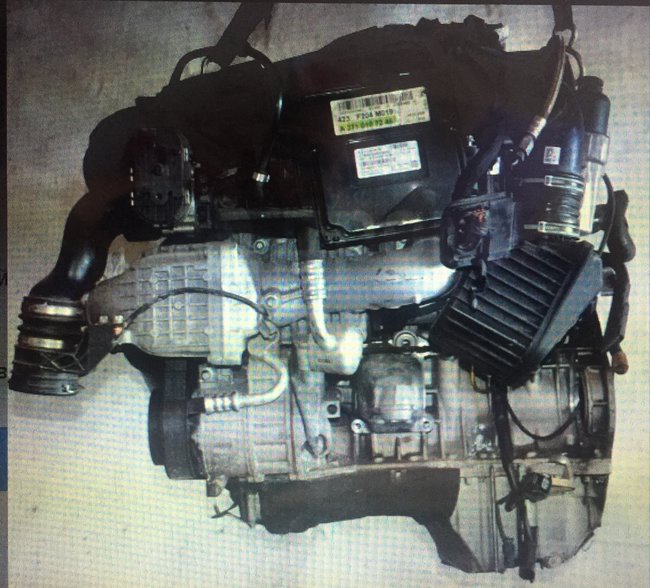

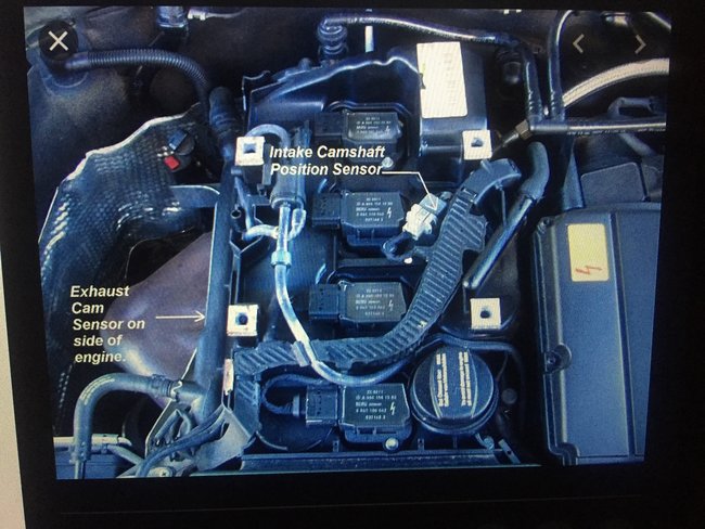

Also here are the pictures of the engine bay,thanks once again.
Aug 1, 2021 at 9:09 AM
SQM
  • 6,383 POSTS
The issue is that I was going by my US spec manual for that C230.
You are not in US correct?
So I will have to assume you have the Euro spec C230, which has different smog/emission related component.

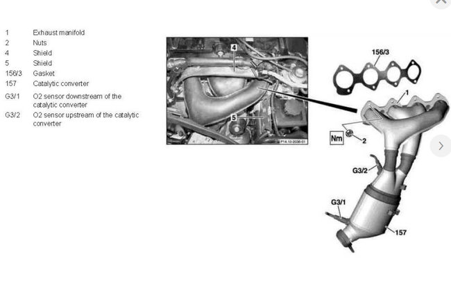

After doing some more checking. I believe this is the secondary air pump for your C230 (picture below).
Can you confirm if that part has a tubing that goes to the intake?
Aug 1, 2021 at 10:17 AM

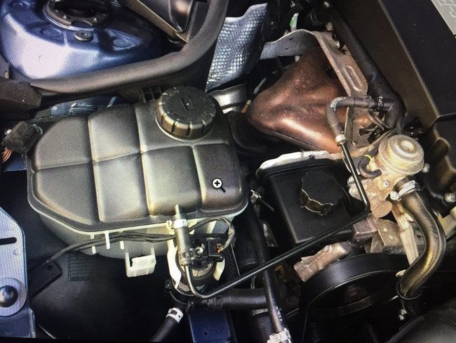

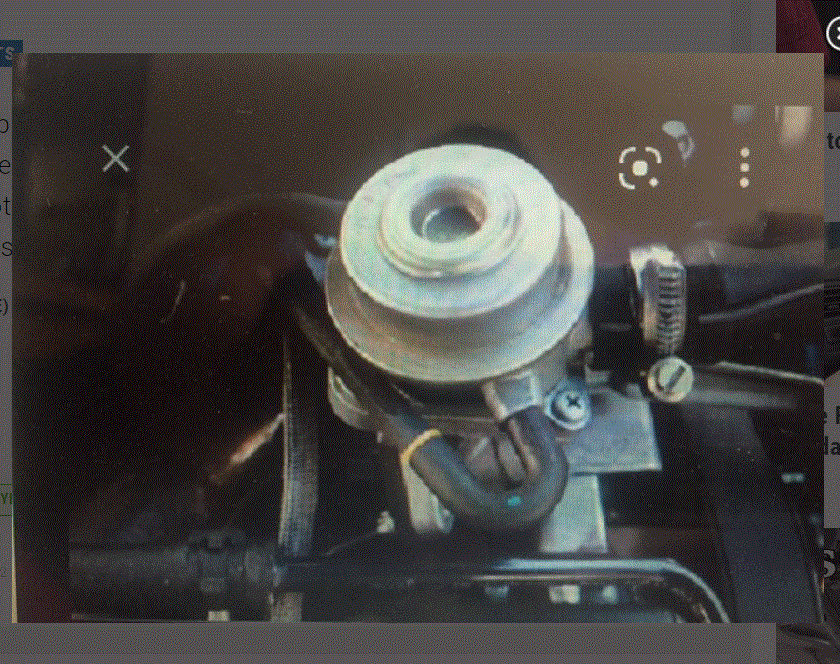

VIVEKHB
  • 93 POSTS

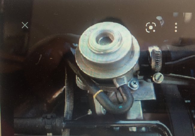

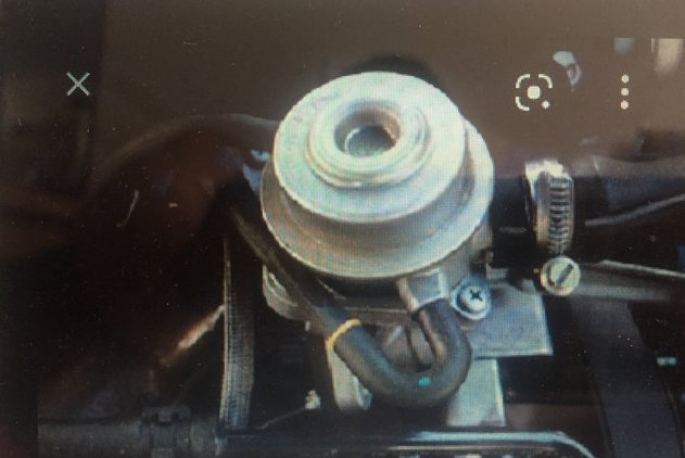

Sir, I am from Montreal,Canada.The part you circled in red is the throttle body.
I recollect very well that the vacuum valve solenoid has three rubber hoses ,one attaches to the intake manifold and two attach to the EGR valve, the one that I cleaned yesterday.I have attached the photos below.
Thanks once again.

Hi Joe, I am basically waiting for a reply from your part. I was asked to clean the vacuum valve on the intake side of the manifold, but I don't see any valve. Please direct me, thanks in advance.
Aug 4, 2021 at 6:19 AM
  • 110,244 POSTS
No problem. I read back through the threads and found a picture that you sent us. I copied it and attached it below. That is what you are looking for.
Aug 4, 2021 at 3:10 PM
VIVEKHB
  • 93 POSTS
Hi Joe , I have cleaned the EGR valve and the check engine light came back after 20km .I don't see the actuator valve on the intake manifold .Please your direction is highly appreciated.
Aug 5, 2021 at 5:51 AM
That valve is a back pressure valve, not an actuator.
The EGR gets carbon up on the shaft and you cannot access it for cleaning. The only way is to replace the valve.
Aug 7, 2021 at 10:52 AM
