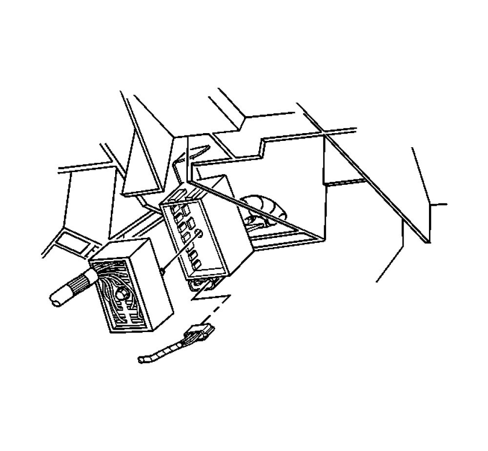

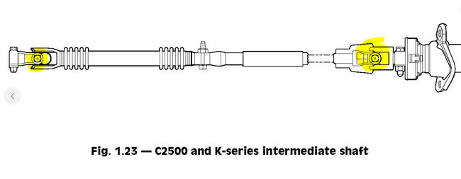

I have heard the the noise when making left turn and small bumps at low speed is due to the plastic bearing in the column, and also the intermediate shaft is also a common problem. Are the any know fixes for the intermediate shaft issue, short of buying a new one? I'm going to replace the plastic bearing in the column.
Nov 26, 2020 at 10:13 AM
  • 110,194 POSTS
Is the sound under the dash? As far as the intermediate shaft, there is a universal joint at each end which can wear out and cause play in the steering and noise. I attached a pic below and highlighted the joints. Check them for play. Note: If it has excessive play, it should be replaced.

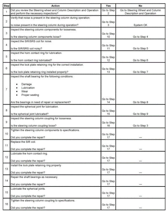

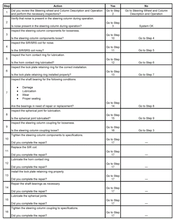

If the noise is from the steering column area, pic two below provides a diagnostic flow chart to identify the problem.

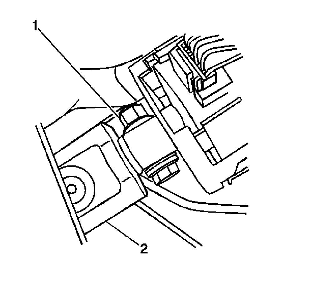

Here are directions for removal and replacement of the column. I'm adding them in the event you take it completely out of the vehicle. The remaining pics correlate with the directions.
_________________________________________
2004 Chevy Truck Silverado 1500 4WD V8-5.3L VIN T
Steering Column
Vehicle Steering and Suspension Steering Steering Column Service and Repair Removal and Replacement Steering Column

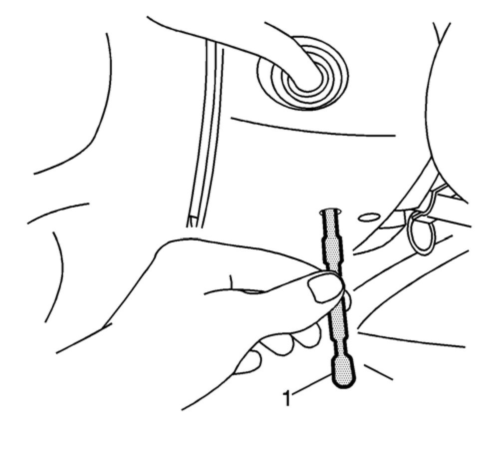

Notice: With wheels of the vehicle facing straight ahead, secure the steering wheel utilizing steering column anti-rotation pin, steering column lock, or a strap to prevent rotation. Locking of the steering column will prevent damage and a possible malfunction of the SIR system. The steering wheel must be secured in position before disconnecting the following components:
- The steering column
- The intermediate shaft(s)
- The steering gear
After disconnecting these components, do not rotate the steering wheel or move the front tires and wheels. Failure to follow this procedure may cause the SIR coil assembly to become un-centered and cause possible damage to the SIR coil. If you think the SIR coil has became un-centered, refer to your specific SIR coil's centering procedure to re-center SIR Coil.
3. Lock the steering column through the access hole in the lower trim cover using J 42640.

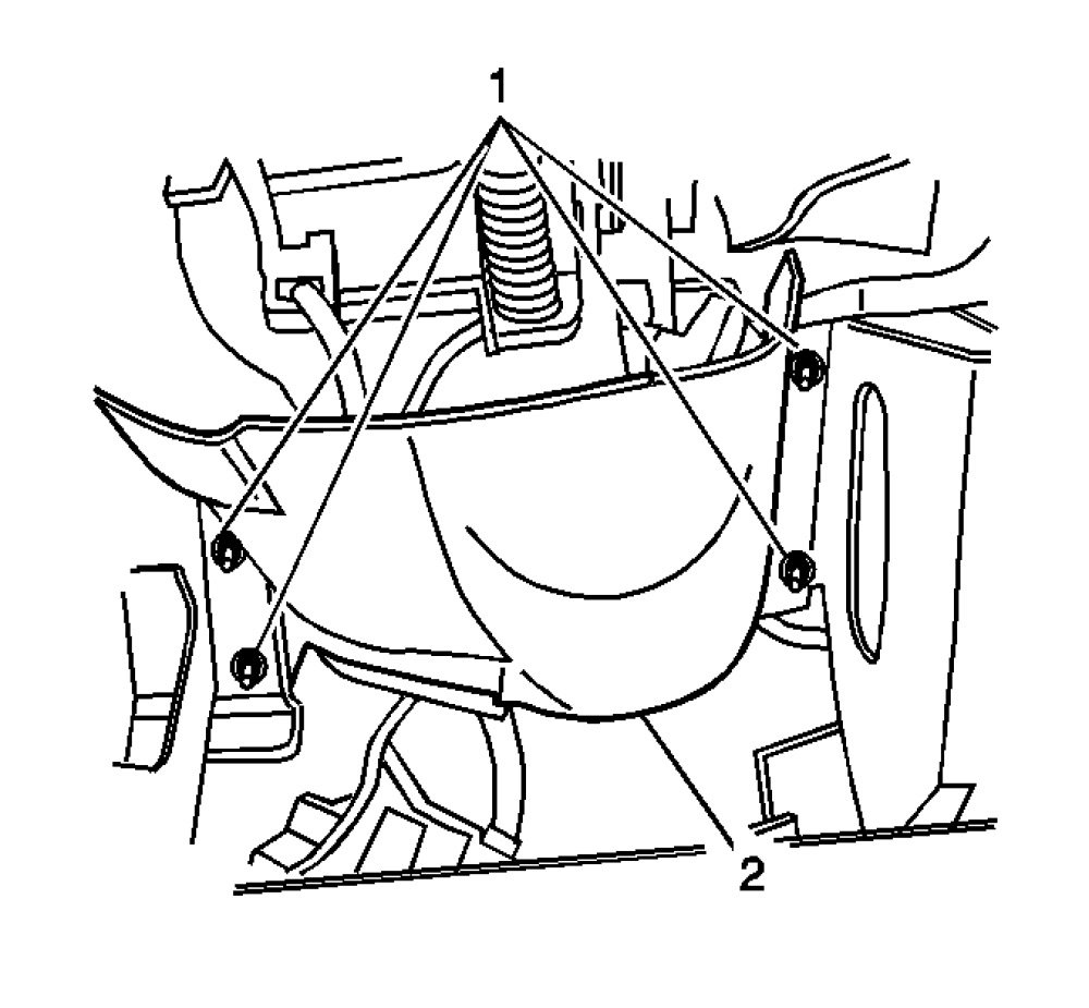

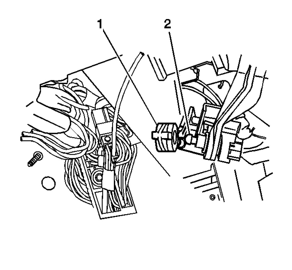

4. Remove the body control module bracket. Do not disconnect the harness from the body control module. Refer to Body Control Module Replacement See: Body Control Module > Removal and Replacement.
pic 4

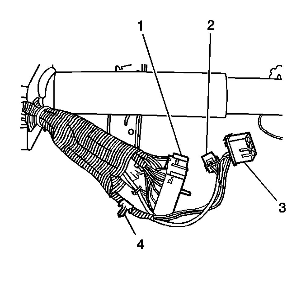

5. Disconnect the transmission shift cable (1) from the column.
pic 5

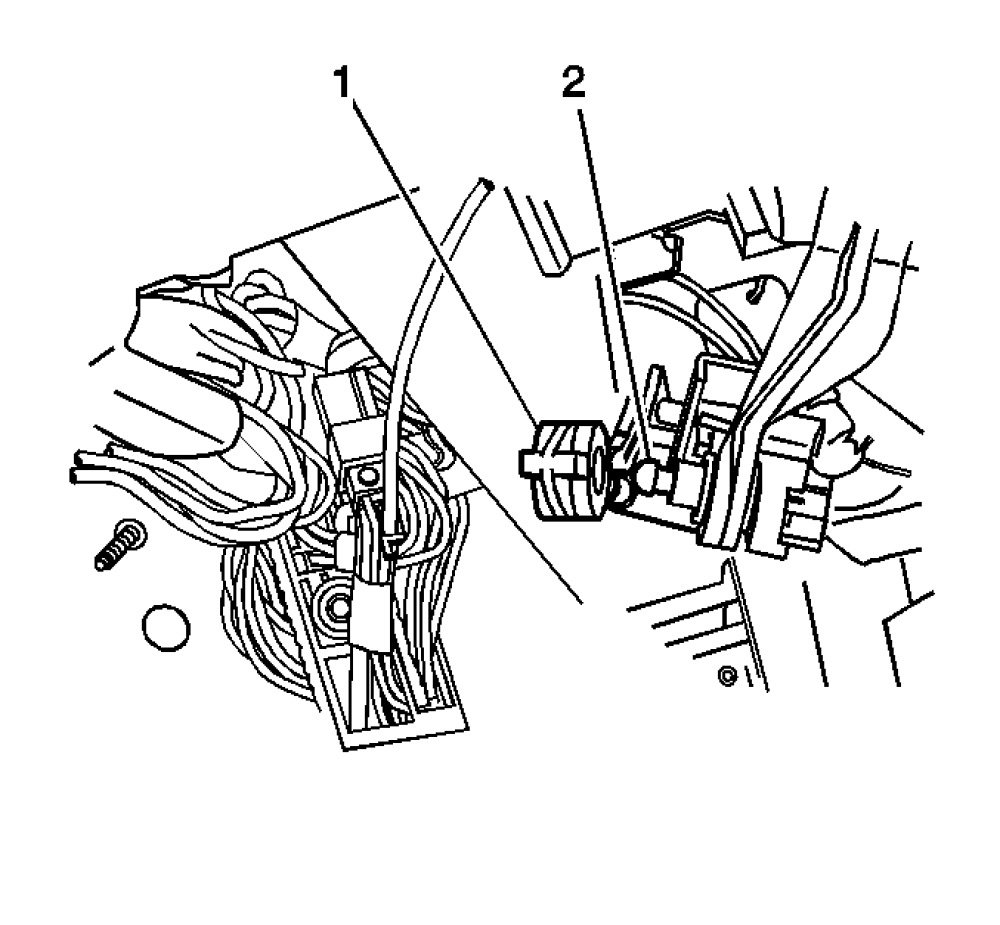

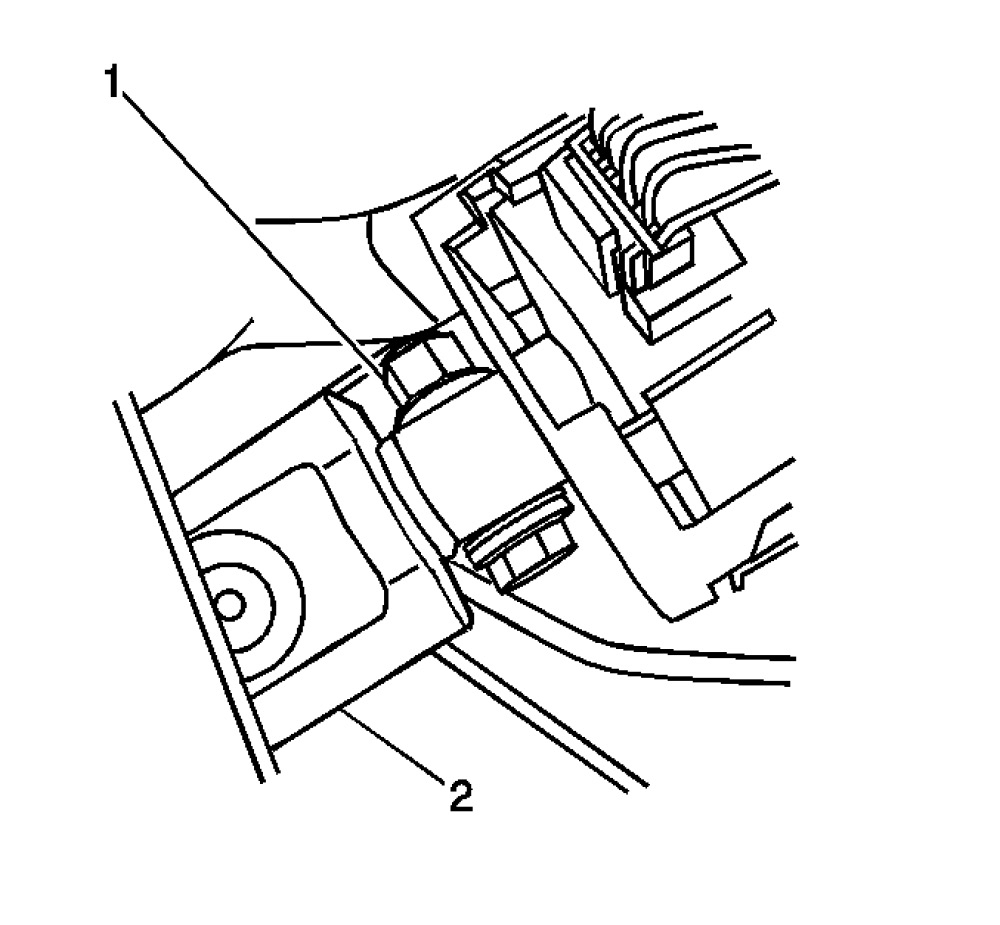

6. Disconnect the steering column electrical connectors.
pic 6

9. Remove the nuts (1) from the knee bolster deflector.
pic 9

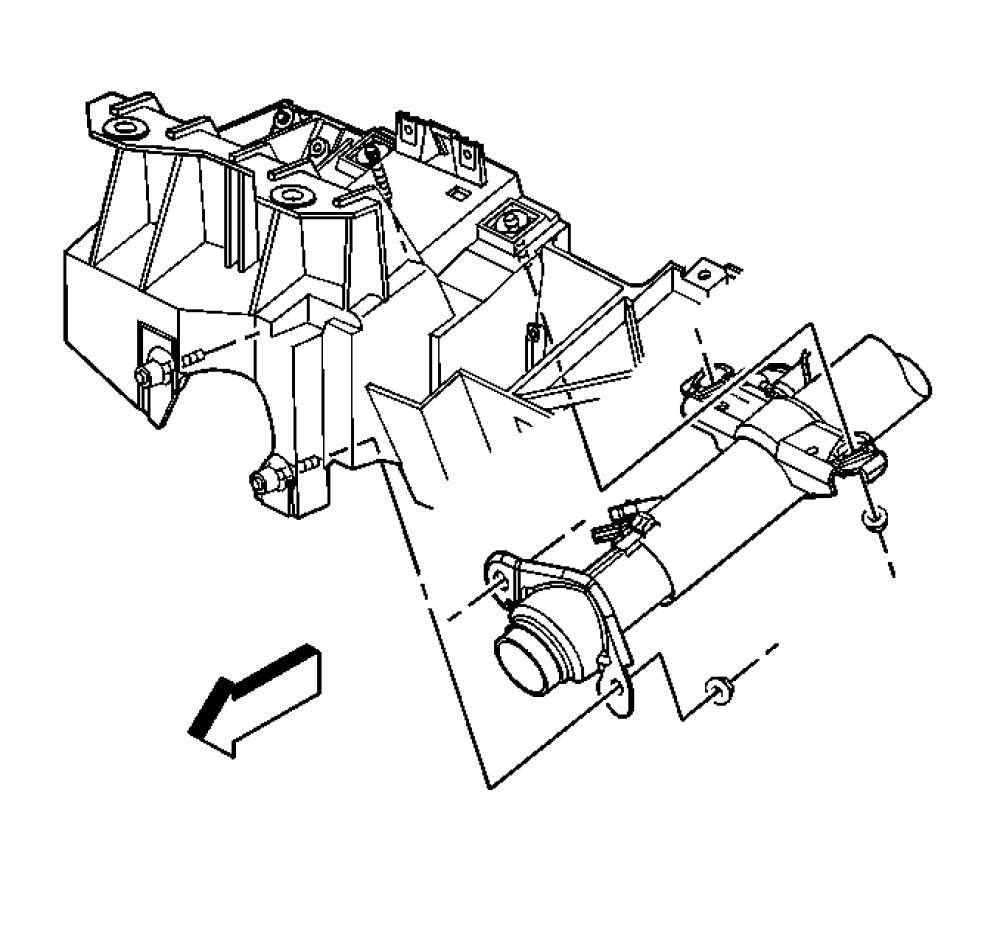

10. Remove the nuts from the upper support brackets.
11. Remove the nuts from the lower support brackets.
Notice: Once the steering column is removed from the vehicle, the column is extremely susceptible to damage. Dropping the column assembly on the end could collapse the steering shaft or loosen the plastic injections, which maintain column rigidity. Leaning on the column assembly could cause the jacket to bend or deform. Any of the above damage could impair the columns collapsible design. Do NOT hammer on the end of the shaft, because hammering could loosen the plastic injections, which maintain column rigidity. If you need to remove the steering wheel, refer to the Steering Wheel Replacement See: Steering Wheel > Procedures.
12. Remove the steering column from the vehicle.

1. Install the steering column to the vehicle.
Notice: Use the correct fastener in the correct location. Replacement fasteners must be the correct part number for that application. Fasteners requiring replacement or fasteners requiring the use of thread locking compound or sealant are identified in the service procedure. Do not use paints, lubricants, or corrosion inhibitors on fasteners or fastener joint surfaces unless specified. These coatings affect fastener torque and joint clamping force and may damage the fastener. Use the correct tightening sequence and specifications when installing fasteners in order to avoid damage to parts and systems.
2. Install the lower column nuts.
Tighten
Tighten the nuts to 30 Nm (22 lb ft).
3. Install the nuts to upper support brackets.
Tighten
