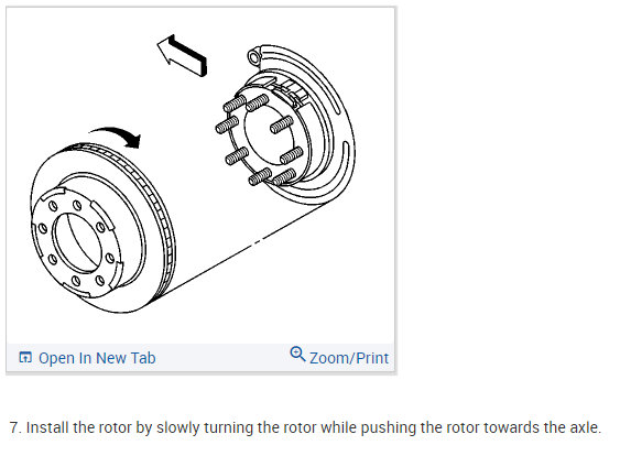

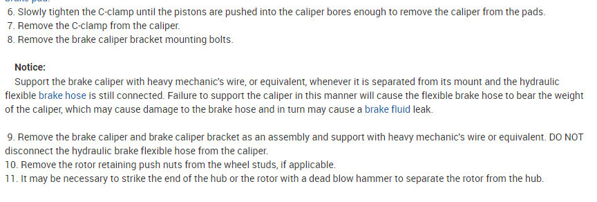

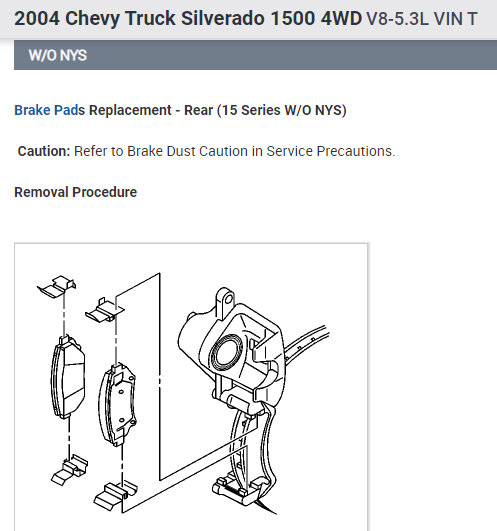

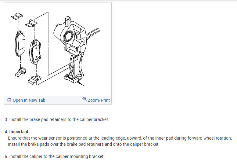

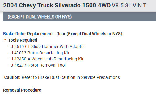

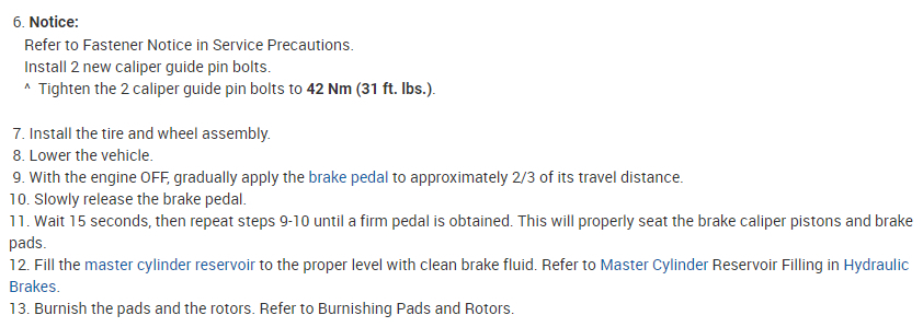

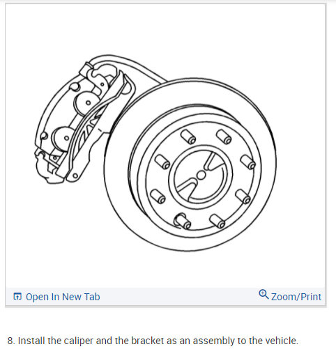

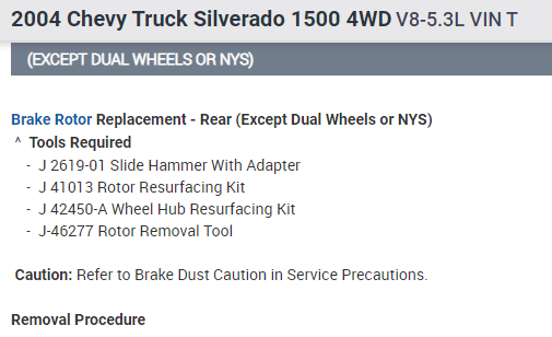

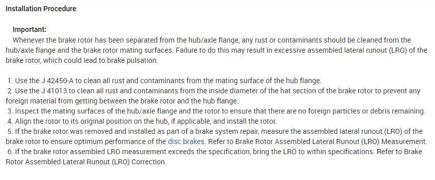

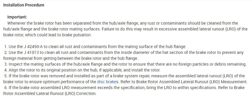

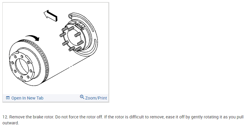

i have been hearing squeaking sounds from the rear when I hit the brakes. i was told that it could be the brakes can you help me change them out?
Nov 7, 2009 at 2:04 AM
DANNY L
Experienced Mechanic
5,648 POSTS
Hello, I'm Danny.

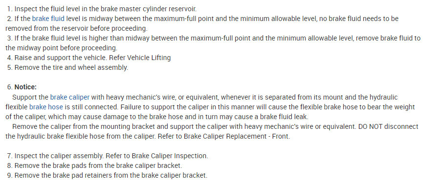

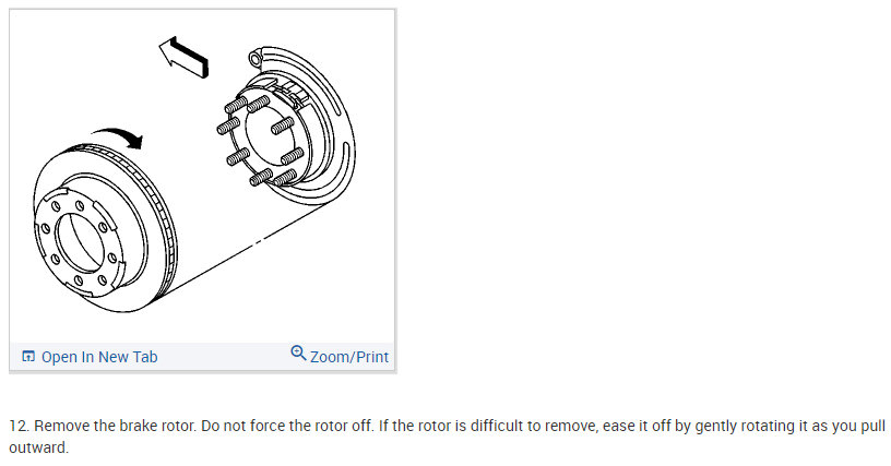

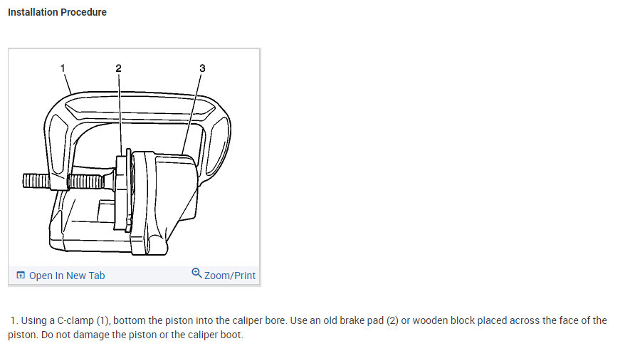

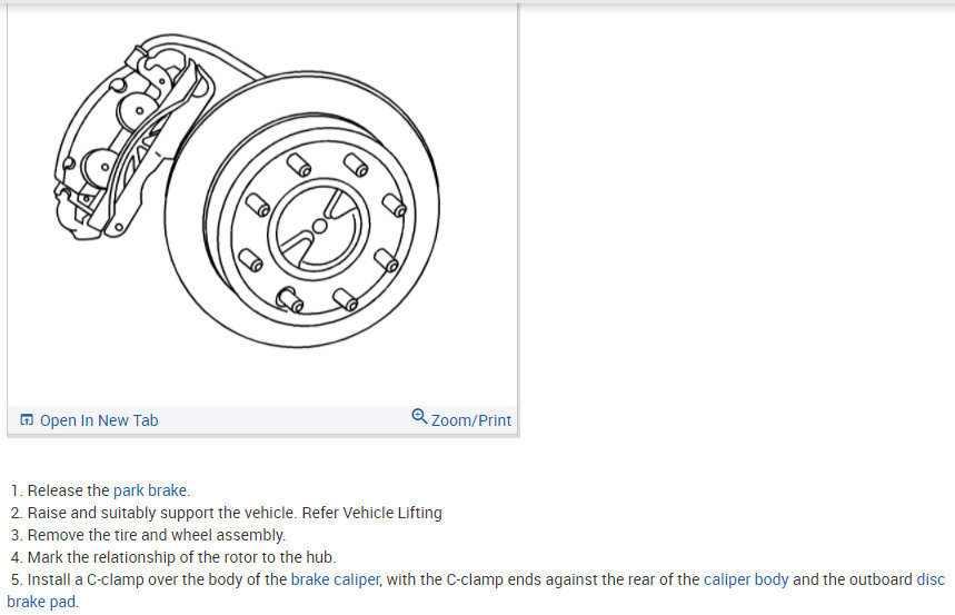

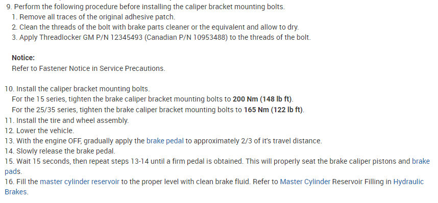

Here is the information you requested. Here is a tutorial showing how to replace rear brake pads:
https://www.2carpros.com/articles/how-to-replace-rear-brake-pads-and-rotors
I've attached picture steps below on how to replace the rear brake pads and rotors on your Silverado. Hope this helps and thanks for using 2CarPros.
Images (Click to enlarge)
