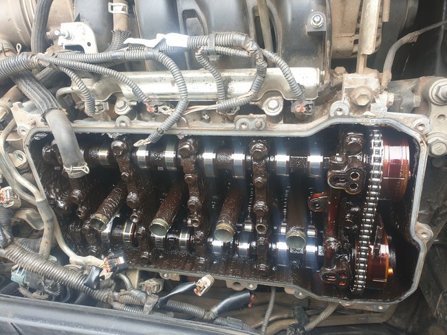

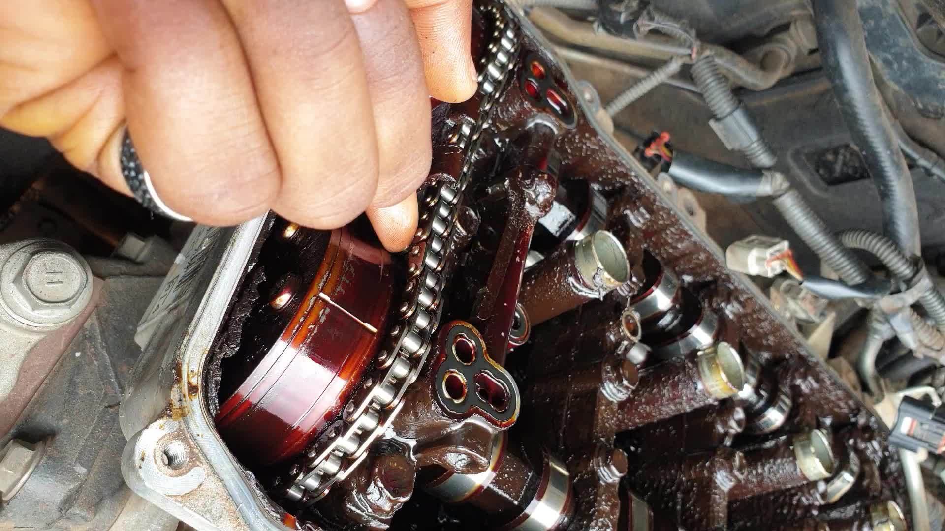

I just bought a fairly used car listed above 2011-2012 model. When I took it for a test drive, I heard noise when I accelerate which then smooths out as I drive on until I brake again and try to accelerate, this noise seems to be coming from under the hood on the passenger side. I bought the car regardless thinking it could be exhaust issues and traveled with it. the sound continued all through the nine hours travel but no new issue developed and I seem to get good gas mileage. The next morning I honestly did not do oil checks before takeoff, I had hardly driven for five minutes when low oil pressure light came on, I packed almost immediately less than 300 m after, bought a liter Total oil (20W) and added approx. 0.5ltr which turned out to put the oil at over-gauge, the low oil pressure light went off anyways, even though I didn’t try to run or drive the car any further before adding the oil perhaps the warning light will go off by default. After that event, I began to notice intermittent low engine power, whereby I will match on the gas and the car would drag, then it might later pick after a long drag, it jacks into gear at times after a noisy rev. At whatever RPM while in motion, the car experiences difficulty to climb but runs smoother coming down a cliff.
I think it’s important to mention that the noise from under the hood is still there, and note; no Check Engine Light (the function works, came on when one of the spark plugs was removed for servicing).
When I went for computer diagnosis, code P0016 and P0017 came up which could be erased, but set back.
An oil change was performed yesterday to a synthetic 5W-30 oil, right fill, the filter was changed and the sump was opened to clean the oil pump mesh. The VVT Solenoid/sensor was cleaned off clogs, the air filter was observed and cleaned, the spark plugs too were cleaned, but with all that done, the rattling/tapping noise like of a chain, on the passenger side of the car from under the hood persists and the car does not pick up/accelerate correctly still, also there is a lot of noise (generally) maybe from transmission shifting delay or so, like the car is under an opposite directional drag. The most annoying thing is, there is still no check engine light.
I plan to service the transmission soon.
Additionally the car was earlier diagnosed to have exhaust Restrictions by one of my local mechanics and the catalytic converters housing were opened up and the content were emptied, the container was closed back up/welded and the exhaust reinstalled without catalytic converters, pending when I can afford a replacement. I still have doubts the catalytic converters were due for a change anyways. Their claims was that, back pressure was the cause for the low engine power which was my complaint from the start.

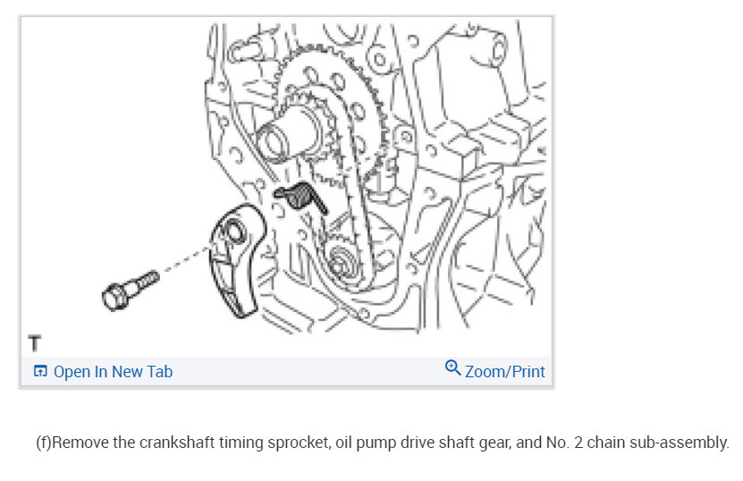

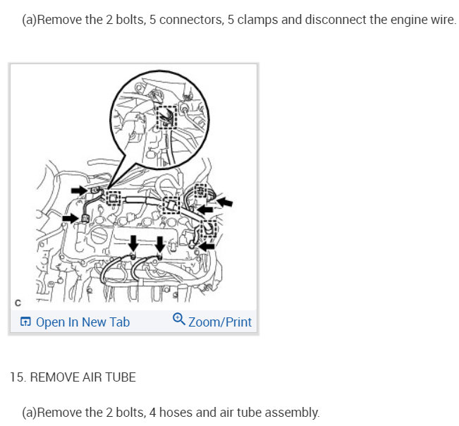

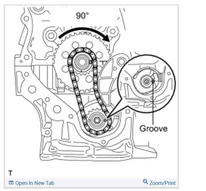

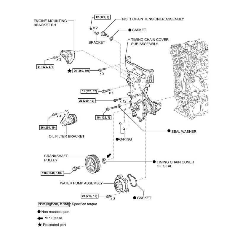

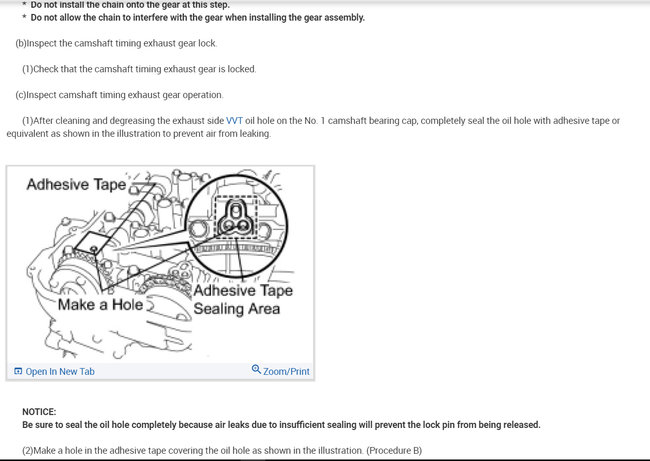

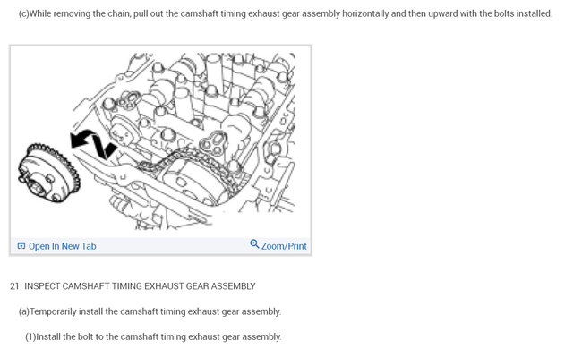

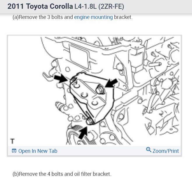

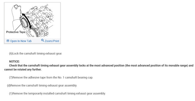

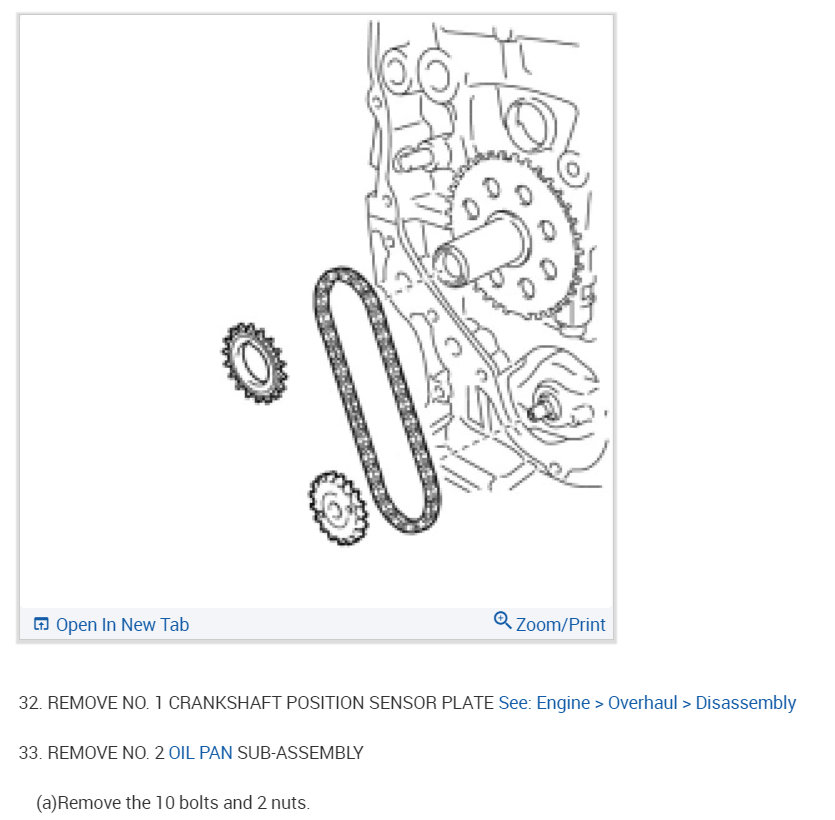

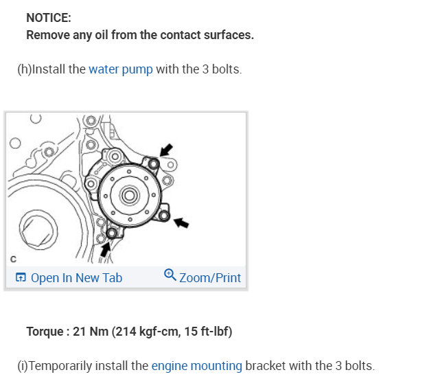

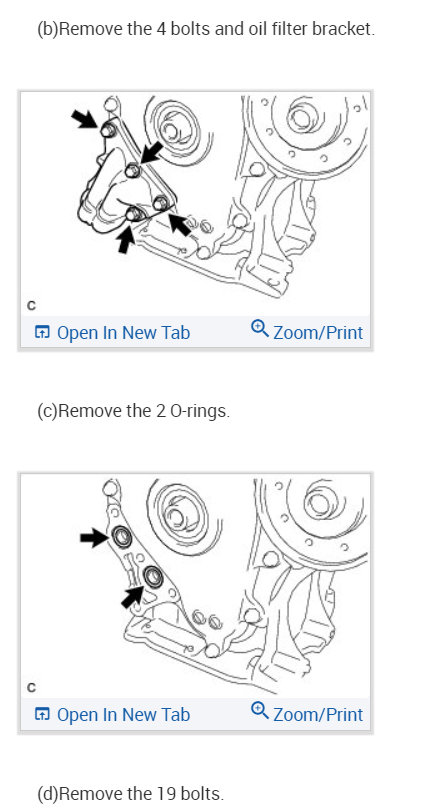

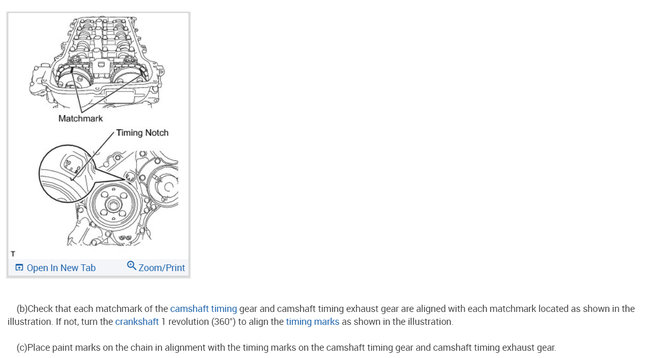

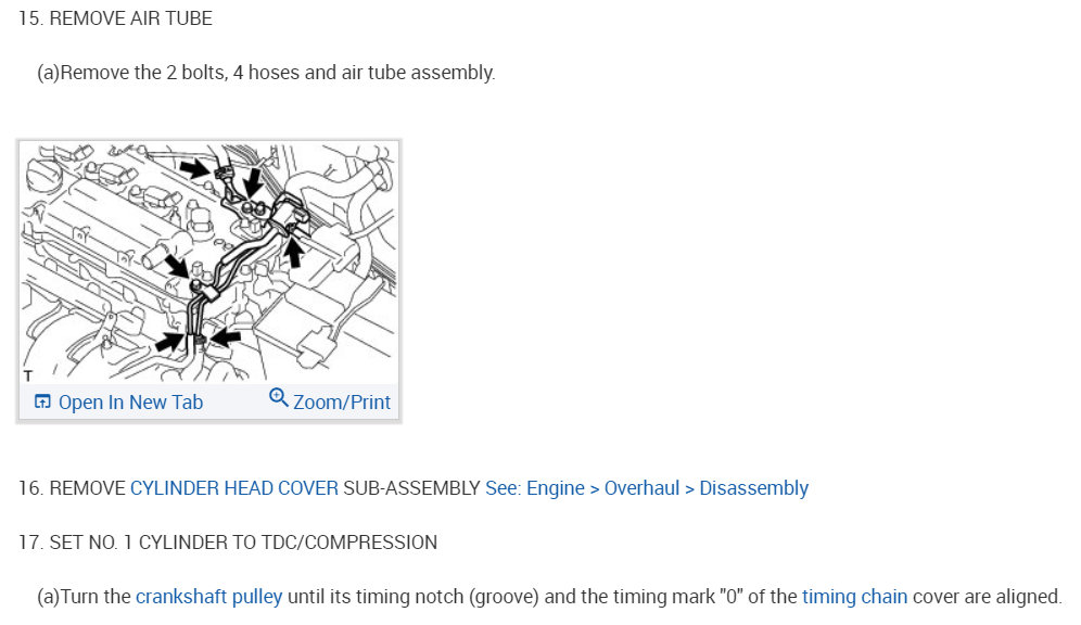

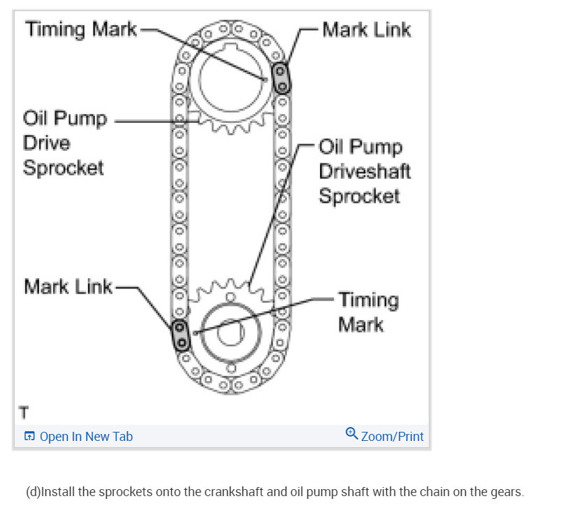

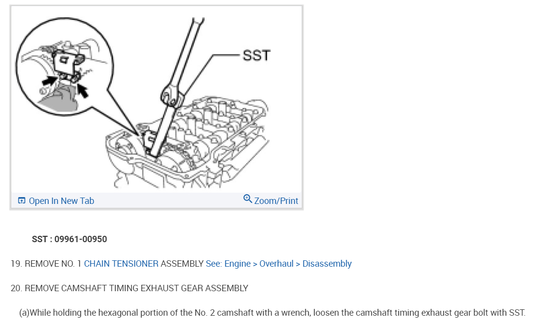

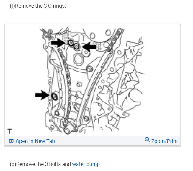

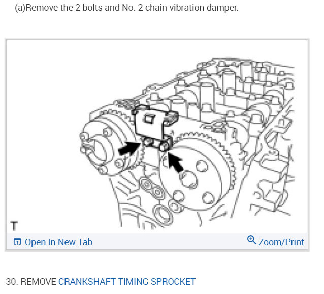

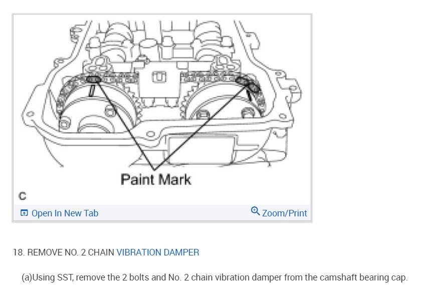

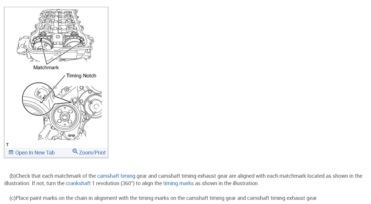

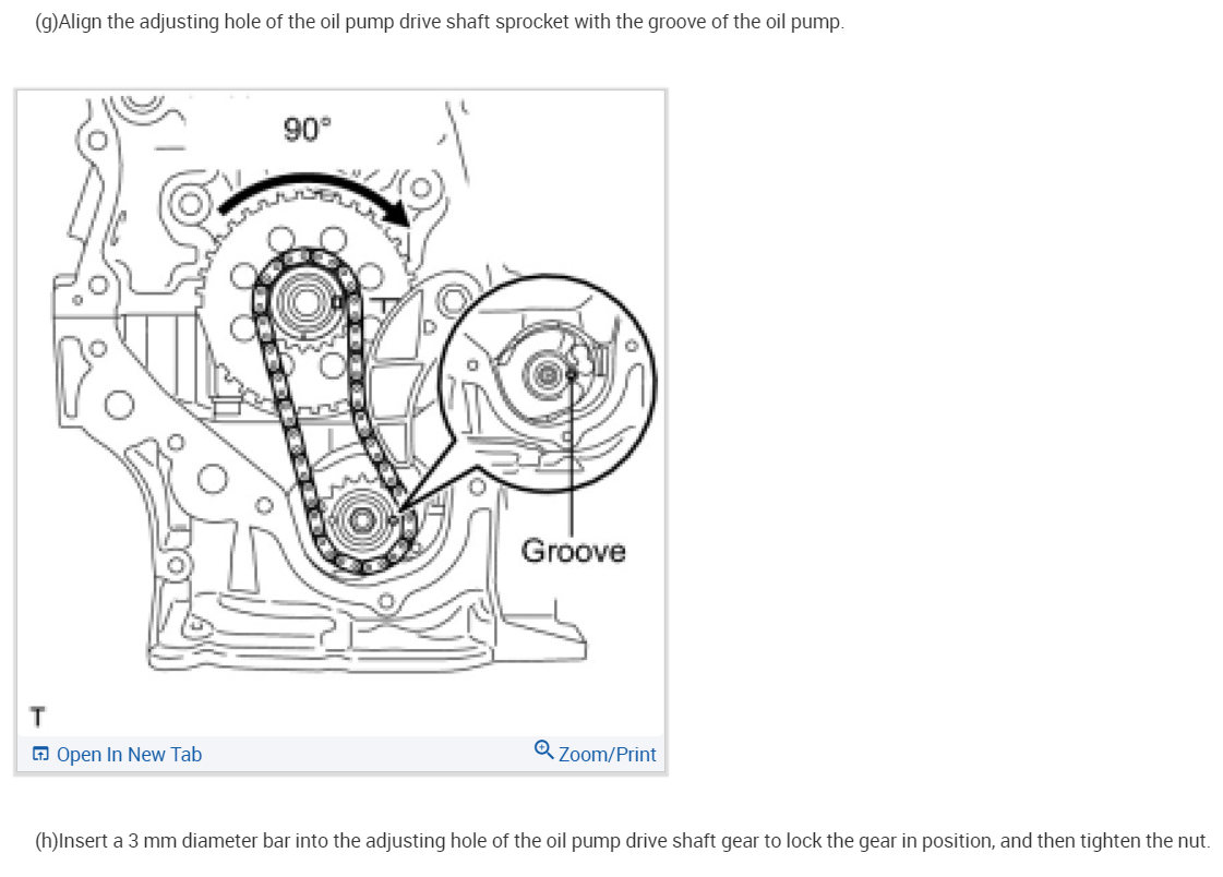

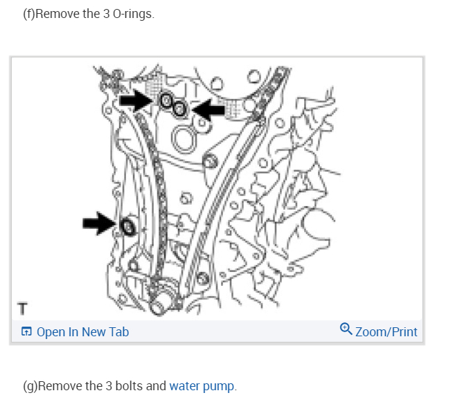

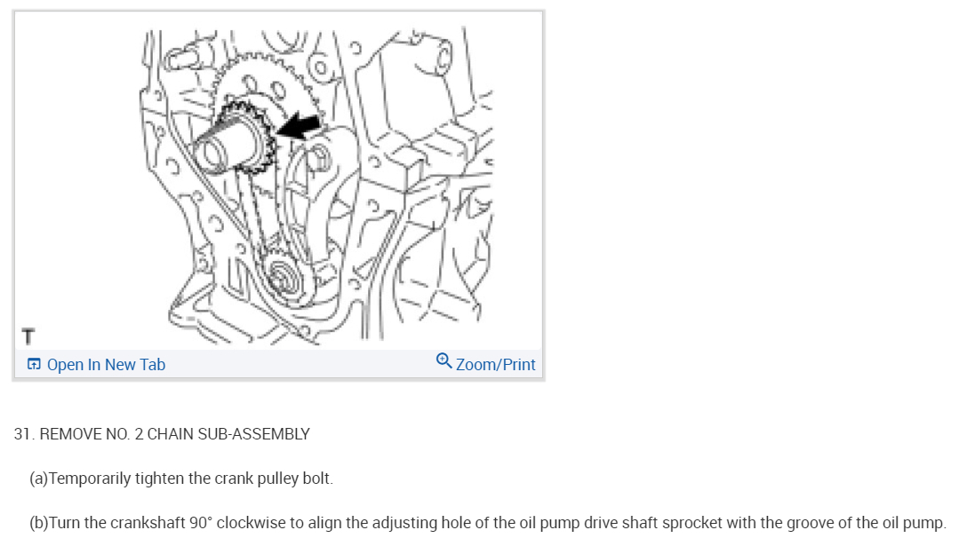

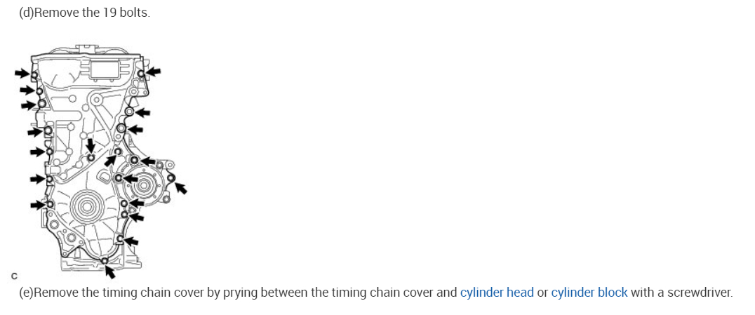

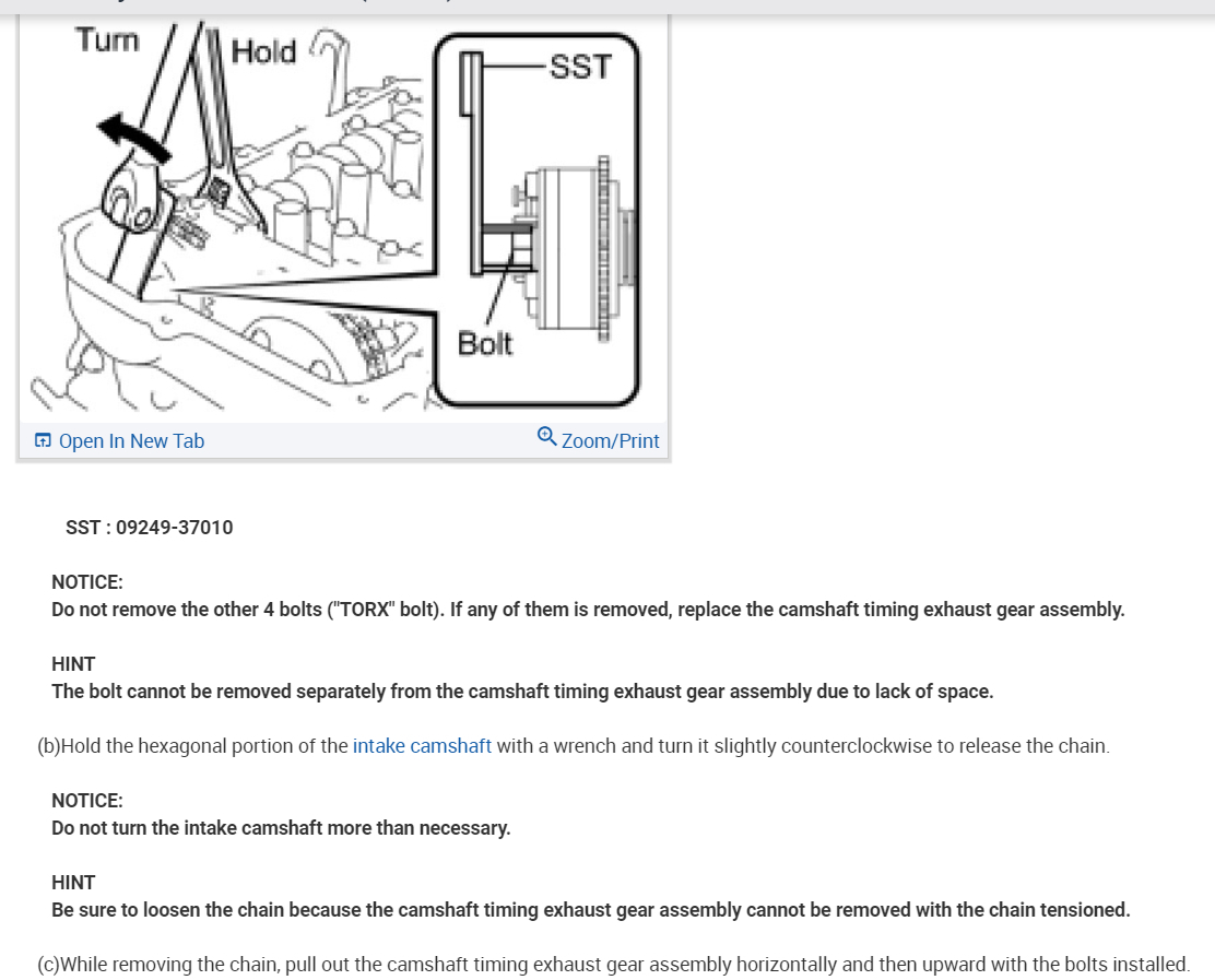

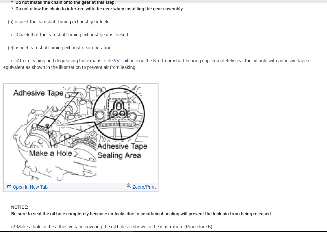

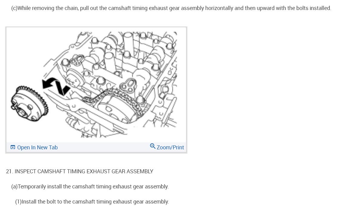

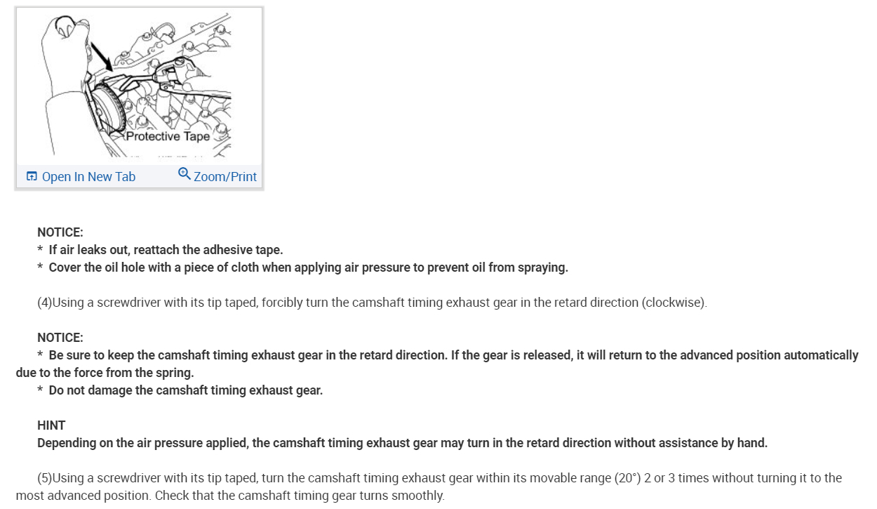

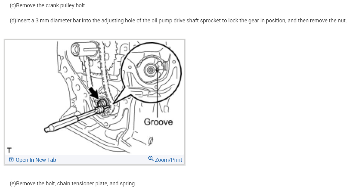

Yep, good call on the catalytic converters they were probably okay. What happens is the the variable valve timing actuators were out along with the timing chain and guides. Can you please shoot a quick video with your phone so we can see what's going on? that would be great. You can upload it here with your response. That was I can tell for sure.
Here is a guide to show you how it works:
https://www.2carpros.com/articles/how-camshaft-variable-valve-timing-works
If I am correct here are the instructions and diagrams to replace the parts needed to fix the problem. Check out the diagrams (below). Please let us know what you find. We are interested to see what it is.

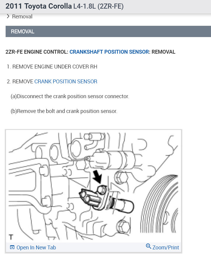

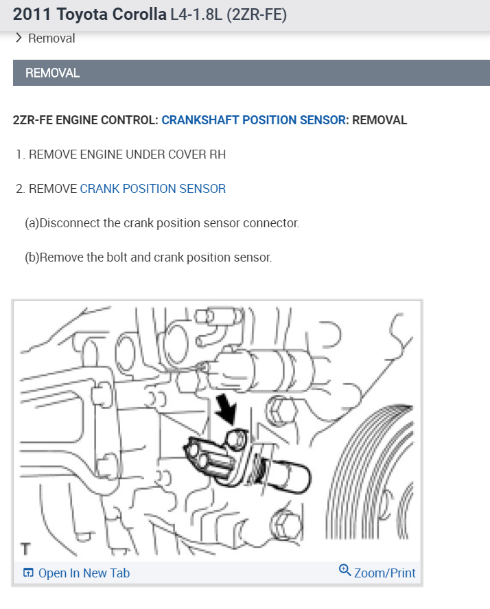

Many thanks for your response, help and advice, I hope to make a video of the problem and post here also, I plan to have a mechanic look into what you suggested, but before we get into such hideous and expensive exercise or task, I want to rule out this possibility as it occurred to me: the P0016 DTC reads; Crankshaft Position - Camshaft Position Correlation (Bank 1 Sensor A). Could this mean, it is perhaps the sensor that is bad or a bad sensor would not be accompanied with the chainlike rattle sound am hearing?? because, I read one of your blogs here, and realised a failed Crankshaft sensor can cause reduced engine perfomance.
Jul 29, 2019 at 5:54 AM
  • 54,178 POSTS

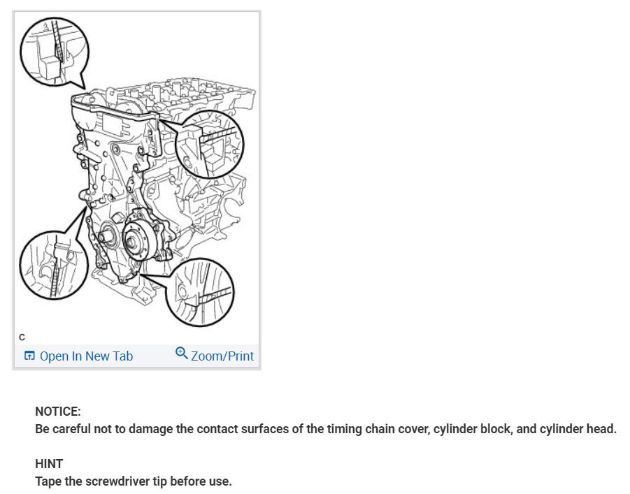

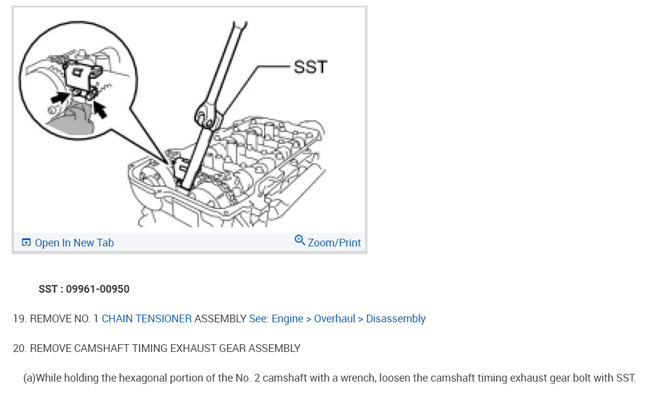

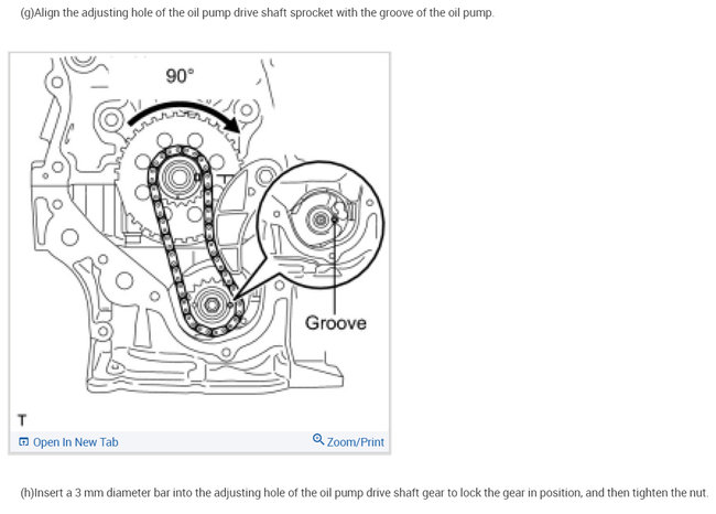

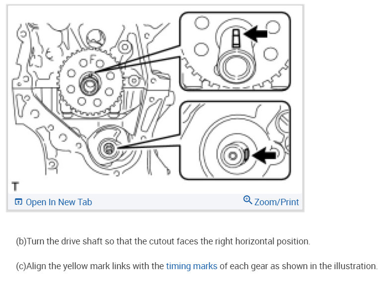

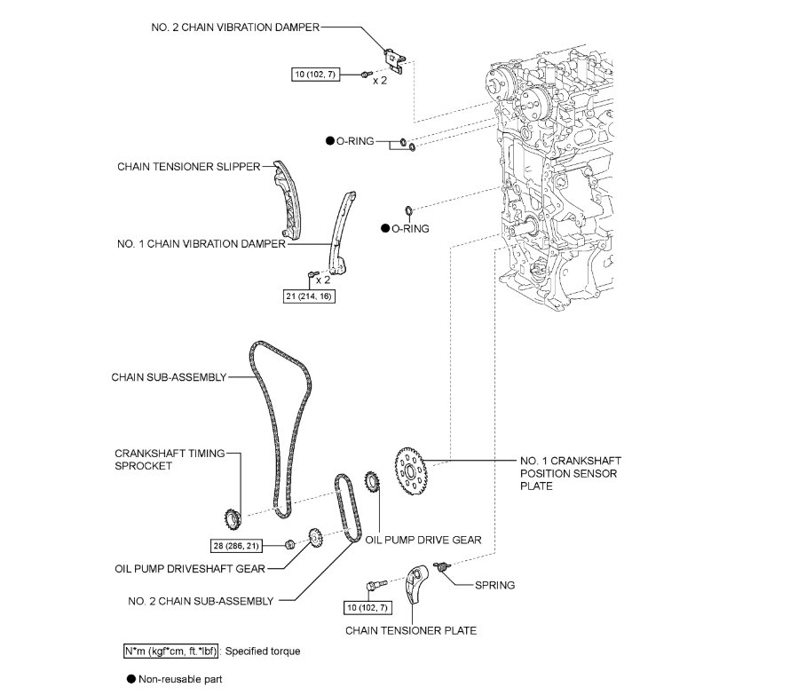

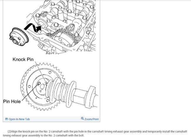

You get the p0016 codes etc, when the actuators cannot hold their position and the engine losses correlation between the crankshaft and camshaft. You can try to replace it to see if that helps. I have been wrong before lol. Here is the location. Check out the diagrams (below). Please let us know what happens.

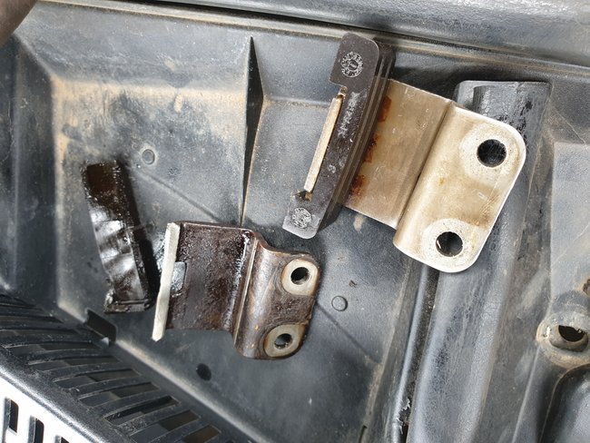

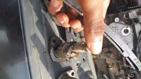

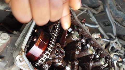

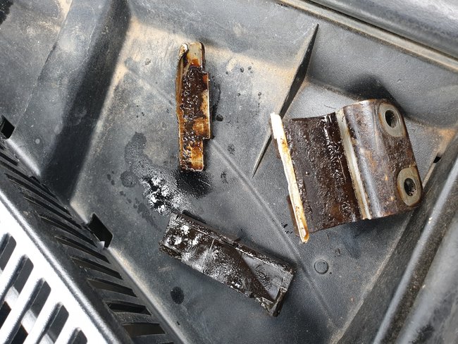

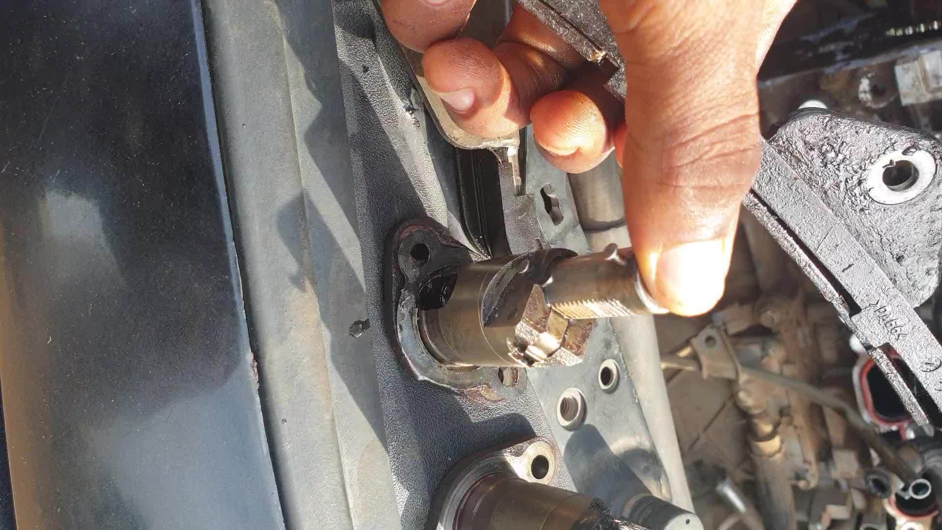

Thank you very much. Right call on the bad timing assembly being the problem, upon opening the engine, The damper no. 1 and 2 were broken, as you can see in the pictures, the Timing Chain was loose and out of time and the timing Adjuster was also bad after the fix, the noise was gone and the engine appears to have more power now. The engine have a lot of sludge though, should worry?
One more thing, the transmission seem to be under performing, when in motion, if I don't lift my leg from the gas pedal a bit, it doesn't shift into the next gear until after a while that the car must have been revving and I feel no matter the speed I achieve, it doesn't shift into gear 5. What could be the issue now, the transmission? Note, this was so even before the work on the timing chain.
Jul 31, 2019 at 7:41 AM
  • 54,178 POSTS
Good find on that one, it looks like the engine oil was not changed very often which might be causing the issues now. I would try to clean as much as you can then remove the oil pan to clean the pick up screen for the oil pump then keep changing the oil every 1000 miles/KM For the transmission issue lets start a new thread.
