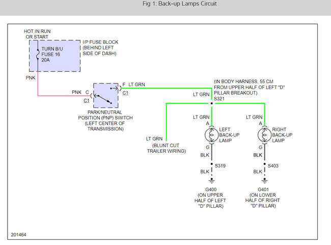

You have a wire or socket that is grounding. here is a guide to help you find it with the wiring diagrams so you can see how it works:

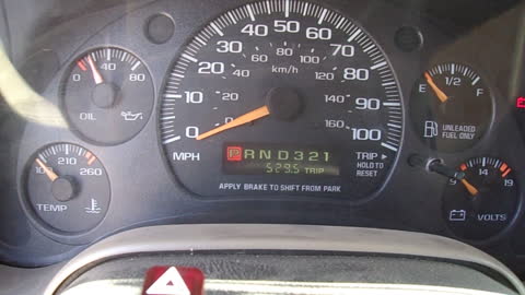

Been working other issues but had time to pull all rear bulbs, fuse blew in Rev(R), engine was off. Had friend ck my (R) lights (back-up) for illumination before fuse blow, no lights fuse blew, engine off. Purchased workshop service manual and began spark chasing. Leaning toward the steering column and under dash wiring. Got manual in-case I have to play around the air bag (yikes!). Sent vid of lag in shifter especially RT to LT. Should have said "detent" each time the shifter fell in one. Can do if needed. Thanks for the look-out, Ken

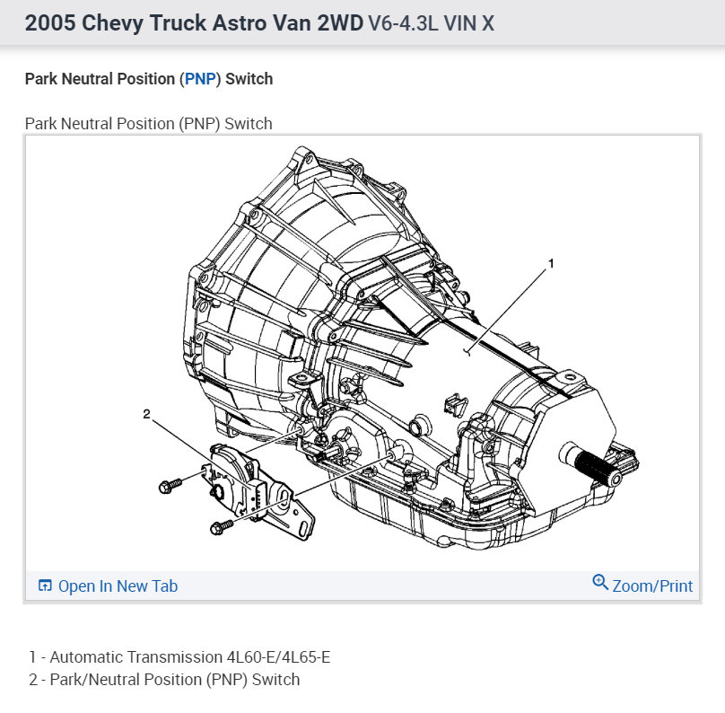

Okay cool. thanks for the video helps. When the detente is in neutral going back into reverse is the car in neutral or reverse, if reverse the gear position sensor is out and needs to be repacked here is the location and instructions to do so. Check out the diagrams (below). Please let us know what happens.

"When the detente is in neutral going back into reverse is the car in neutral or reverse?" It's in reverse. The PNP was changed and I kept the old PNP also because it wasn't in bad condition. Also kept the old turn/flasher relay for troubleshooting.

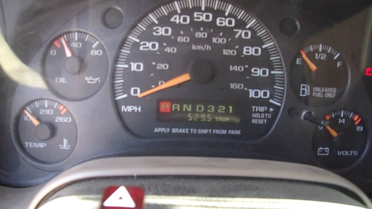

I am trying to see if it is a linkage issue or switch. what I am getting at is do the gear working correctly but the indicator light does not follow or is the lights following correctly but the transmission is not in the correct gear for the lever position?

Copy that, the detente's are correct. The light indicators are not quite in-sync. When the Rev ind light illuminates, the fuse blows. Moving the level slowly to cycle thru detentes show a lag with some of the ind lights. Reminds me of how a rheostat hits it contacts. Like it's caught between two contacts then overloads. But it's all Chinese to me! Thanks for your questions and patience.

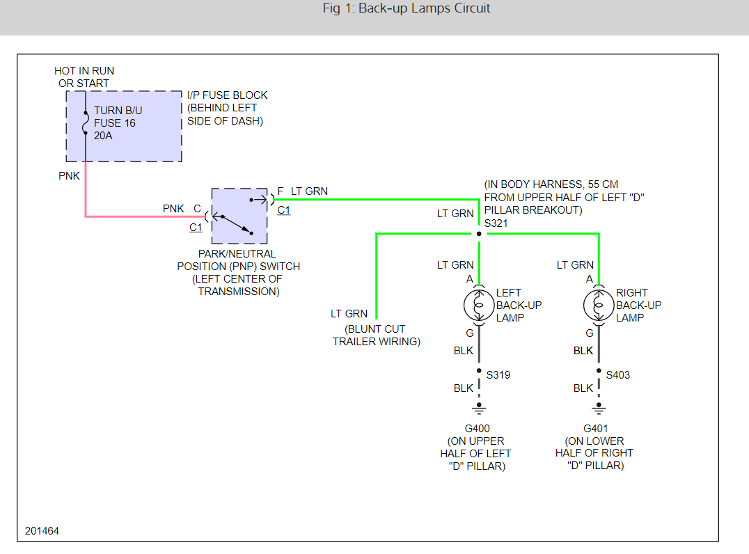

Solved! Trailer wires were tucked in the jack and tools area. Everything looked neat and tidy but decided to unravel and stretch out wires to examine condition. Nothing concerning noted plus wires had a neat conduit around them so left as is to run to the store. Forgot and backed-up like normal then hit the brakes and threw it into park to keep fuse from blowing. Checked fuse, still good! Went to rev again, fuse still good and back-up lights on. Going to remove trailer wires conduit and inspect thoroughly. Thanks for asking about the trailer wires. I checked the schematic and saw how they tie into the system and saw three videos of install.
