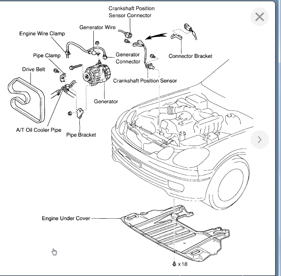

While removing the crank pulley bolt, using the starter to break it lose, the exposed coil connector wire sparked to ground and disabled the starter and other inputs or outputs. I have straight wired the starter. It works but no spark, nothing happens when i turn the key to start.

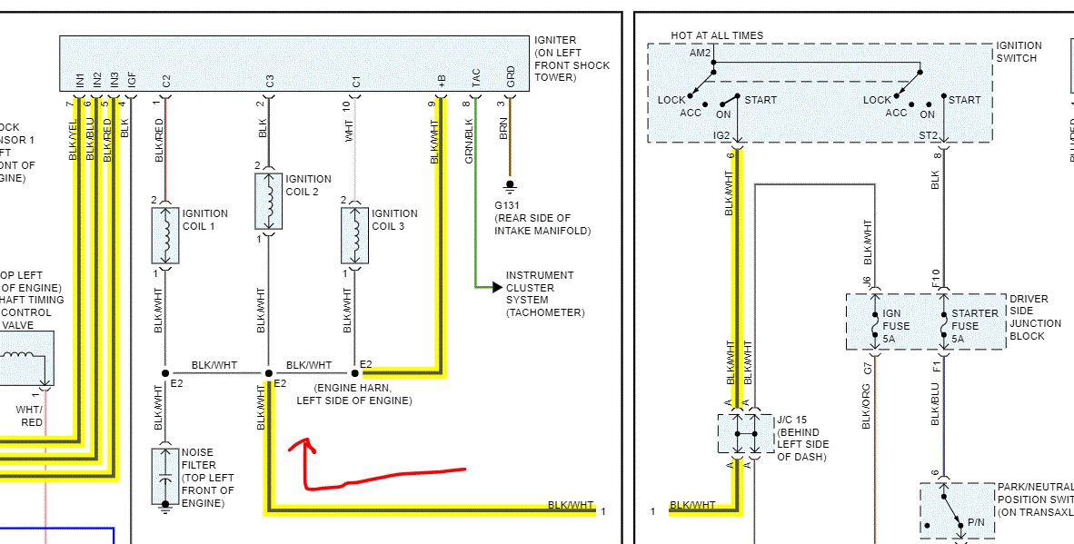

I attached a pic below from the wiring schematic. I need you to check for power to the black/white wire going to the igniter. Also, what other thing were affected? You mentioned input / output devices. Also, how have you straight wired the starter? In other words, what was bypassed to power the starter?
I noted you are a mechanic. Take a look at the schematic I attached and check for power from the ignition switch. Make sure the ignition fuse in pic didn't blow and there is power to it.
Let me know what you find.

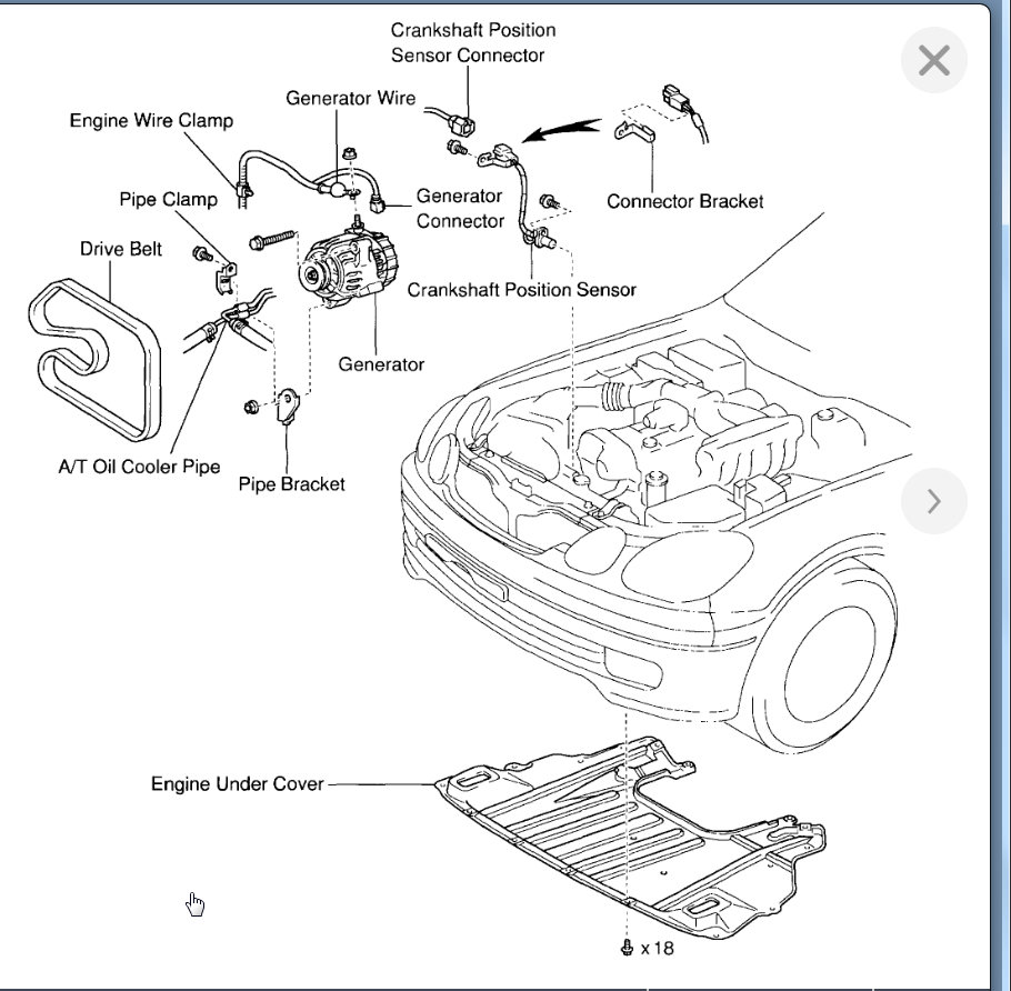

I suspect you have an issue with the crank sensor. Do you happen to have a scan tool that can look at live data? If so, can you crank the engine with the starter and see if the PCM registers an RPM?
If this is not the case, can you give me a little more detail about what arced and where it arced too? Are you saying an ignition coil or the starter B+ wire arced? I am just not sure which exposed wire you are talking about. Thanks

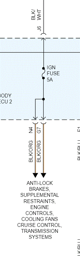

Yes, I have all the information. There is no power to the ignition 5 amp fuse.

Okay, lets work backwards. You replaced the ECM. Is there power to the black/white wire in connector E6? Also, there should be battery power at the black/yellow wire in the same connector. Looking at the connector I mentioned, the power supply is coming from a 25 amp inj fuse.

Okay, the Am2 is power to the ignition switch. It also powers the 5 amp ign fuse. Then it distributes to other components. I took a snap shot of the ign fuse (5 amp) and what it runs to.
Did the AM2 chance anything? Check to see if there is now power to the 5 amp ign fuse when the key is on.
Apr 4, 2020 at 7:53 PM
DAMAN2020
  • 43 POSTS
Yes, we have power to the 5 amp ignition. Fuse with key on.

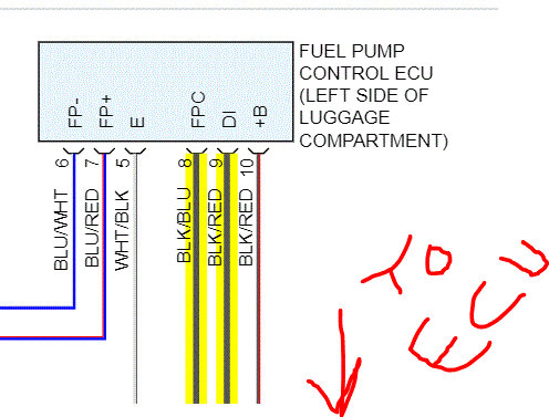

Found the fuel pump relay, it looks good however I did not put power to it. Now the relay is controlled by a module in the left rear if the trunk. It is controlled by the ECU. Any suggestions?
Apr 4, 2020 at 9:19 PM
  • 110,194 POSTS

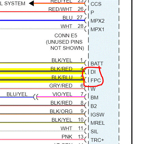

I attached two pics below. The first one is at the ECM, and yes it ties into the fuel pump control ECY you are referring to in the trunk. Power is supplied to the ECM via the EFI fuse. Signal is sent to the fuel pump ecu in the trunk. If you look at pic 2, it shows power distribution to the pump and power from the ECU. Check those two sets of wires for power in and out. Note, there is a white / black wire to ground. It's doubtful that anything is wrong with it, but make sure there is continuity to ground.

I've been messing around with the fuel pump relay this entire time. I believe it is bad but the module controls the relay. When I turn the key on I'm getting 0.01v for the coil core and 0.02 for the coil field wrap. Going to the module now.
Apr 4, 2020 at 10:47 PM
DAMAN2020
  • 43 POSTS
Even if I put jumpers to the relay with 13v i could not get it to click or make the circuit.
Apr 4, 2020 at 10:48 PM
  • 110,194 POSTS
It sounds like a bad relay, but you should be getting more to the CC and CF. If you go back the ECM, do you have power there? There are no fuses, splices, or anything I see between the two.

Going to take a nap now. Get back up at 8:00 am. The fuel pump relay tested good with jumpers but when using (key on position) it does not engage. I have a pin listing for the ECU so I can test the D1, FPC, +B ETC...

Okay, 0.01v coming out of the ECU going to the module. On both black/blue and black/red.

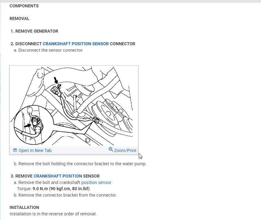

So um yeah, the pump is building pressure. The camera inspection inside the cylinder shows no pulse from the injector. So I've pulled out the crank position sensor. Thinking that something might be giving it a false readings. Is was dirty as heck.
