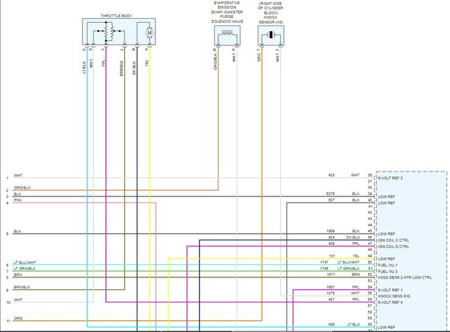

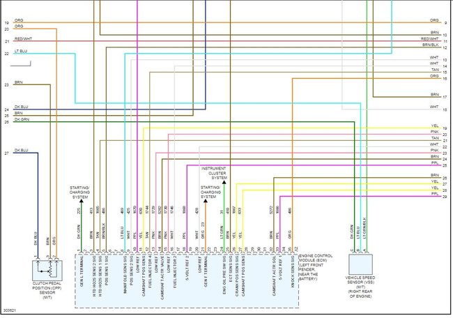

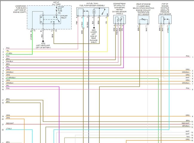

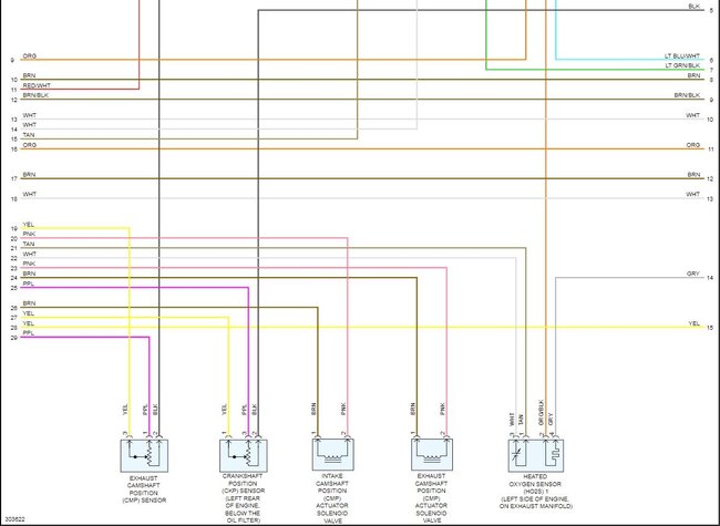

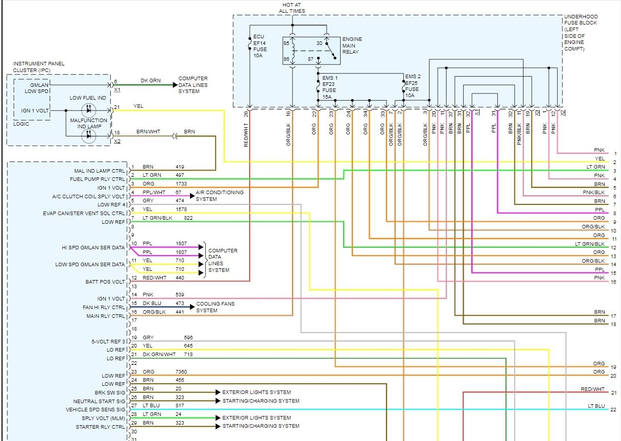

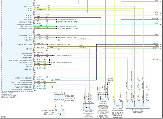

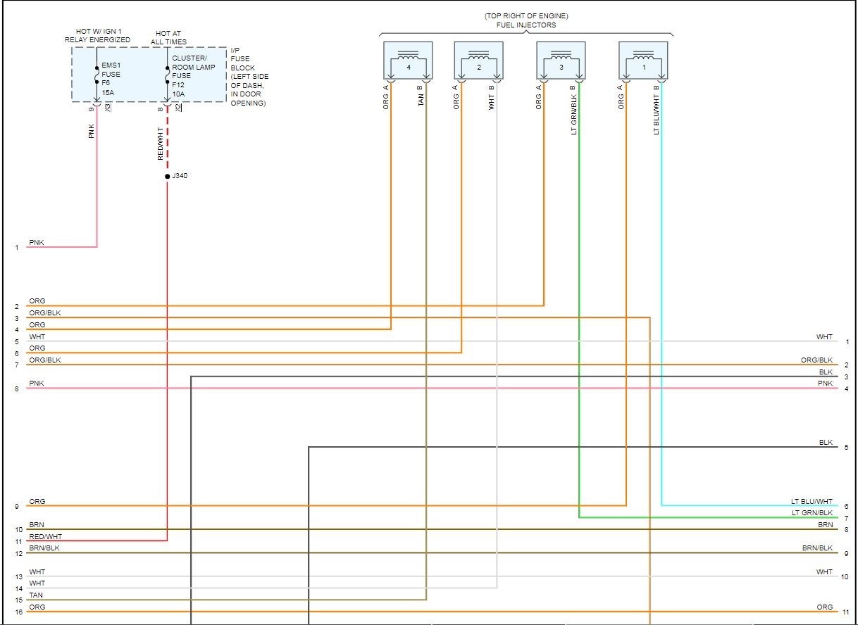

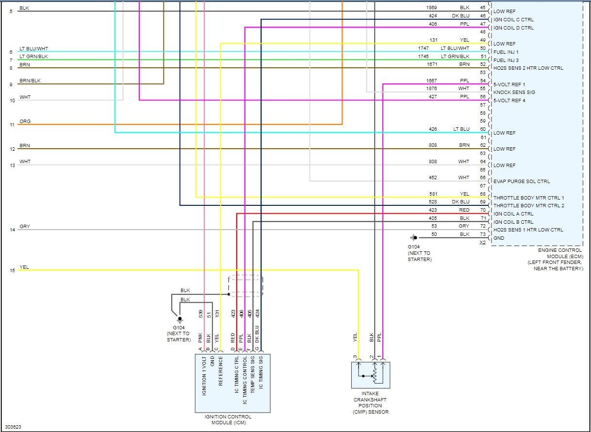

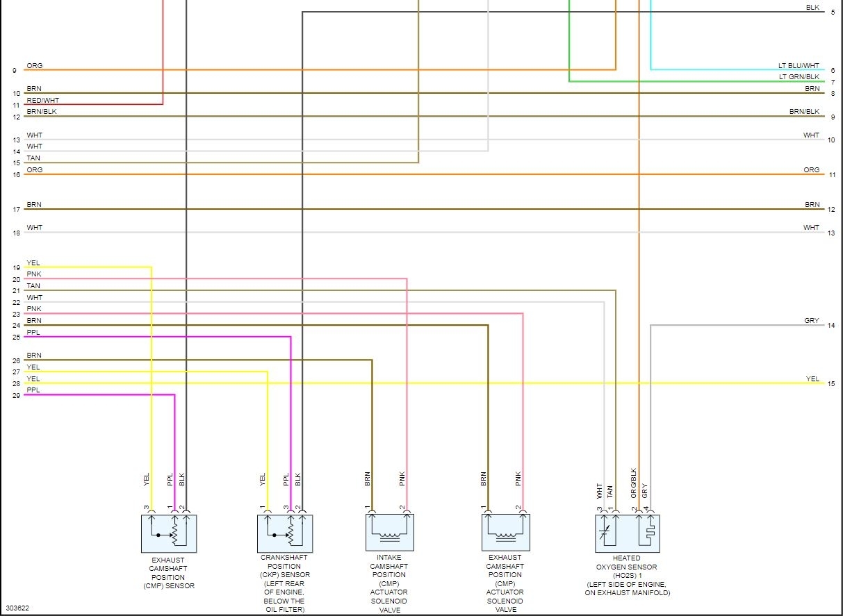

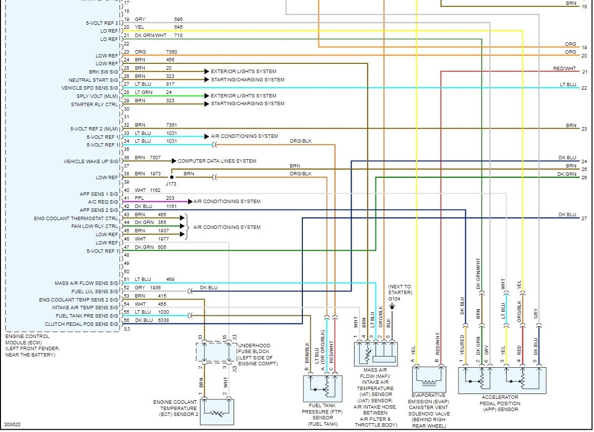

The car was in a deer hit. I bought it needing a headlight and fender through auction. The car will not turn over. No fuel pump or check engine light when the key is in the on position. I have changed the fuse box and the PCM. I am thinking there is no power to the PCM but I do not have a wiring diagram for it. I have been able to power the fuel pump through a power point and I have had the engine turn over the same way. Any help is greatly appreciated. Thank you
Sep 13, 2018 at 6:47 AM
DANNY L
  • 5,648 POSTS
Hello, I am Danny.
I have attached a wiring diagram for the ECM. Hope this helps and feel free to ask any questions. Thanks for using 2CarPros.
Danny-
Sep 15, 2018 at 2:16 AM
ALBROWER87
I have not had much luck it appears there is no communication from the OBD connector under the dash through the system. I was unable to get the picture to come up clear. I did a little more research and found it runs through a couple more modules before hitting the PCM/ECU.
