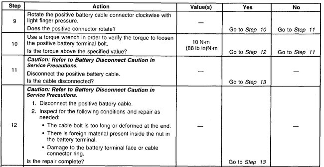

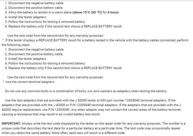

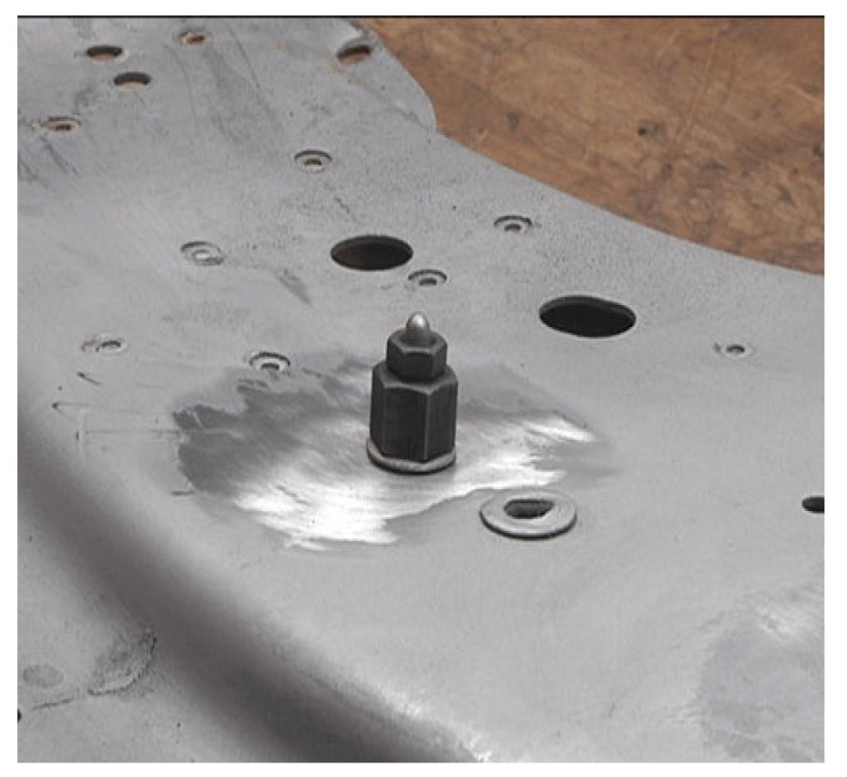

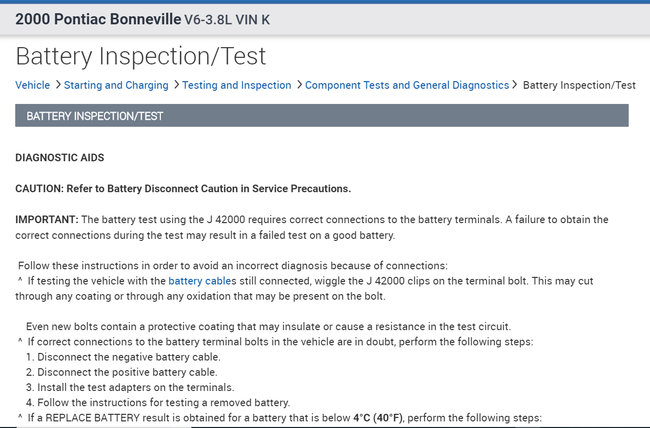

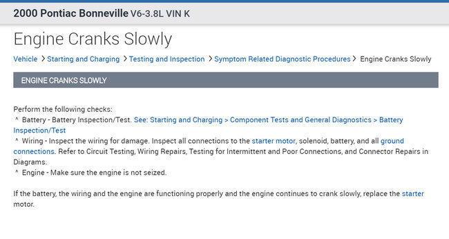

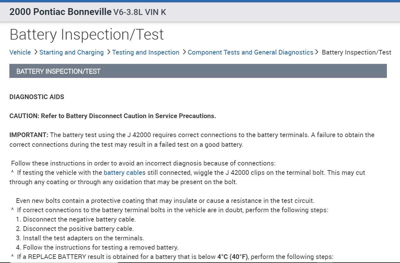

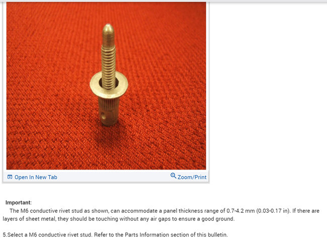

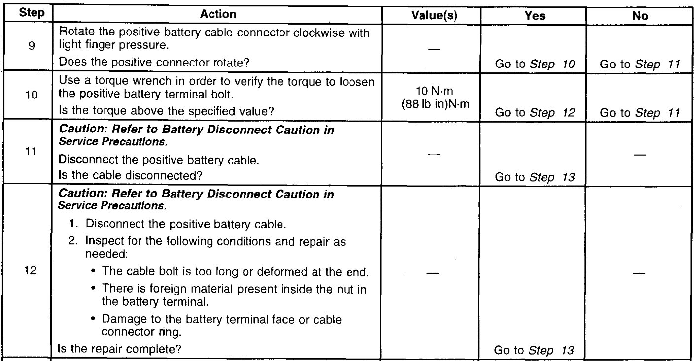

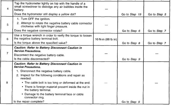

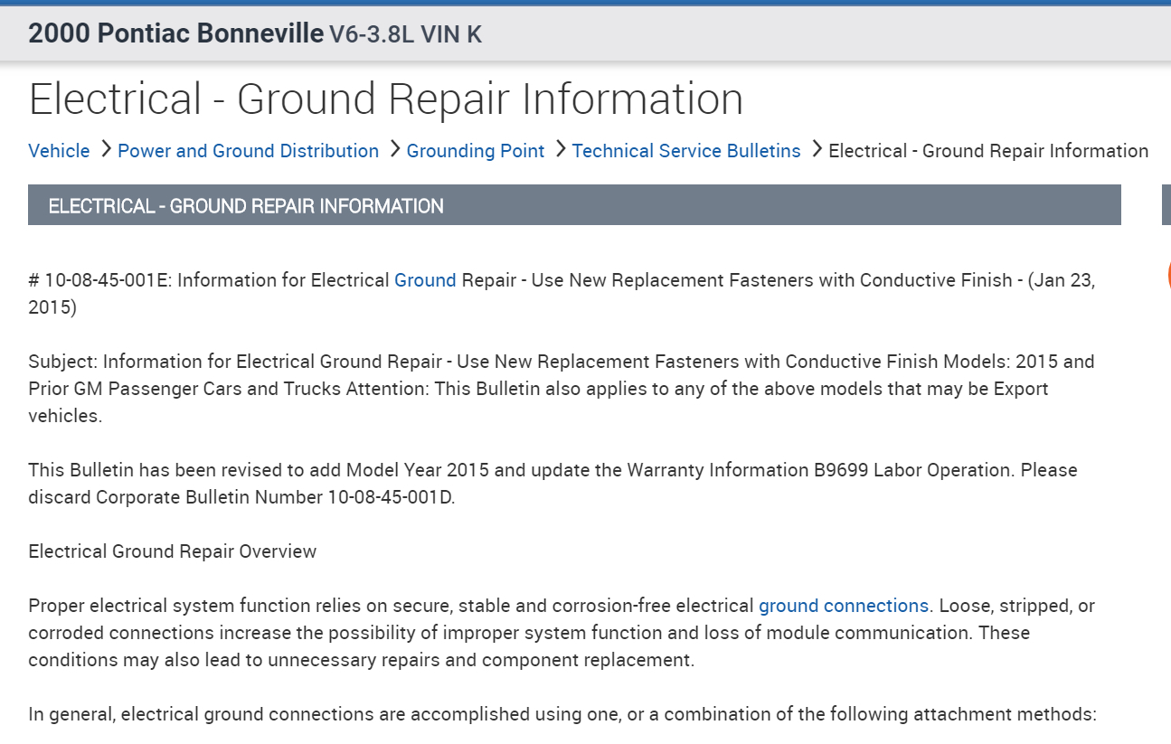

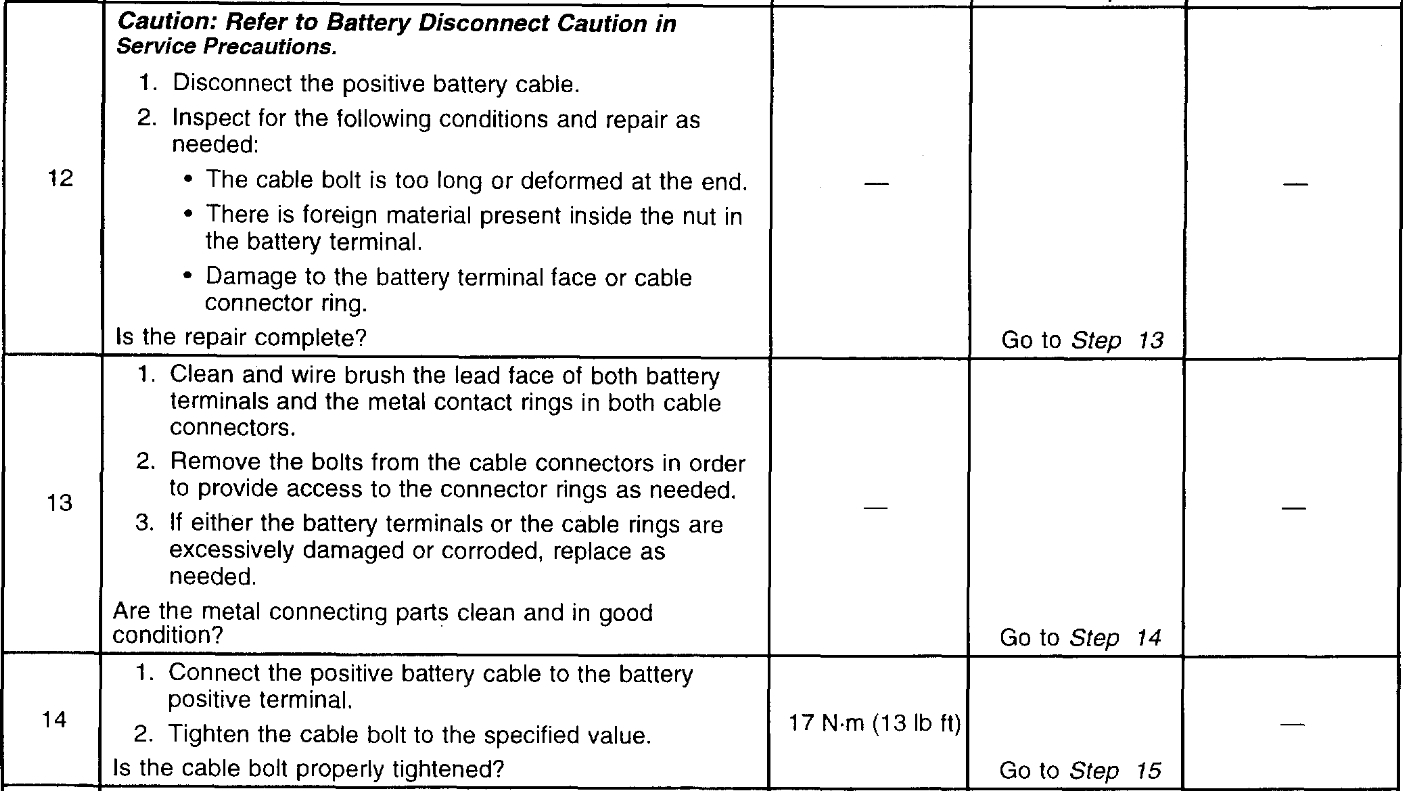

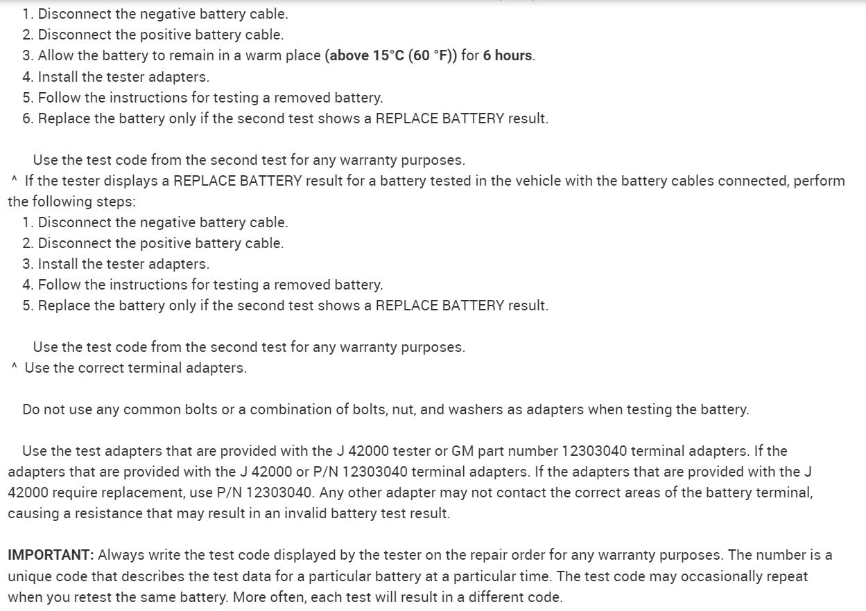

SCGRANTURISMO
  • 4,897 POSTS

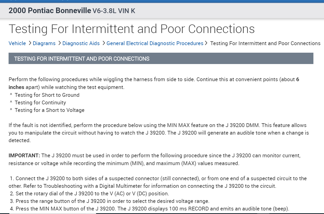

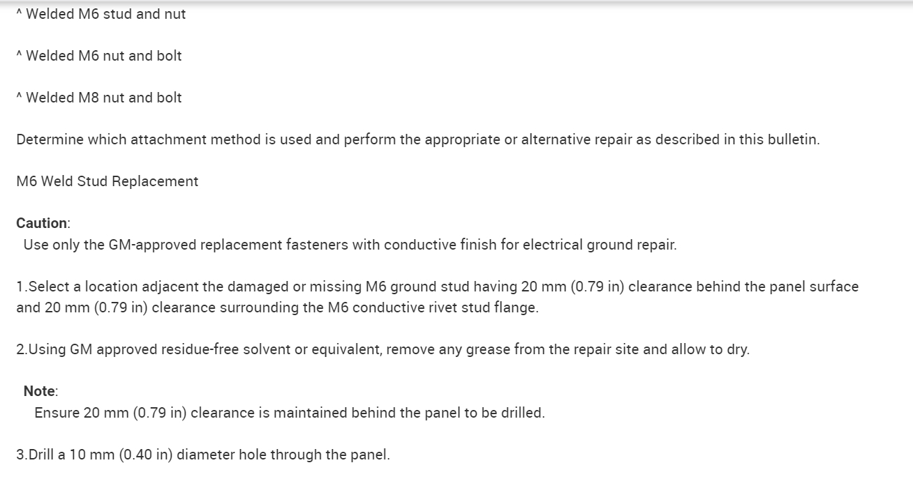

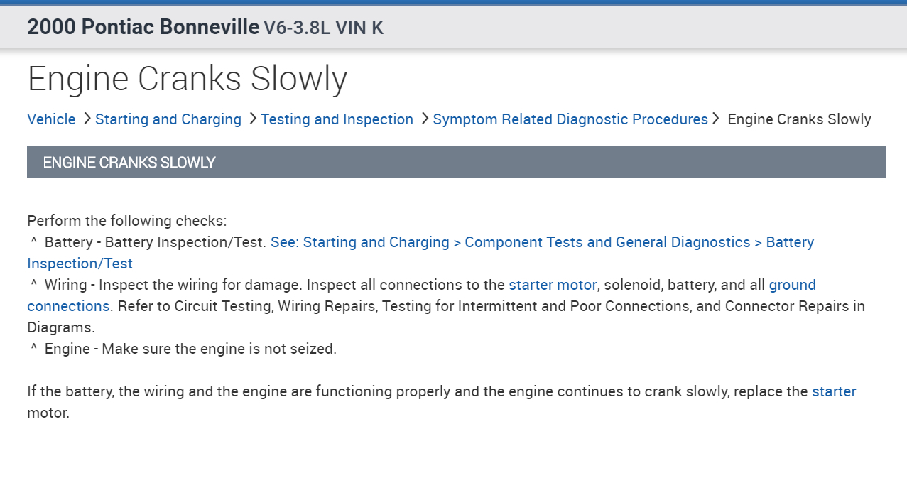

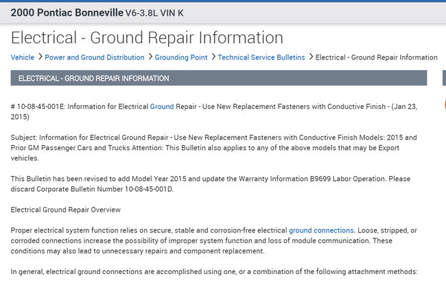

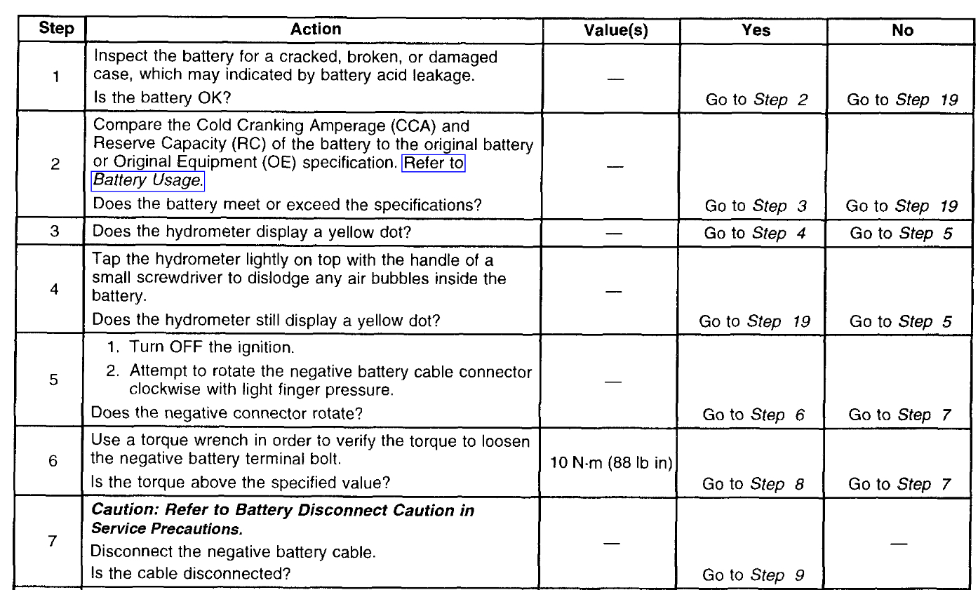

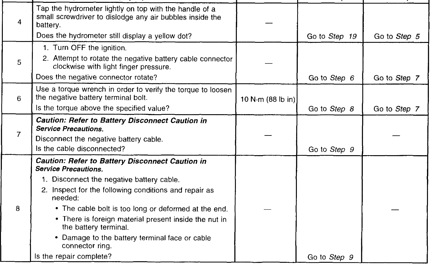

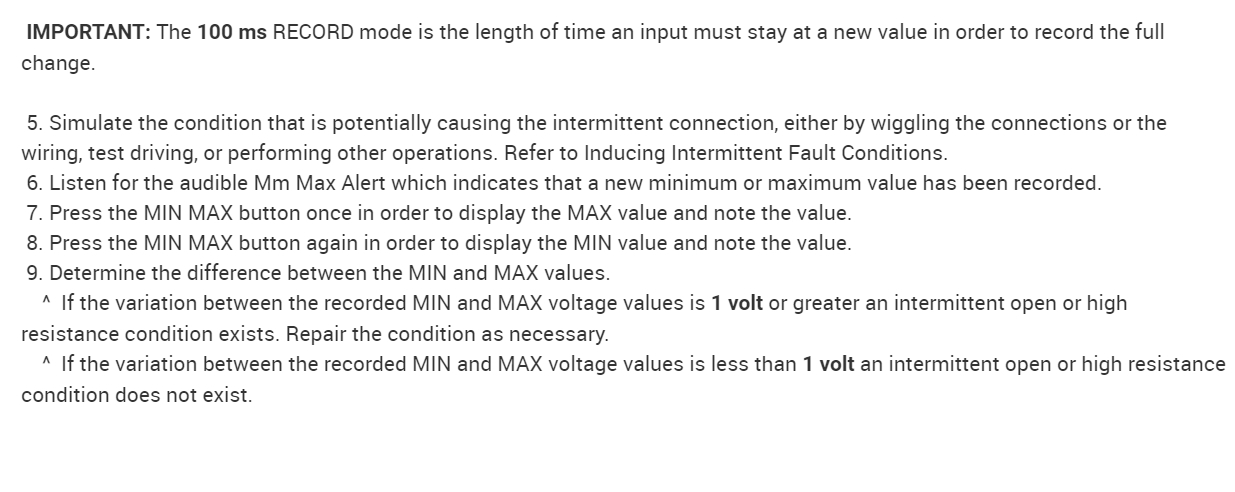

Hello again,
Here is what Pontiac has to say on the issue. I have included the information in the diagrams down below. Please go through it and get back to us with what you find out.
Thanks,
Alex
2CarPros
