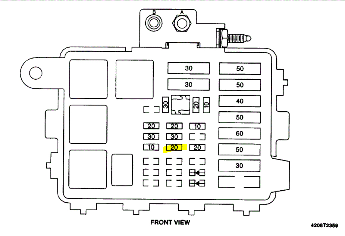

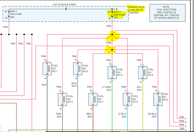

If you use starting fluid, will it start for a few seconds and then stall? If so, let's focus on fuel. You indicated good fuel pressure, so the next step would be the injectors. If you take a look through this link, it explains how to test them. Also, each injector will have a pink wire to it and then a different color. The pink wire should have voltage when the key is on at all times, so that's an easy check. Make sure you have a good ground when testing the pink wires. Under normal conditions, the PCM provides a ground path to complete the circuit.
https://www.2carpros.com/articles/how-to-test-a-fuel-injector

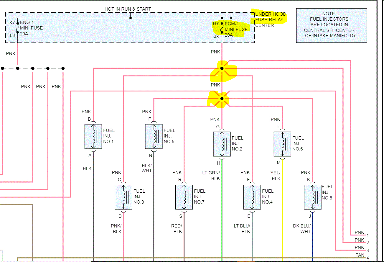

Also, before checking the injectors, check the ECM 1 fuse in the under-hood fuse box. In addition to checking the fuse, confirm there is power both to it and from it.
Let me know what you find or if you have questions.
See pics below. Pic 2 should indicate the ECM 1 fuse. Confirm that for me.

The injectors show 12.1-12.3 volts. If I use starting fluid, it will almost start but not run

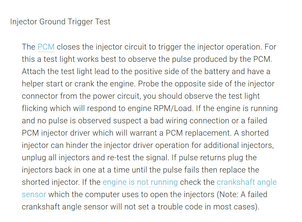

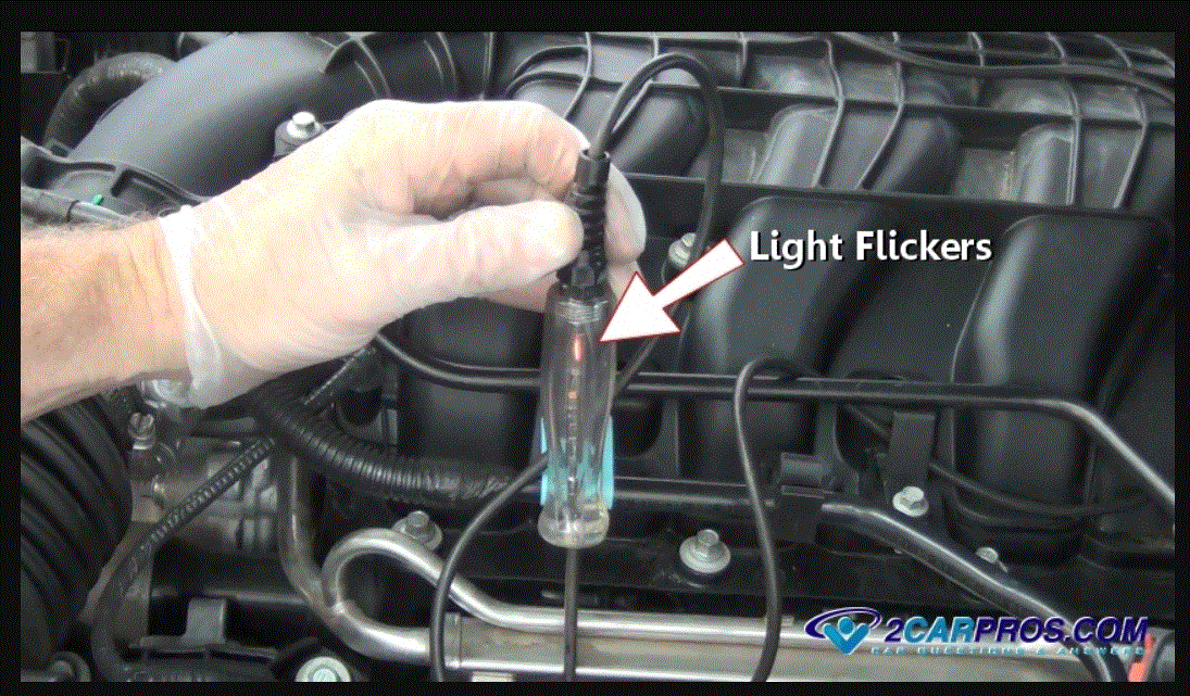

Okay, if we have power to the injectors, we need to see if the PCM is providing a ground path. Take a test light, connect the tester lead to the battery positive, disconnect one of the injectors, probe the ground path wire (Other than Pink) and have a helper crank the engine the test light should pulse.
I copied that section from the link I sent and attached it below for easier reference. Also, if you can, record it cranking and upload it so I can hear the engine turning.

You are very welcome. I feel bad we didn't get it going. However, I am really interested in knowing what is found. If it didn't have spark, that usually points to a crankshaft position sensor issue. Since we have power to the injectors, the fuel pressure is good, and it nearly starts with starting fluid, I have a feeling the PCM isn't providing a ground path to actuate the injectors. I hope I'm wrong. LOL
