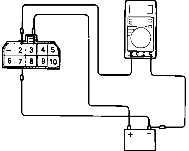

Vehicle sat for three years. Put new battery in and good fuel it started right up. Drove it home about ten miles ran great. Started it a few days later and it ran for ten minutes then shut off. Eventually got it started again ran then shut off hasn't started since. Has no spark. Swapped coil assembly with my Montero and Montero runs fine. Swapped MFI relay and Montero runs fine. Tested output from distributor and crank position sensor voltage oscillates like I would expect. Checked ECU ground circuit checks good. Opened ECU no burn spots. Question is, what input to the ECU causes an output to the coil other than the crank position sensor in the distributor? Does a bad airflow sensor cause the ECU to not output a spark?

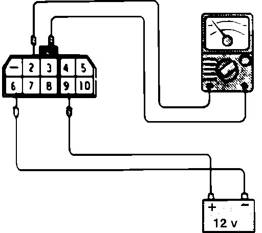

I have a feeling the problem is related to the main engine control relay. See picture 1 Failure of the engine control relay could interrupt power supply to the fuel pump, injectors and ECU, resulting in start failure.
Here are the directions for diagnostic of the relay:
CAUTION: Use caution when connecting jumper wires to the relay. If the polarity is incorrectly connected, the relay will be damaged.
Fig. 1 Relay Test
Pic 2
COMPONENT TEST
1. Supply 12 vdc to relay terminals 8 (-) and 10 (+). Using a voltmeter, check for voltage between terminals 4 (+) and 8 (-) and between terminals 5 (+) and 8 (-). Refer to Fig. 1.
Voltage
12 vdc
Fig. 2 Relay Test

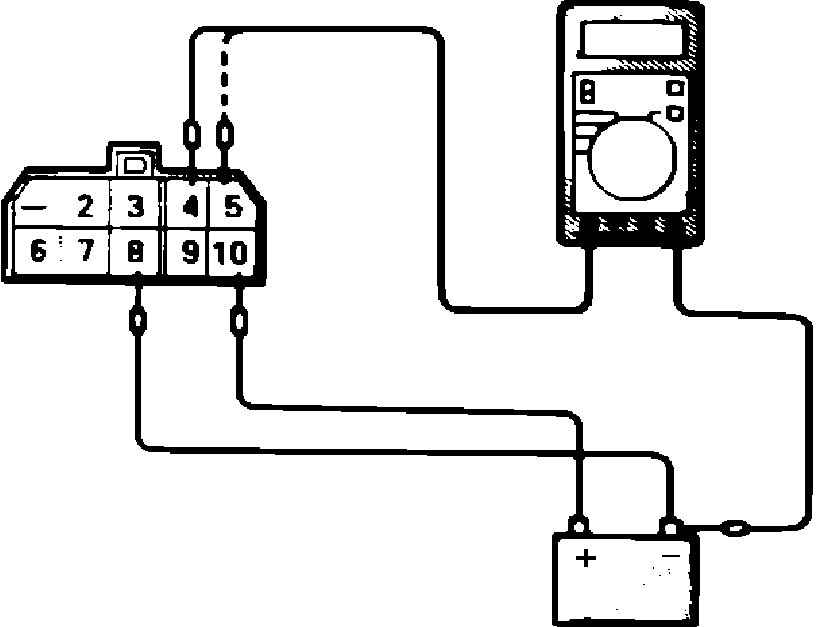

Pic 3
2. Supply 12 vdc to relay terminals 6 (-) and 9 (+). Using an ohmmeter, check for continuity between terminals 2 and 3. Refer to Fig. 2.
Continuity
Should exist when voltage is supplied.
Should NOT exist when voltage is NOT supplied.
Fig. 3 Relay Test

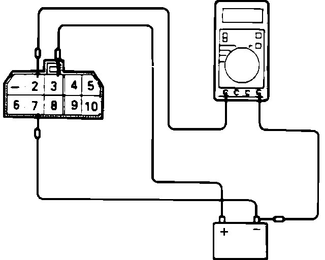

Pic 4
3. Supply 12 vdc to relay terminals 7 (-) and 3 (+). Using a voltmeter, check for voltage between terminals 2 (+) and supply battery ground terminal. Refer to Fig. 3.
Voltage
12 vdc when terminal 7 is connected.
0 vdc when terminal 7 is NOT connected.

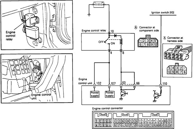

HARNESS TEST
1. Disconnect the negative battery cable and the ECU connector.
2. Reconnect the negative battery cable and turn the key to the ON position.
3. Using a volt meter, check the voltage between ECU harness terminal 110 and ground.
Voltage
System voltage.
4. Turn the key to the OFF position.
5. Disconnect the control relay connector.
6. Using an volt meter, check the voltage between relay harness terminal 10 and ground.
Voltage
System voltage.
7. Using a ohm meter, check for continuity between relay harness terminal 8 and ECU harness connector terminals 63 and 66.
Continuity
Should exist.
8. Using a ohm meter, check for continuity between relay harness terminal 4 and ECU harness connector terminals 102 and 107.
Continuity
Should exist.
If any of the previous tests produce unsatisfactory results, the harness will need to be repaired or replaced. Once repairs have been completed, road test the vehicle to confirm that the repair has corrected the problem.
If the same problem reoccurs, it is possible that there is an intermittent failure of the component or the ECU. Check for looseness at all harness junctions and test for an intermittent failure.

Thanks for the information, however I have verified the engine MFI relay works. I removed it and installed it in my 1990 Montero and the Montero runs fine with the mighty maxes MFI relay. I have tested the coil, distributor, air flow sensor and the transistor that the ECM controls for spark all items work when installed in the Montero. The only thing I can't test that way is the ECM the computer from the mighty max is different than the Montero. So, can the engine computer fail from sitting for years? Do they lose the program? Where should I send it for testing? I don't imagine it could be anything else.

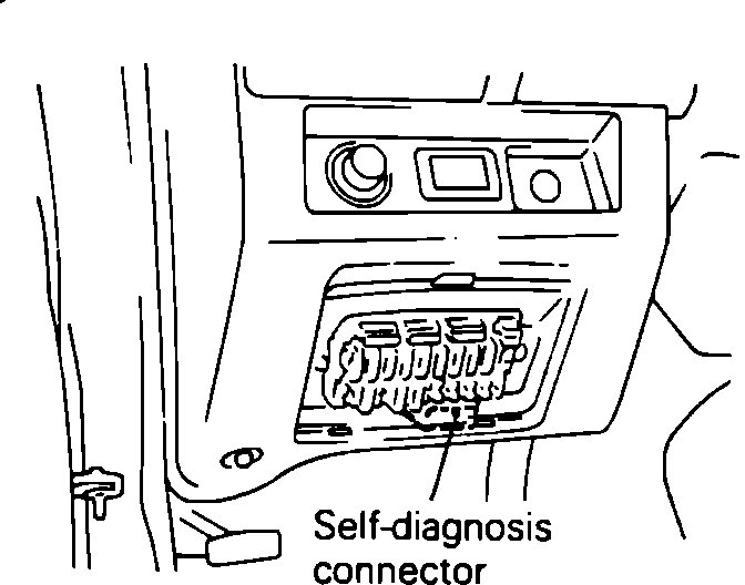

Self-Diagnosis Connector Location
2. Does the ECU output a steady 12 vdc at the diagnostic check connector?
A. If not, and the ECU is suspected to be faulty, check the POWER AND GROUND CIRCUITS test to confirm that the ECU is being supplied with power and ground.
B. If so replacement of the ECU is required.

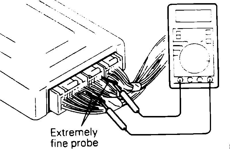

ECU Probing Technique
To test pins using a multi-meter do not remove the connector from the ECU, instead insert a straight pin or needle from the back side of the connector to access each pin.

DARKMATT
Update. I found that the ECM from the mighty max and the Montero are virtually identical. Same circuit card numbers and components. The only difference I found was the ignition timing circuit has a different hand drawn number on it otherwise the components are the same. I took the Montero computer out of its case and installed it into the case of the mighty max, both are 1990 V6 federal with manual transmissions. I installed it into the mighty max and voila it runs. I didn't want to leave it in and potentially ruin my Montero's ECM so I switched it back, Montero runs fine. So now I need to have the ignition circuit in the computer repaired. I read somewhere that the capacitors can be a problem but they don't look like they are swelled or damaged or leaking. Does anyone know of a reputable repair shop that can test and repair a 1990 mighty max v6 ECM?
