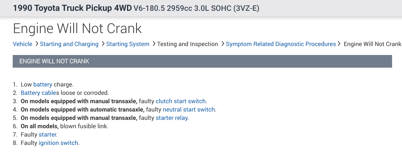

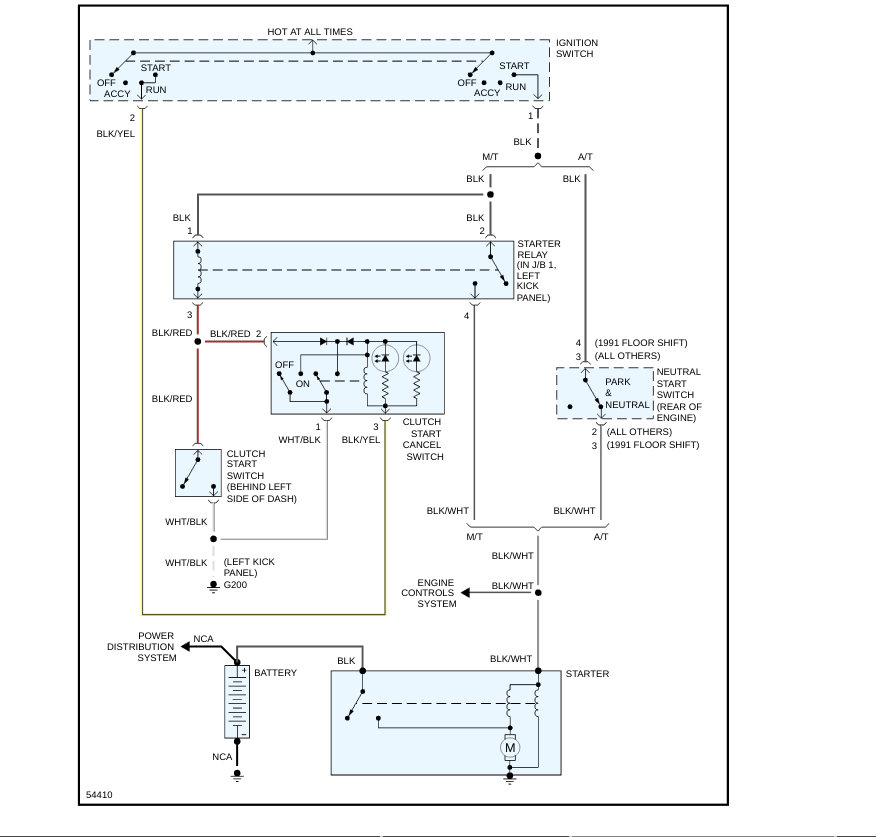

I moved my truck one day and about 2 weeks later I went to crank it and nothing, not even a click. I tested the battery and it was bad. I went to AutoZone and purchased a new battery, and put it in the truck. I have 12 volts. test light works from positive to block. I have headlights and horn and emergency flashers but no buzzer when key is put into ignition, no fan from the vent, no brake lights..To me it doesn't seem to be a starter issue because I get nothing when I turn the ignition key on. It sounds more like a bad ignition switch. I also used a key my wife had and still nothing. How would I test the ignition switch to seer if it is bad or does it sound like something else?

In the diagrams down below I have included a wiring diagram of your vehicle's starting circuit as well as a flowchart to what to check for a No Crank situation like yours. It is from the vehicle manufacturer and will quickly lead you to the problem. I hope that this helps.
