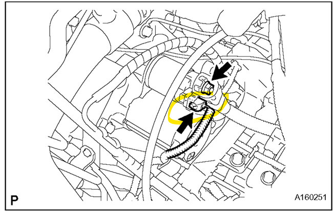

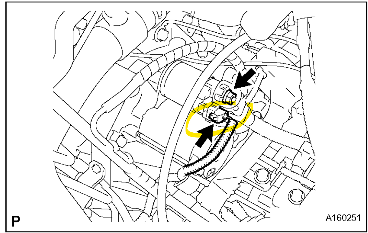

Is it possible the Starter wire got knocked off when working in that area? It's right near where you were.

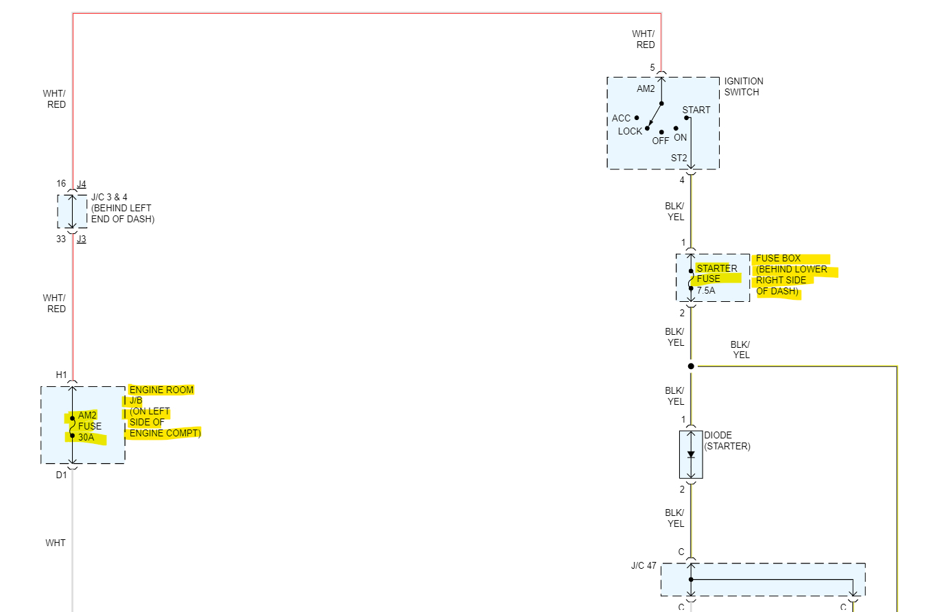

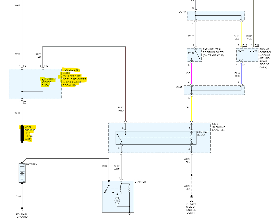

Here's the Starter circuit diagram and fuses just in case you need them.
