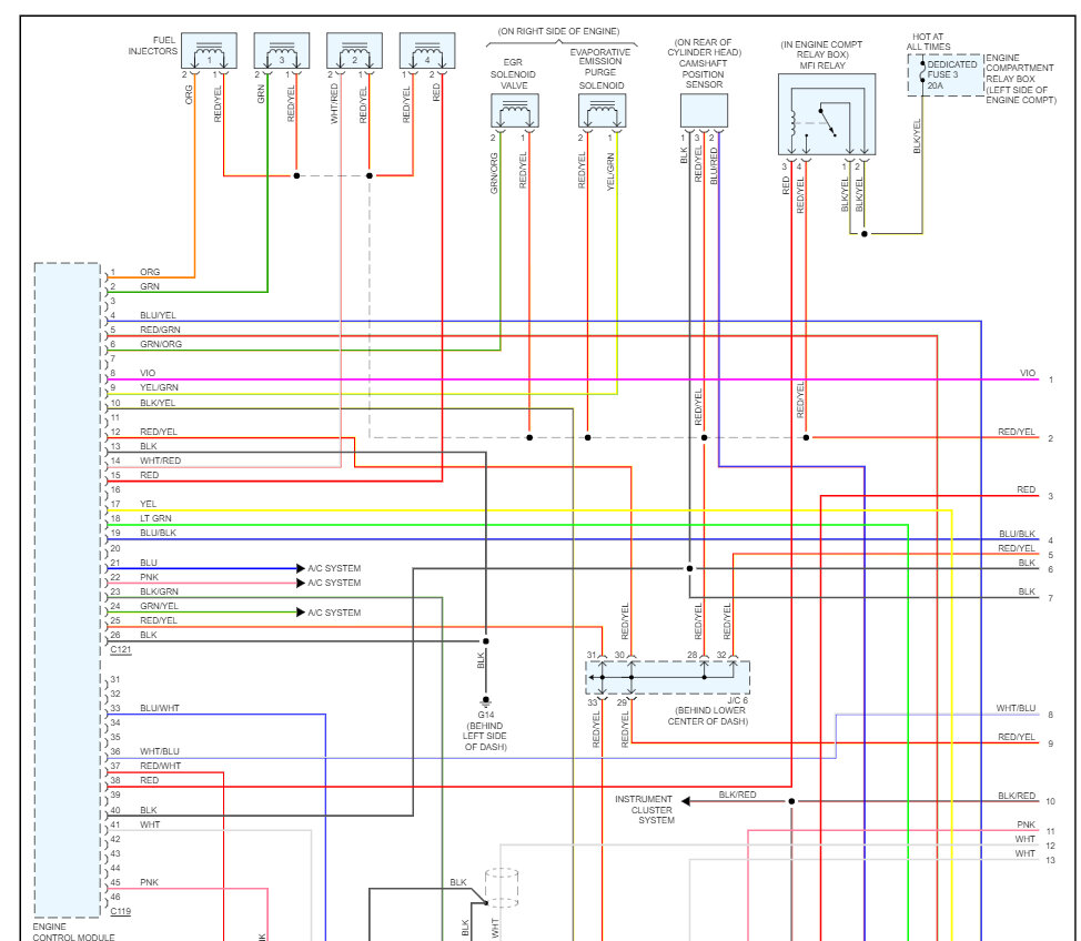

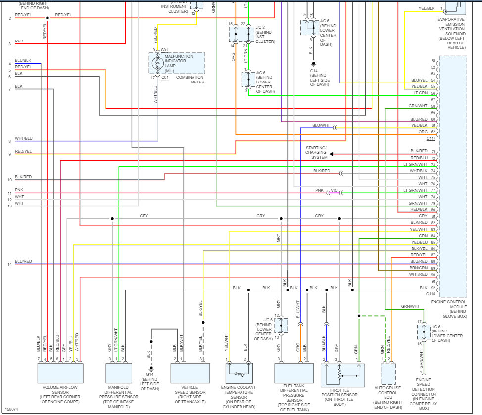

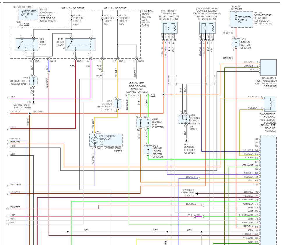

Short on MAF harness and now no start replaced both coils the MAP sensor the MAF sensor and the crankshaft position sensor and it seems to drain the battery fast when I try to start it. P0335 and p0113 codes. What are the wires to the MAF sensor from left to right in color coordination.

With the battery fully charged and would please my hand on the alternator to see if it is warm, if so, the alternator has shorted out which drains the battery, also disconnect the AC compressor wire and see if the drain stops. The codes:
P0335 fails to detect operation from the crankshaft position sensor
P0113 Code Intake Air Temperature Sensor 1 Circuit High

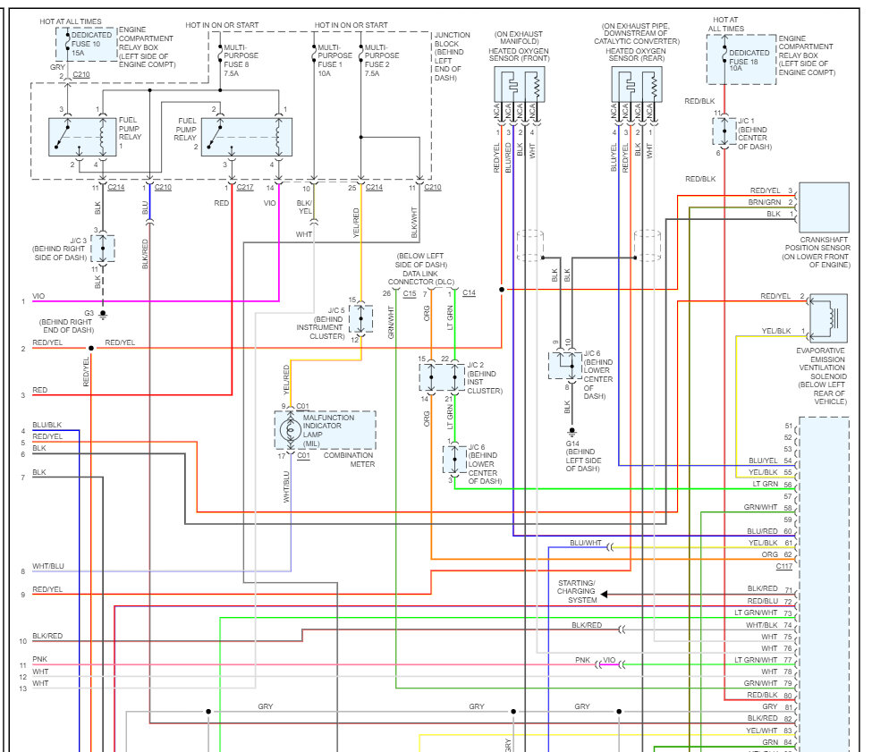

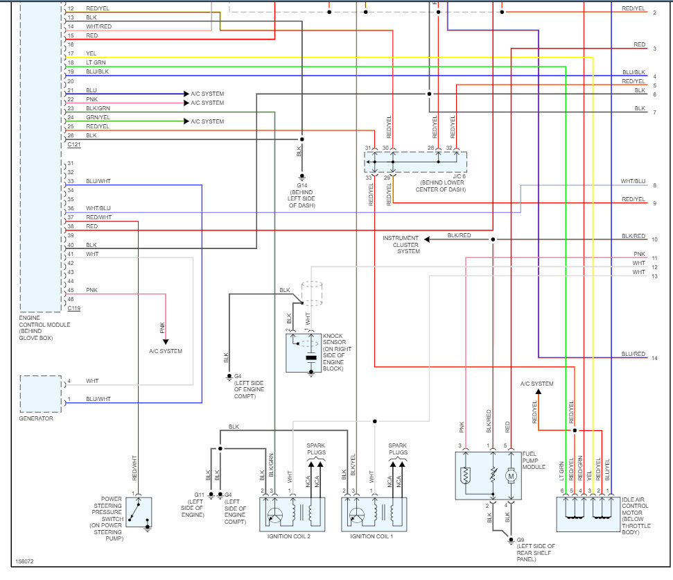

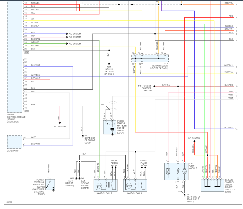

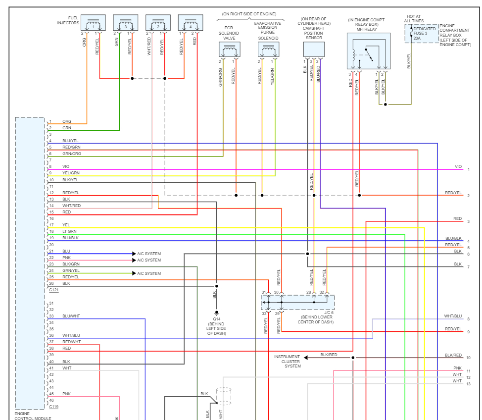

The only of these two that can make the engine not start is the P0335 code, but I have also seen the MAF sensor cause the engine to not start as well, can you disconnect the MAF sensor to see if the engine will run? Here are the wiring diagrams you have requested in the images below. Please let me know what happens.

So, unplugging the MAF did not show response.
And I don't see the MAF sensor in the diagram just idle air sensor.
Feb 26, 2023 at 11:09 PM
  • 55,732 POSTS
They call it a volume airflow meter in the last diagrams bottom left.
