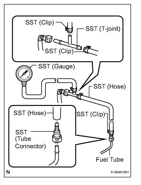

After the first start of the day sometimes it takes forty seconds sometimes it is two minutes I have to wait before it starts. It is doing it more often. I think it is a fuel supply problem. No inline gas filter so I can't put a new one on it. A squirt of engine started in the breather compartment will make it start. It will not idle rough or run rough after it starts.

I agree with you that it is a fuel related issue. With that, I would first start with checking fuel pressure. Here is a link that shows how it is done:
Here are the specific directions for your vehicle. The pressure specs are included in the directions, and the attached picture correlates with these directions.

2. CHECK FUEL PRESSURE
a. Discharge the fuel system pressure
b. Using a voltmeter, measure the battery voltage.
Standard voltage: 11 to 14 V
c. Disconnect the negative (-) battery terminal.
d. Disconnect the fuel hose from the fuel main tube.
picture 1
e. Install SST (pressure gauge) using SST and a fuel tube connector as shown in the illustration.
SST 09268-31011 (09268-41500, 90467-13001, 95336-08070), 09268-45014 (09268-41200, 09268-41220, 09268-41250)
f. Wipe up any gasoline.
g. Connect the negative (-) battery terminal.
h. Connect the intelligent tester to the DLC3.
i. Select the following menu items: DIAGNOSIS / ENHANCED OBD II / ACTIVE TEST / FUEL PUMP / SPD.
j. Measure the fuel pressure.
Fuel pressure: 304 to 343 kPa (3.1 to 3.5 kgf/sq.cm, 44.1 to 49.7 psi)
- If the fuel pressure is greater than the standard value, replace the fuel pressure regulator.
- If the fuel pressure is less than the standard value, check the fuel hoses and connections, fuel pump, fuel filter and fuel pressure regulator.
k. Disconnect the intelligent tester from the DLC3.
l. Start the engine.
m. Measure the fuel pressure at idle.
n. Stop the engine.
o. Check that the fuel pressure remains as specified for 5 minutes after the engine stops.
Fuel pressure: 147 kPa (1.5 kgf.sq.cm, 21 psi) or more
If the fuel pressure is not as specified, check the fuel pump, pressure regulator and/or fuel injectors.
p. After checking the fuel pressure, carefully disconnect the negative (-) battery cable, and remove the SST and fuel tube connector to prevent gasoline from splashing.
q. Reconnect the fuel tube to the main fuel tube (fuel tube connector).
r. Install the No. 1 fuel pipe clamp to the fuel tube connector.
s. Check for fuel leaks (step 1)
