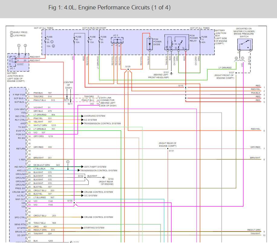

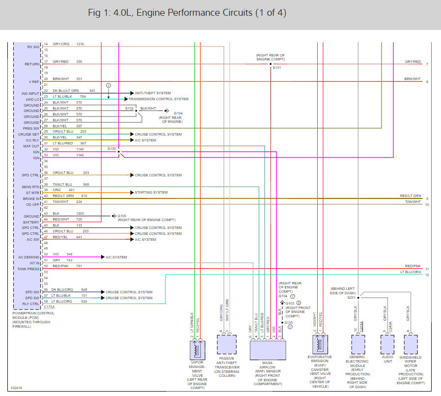

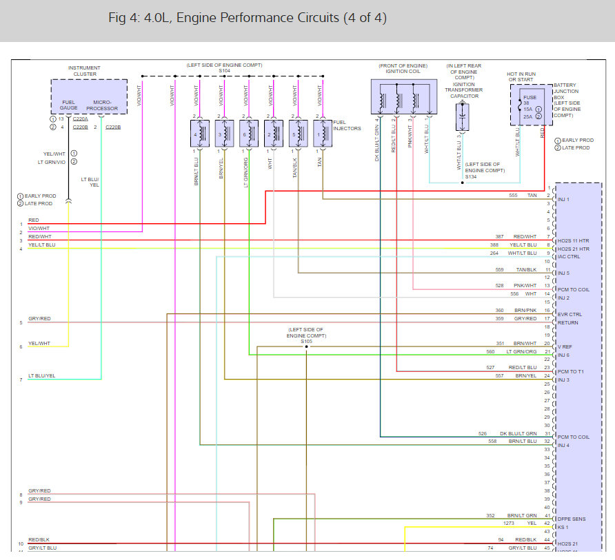

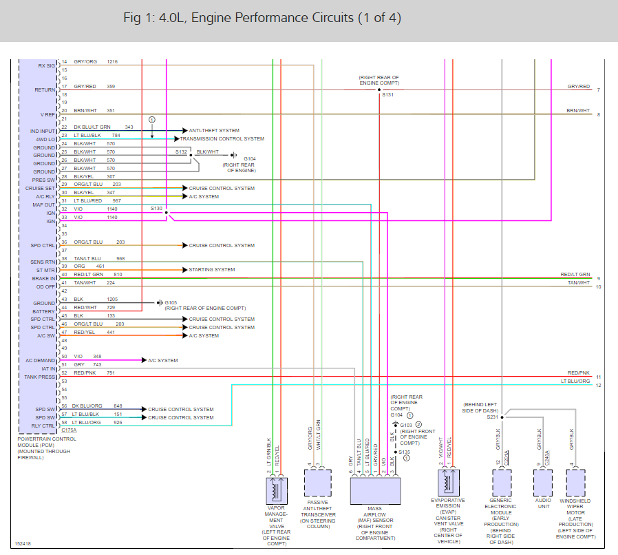

It sounds like the injectors are okay. I would check all grounds and power sources to the ECM here is a guide and a wiring diagram to help you get the job done.
If the wiring checks out the ECM must have had a problem a voltage surge perhaps I would look into a rebuilt ECU.
Let me know

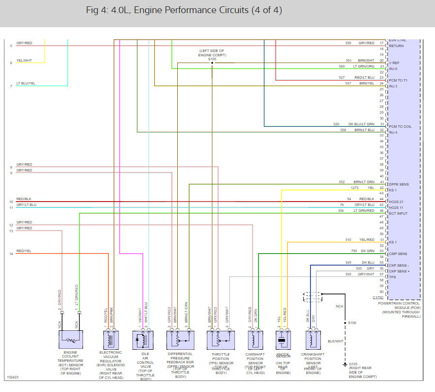

Hi Ken. Thanks again for replying. I giving you an update on the explorer. I checked for power to the cam and crank sensors from connectors. With key on only getting 1.49 volts to the crank sensor on any pin. And im getting 0.03 from the cam sensor connector. I checked with multimeter from negative battery post to the connector pins. Also trace crank wiring to ecu and checked for resistance and I got 0.00 on both wires. Still need to trace the cam sensor wires. Do you know if any fuses or relays need to be check. If so let me know which ones.

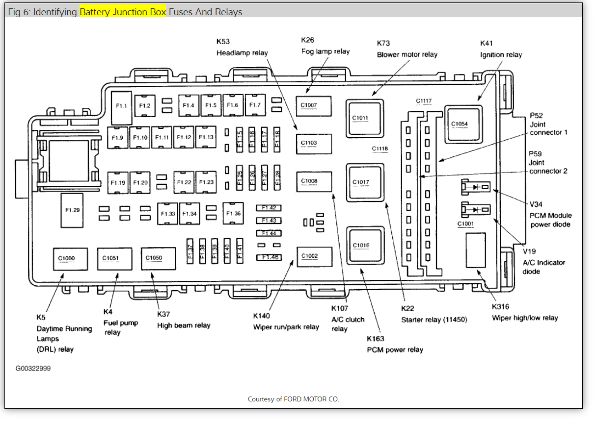

I would check the PCM relay.

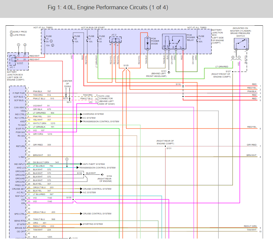

Hi Ken. Quick update. Relays seems to be ok. I have 12volts getting to the relay. However there is only 1.49 volts coming out of the pcm pin that feeds the crank sensor. I had to put a jumper from pin 87 to 30. Tried several relays. Also checked the connector that feeds power to the pcm with key on, and they all have 12 to 11.5 volts ecept for pin 3a (brown) which gave me 1.15 to 1.45 back and forth. And pin 4a (pink) gave me 1.69 volts. Dont know if thats normal. Let me know what you think. Thanks
Tuesday, January 16th, 2018 AT 7:49 PM
KEN L
  • MASTER CERTIFIED MECHANIC
  • 48,363 POSTS
It sounds like the voltage regulator inside the PCM has gone out. Make sure you check the power and grounds to the PCM and if all okay it sounds like the PCM has gone out. You may be able to get a used one and plug it in to see if it works if not the unit will need to be programmed.

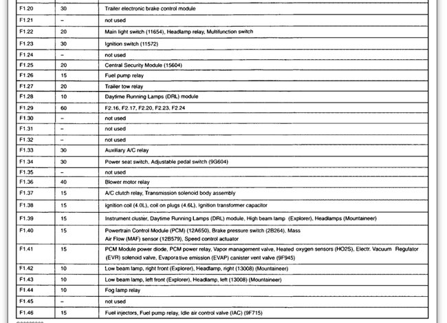

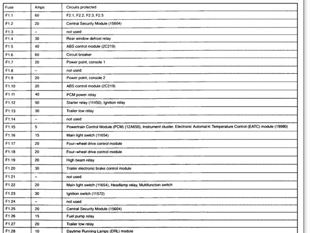

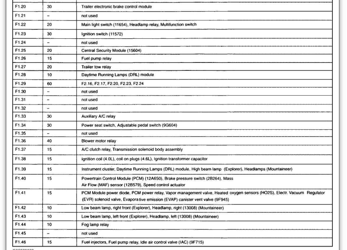

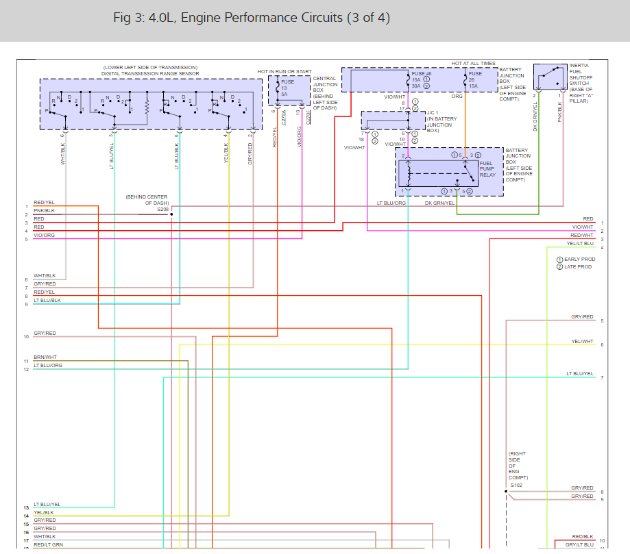

Hi ken. Noticed no voltage on fuse 39 in junction box, fuse is good with key on. Thanks.
Thursday, January 18th, 2018 AT 12:33 AM
MANNNY76
  • 25 POSTS
Also 42 and 43. They only have power when battery is disconnected from negative post. But if I connect the negative battery terminal to the post no more current flow. Key on or key off. So dont know if this is normal. Are these fuses suppose to be live all the time? Just noticed that Im getting 12 volt on my crank sensor. But only if negative battery cable is disconnected from cranksensor connector to negative battery post without negative battery cable connected. As soon as I connect the battery cable I loose all the voltage.

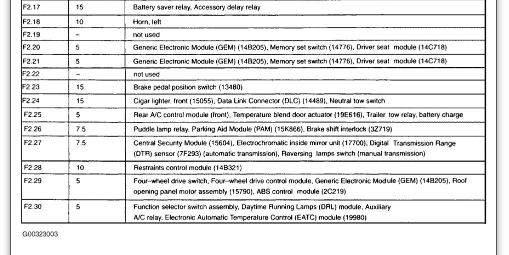

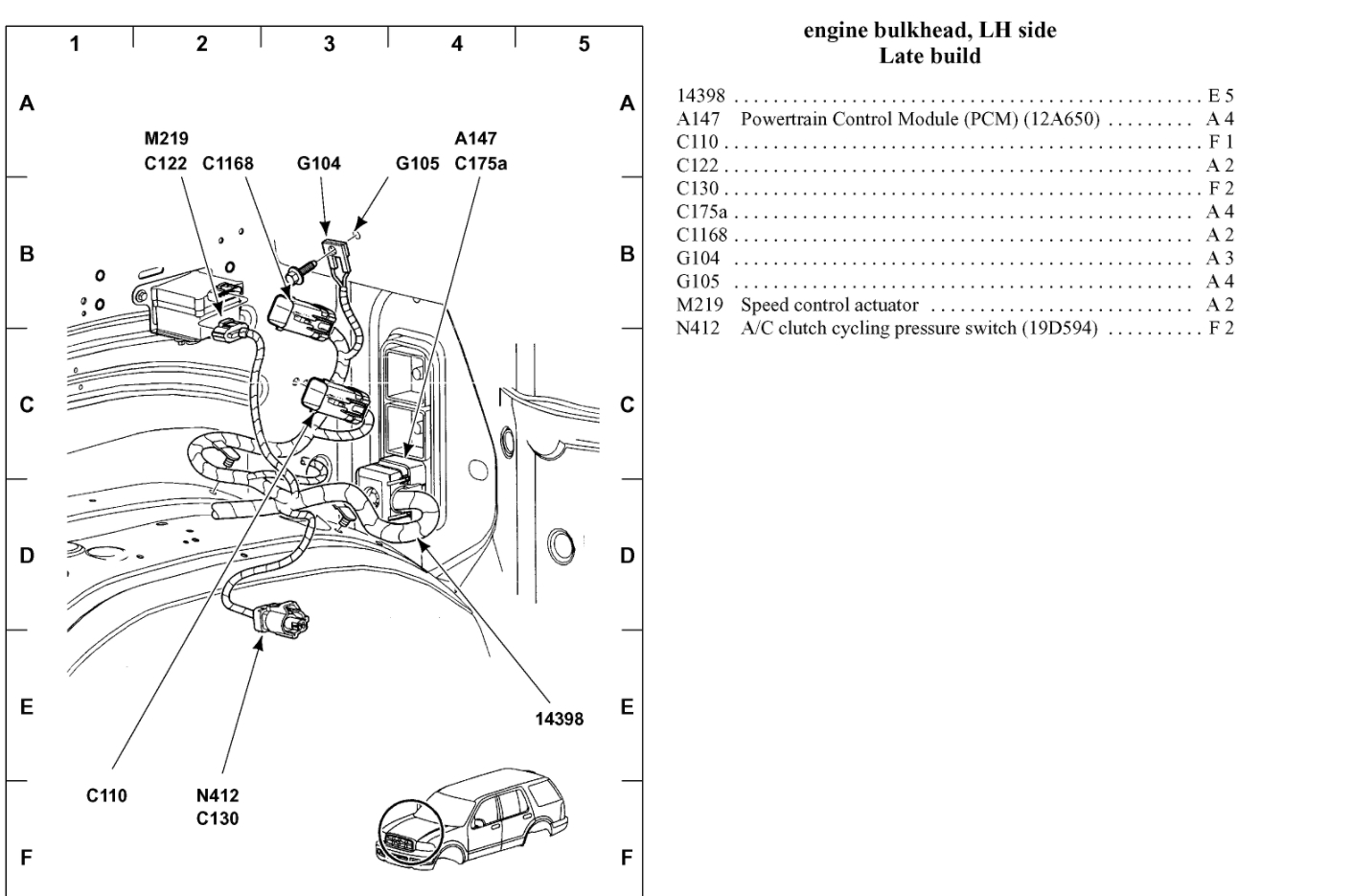

It is starting to sounds like you have a ground cable/strap that is not connected from the engine to the frame can you double check it for me?
Thursday, January 18th, 2018 AT 4:57 PM

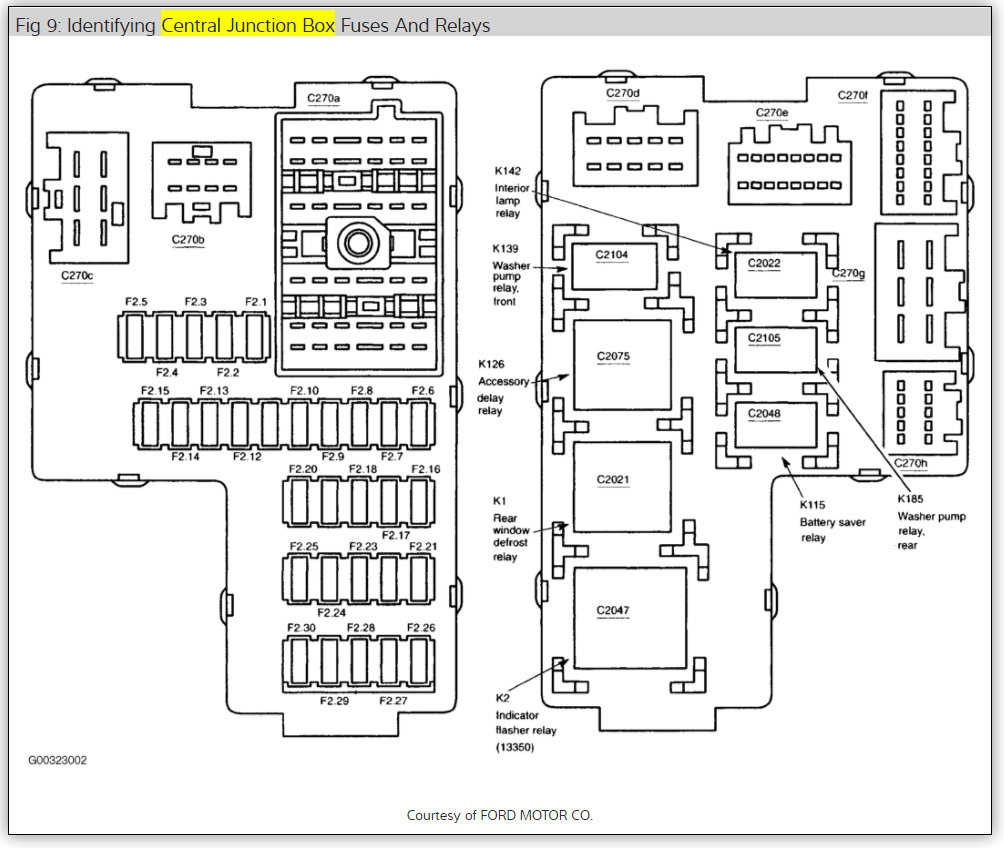

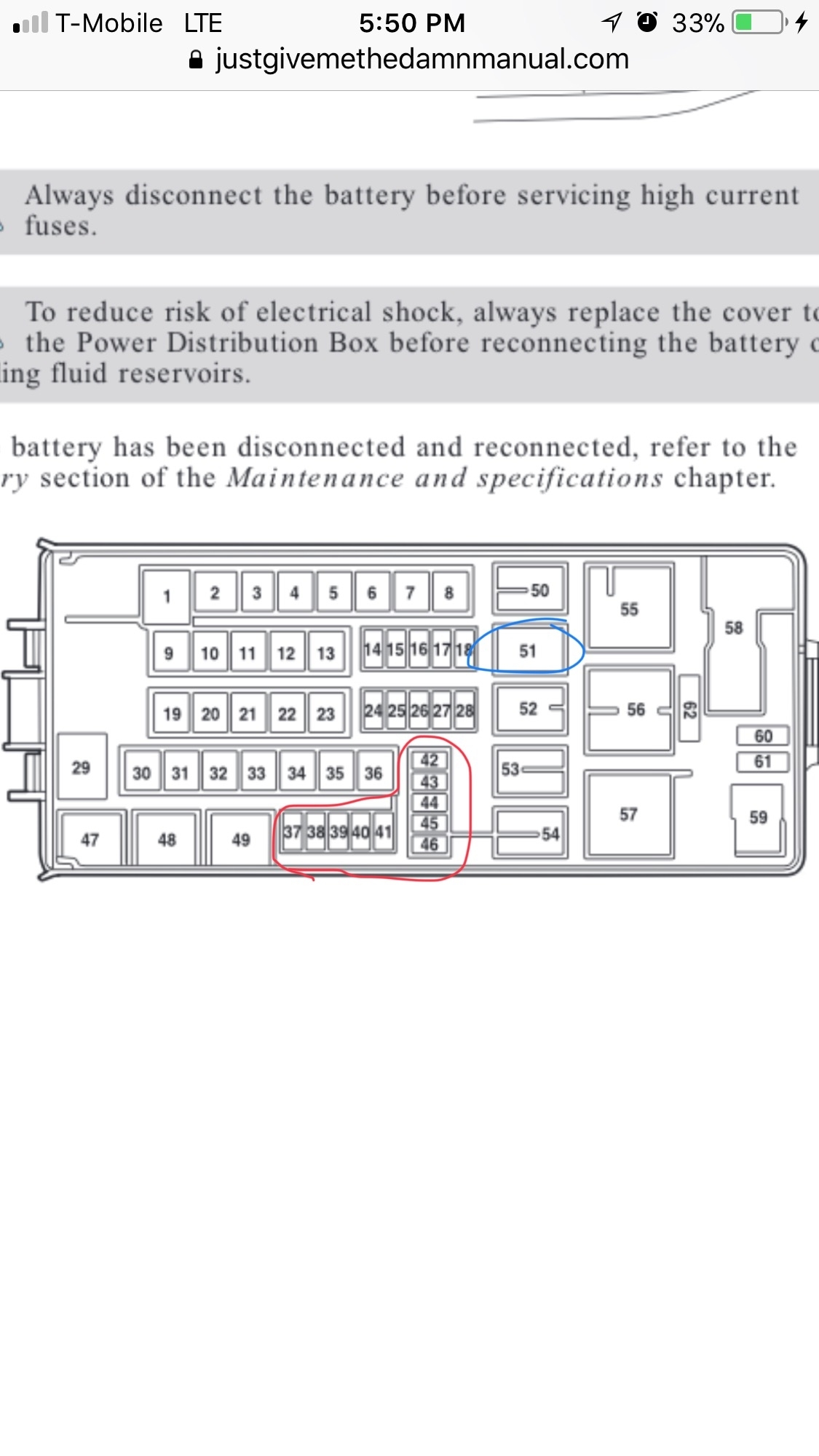

MANNNY76
  • 25 POSTS

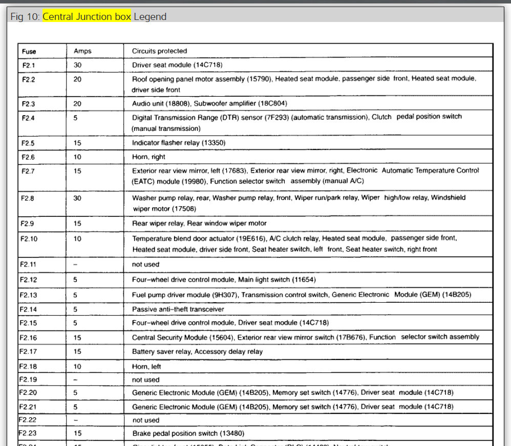

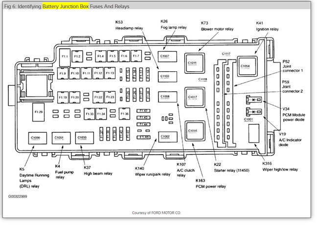

Do you have a diagram where a should check. You know like a picture one sending you a picture of the fuses that loose power on all fuses in red circle. The relay in the blue circle clicks when Negative battery is connected. Which is the police ivd relay. If I reconnect the battery while testing fuse 39 this relay stars clickng non stop till I disconnect the negative terminal. Hope this helps you to help me. Thanks in advance ken. I really appreciate your help.
Thursday, January 18th, 2018 AT 11:23 PM

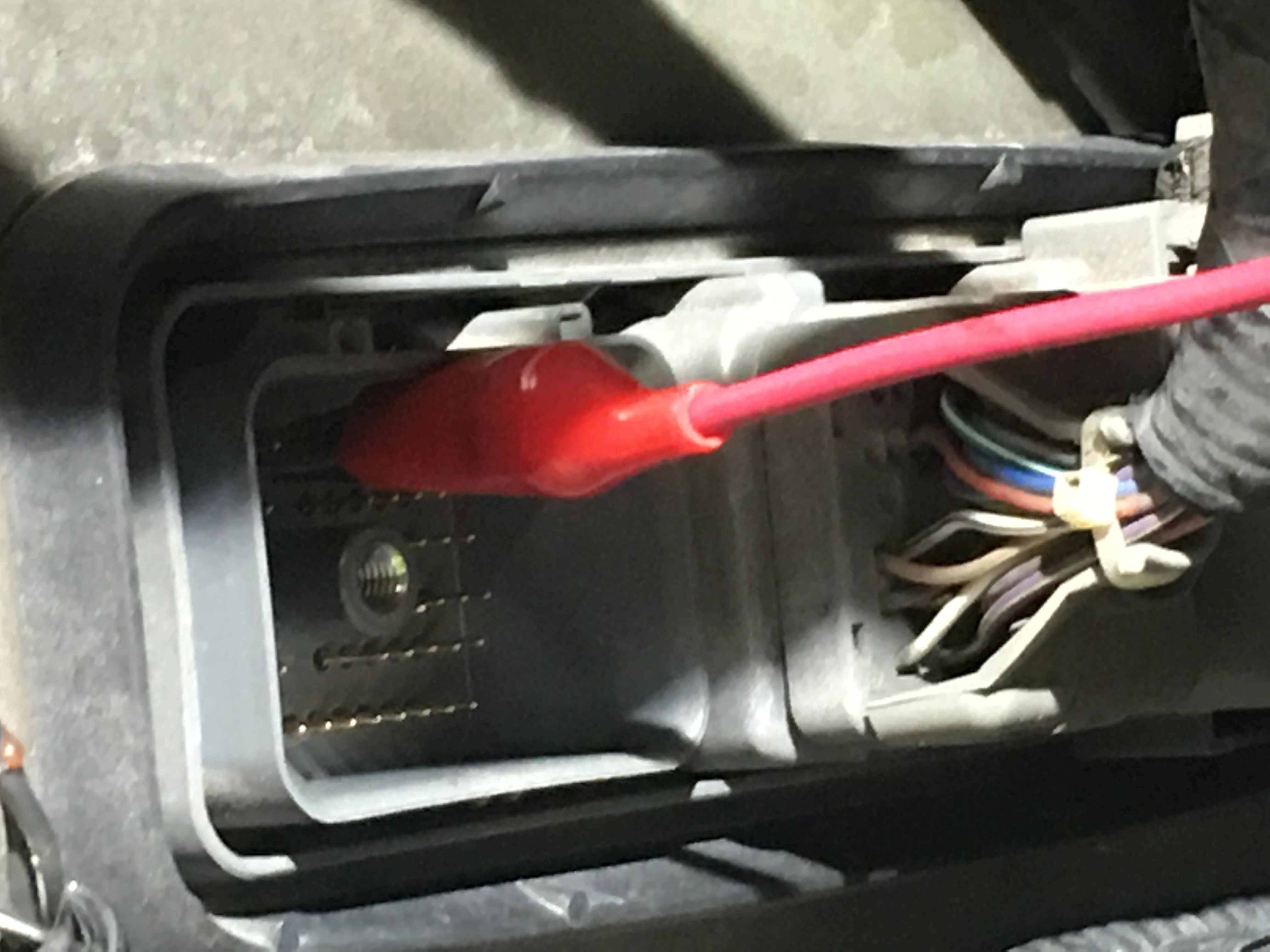

This is sounding more and more like a PCM problem. Have you done a pin to pin check of the wiring harness if so I would do the PCM.
Friday, January 19th, 2018 AT 10:37 AM
MANNNY76
  • 25 POSTS
How do I do that? I will check, just tell me which connector and what to expect from each pin. This issue happened even when connectors where not connected to the pcm. Some pins that are powering the pcm, supply only 1.2 volts. Pin 3 and 4 some pins don’t have voltage at all I just don’t know if all pins need to have 12 volts besides the 4 black and white ground wires.
