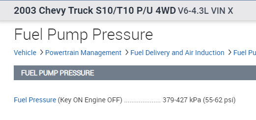

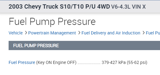

Based on that information, it isn't getting fuel into the engine. You indicated the fuel pump was replaced. Have you confirmed the fuel pressure is within the manufacturer's specifications? Here is a link that explains in general how it is done. Also, I attached the manufacturer's pressure specifications below.
If the fuel pressure is within the specifications provided, then we need to check if the injectors are getting power and ground.

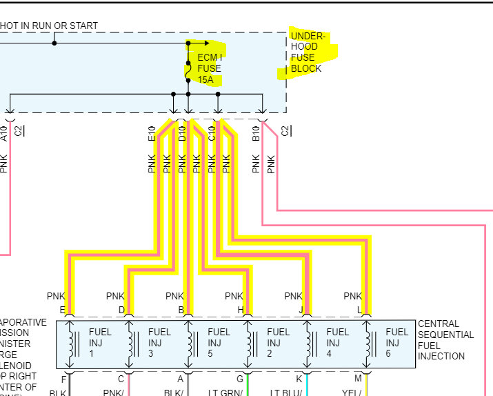

Each injector has two wires. One will be a pink wire (at each injector) and the other will be different from one injector to the other. With the key on, there should be power to the pink wires. Check that for me first. If there is no power, check the ECM1 fuse in the under-hood fuse box. Check the fuse and confirm there is power to and from it.
Do this and let me know the results.
