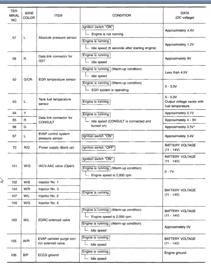

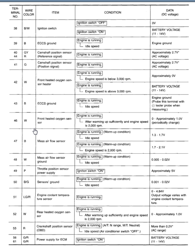

Before I was getting spark now I'm not getting this is beginning to be a nightmare problem injectors are pulsing-what's next
This a 97 HB my bad-does this have a CPS on the transmission.

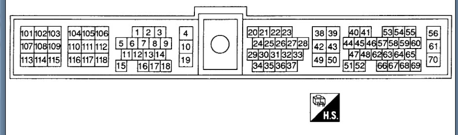

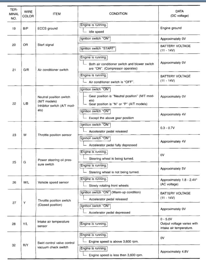

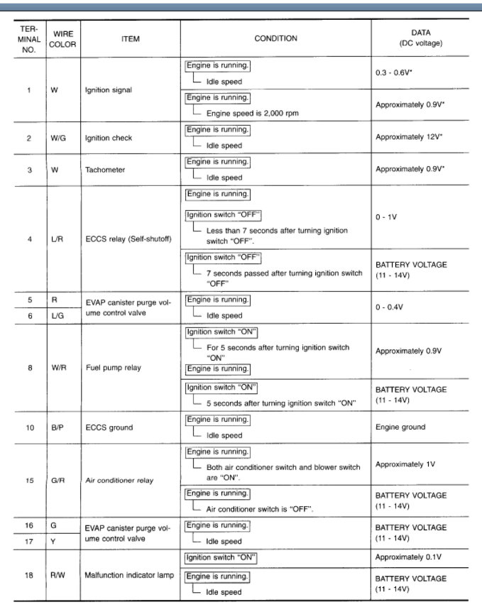

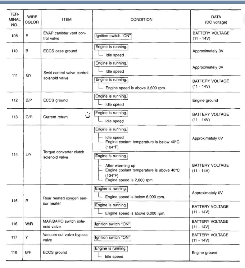

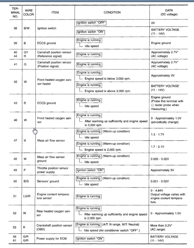

Can you give me the PCM pinouts.
Feb 27, 2021 at 4:38 PM
So if you have spark and injectors are firing, plus the compression is okay, then we are missing something.
You need spark, fuel and compression to start the engine. So have you changed the spark plugs to make sure they are not fouled with fuel?
I attached the PCM info below.
Mar 1, 2021 at 8:05 AM

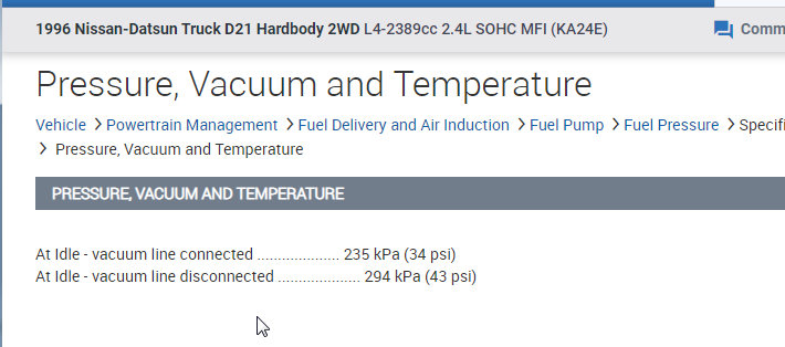

Now I have spark and fuel injector pulsing, compression is 190 PSI it seems like the injector is not spraying the correct amount of pressure when fuel rail disconnected. also the fuel pressure when check with a gauge is 32 psi what's next to check- i'm thinking fuel injectors- It seem s pressure is to high at 32psi. I thought the pressure should be 9-14 PSI for a TBI.Thank you Mr. K
Mar 2, 2021 at 10:28 AM
TBI? Meaning throttle body injection? Are you sure this vehicle has this system because I so it has an MFI, multipoint fuel injection. Meaning it has injectors at the cylinders and not on the throttle body. If that is the case then the fuel pressure is correct. I attached it below.
