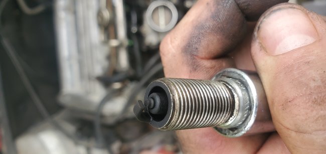

When I pulled the plugs, they were damp and dried quickly but here are pics tried to take as soon as they came out. this was 2 minutes after cranking with relay in.
May 20, 2022 at 6:40 AM
  • 55,224 POSTS

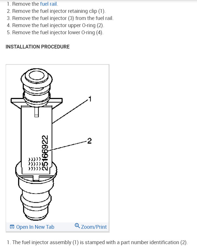

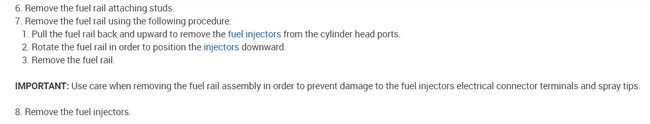

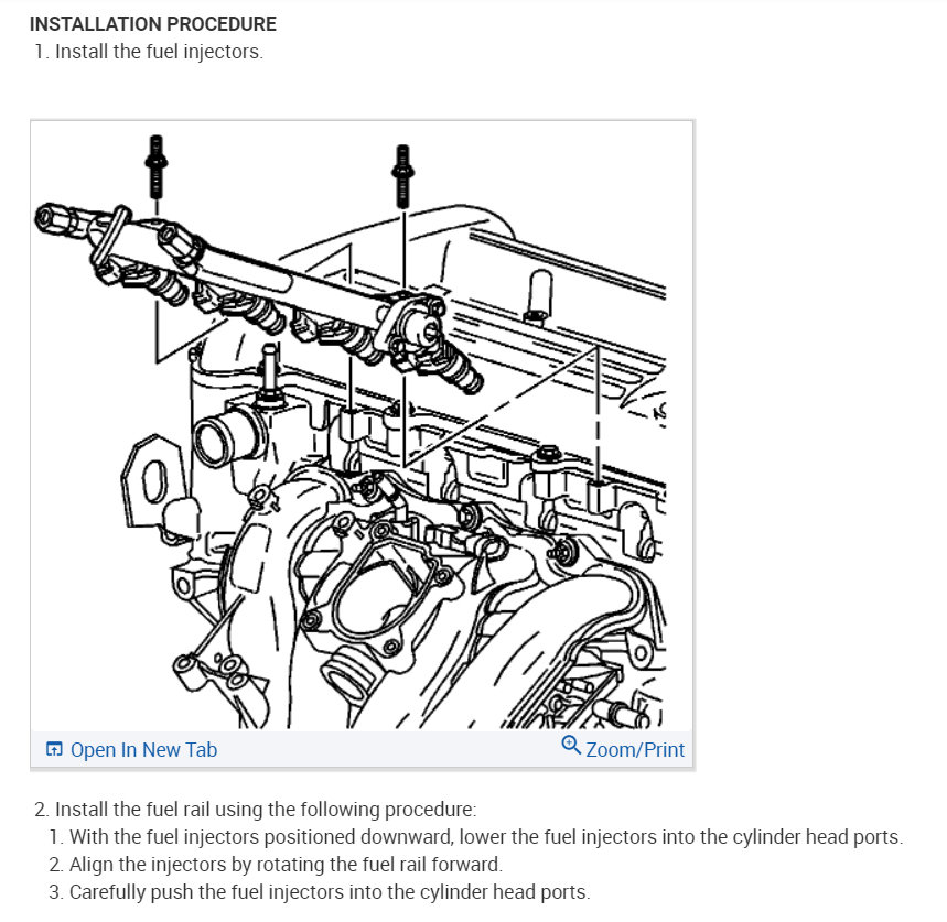

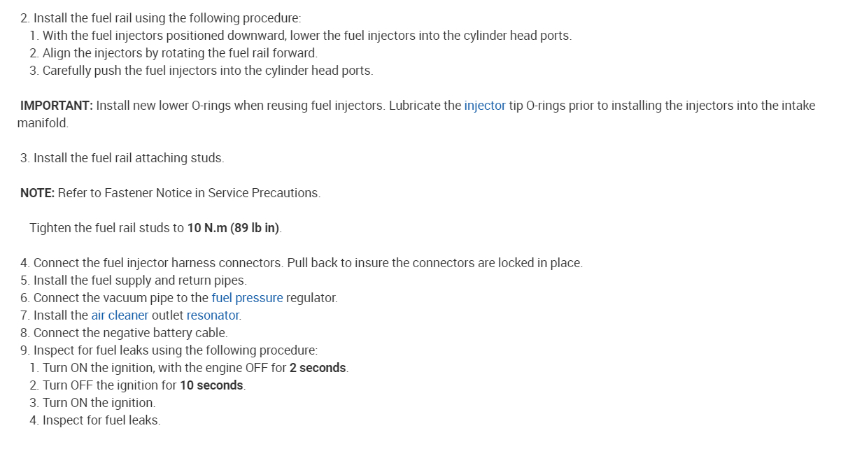

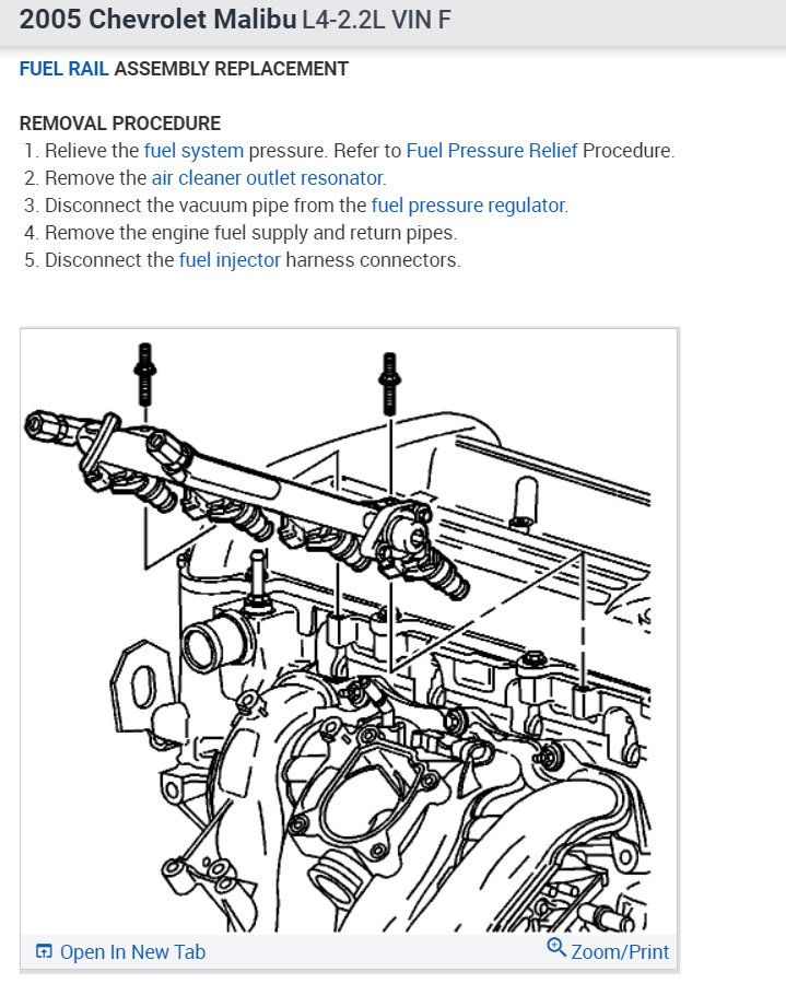

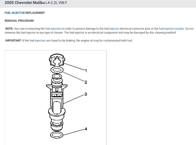

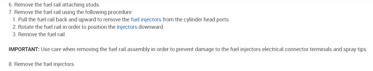

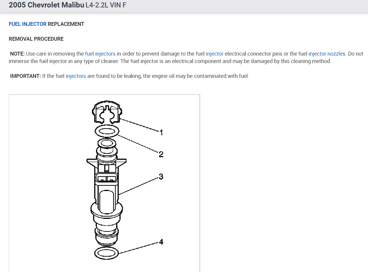

Yes, those are carbon fouled and will need to be replaced. Do the rest of the plugs look the same? I would remove them all and look for one that is different, this will be the cylinder the injector is stuck open on. Here is a generic guide on how to replace an injector with diagrams below to show you how on your car:
https://www.2carpros.com/articles/how-to-replace-a-fuel-injector
