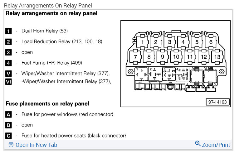

Car will not run unless starting fluid is used. Fuel pump relay has to be jumped to get fuel pump on but it was working normal after the no start. Seems like the fuel system has shut down and will not deliver gas to plugs.

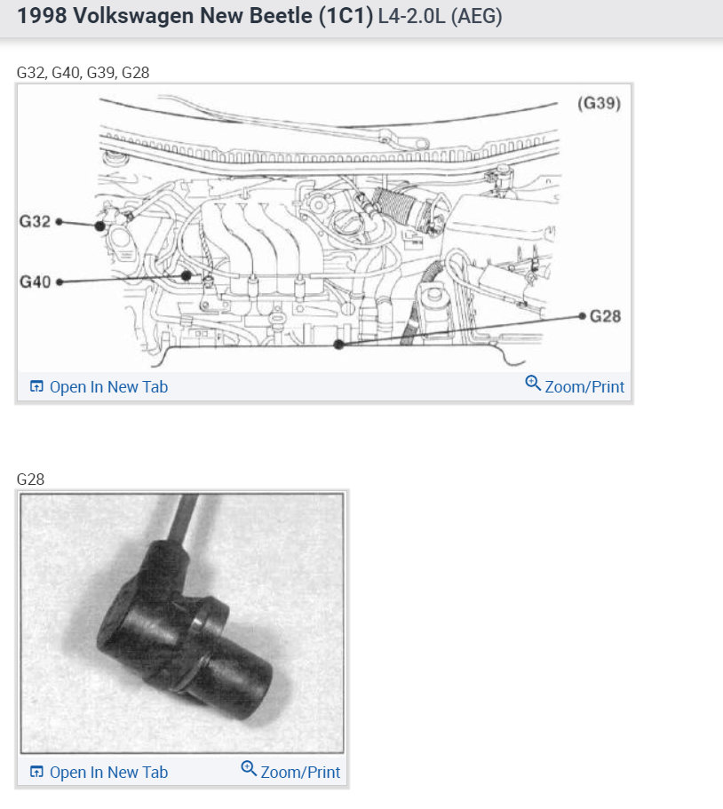

P0725, p1850, p1854 and p1857 is what shows up. No tachometer movement while cranking suggests crank position sensor but previous owner said he "just put a new one on trying to fix it".
Jul 2, 2019 at 5:27 PM
  • 55,721 POSTS

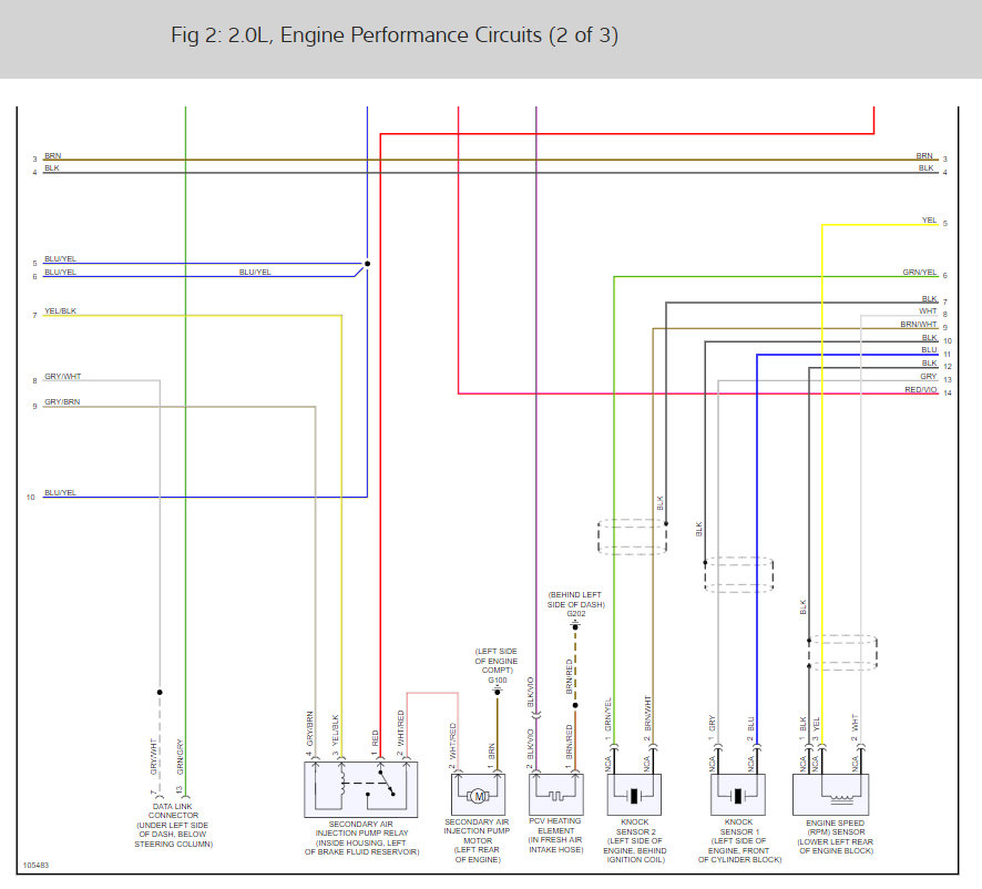

Yep, the RPM sensor sounds like it is out. I would replace it with a OEM part. Here is the location in the diagrams below. Please let us know what happens.
Jul 3, 2019 at 4:52 AM

I was messing with the fuses and finally got the fuel pump to work normal but now I don't have fire. I've been meeting with fuses and relays trying to recreate the fuel pump not working and getting fire but no luck. Could the fuel pump have just been a bad fuse and could the no fire be completely unrelated? And I can make it give the p0322 code by unplugging the crank sensor and trying to start it. Now I'm back to where I started with no fire.

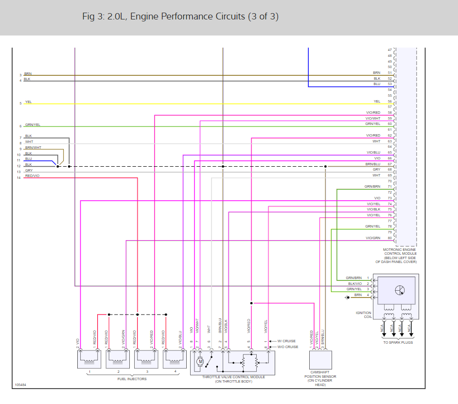

I did change the crank sensor and coil pack with no change. I am not getting battery voltage at the coil with key on. It jumps around between 8 and 11 volts. If i wiggle the ignition switch connector it changes how many volts it gets. I have 3 ignition switches, all 3 do the same thing. There is one pin on the connector that is broke. I'm going to try to connect another connector to it and see if that helps. Will be back with results after I'm done.

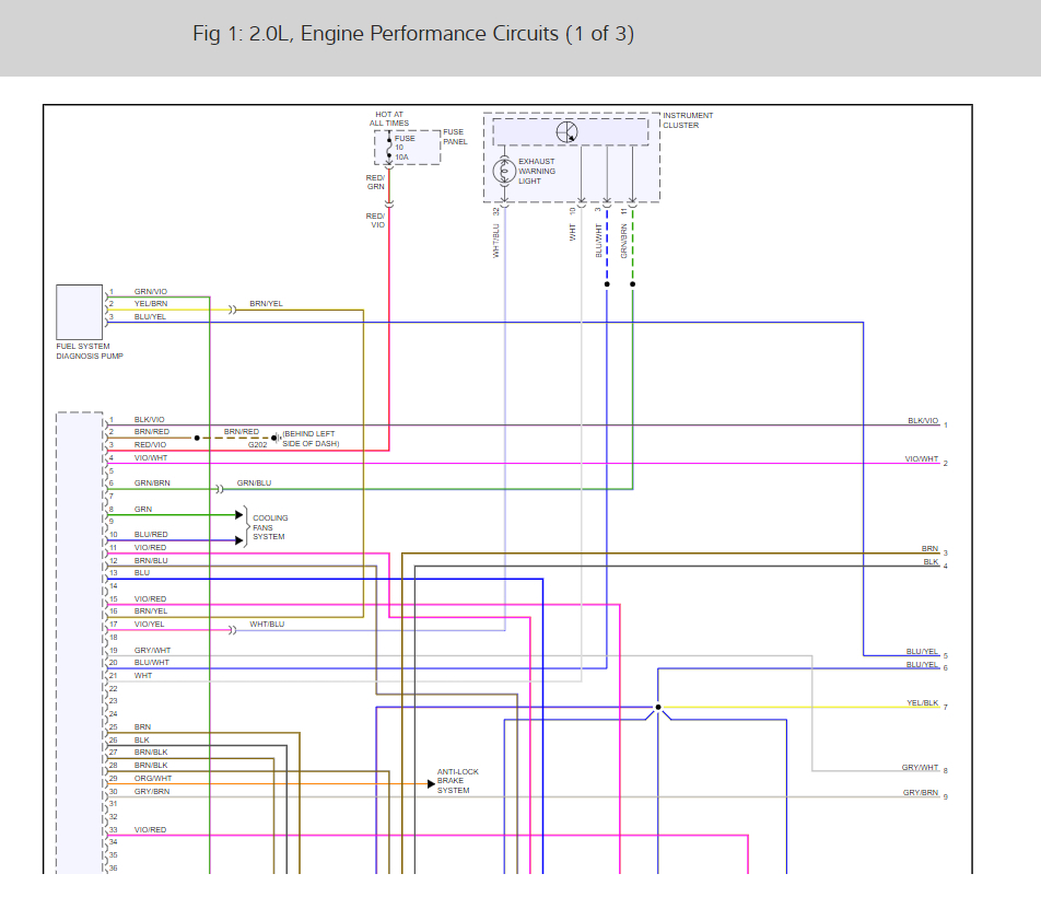

  • 55,721 POSTS

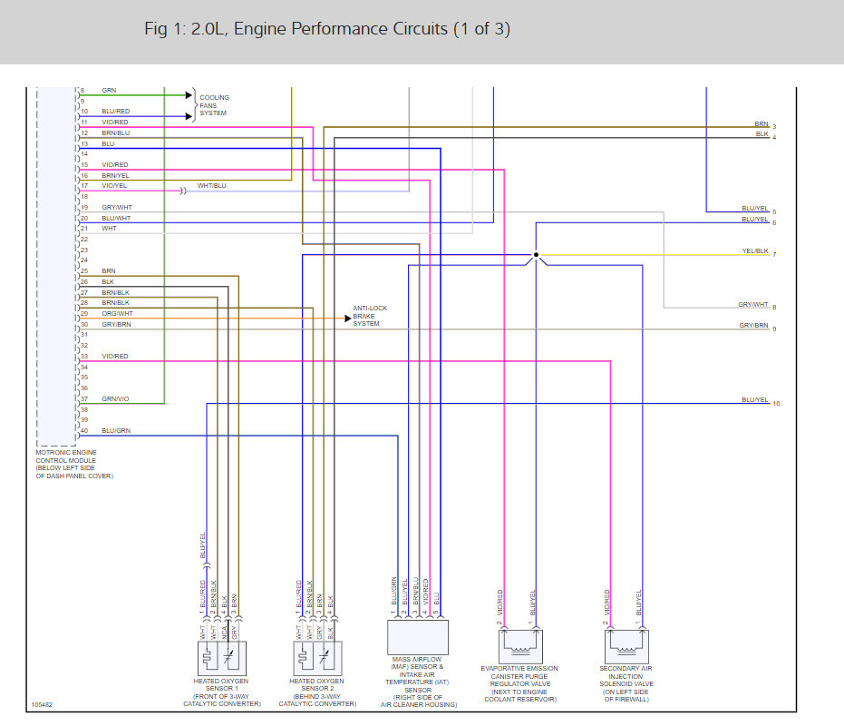

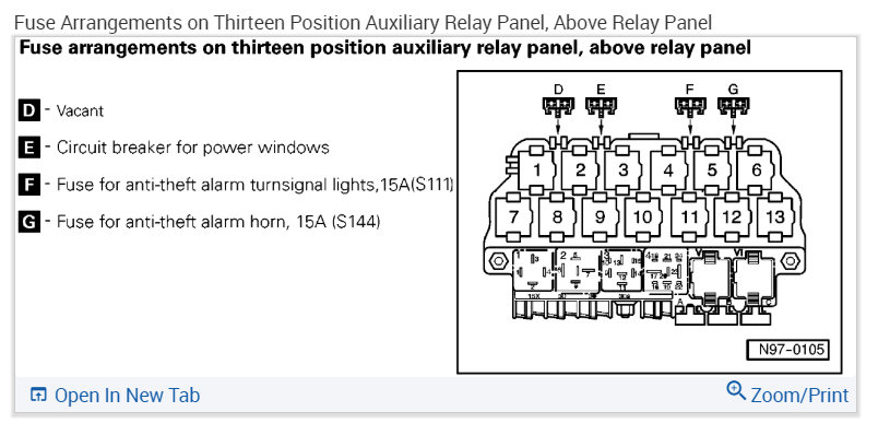

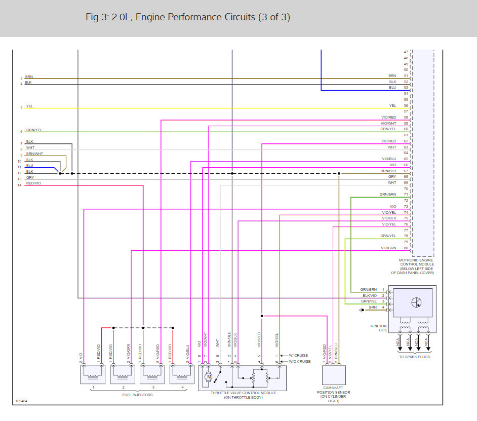

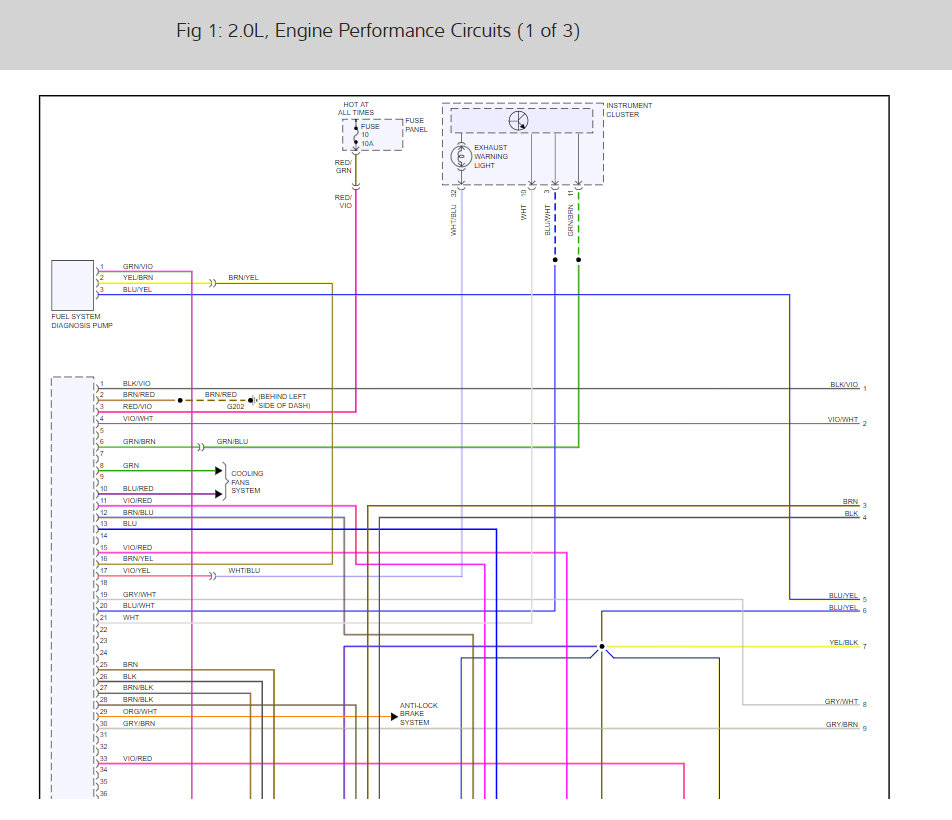

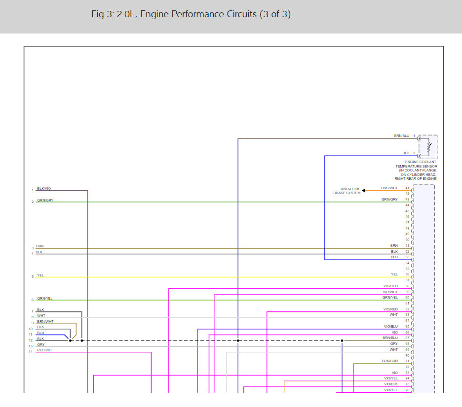

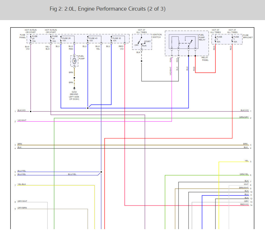

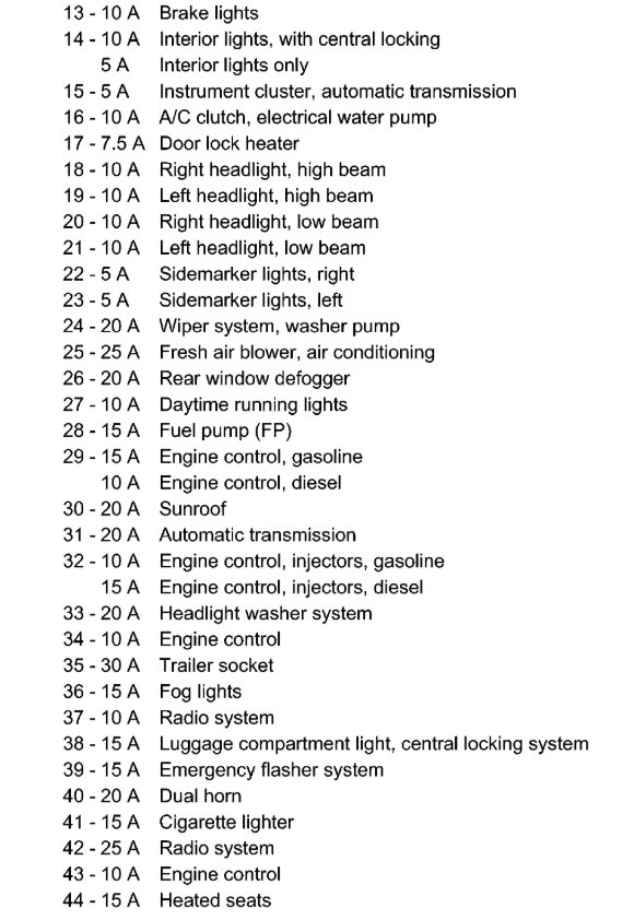

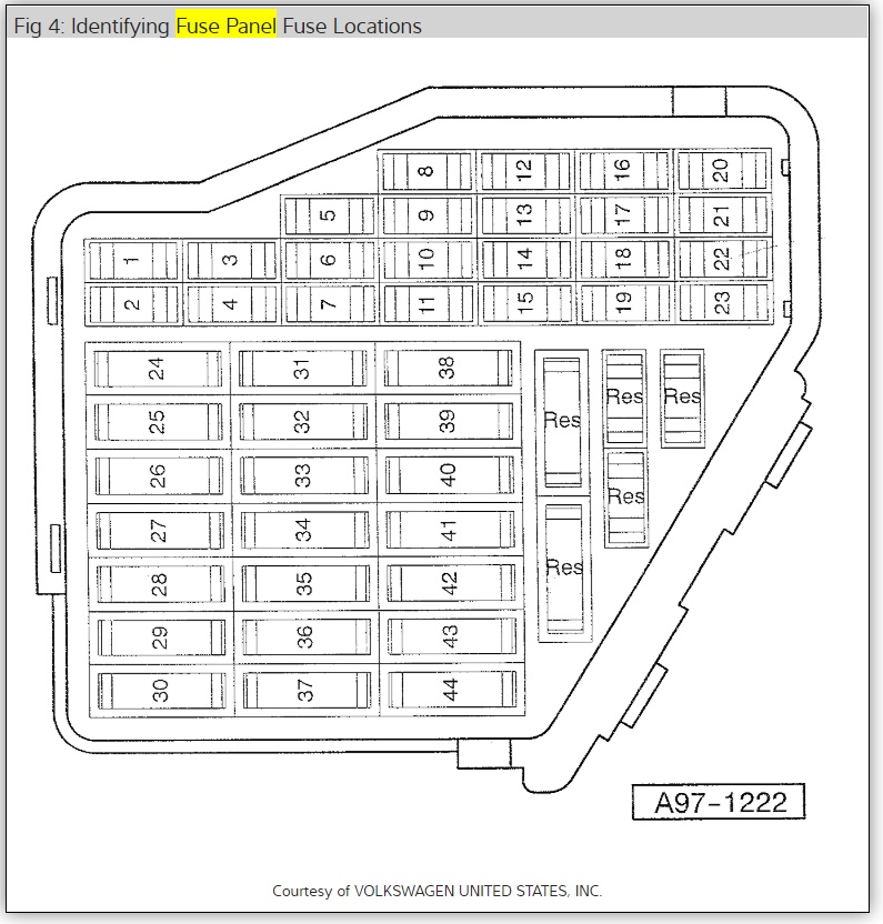

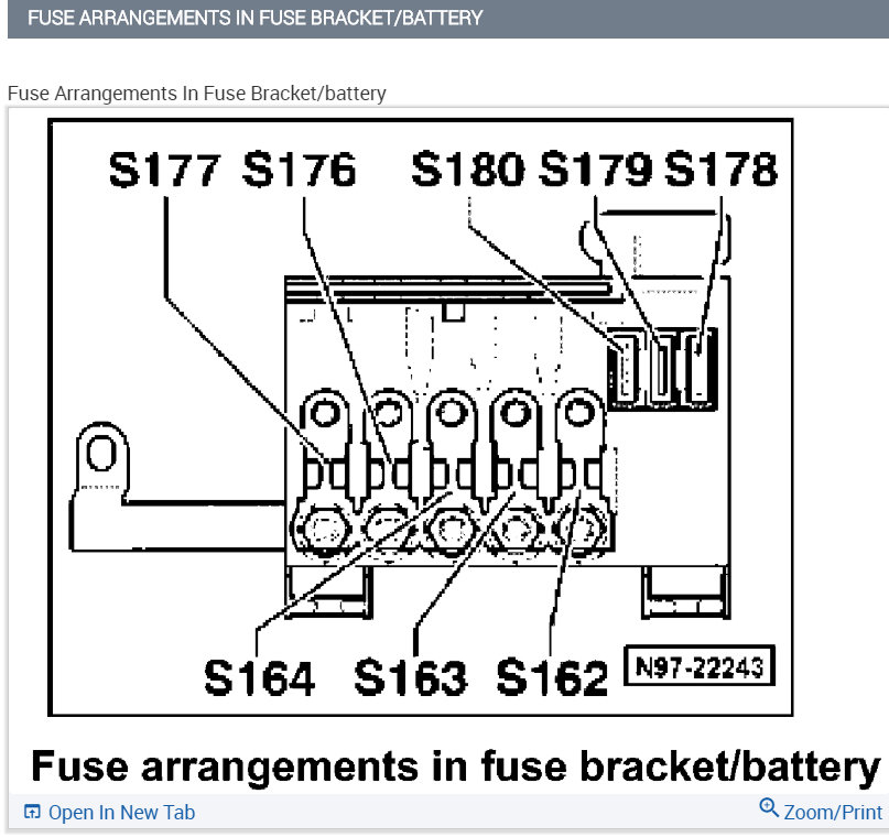

Okay, there are fuses that run the system. lets check for power at each with the key on. here is the engine wiring diagrams so you can see how it works and which fuses to check:
Jul 10, 2019 at 3:36 AM

  • 28 POSTS
So putting in a new ignition switch connector didn't help. I did find that if I remove the relay for the fuel pump that it will get spark again. Plug the relay back in and no spark. I'm going to get a new relay and see what happens. I hope it is not the computer keeping it from getting spark when the relay is in.
Jul 10, 2019 at 8:18 AM
BRANDONGIBSON160
  • 28 POSTS
Realized that the engine will run on starting fluid with or without the coil pack plugged up. But only if the fuel pump relay is unplugged.
Jul 10, 2019 at 11:54 AM
  • 55,721 POSTS
It sounds like the relay is shorted. lets try a new one. Please let me know.

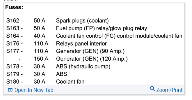

BRANDONGIBSON160
  • 28 POSTS

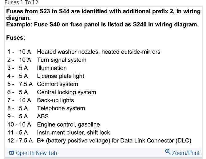

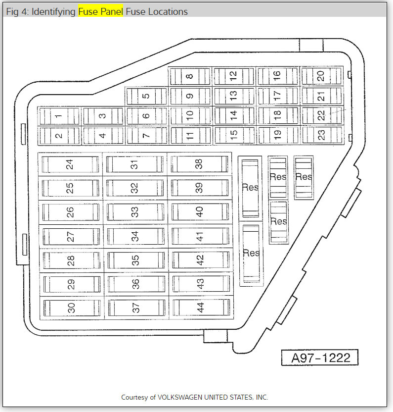

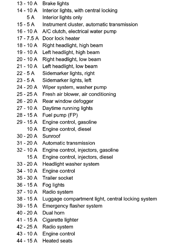

I checked power to the fuses and im getting no power to fuses 29, 32 and 43.
Jul 12, 2019 at 12:02 AM
BRANDONGIBSON160
  • 28 POSTS
I get power to 32 and 43 until the fuel pump stops priming.
Jul 12, 2019 at 12:07 AM
BRANDONGIBSON160
  • 28 POSTS
New fuse in 29 gets power.

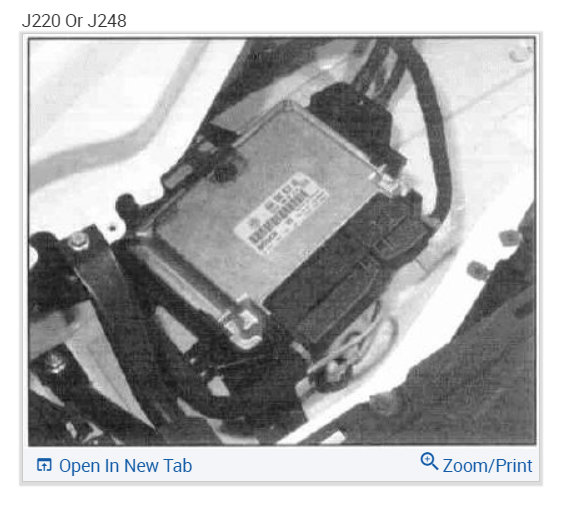

So now it has got to the point where I can't even connect my code reader to the car. Can i get a PCM out of a pull a part and put it in and it work if its a good one or would i have to have it flashed?
Jul 17, 2019 at 11:32 AM
  • 55,721 POSTS
Most of the time a used one will work, but you can order a rebuild unit and give them your VIN to be sure. Let me know
Jul 18, 2019 at 2:21 AM
BRANDONGIBSON160
  • 28 POSTS

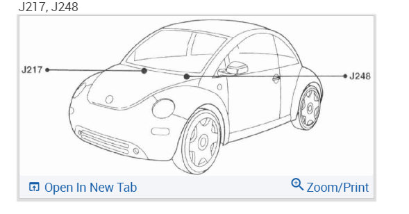

Is the pcm behind the gauges or on the passenger side?
Jul 19, 2019 at 10:50 AM

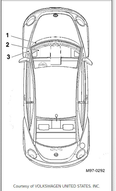

  • 55,721 POSTS
Here is the location of the PCM. Check out the diagrams (below). Please let us know what happens.
Jul 20, 2019 at 3:45 AM

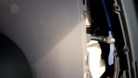

The sound quality is bad. Here is a video:
Aug 6, 2019 at 6:01 AM

BRANDONGIBSON160
  • 28 POSTS
Checked power to fuses again and there is no power to fuse 32 with key on. Could this be my problem?
Aug 8, 2019 at 6:07 AM
